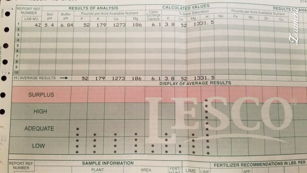

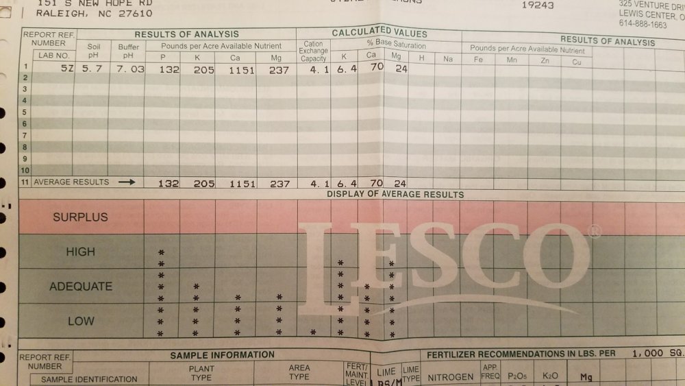

Got our lawn area soils reports back today...
I just put down 5#/1000 last week but picked up more today based on the report recommendations. Based on my conversation with the guy at Site One, I'll be adding more (to get where I'm supposed to be) when I put down winter fertilizer.
I'll be taking a closer look at the fertilizer recommendations, also. @R Q , any thoughts?

Yes, do the lime as recommended. I expect that Site One recommended Calcitic Lime or fast lime. Your other option is regular dolomitic lime which works slower but in my opinion lasts longer also and will raise your already low Mg. Your soil does need calcium so use the fast lime first to get your pH closer then, use dolomitic for a longer lasting effect.
Next consider using some Gypsum at 15/M a couple of times in the next year and it is always a good addition. It will get your Cation Exchange Capacity (CEC) rate up which you need. CEC is a rate at which the molecules in the soil are able to move about and interact so to speak. It is not a measure of compaction.
One thing that the Lesco tests don't measure is the Humic value, or the amount of organic matter within the soil which is a helpful tool. Organics in the soil add beneficial bacteria and nutrients. You can add organics by using Milorganite, real compost, or some of the organic based ferts on the market, BUT these are hard to add into your pre-em program because being organic, they usually don't add chemicals such as pre-em into them. Many of the Lesco ferts do have an organic component added into them but IMO it's not enough, I like real compost or composted poultry fertilizer. Site One does carry a GREAT organic fert called Sustane, but it ain't cheap!
One last thing and you may think I'm crazy but go buy some red wiggler fishing worms and plant them around a few places in your yard. Yes, dig as hole and put them in it and make sure the soil is moist and don't mash them in. There is nothing that works harder at decompacting your soil and turning organic matter into usable nutrients than the red wiggler worm.
Okay a second last thing, next time you do a soil sample, use NCSU, NCDA&CS Agronomic Division - Soil Test Forms and Information Its free most of the year and gives you a little bit more useful info. It is slow to get back to you so Im glad you used Site One this time around.
