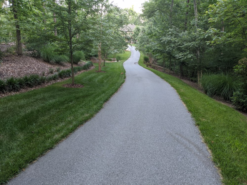

My new fescue (planted in the fall) has been doing well, followed all the directions given by @R Q with good success.

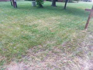

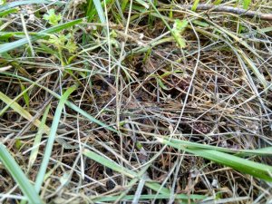

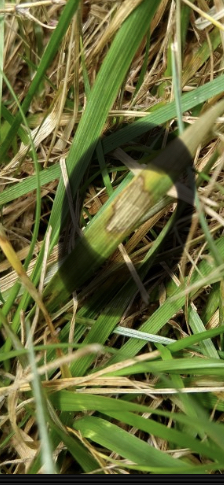

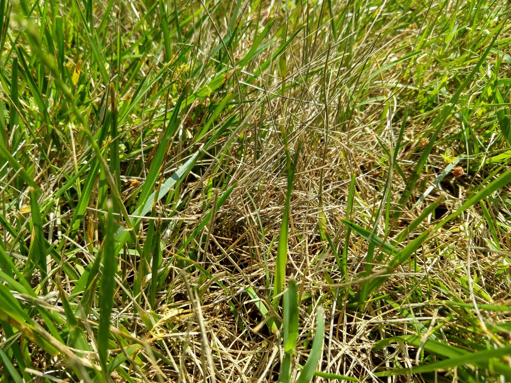

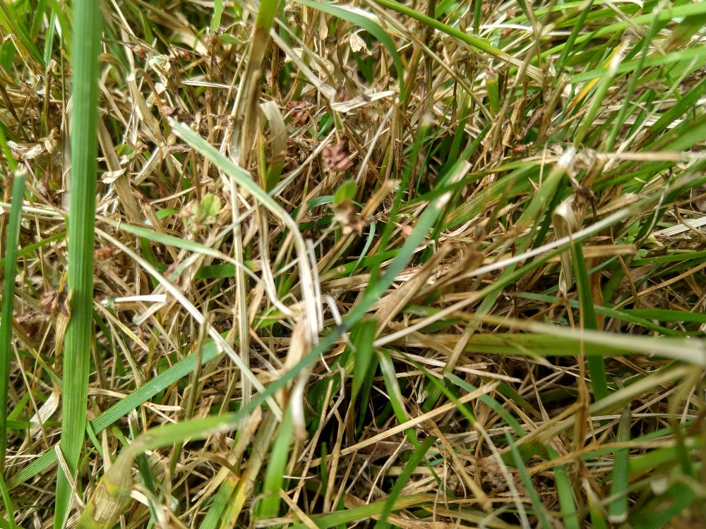

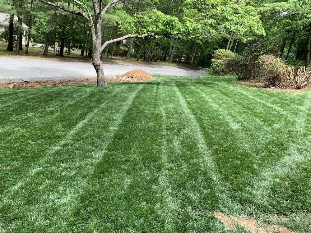

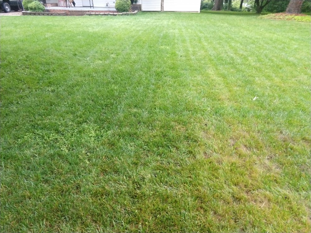

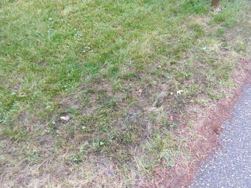

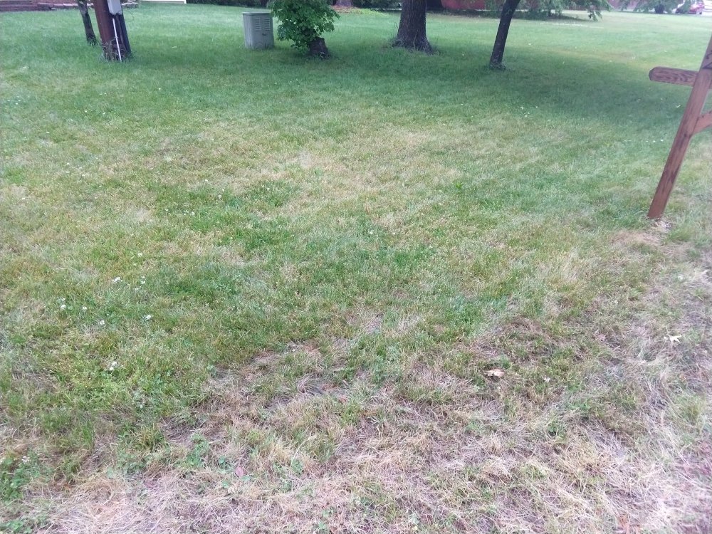

In the last week there have been patches of lawn (only in the front yard) that looked like they were getting dry/burned. Then spots within the dry section started turning dark brown/black. Is this a fungus, is it a soil deficiency?

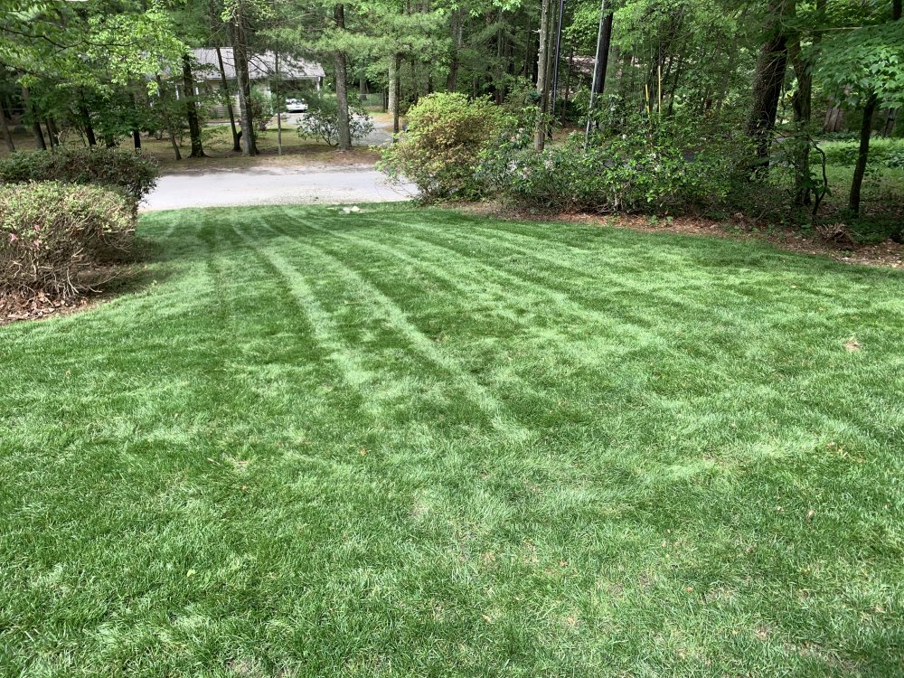

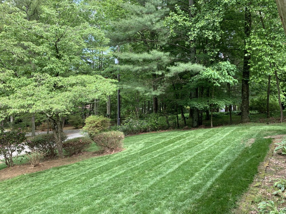

The last picture is proof that most of the lawn is still chugging along and green.

See the mailbox post....any chance the mailman is running in the yard there?
Take a soil probe and see how much soil is there, normally areas close to asphalt get hot quicker because the top soil is thin and it has road bond (gravel) under it
this occurs not only in the heat, but under periods where it hasn’t rained in a while,
areas in the middle of your lawn can be affected by What is called hydrophobic condition, where the soil actually repels water

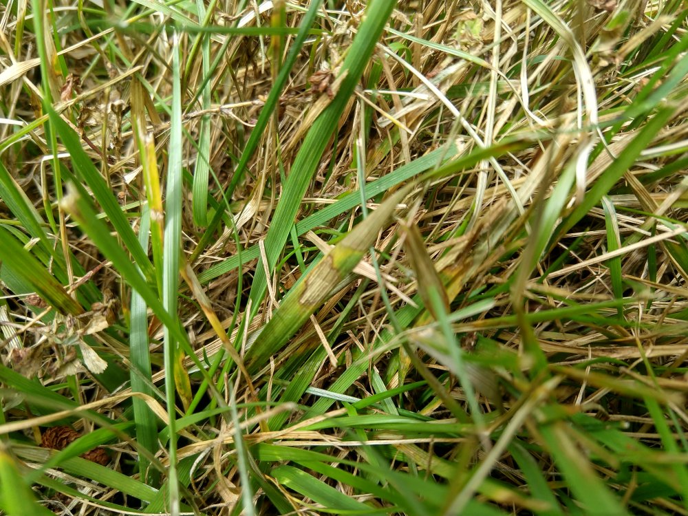

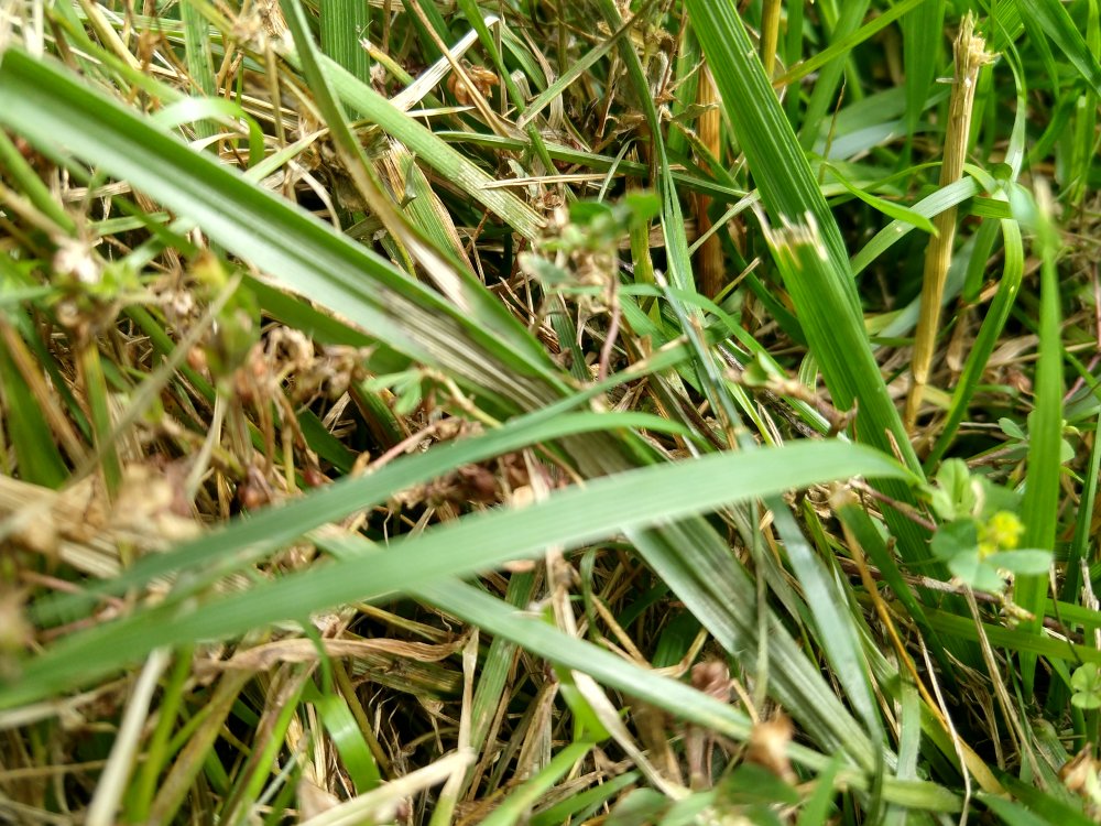

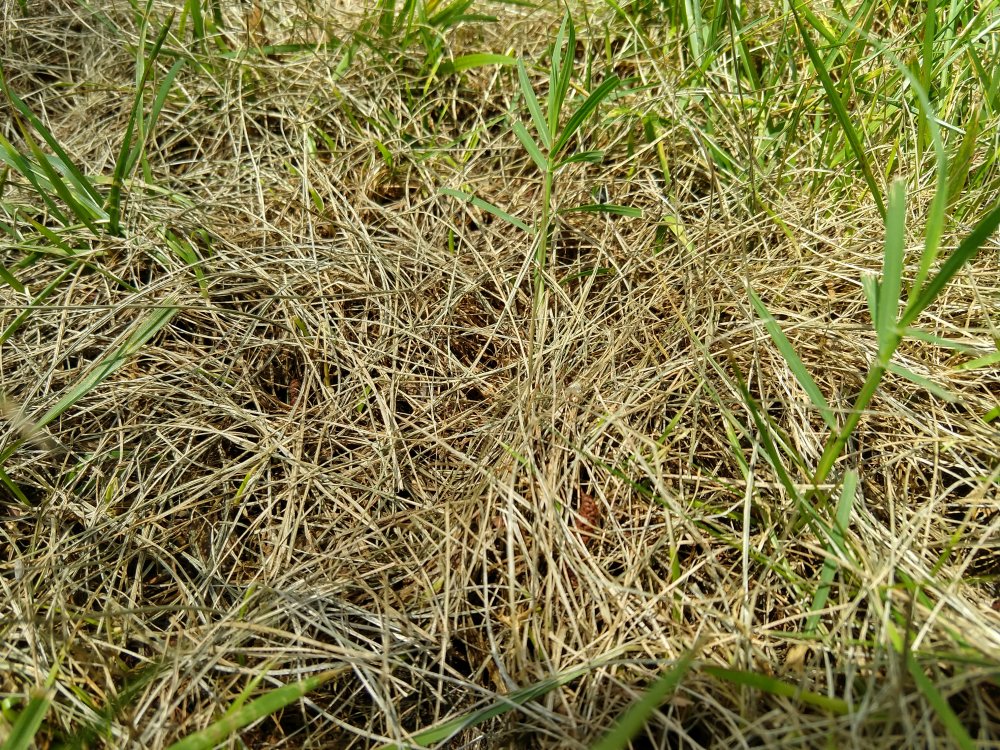

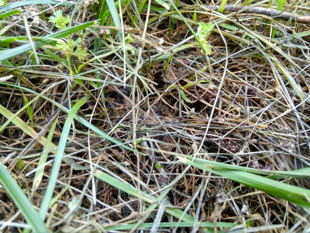

@guffey24 let me know if these work for you......the dark brown/black grass seems to have all turns to straw in the last day.

@guffey24 do you think these pics show some damping off? I agree about the dying off at the road is probably heat and gravel related. Developers and pavers do a great injustice by carelessly spilling gravel and asphalt into the future lawn areas. Also some of the yellowing spots in the yard could be some Poa Annua finally dying off. It's held on a long time this spring due to the cool and damp conditions.
@guffey24 this is about the best my cheapo phone can snap.
I am inclined to think it is low topsoil content around the mailbox, I spread 16 yards of topsoil last year, but it was mostly to fill ow spots and cover areas that had none, perhaps now I have moved onto the next weakest link?
What is the best way to go about putting down new soil without killing all the grass or watching it all wash down to the backyard (fall during over seeding?)

You may have some rust there but I'll defer to Guffey on disease ID. What you should check around mailbox and pavement is if there is a lot of gravel in the soil under whatever soil is there.

definitely showing some brown patch in those pictures, could be some other diseases, but weather has been pretty good for growing cool season grass thus far
what seed did you plant last fall?
Bought the blue tag (?) certified kentucky 31 from Agra Supply, can't remember the brand off hand.
any good solutions, is it isolated or will it spread?
it will spread with wet conditions and actually mowing when wet
easiest way for a person to treat that doesn’t have a skid type sprayer would be to put out a granular fungicide, I like Headway G, it can be bought at a professional store
it needs to be put out on wet turf, and let dry for at least 4 hours before rainfall or irrigation
