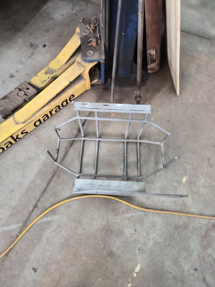

He used the forge to make some custom parts
View attachment 451958View attachment 451959
That is cool!
On that forge - you need to coat that “wool” with a layer of heat resistant cement/ceramic stuff. Supposedly that stuff can be bad to breathe, similar to asbestos. The forge is blowing on it and circulating little pieces for you to breathe in.
That is cool!
It was coated. But probably could use another coat

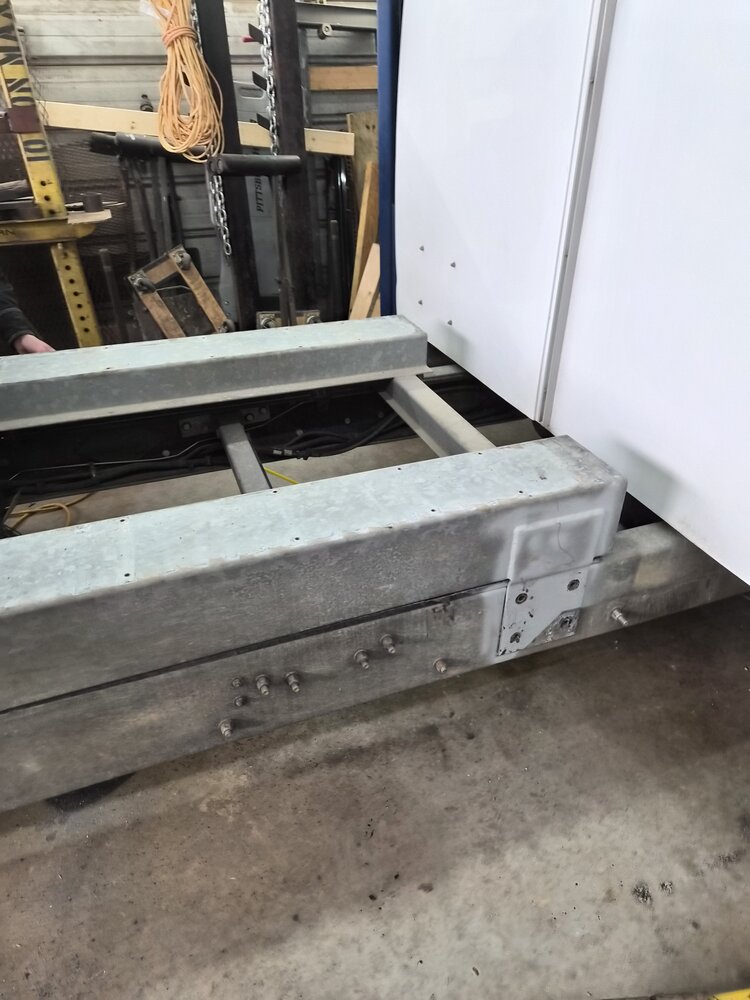

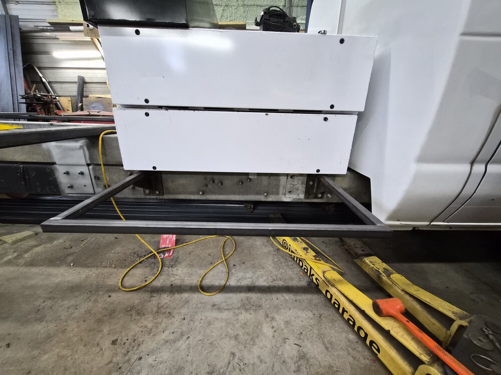

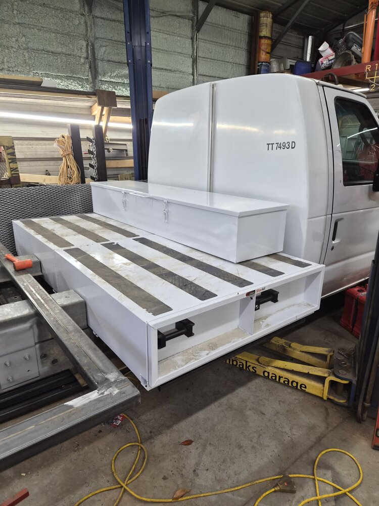

On that rear gate, why not just weld the square tube across the bottom instead of through, with all the cuts and whatnot?
No way to add springs to that gate so to avoid the complexity of the winch, power source, remote, etc at every job?
Just curious, as I would not have the patience for all that!
He did not want a spring. He liked the winch idea and he is stubborn so not worth the argument, I am betting he will change to springs some day :)
The gate has 2 sections. Section 1 is 6feet and section 2 is 3 feet. For a total.of 9 foot ramp, which would be to tall to drive around with
He made 2 more gates that drop down so you can load from the side
He is thinking pallets, etc
