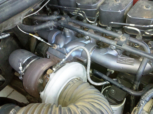

been a while since picworthy mods from the Lung
I've been getting antsy because I've not done any mods since installing some injectors last summer in an attempt to break 300whp on the stock turbo for the L&N dyno day, so I decided to try out a possible combo from my parts bin. PDI T4 manifold holding a non-gated s300 (66/74/.91) and a hand fab 4" downpipe (pain in the ass).

thats sick hurley. what size injectors did you put in? i know thats a laggy SOB, i know your light truck will run though!!
I'm running some 5x.014/+.010"/280Bar "Super Smokems" :D

I will say this, under normal driving conditions it builds 0-6psi taking off from a dead stop with a decent pace/grade - more or less like the stock turbo. 75mph cruising, 4psi. anytime i get into it without the TC locked it spools quick and WHAM 45psi. what it will NOT do is a 55mph pull with the TC locked.... chugalug to 65 or so then the boost needle will swing. If I do a 3rd gear roll from 50mph, yeeeehhaaawwwww
I really need to go 4k/20deg timing, but im worried about the headgasket (damn not having extra $$$)
