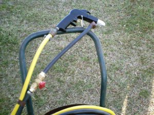

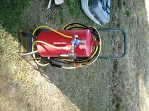

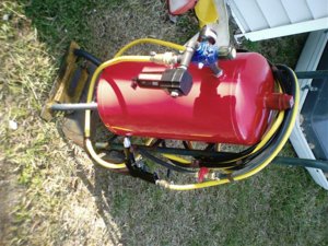

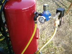

Here are some pics of the final product!
works awesome! I am putting a 1 1/2" ball valve in the coupling to make loading it easier. you can adjust the regulator betweem 7-12psi depending what media you are using. I put a valve in the sand line so when you are not blasting you can shut off the flow of sand.
