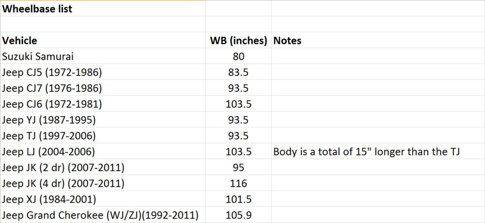

First of all, There is not such a thing as PERFECT wheelbase, or suspension. Every single rock and trail is different.
Longer arms in some fassion eqauls better ride qaulity, more stability, more useable flex.
Wheelbase lenght determines alot of ride qaulity and breakover angle and stability.
Your tj @CasterTroy is allready a billy goat, I dont see any critical drawbacks to longarms without stretch, as said it would be nice.
