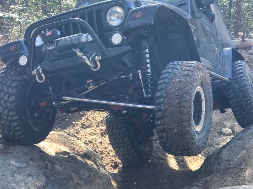

Chris is onto it here. If you go under and measure a >30" link and see how far it actually goes you can see how you will land your links on rocks constantly. Wranglers can set up links differently than XJs but "mid arms" provide a very reasonable upgrade. If you are going coil overs then sure have >30" link and use all that crazy droop to your advantage.

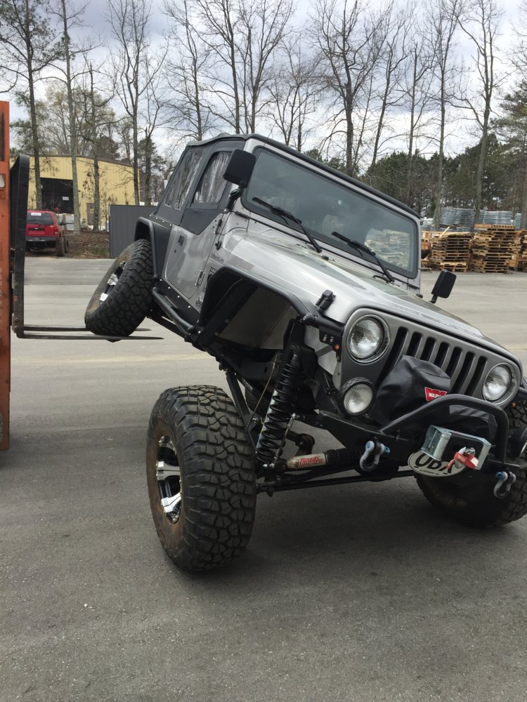

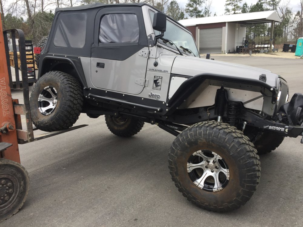

@CasterTroy in the picture of you crossed up in the swale in your front yard, isn't the extended spring loose in the bucket?

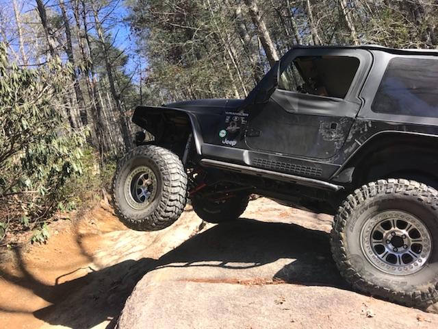

I'd be interested to see somebody do this with the Jeep on scales. How much weight is actually on that front right tire? There's probably some weight transfer due to the suspension geometry, but then? Maybe 200 or 300#?
I'd also consider making the front anti sway tighter. It looks like your rear tire can stuff another 2"-3".
Actually no. I have pictures somewhere in the office for record. I was testing the bump stops. Ordered longer ones and trimmed until the tire almost touched but to my surprise the springs never came loose.
See now Shawn is onto the real problem with long arms on a tj. You may have more flex but a weightless tire does you no good for traction.
