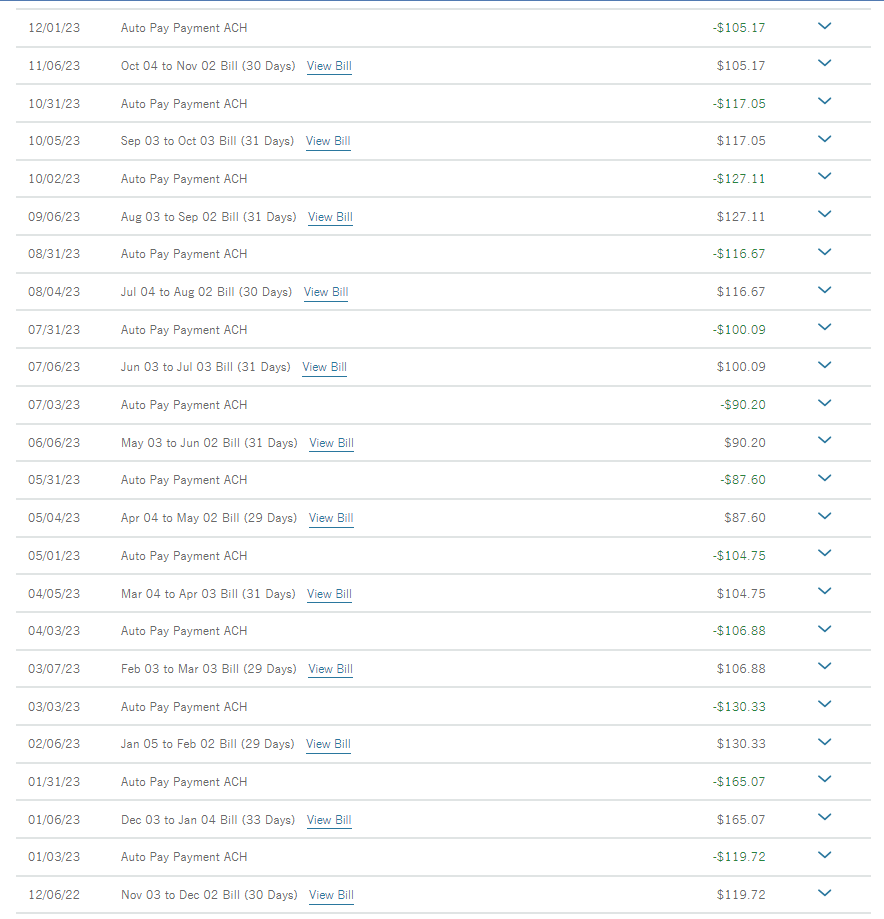

How long would it take for solar to breakeven, assuming there were no issues and no maintenance?
Here's a snapshot of my power bill for the past year. 100% electric, no gas, 4 people in a 2500sqft+1500sqft basement house.
Average of about $115/month. $20k breakeven is 14.5 years. Will I even be in this house in 15 years? Whats the life expectancy of the batteries in the solar energy system? How much maintenance is required? Etc.
I'm not anti-solar either, I just don't think it's all it's cracked up to be. I seriously considered it 5 years ago when we built our house, and the math didn't make sense.
Damn man do y’all even use power? Lol 😂 mines about 1500sq and we’re usually 160 range worst is 225. But the wife does like her heat. Plus the shop is a separate meter at a minimum of 26 I think
