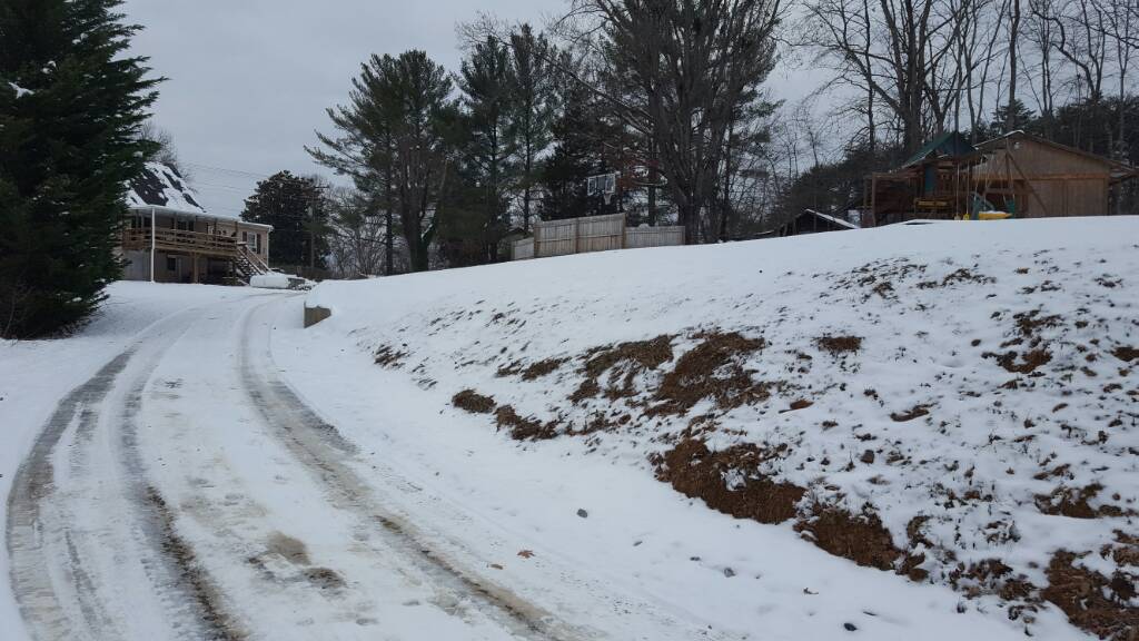

Yea but his trailer is still here. I have had some difficult times getting my cage trailer out of here in the past. And these photos are today, I scraped the driveway after the snow quit wth my skid steer...just have him meet you at the road. Thatll give you a chance to hot lap around the parking lot some. You know you want to

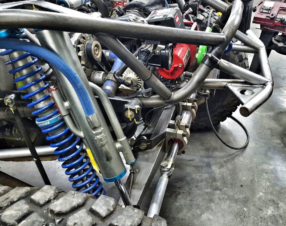

Why even build the links like this? Why not just put the centerline of the shock eye below the centerline of the link and be done? With as much $$$ as the bomber and other cars are, I just don't see why they (or anyone else) designs links and shock mounts like this.

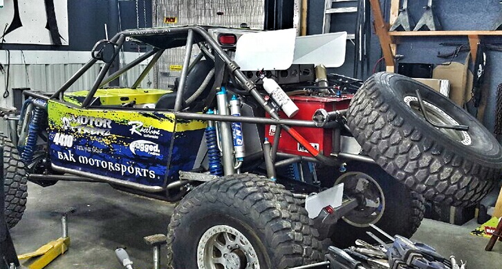

I dont how that ram stays protected, unless I'm missing something.Cutler Fabrication is providing some serious baby making music. Front end is getting buttoned up, new idler pulley, serp belt, bumper repaired, and one or two small surprises to be revealed later this week.
It has been discussed briefly. But ironically, there are very few scars above the center of the diff. Zero nicks in the cylinder or shafts.I dont how that ram stays protected, unless I'm missing something.
Makes some sense. Law of averages i guess. I feel like during racing at some point you're going to hit a rock just right to kill it, but maybe not.It has been discussed briefly. But ironically, there are very few scars above the center of the diff. Zero nicks in the cylinder or shafts.

Edit: the tie rod ends are about 1.5" above the upper uniball of the knuckle.
