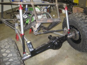

are the joints in the airshocks going to allow enought movement side to side as the axle flexs? Just something i was looking at while i was getting ideas for my build.....still need to start though

I flexedt out w/o the tires on it and it seems to be OK on the shocks, Fully flexed I could still turn the end of the shocks, they didn't seem to be in a bind, I'll check it out more though.

Gotta change a few small things on the rear, make some spacers, etc, but I think the rear suspension is pretty much done (aside from bumpstops). Have a lathe at my dad's house now so I'll be able to make spacers and such, as well as drill/tap any links that need to be done.

FINALLY I have some updates, got the tubework shown done in the past two days (hoop back was already done, and the very bottom tube)
Still have to cut/adjust the upper shock mounts, weld on link mounts on the axle, and put in alot of brace tubes, but it's starting to look like a buggy now at least...
