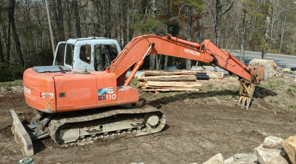

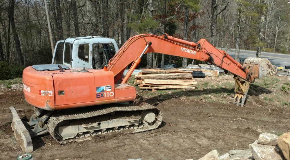

I got my new one. Ended up trading my bobcat t650 for it, the guy delivered it too. He had rigged the starter switch (it was sticking) by adding a starter button. He said the bad switch cost him a starter and a set of batteries. Well lucky me the cheap starter button hung and fried the starter again.
So $22 for a new switch (eBay) and $202 for a new starter (eBay) and I should be good to go, still waiting on the starter. Switch was $120 and starter was $1800 from James River equipment....

Traded my t650 bobcat for it that I had bought on auction. Was a good deal for me but ended up costing me more $$ in the end to get a replacement for the t650. All good though, the foot controls on the bobcat absolutely killed my knees, so now I have pilot controls, A/C, and hi-flow hydraulics...

What's the deal with heavy equipment starters being so expensive? I thought $1500 for my dozer starter was crazy. $1800?!?!
Yea I knew when I called it would be outrageous. Was mainly calling to get the part number (which the parts guy offered without me asking). He told me I better be sitting down before he gave me the price and recommended getting the one I had rebuilt.
The starter for it is apparently the same one used on about a gazillion other things (all with different part numbers of course).

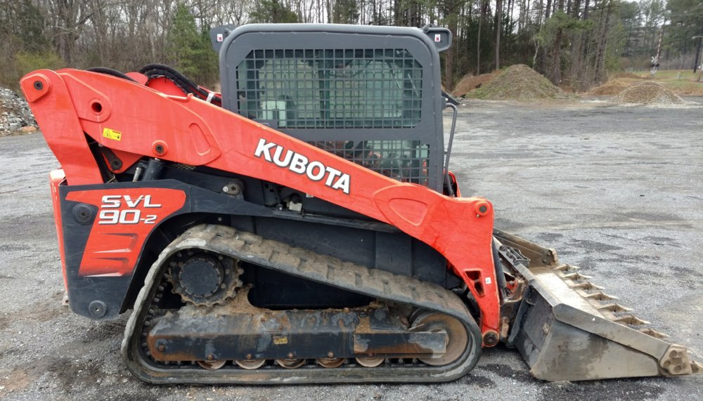

My Kubota has scuffs here and there but nothing major, no rust (well, no more than one would expect). Even the ~2002 Hitachi that has who knows how many hours (meter doesn't work) doesn't have rust on it and no need for paint.

Yea it stinks spending time and money to fix something you haven't even used. I have spent probably 400-500 on the Kubota for all new fluids and filters (even the hydraulic filters in the tank). But I at least know everything is new now.
The excavator I still need to change the motor oil, and fix some leaks. It has one hydraulic leak that shouldn't be hard to fix, the pump head leaks the lube oil, but it might be one of those things that isn't worth fixing, just keep it full. Gotta pressure wash it and see where the leak is.
