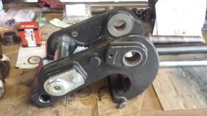

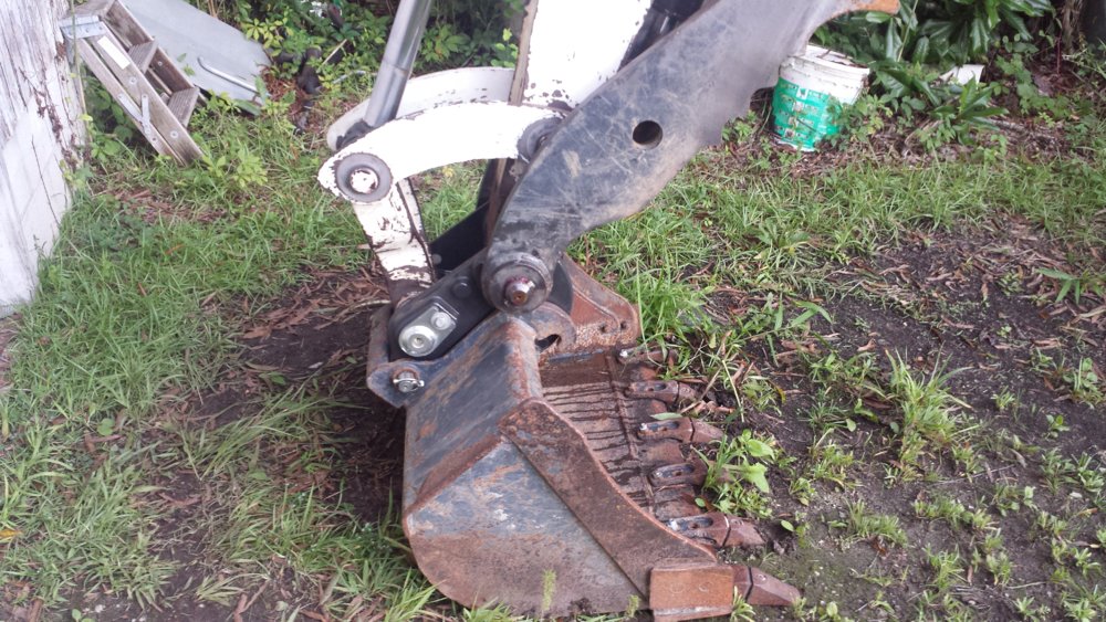

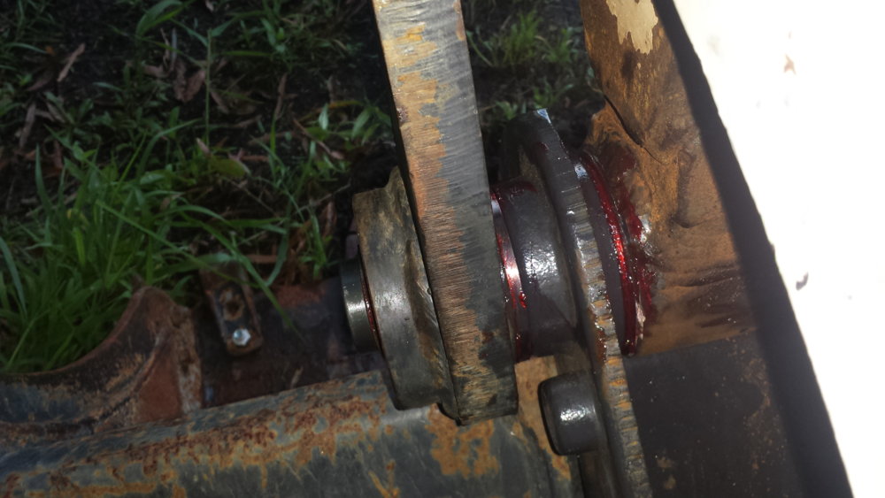

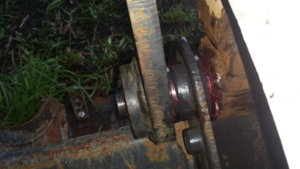

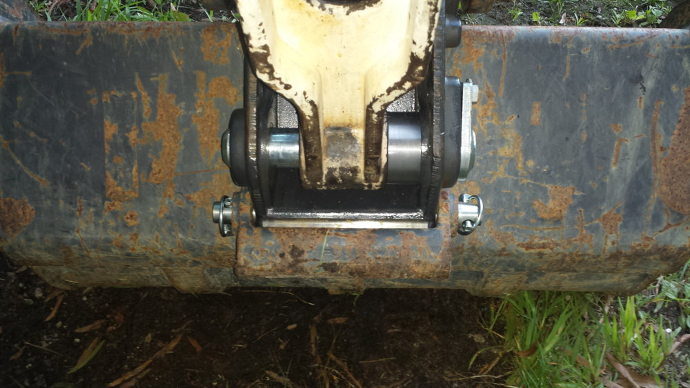

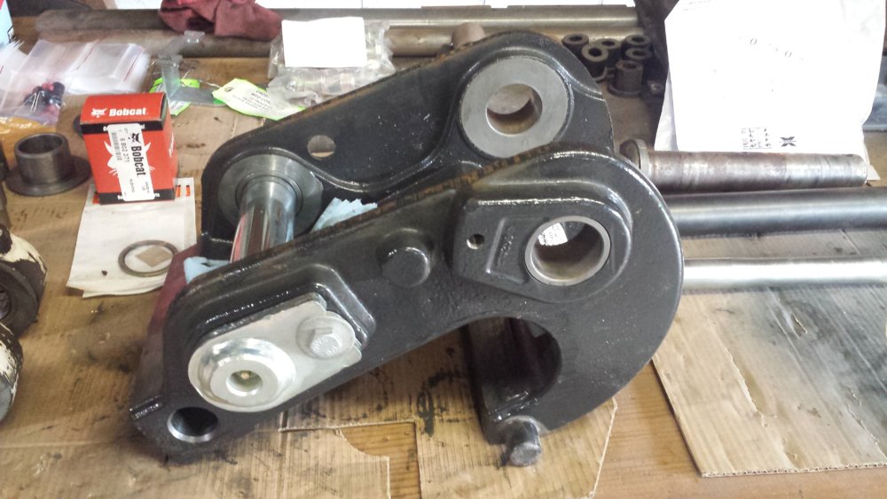

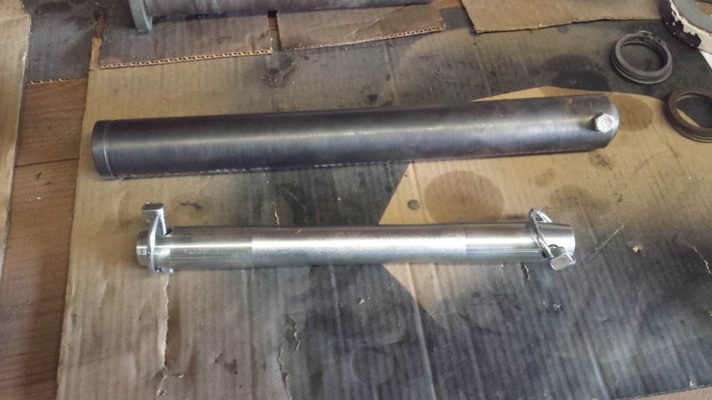

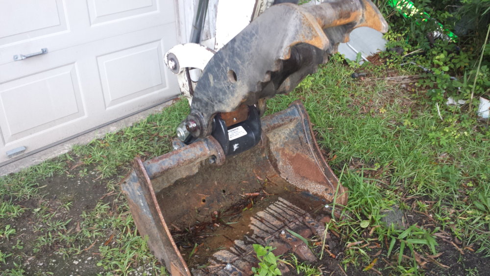

The top pin is the one I made. It's 4130 that's heat treated. It's in the high 40s on the Rockwell C. Not the ideal material, but the price couldn't be beat!

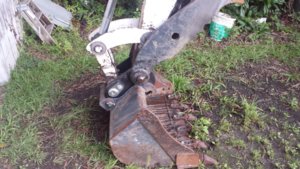

The only measuring device I had that would measure 10" was a tape. I had to make four spacer/washers in this area, but them bitches fit like a glove. Two of them are .218 thick and the other two are .343 thick. The much thicker ones are 1.320. Everything worked out surprisingly well!

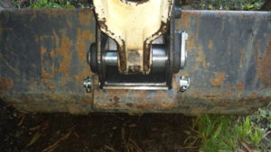

I made another spacer to go on that left side. The original coupler had a latch around that dog bone and these make up that difference.

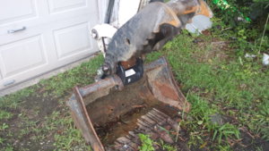

That three foot bucket looks massive...my old two footer needs a new coupler welded on to fit the pin-on style x-change coupler, but I'll get around to that eventually.

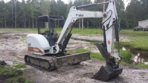

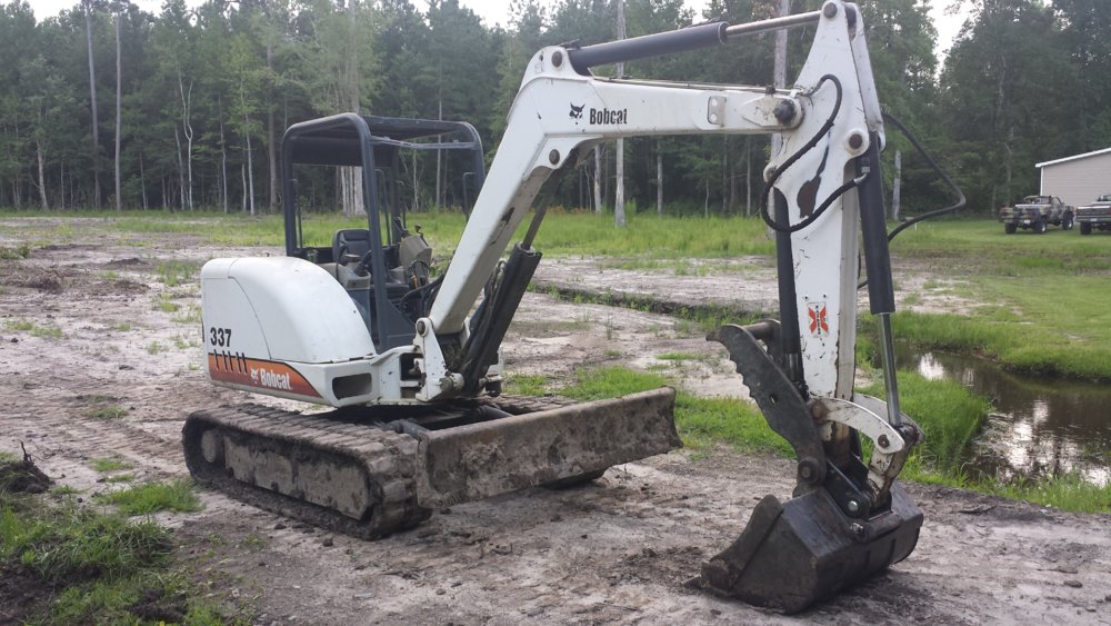

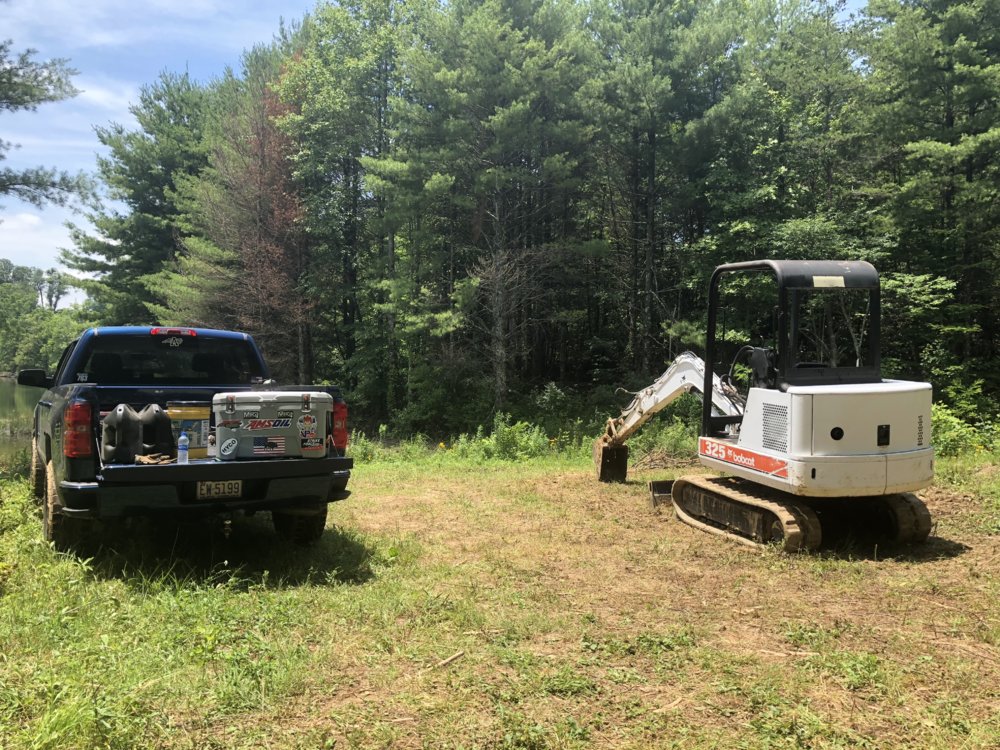

Repair help question for you guys? Bobcat 325 Mini X pictured above. Today, the boom cylinder (closest to cab) decided to shoot the cylinder seal out. It’s dry rotted something fierce. Got all the lines unhooked from the cylinder and retainer bolts out of the pins but the pins won’t budge. Any tips of tricks? Usually we can just drive them out with a sledge and punch on most of the equipment but this one is being a bastard.
I assume you got the weight and pressure off the cylinder. How worn are the pins? Could they be grooved from wear? If you can get a bite on them, try rotating them 90 degrees.
My thumb cylinder is the same way. I also need to pull the bucket curl cylinder, the eye on the end of the rod is worn out and the bushing slides right through it.
Got the upper one out this afternoon after some more time with the hammer. Lower one wouldn’t budge so it’s soaking in some penetrating oil. No way to get a bite on them. Just hammer and punch. Of course they’re the only two pins on the whole machine that don’t move freely :lol:

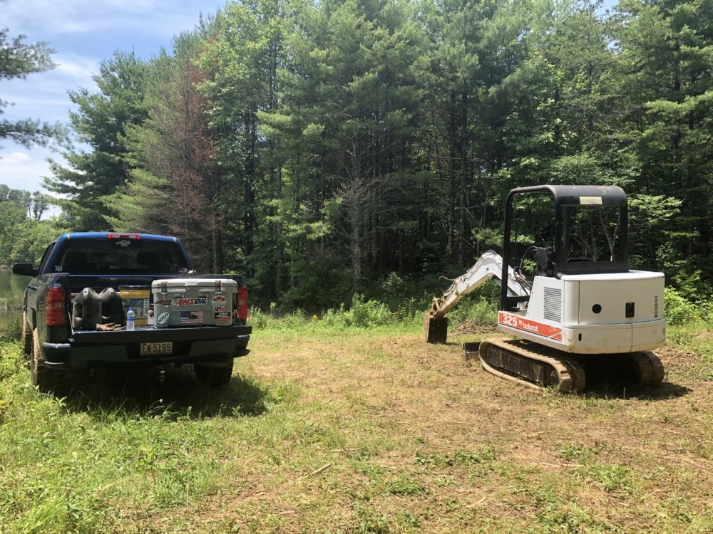

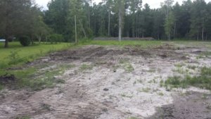

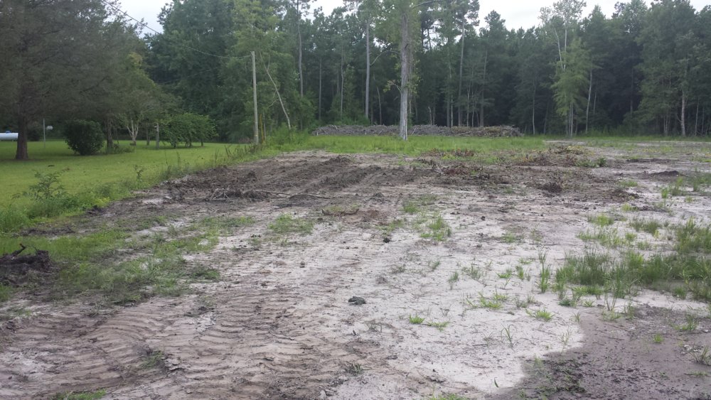

Since the weather in eastern NC is more indecisive than a woman when you ask her where she wants to eat....I said screw it and went and got my excavator and finished getting rid of the few smalls trees I was taking out. It never did rain today :rolleyes:

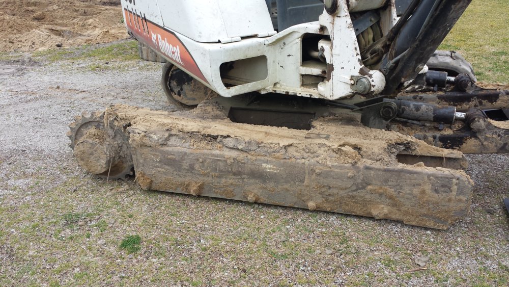

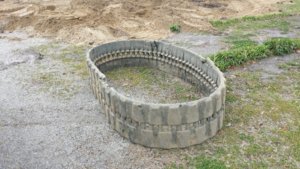

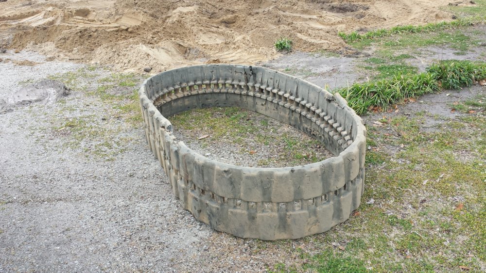

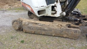

I split a track and it rolled off. The tracks are toast and I'm due for an undercarriage rebuild. I'll need two tracks, two idlers, two sprockets, and 10 bottom rollers. The tracks are the originals along with all of the undercarriage, aside from one of the front idlers. They're 18 years old and have 4100 hrs on them. I don't think they owe anyone anything.
Does anybody know of a good place I can get all this stuff from? I've been looking at Pentom Supply because they have an awesome website, but I feel like I can probably do a little bit better than 5600 bucks...
Here's pics because everybody likes pictures.
What about that final drive company? I can't remember the name right off but I think it's "final drive something another" they were The Cheapest on rebuilt final drives, I would think they would sell the idlers and stuff too.
Can you pm me part numbers? I might be able to help.
The track is split, so it won't stay on. I also haven't found another one that was anywhere close to the price I paid for this one.
