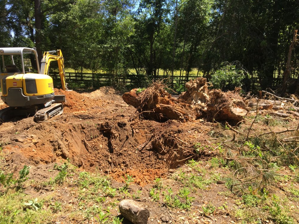

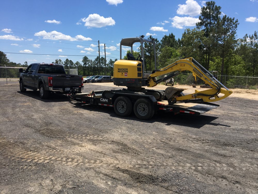

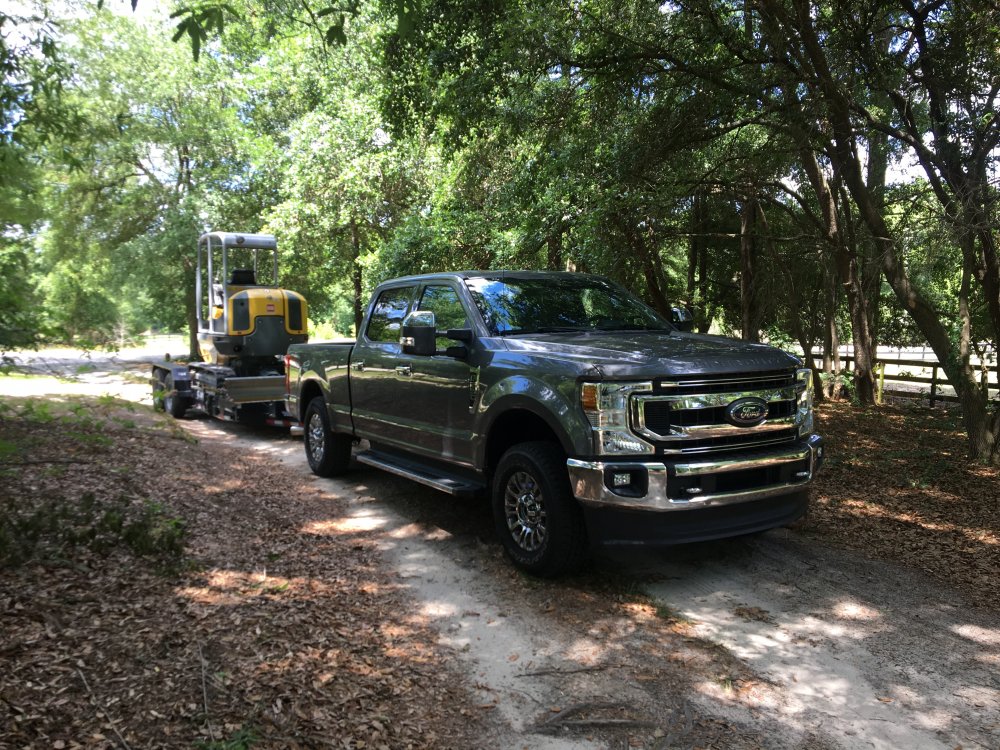

Got her picked up. Started working on the stumps. Was getting disheartened when things started working.

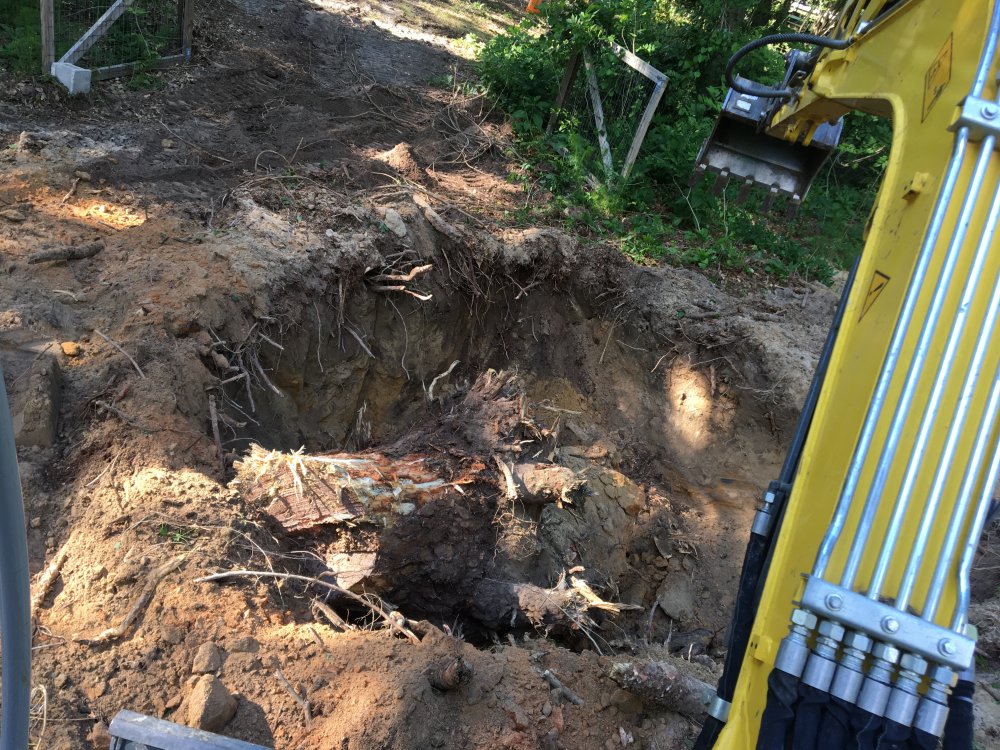

This is a decent machine but not enough ass for these stumps. I had to actually break some of the roots with the teeth. Curling under them stalled it. I think I have the idea now for what to do with these things...
I got to where I could get 2-3 foot diameter pine stumps out in about 20-30 minutes. It seems like that was just about all anybody ever wanted me to do was dig stumps!

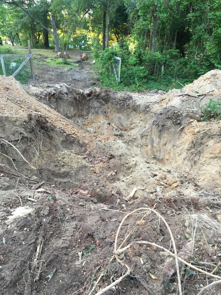

Also, fill in as you go, so that you can drive over and pack down the holes every chance you get. Keep your work area as reasonably clean and organized as you can while you're working, and it will pay dividends later.

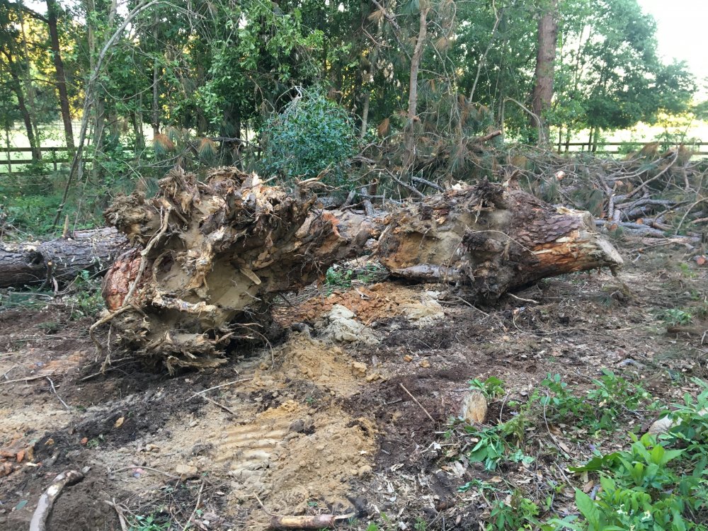

Thanks @jeepinmatt I actually tried to use the dirt from stump two to fill hole from stump one. I’m pretty impressed I got two up already and only use 3 hours of time. Especially for a guy that has used one of these things once before.

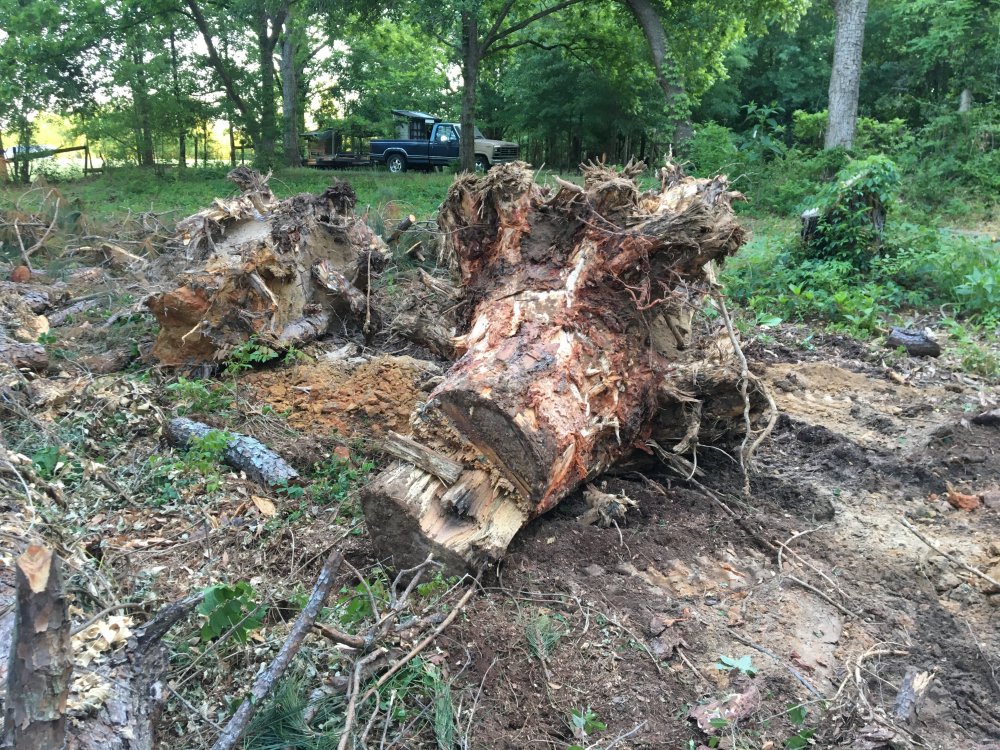

Stump three is out. Lunch with the wife and @XJsavage then we burn.
Knock as much dirt as possible off of the stumps before burning. I have no sage advice on methodology as it's a total pain in the ass no matter what, and you can't get nearly as much off as you'd like.
Get what off of them you can by rolling them over. I'd tell you to pick them up and drop them, but you can't with no thumb. The teeth will do decent with digging dirt out too. I'd probably let them dry out for a bit before I tried to burn them...unless you have lots of used motor oil :D
