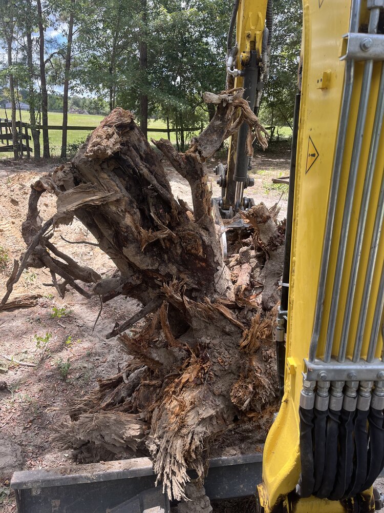

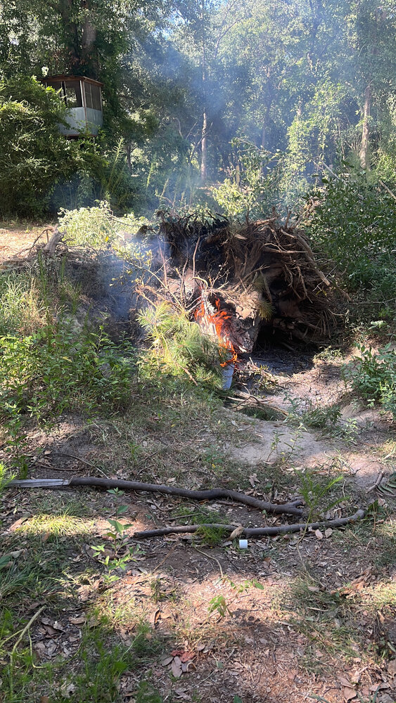

Dead pine is out.
I love the smell of a good lighter knot stump...I hate ground bees though and they seem to love pines.

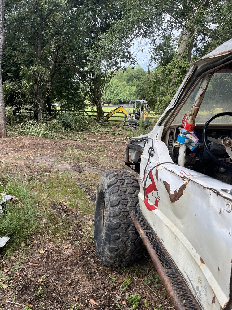

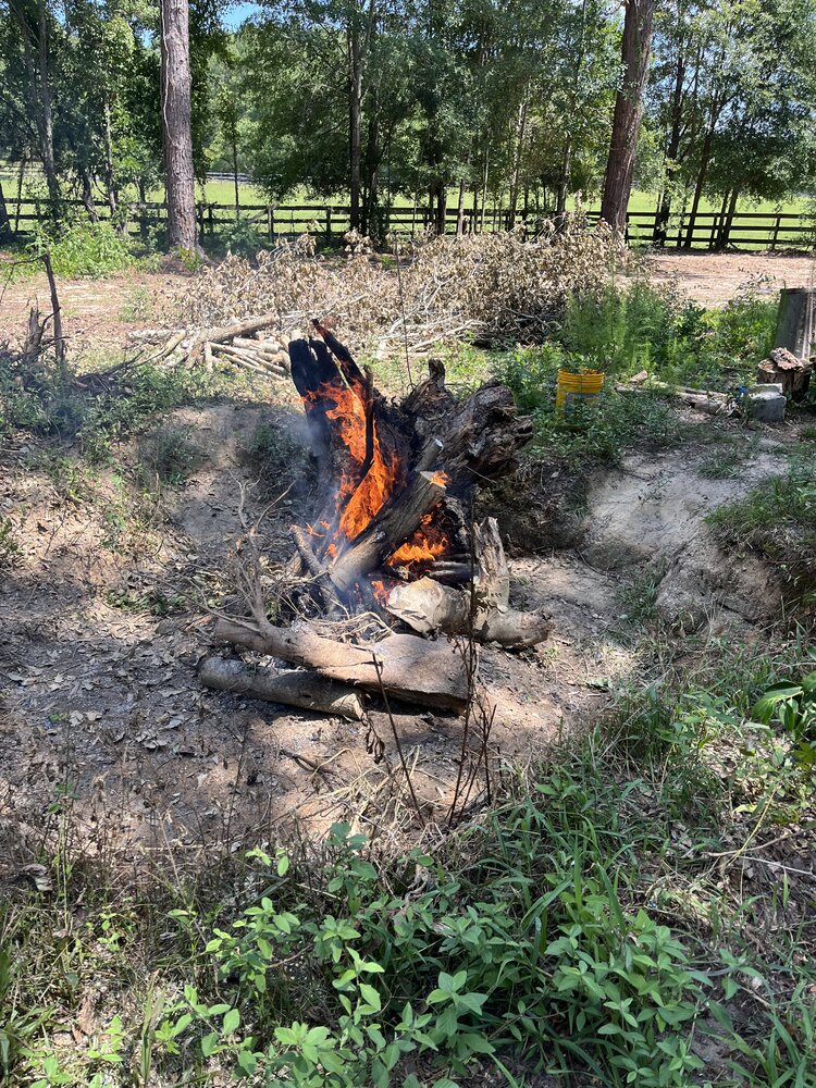

Been burning the first stump since Friday night. Made some good progress. Dropped the pine stump in yesterday. Removed some privit along the fence line too. I’m still under 8 hours. Amazing what I can get done with one of these. It’s an EZ - 38 which is a 9k lb machine. It’s the biggest this place rents. I wish it had a 4 way blade. I can’t grade for shit with it.

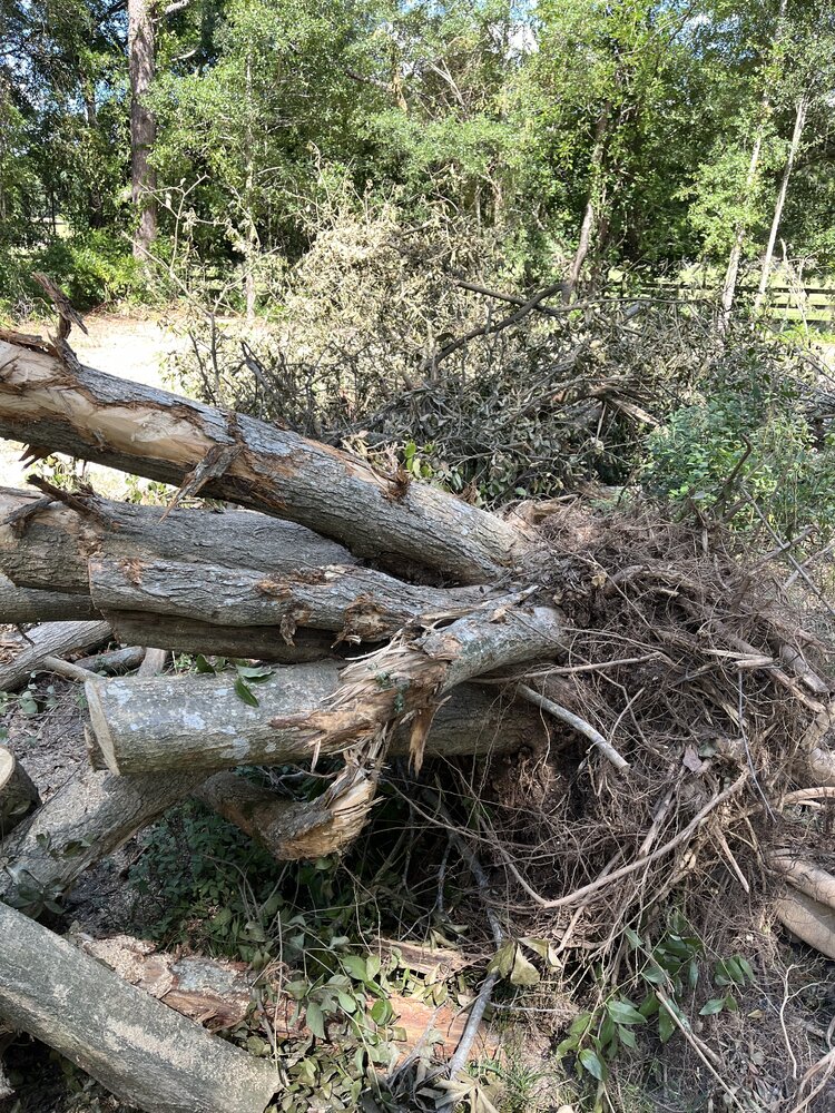

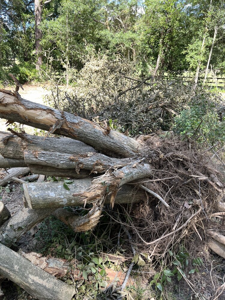

It’s been fun and a learning experience. I’ve got a couple piles of privit and the oaks and maples I took out to burn. Nothing bigger than 6” across. There are some things here I am going to have to call in help with.

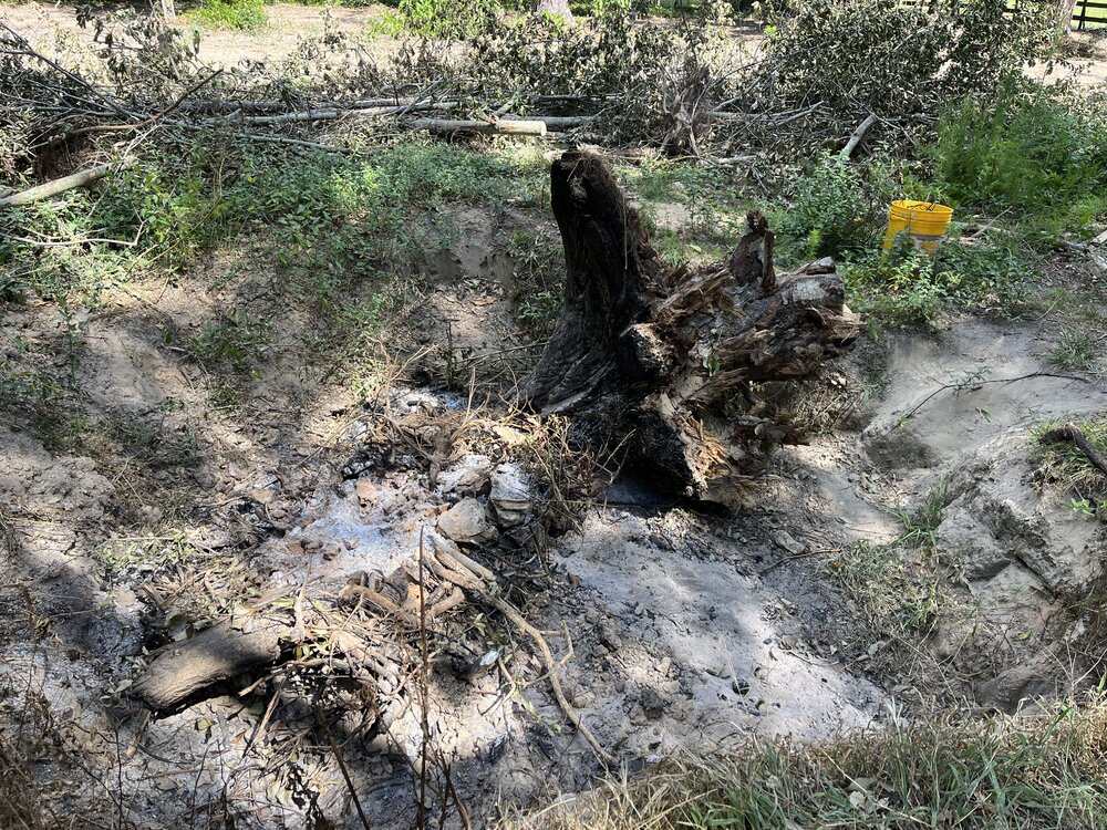

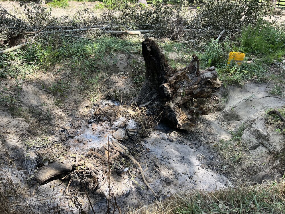

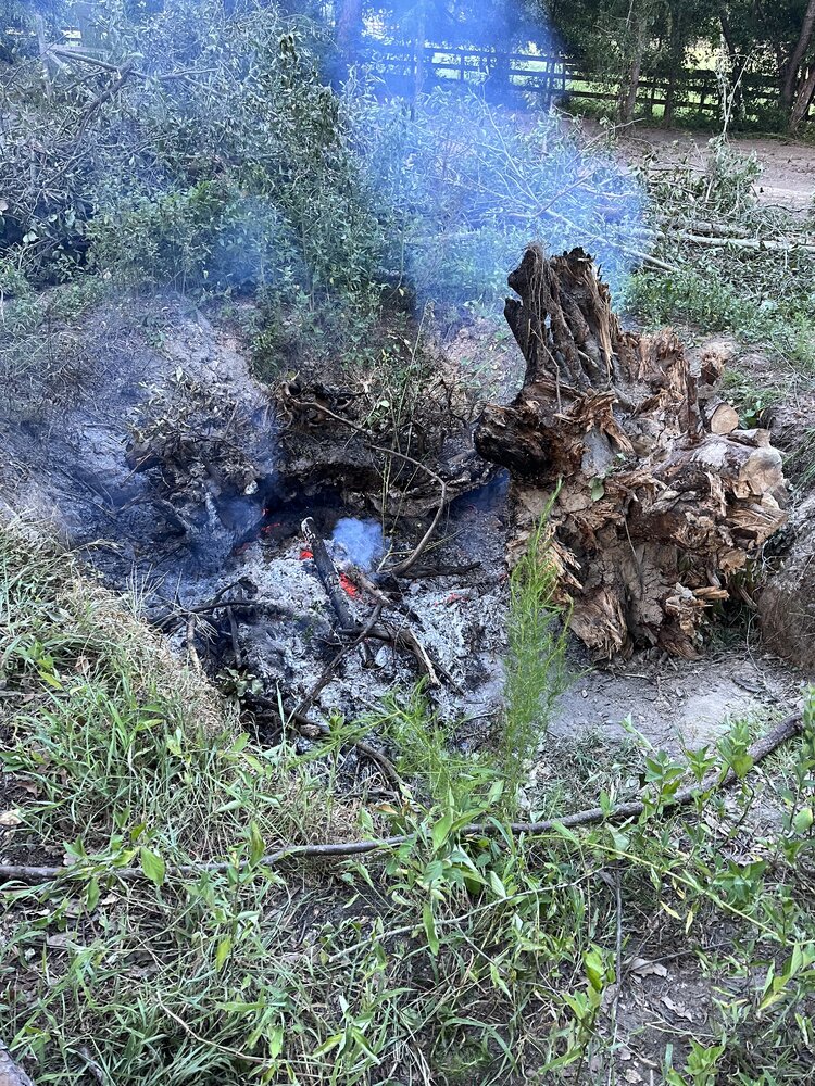

So the big stump is basically gone. Pine is mostly still there. I’ve got this big privit cluster to drag in the Pitt now.
I have had good results with buying a bag or two of charcoal for grilling, piling it all over the stump and let it slow burn it.
Good time to get rid of used motor oil/any petroleum product.
Not that I'd ever do that or anything.
And I'd certainly not get it rolling with a leaf blower to really get it burning.
No...never :D

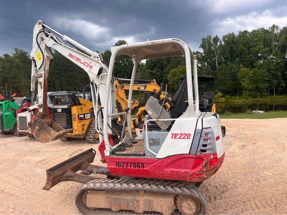

Thanks for that info on the bucket. I didn't think about the smaller one having more force. I have looked at a few machines on line that are in the 7K - 8K area and they aren't super expensive. I put 10K as a top end. I know I don't want anything bigger. This one caught my eye. I'd add a thumb of course.
2008 Takeuchi Mini Excavator tb228​
$23,900
Very clean Only 1912 hours 2 speed Quick coupler Aux hydraulics Very Good tracks Add hydraulic thumb for $1750 We offer all types of financing We deliver nationwide Blue Best Equipment Sales.

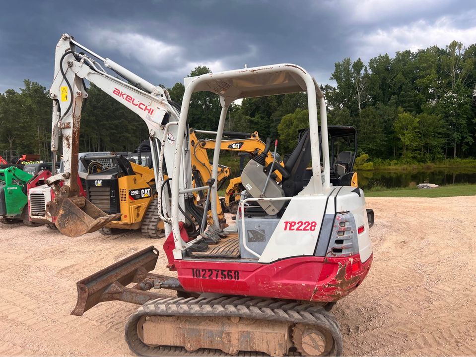

$23,900
I think you’ll be unhappy with a 228 (2.8 ton). Not enough weight, reach, or power. For what they are asking, once you add the thumb and tax, you could probably end up with a TB135 with hydraulic thumb, quick coupler, 12” & 18” buckets, a known history, and new tracks. ;)
For real, I’d say a minimum 35 series machine.
