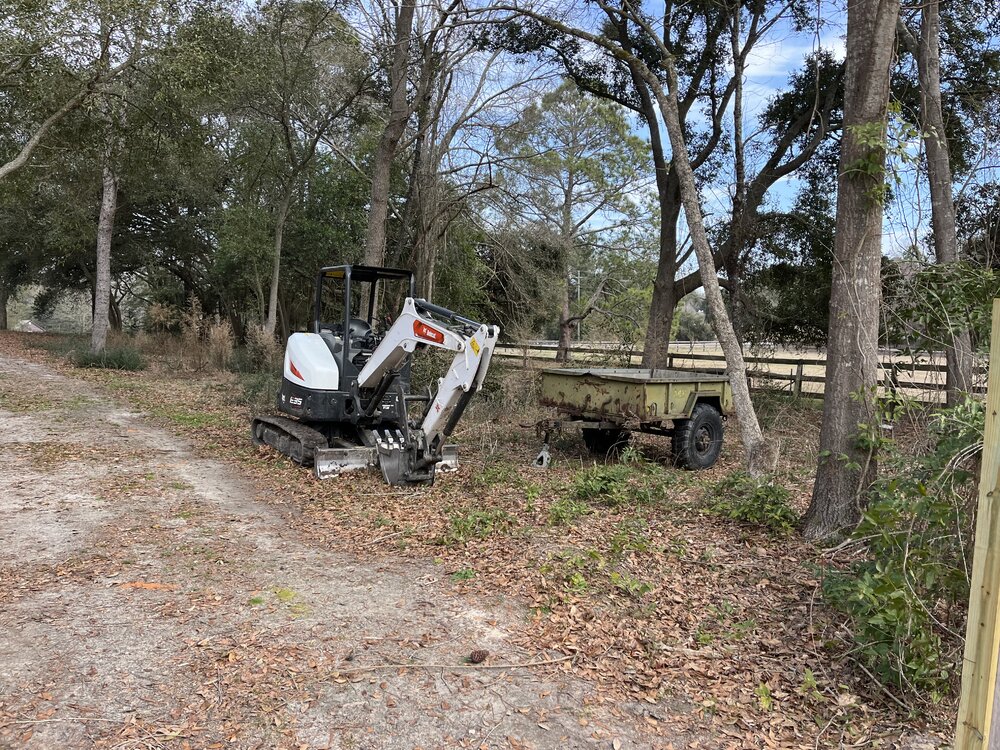

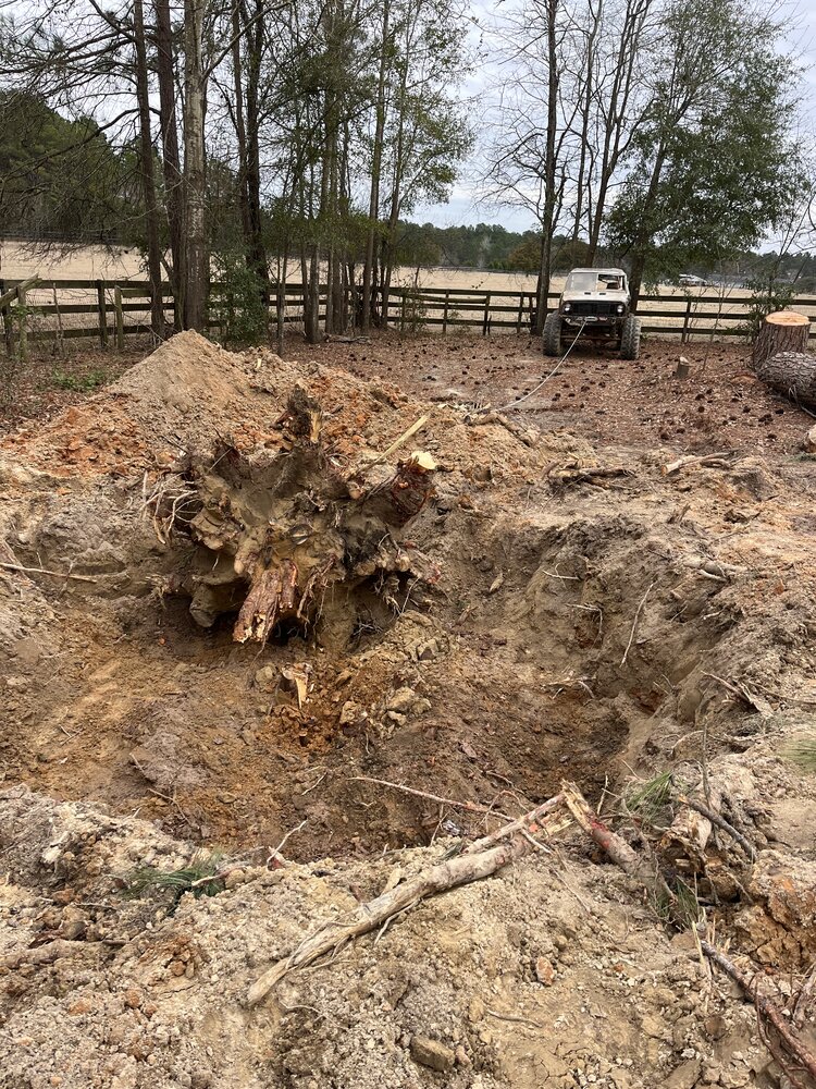

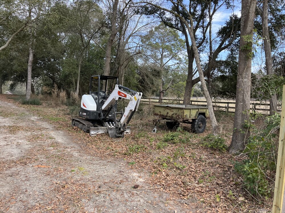

So this past weekend I made an attempt to get the last 2 pine stumps out of the ground. I found out a local rental place rents Bobcat’s for $325 with a trailer. E35 I believe So I decided to give that brand a try.
Welp didn’t go too good. I unloaded and ripped out a privit I missed behind me in this picture. I then pushed over an oak. Maybe 6” across. Now it was time to dig. She dug well but I could tell it was a weaker and smaller machine than one I had rented before. About 2 - 3 hours in and a lot of dirt moved from around the stump and all the outward roots cut with the bucket and thumb it would wiggle a little. I started working on removing dirt around the base as best I could and exposing the “tap roots.” Welp I noticed a spray of fluid from the main boom cylinder. I shut it down and hopped off. I should have taken a picture but didn’t. Somehow the main boom cylinder got bent. Only thing I can come up with was when digging close to the stump I played it on one of the big ass roots. So called them up and returned the machine. So I had to buy a cylinder. No proof it was bent when I picked it up and they said they checked it out. So $732 lesson learned. They did say since I didn’t have it long I could get it another day.

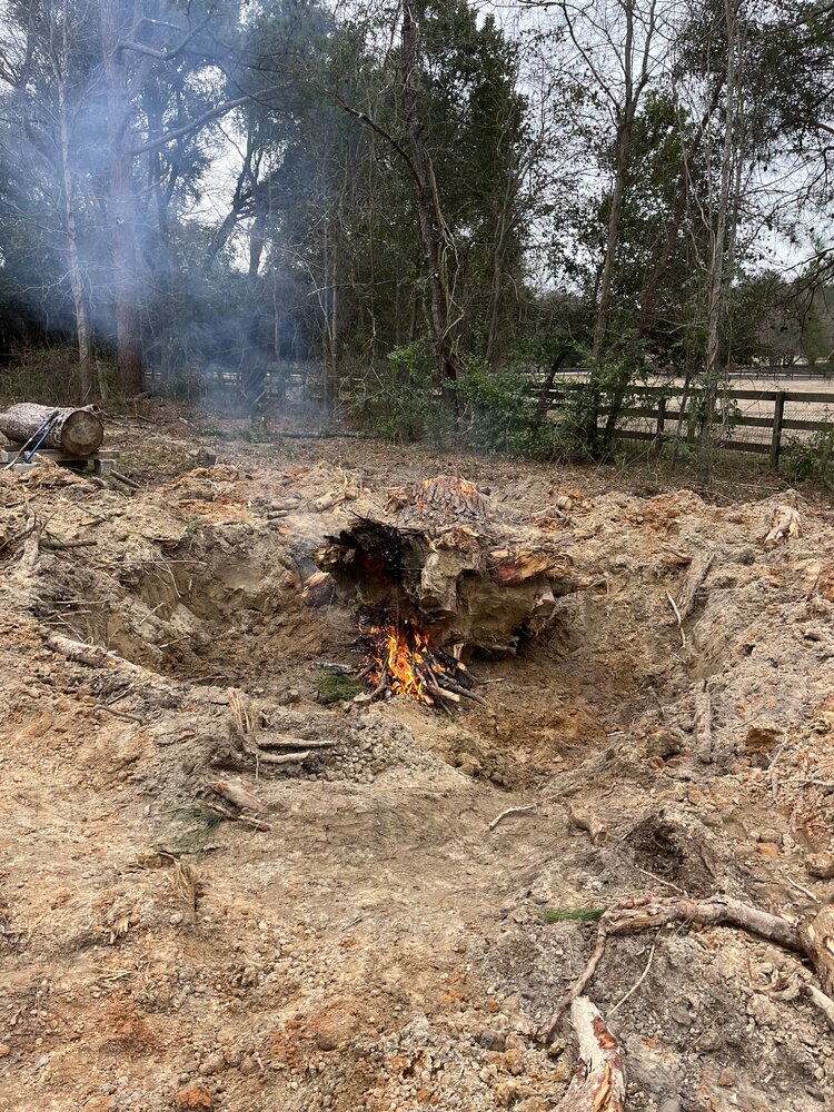

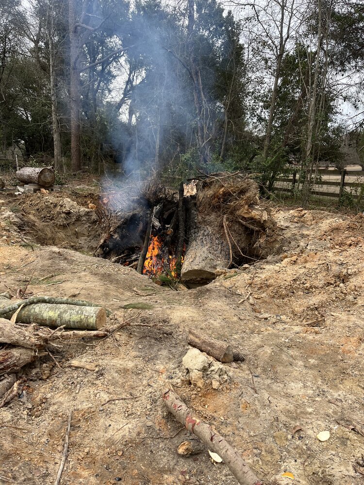

When I got back home I felt pretty damn dumb and very defeated. So I ate lunch grabbed a couple shovels and a sawzall. Hooked the jeep winch and proceeded to get that damn thing ready for fire. Yep I jumped in the hole and stared working on that damn stump. Took most of the afternoon but I won!
That's a great price on the rental, but sucks that the machine sucks and the cylinder bent. If they only charged you $732 for parts/labor/materials on a main cylinder, they did you a solid. I'd have guessed more like $1500-2000 for that repair.
Yes. He just charged me the part. It was an expensive lesson but now I know to be aware when reaching over/beside the stump trying to get to the tap roots. I plan to collect on their claim to get it again just not for these big stumps.

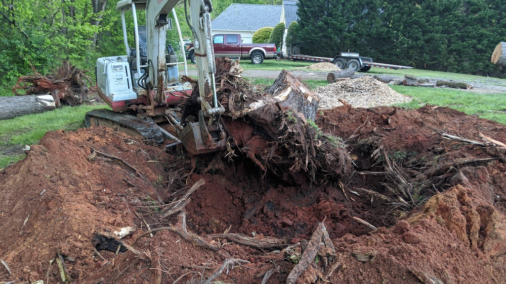

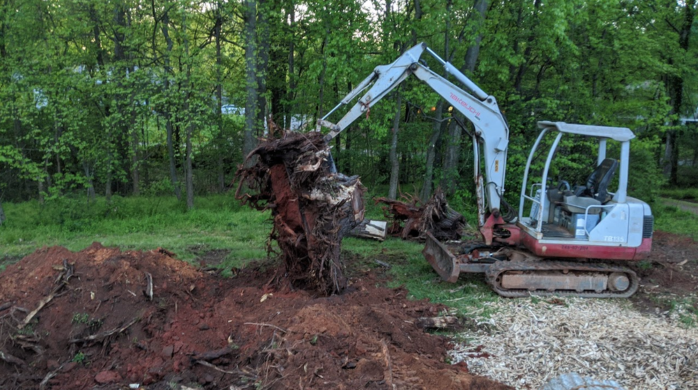

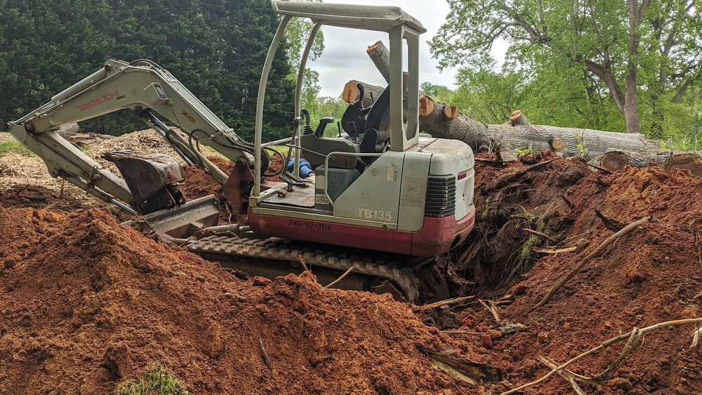

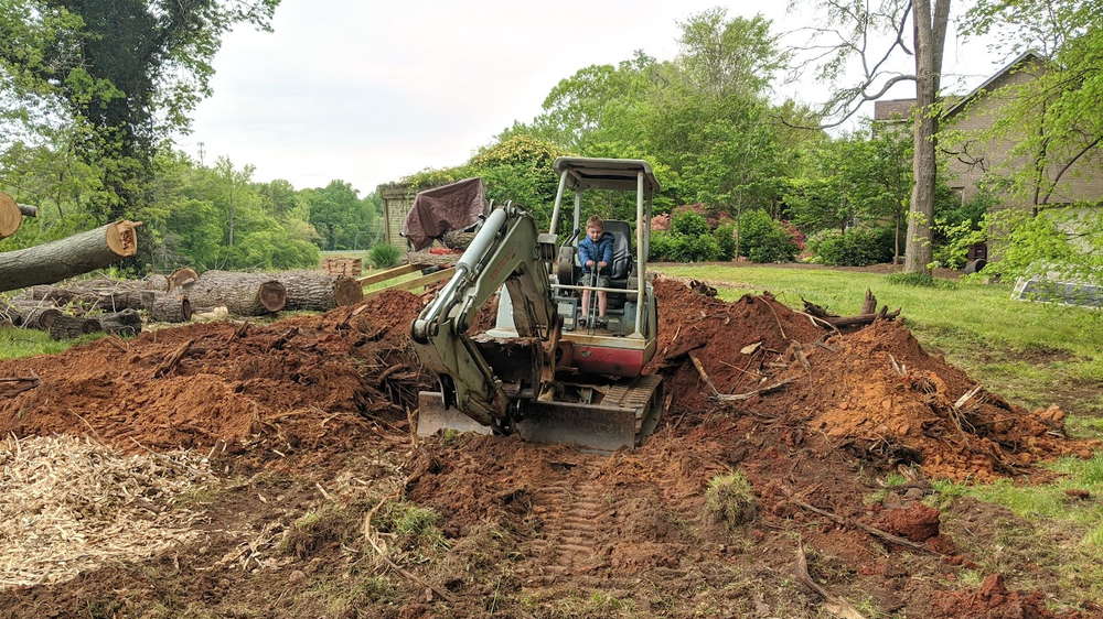

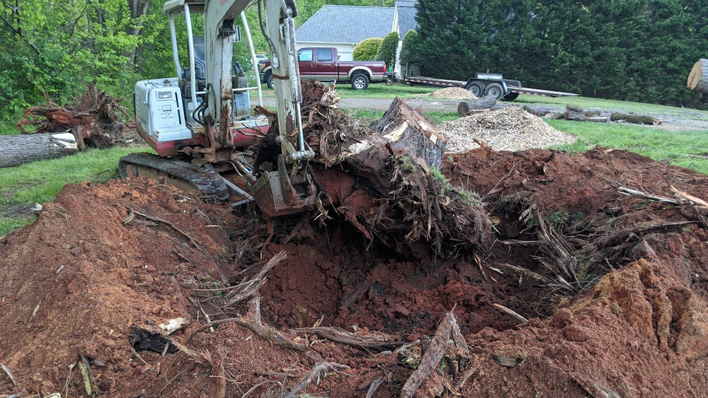

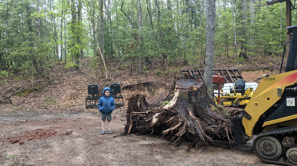

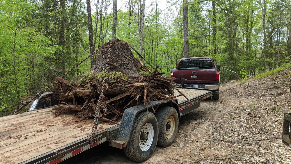

Yeah, not sure it was enough machine for those puppies. But sometimes you have to dig an excavator sized hole to get the stump out due to the root structure:
Basically all anyone ever seemed to want me to do was dig stumps. Depending on the ground, I could get medium sized pine stumps out in 30-45 minutes with the old 337 I had. The key is to just keep digging down and around them. I've had a few that were 8 to 9 feet deep. Then I'd pull them out or break them off. That tap root is going to go down until it hits solid clay, usually.

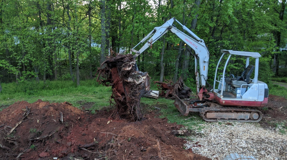

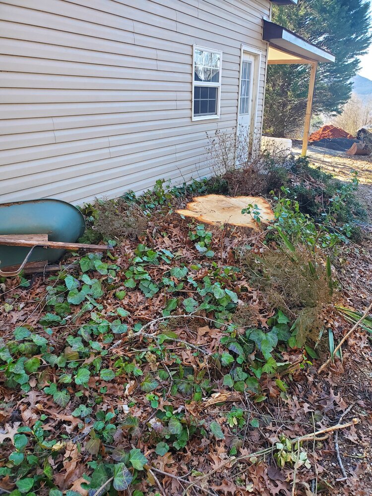

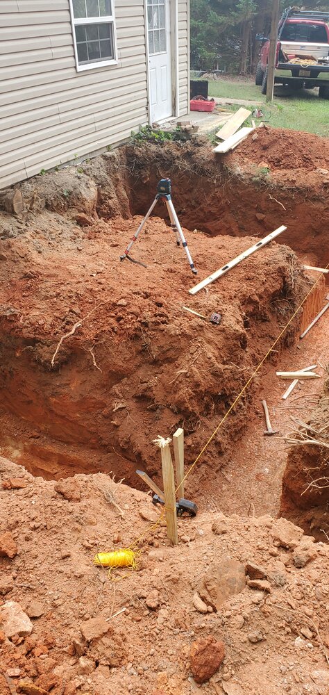

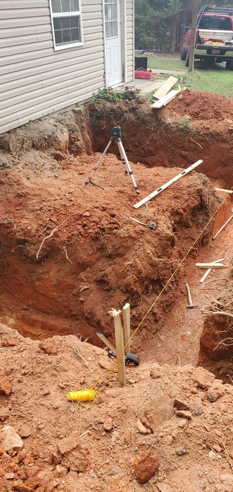

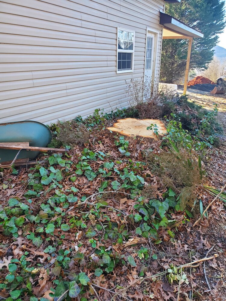

Or a foundation sized hole. Uncle dug this one out for me with his 35G. 12x16 about 4 1/2 feet deep. Probably wouldn't have been so deep but obviously couldn't get all the way around it to loosen it up.

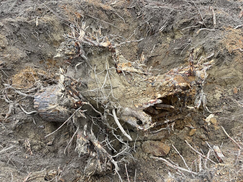

Yes I was digging around it trying to loosen the dirt under roots that went out. This particular one had some big ones. The bucket and thumb had trouble breaking them and ripping them out of the ground. I've got a 10K machine for this weekend. I really want that last stump out of the ground. With thumb and trailer it's supposed to be $475. It will be a Wacker Neuson from the other company I have rented from before. Thinking back on it I picked that Bobcat up around 9 am and had taken out a privit, a small oak and dug 4 - 5 feet around that stump broke it and had it back to the rental company by 12. I bet I only did about an hour hour half of work with it.
