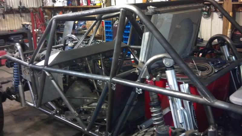

Did some sheet metal this afternoon...

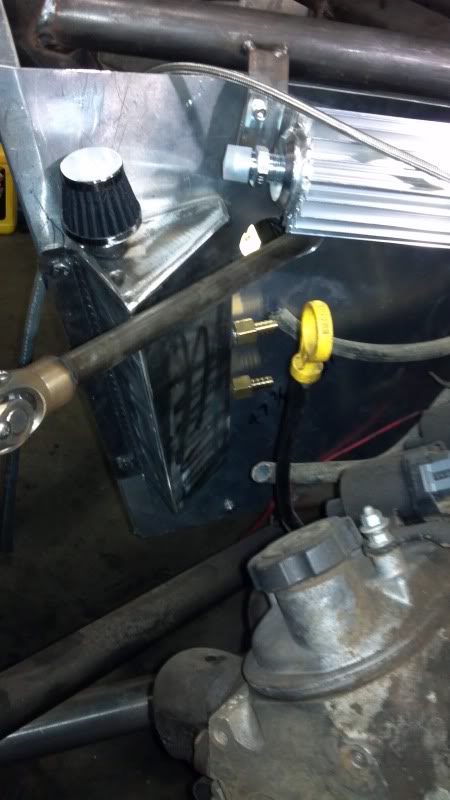

It'll get some stainless mesh in front of the radiator. Might cut out a bit more behind the seats but there's not much to be gained as it's right behind the head rest...

For the peace of mind it gives to the cooling system I don't mind having my rear view blocked.
I did use a backup camera and screen on the last one though. I'm sure Sam will one-up me with a BlueRay player in his along with the reverse camera.

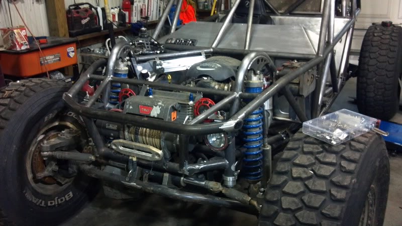

Started workin on the skins tonight....whether Sam likes it or not.
Really it's waiting on a new Accessory bracket from WOD to clock them up a little further. Right now the alternator hits one of the plugs on the throttle body. Lights are mounted up front and some other little small stuff is done.

Most of the small stuff done. Banged out alot in the last week or so. Finally getting a fire under my ass to have this done. Shooting for mid april but not holding my breathe.
Need to finish exhaust, rear basket mounts, and finish coolant hose routing and it should be ready for powder.

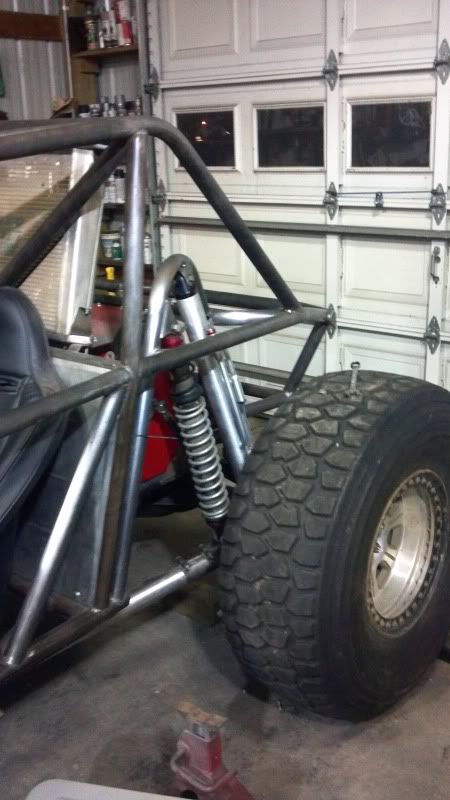

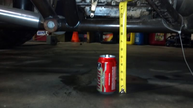

She sits pretty low at full bump.
