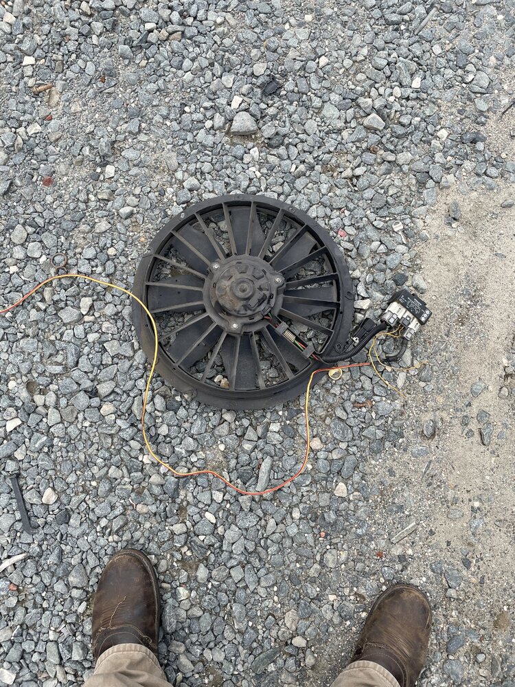

Junk yard score $30

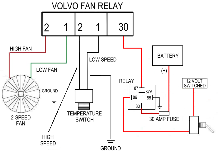

Power is constant, high and low are ground trigger, typically done by temp sensors. However I’d like to run it low triggered by the key, high triggered by a toggle switch. Simple enough I reckon. Instead I can wire the low constant ground, run my current fan wiring to 30 on the diagram since it’s already fused, with an HD relay and will provide power and will come on at whatever temp I tell the EFI to, which will be 100* for now. And I’ll ground the high relay to a toggle
That sounds like a complicated plan.
Wire the volvo fan source to battery with a fuse (or not, the fan isn't fused in the volvo cars).
Wire the low speed ground trigger to your EFI.
Wire the high speed ground trigger to the switch.
Removes a relay from the equation.
Also, I don't know what wiring you have in it now, but the volvo fan will draw a lot of amps at start up.

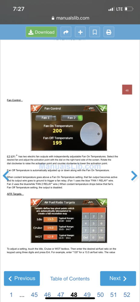

I believe the fan trigger from my EFI is constant ground with positive switches but I will find out.
Usually Fast EFI is ground trigger.
The last one I wired was like that at least.
Excellent. That means I can use it to trigger high and low, no toggle needed
IDK how you're gonna trigger high and low with the ECU?
IIRC there is only 1 fan output.
I have options in my setting for fan 1 and fan 2. Just gotta find the wire for #2
This will be easier than I thought! Now my ECU will automatically control high and low.

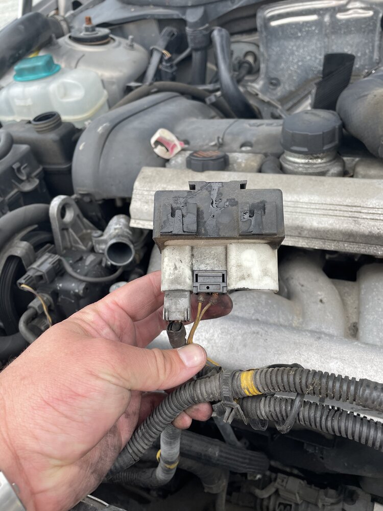

What Volvo are we looking for to acquire this fan?
Any of the mid to late 90s Volvos. Gotta have the relay and plugs too. Best to pull as much wire as possible since it’s already sized properly. The relay is ground switched and what controls high and low.

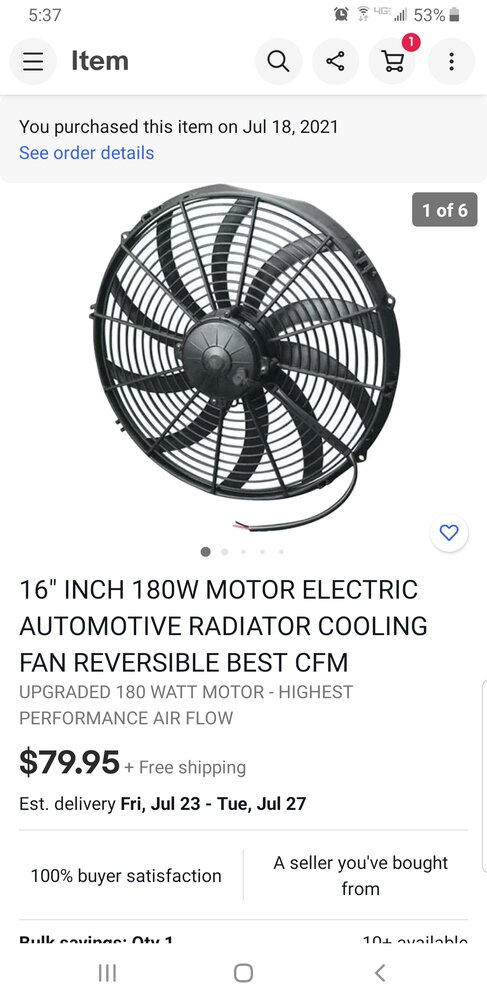

just thought I'd give an update for what it's worth!! this fan so far is bad ass!! It pulls some freaking air, def gotta be pulling over 3K cfm. Just thought I'd share the product review so far!! that's all
3k CFM under what backpressure?
Fan CFM is expressed under a certain type of resistance. Just like an air compressor output is expressed under a certain pressure.
Saying a fan is 3k CFM without the back pressure info doesn't mean anything.
Also, the ebay description says the motor is 180W which is very small for a big 16" fan.
