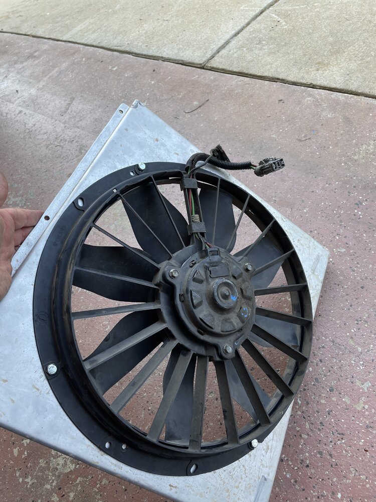

@77GreenMachine get us back on track w/ the install of the Volvo fan

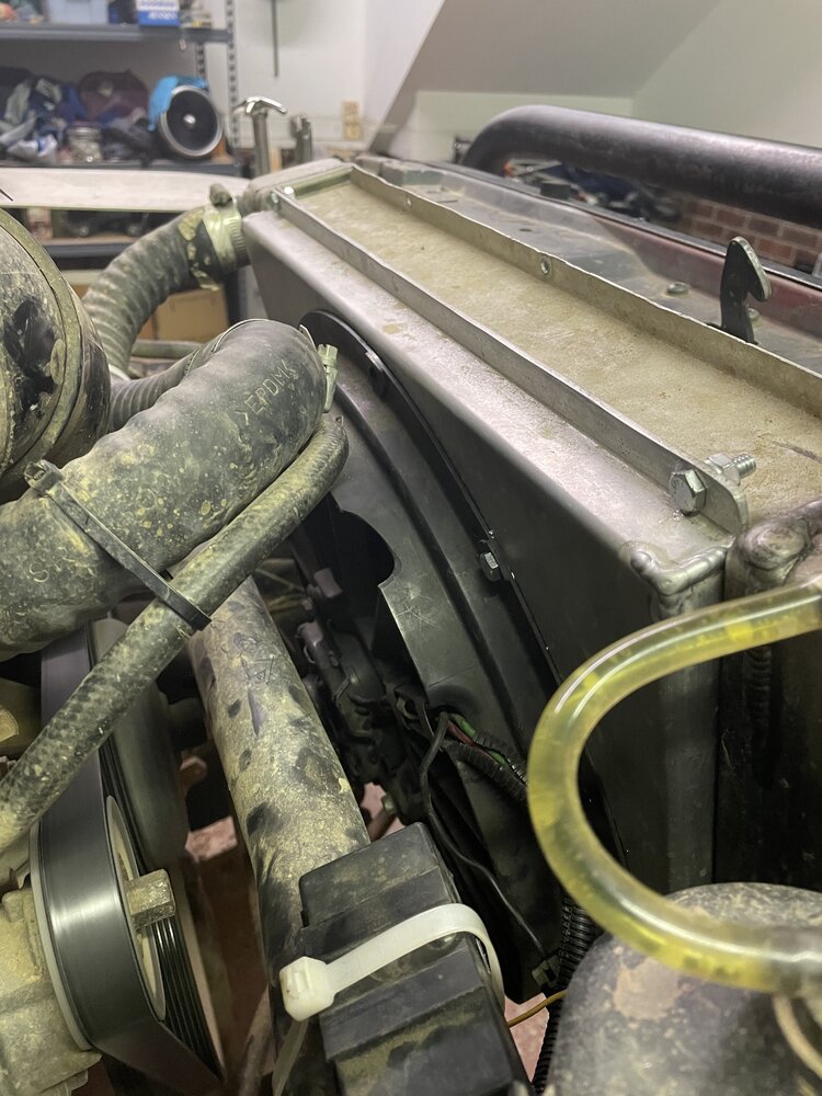

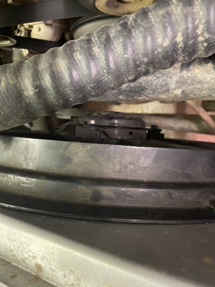

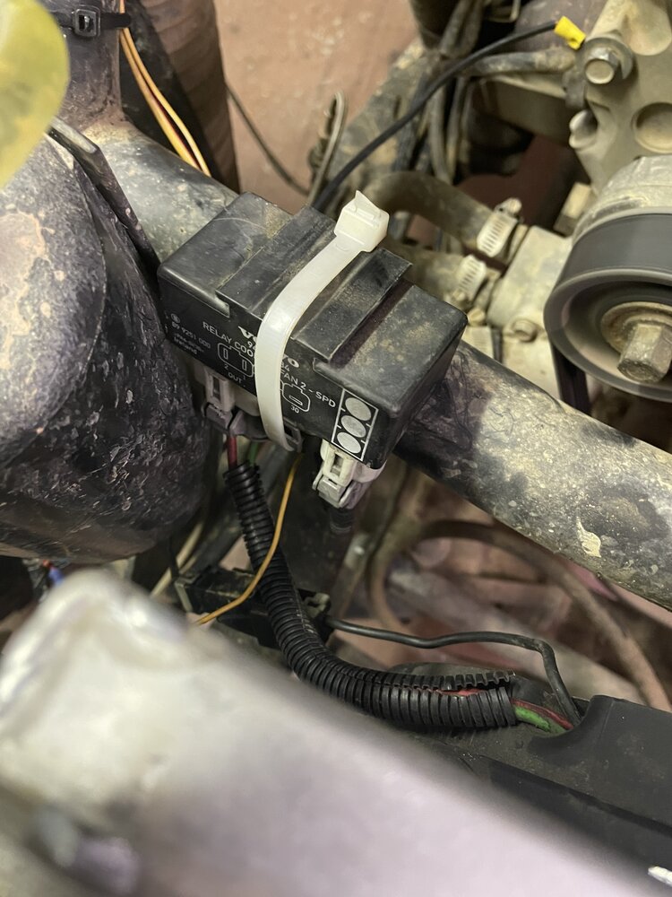

It is bolted in and installed. Took me a while to find the wire from the ECU for fan relay #2. I have fan #1 wired to low and it works as it should. I just never finished Saturday and didn’t touch it yesterday. It’ll take a few minutes to hook up the high side to #2, I’ll mount the relay with some zip ties since I forgot the relay mount at the junkyard. Then set it to come on at 200 or 205.
Initially I’ll set it much lower just to confirm it comes on like it should, like low at 160 and high at 175. Once I confirm the computer is commanding everything correctly I’ll bump it up like above and then do some test driving.
I did test out low and it came on at 180 and brought it down to 175 very quickly so I’m already feeling better about it.

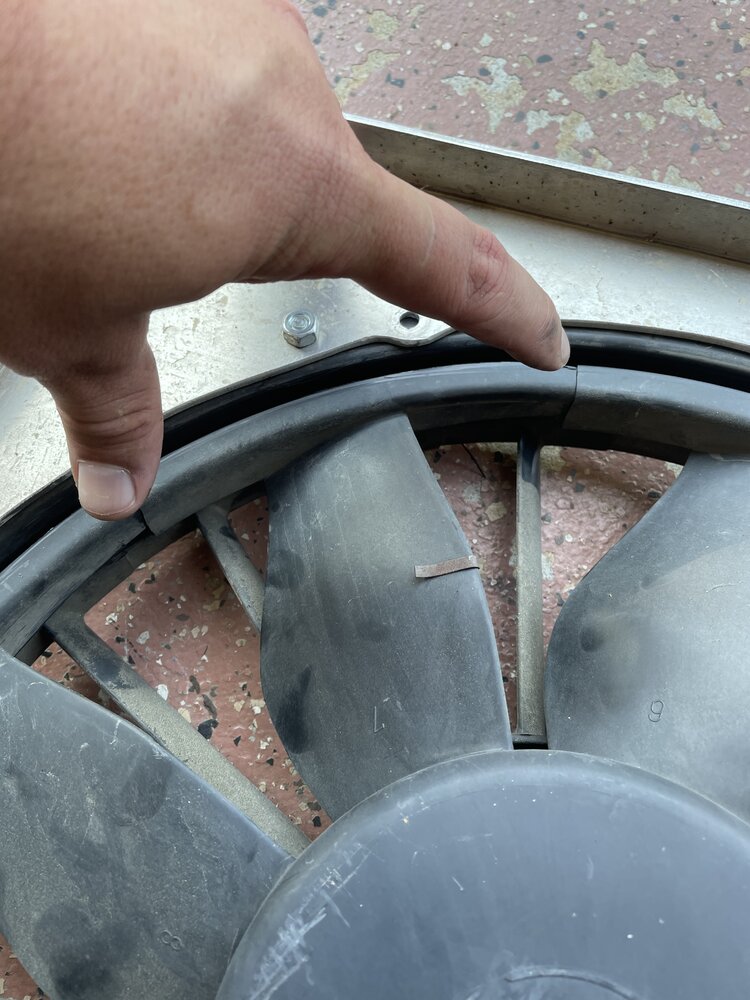

Got the fan done. The computer controls it correctly but the fan is cracked in the outer ring that connects all the fan blades so it sounds like it’s coming apart on high. Doesn’t even sound great on low. It was not too bad at first just a slight noise, but after a test drive and it switching to high it was loud.
Really sucks. but everything fits like it should with room to spare.
Kinda screwed. Was supposed to go to Gulches Saturday. Not sure if I’ll throw the old fan back on for now or what.

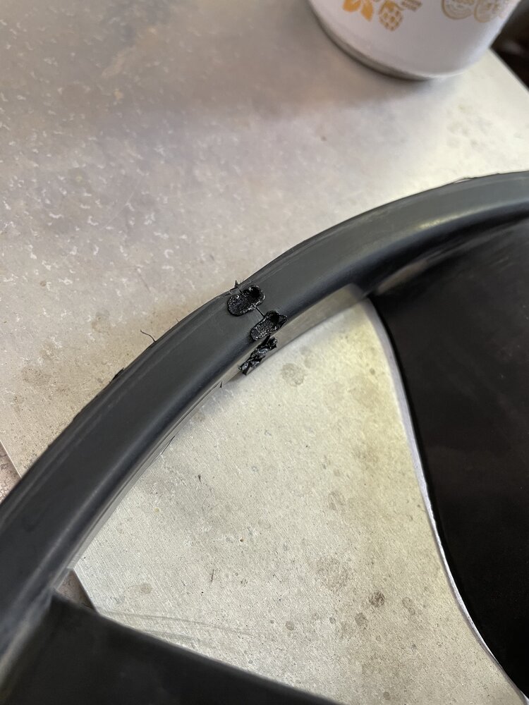

Luckily I utilized the OEM wiring and plugs. Made removal a breeze. Certainly found my problem. 2 cracks all the way thru. A 3rd one has started as well.

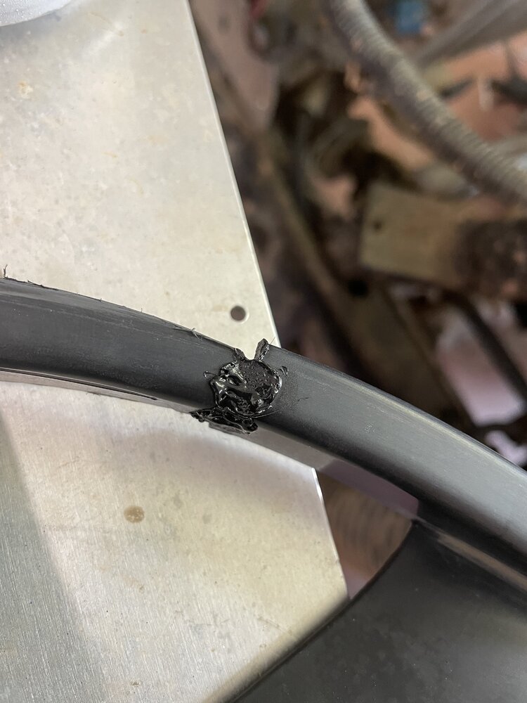

I’m gonna try to get to the junk yard tomorrow to grab another fan. But I thought about cleaning the area with brake clean and applying gorilla tape on the inside and outside of the ring, and then also put the same amount of tape straight across on the other side to keep it balanced. Probably a dumb idea, but might work temporarily.

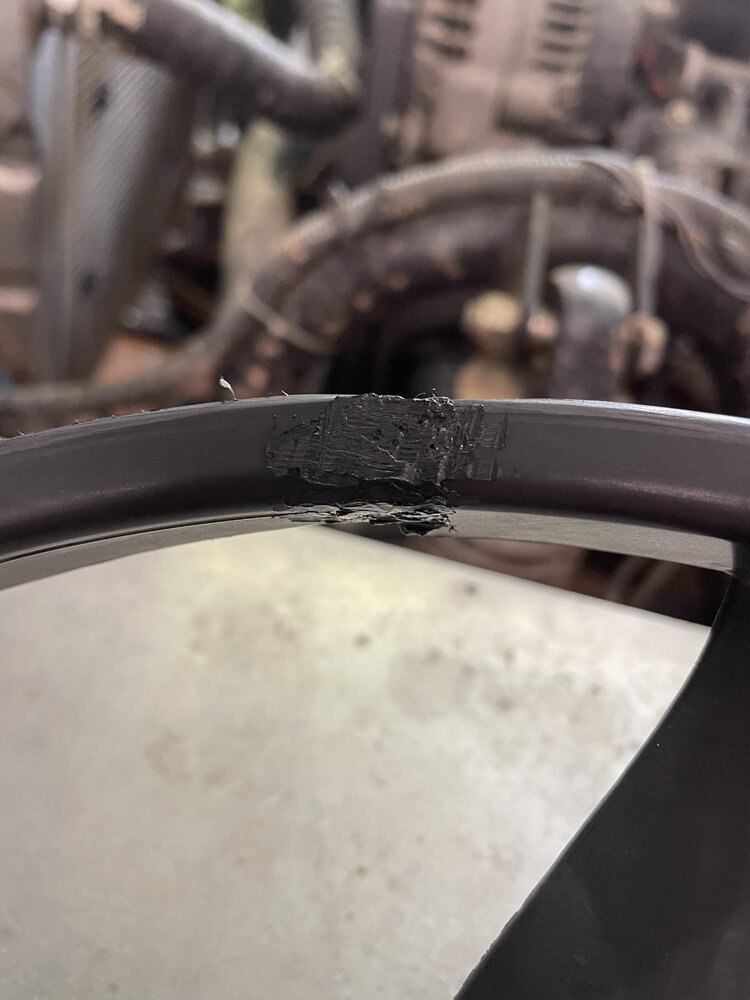

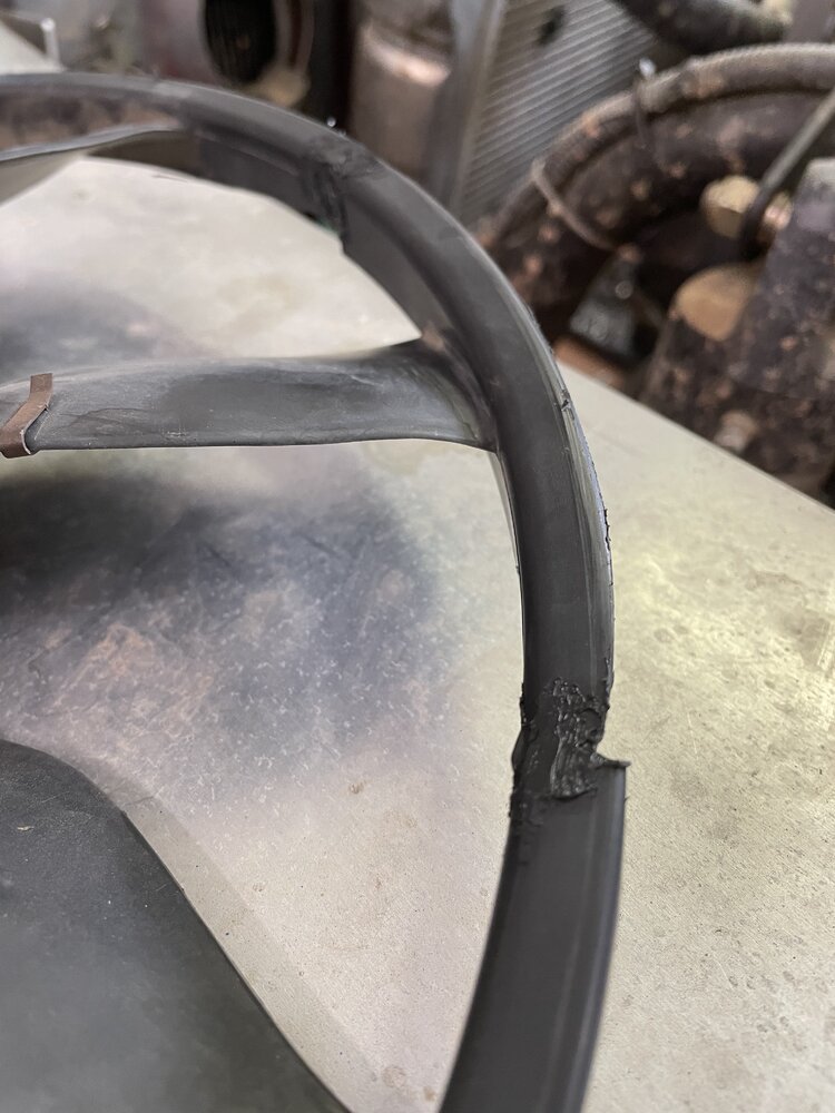

Plastic weld that beeyotch with a soldering iron.
I have a soldering iron. Do you think I could do it with a zip tie as filler? Blend it all in smooth after.
Zip ties work great as filler on kayaks so I would think it would work. Pieces of milk jugs also work great.
So that worked wayyyy better than I imagined. I “tacked” it as you would TiG welding, then smooth lots of the original material over it. Like spreading peanut butter. Then added some zip tie filler and leveled everything best I could.
It is shockingly strong. I was thinking I would as epoxy over it, but it’s so strong and rigid I won’t bother. Fixing to reassemble and report back.
Well that worked. And apparently the fan rubbing like it did was slowing it down quite a bit cause the Jeep runs a lot cooler. It took a LOT of beating on it just to get it up to 200* and I’m sure my neighbors loved it. I had the high set to kick in at 200* and once it kicked on it held at 203. I got it to 206 by sitting still at 3500rpms for a bit. Once I stopped it pulled it down super fast and switched to low, and kept cooling. It was back to 176 in about 3 minutes. It might still get a little warm when I hammer on it but it will take a while to get north of 220 and if it does it’ll come down super fast.
