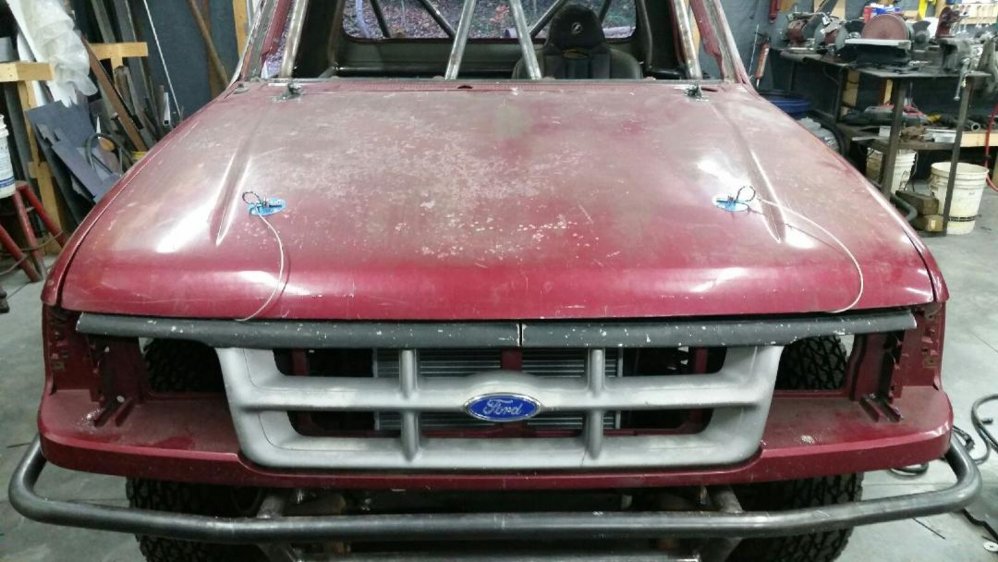

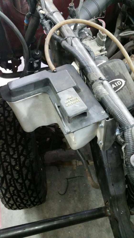

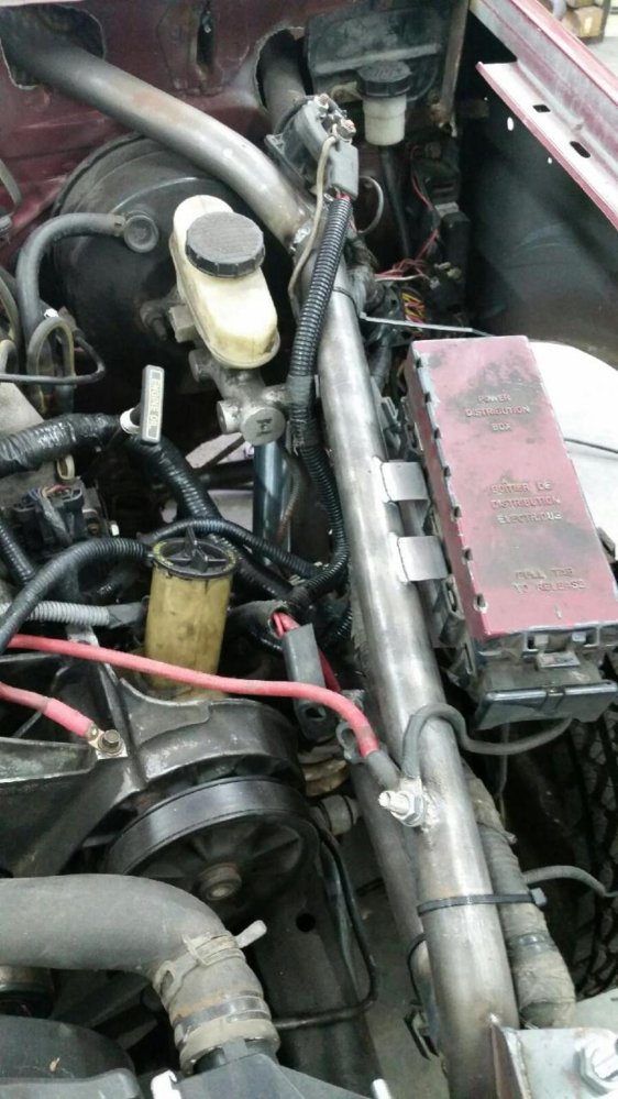

Matt has been busy working on the Bro truck. He had to make under hood mounts for alot of stuff. Built a custom air filter set up, a mount for the overflow jug, and relay box mount.
Got the front bumper tied in.

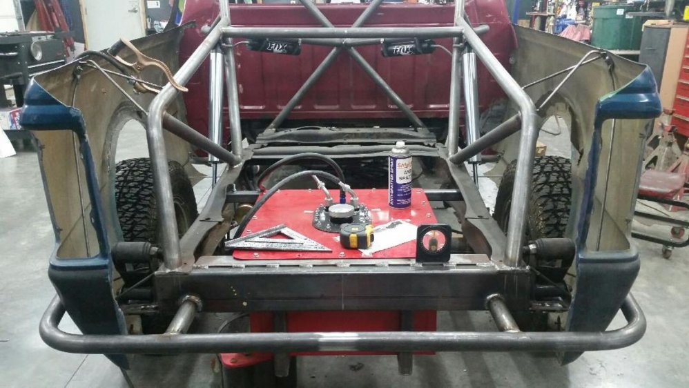

The rear bumper coming together, along with some hood hinges and pins.
Its coming together nicely and Matt is doing an excellent job.
There's still several small things to do but we're getting closer to the Dream!

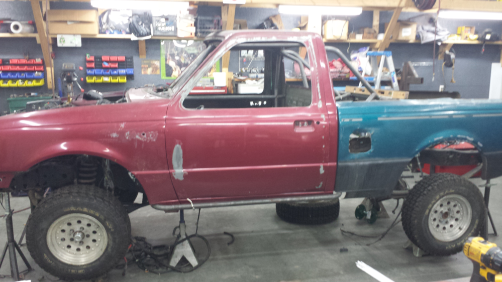

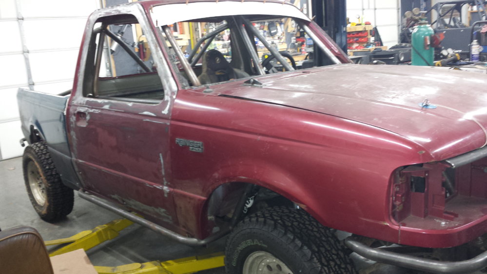

Found a chance to run to Mt Airy to talk with Matt and snap a few update pics. Been so busy with work, my only chance was at 10:30 Friday night.

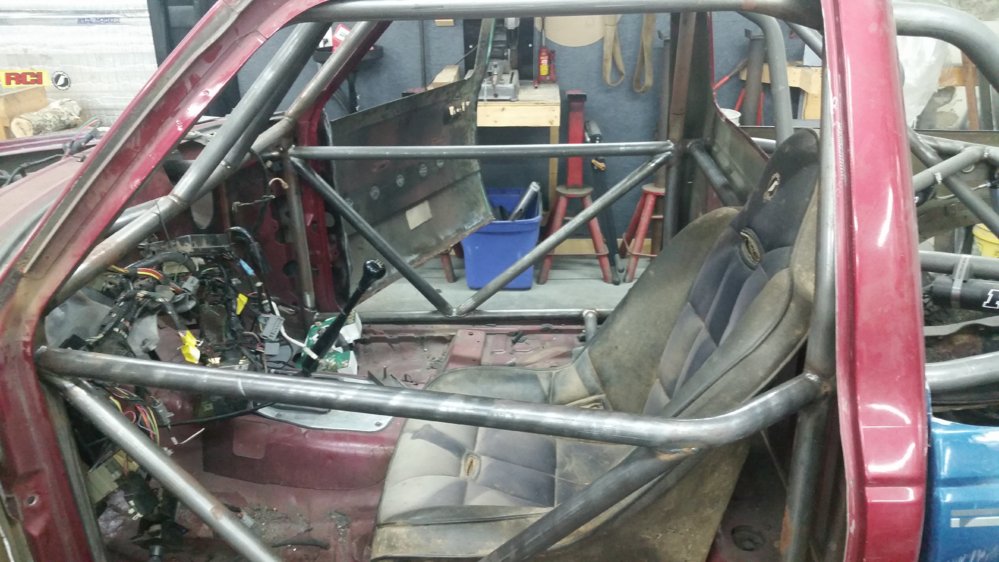

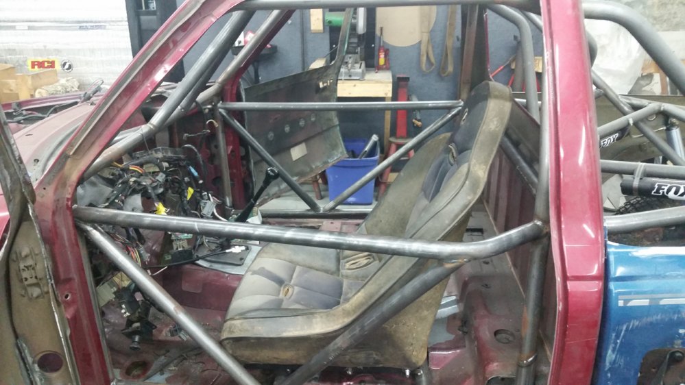

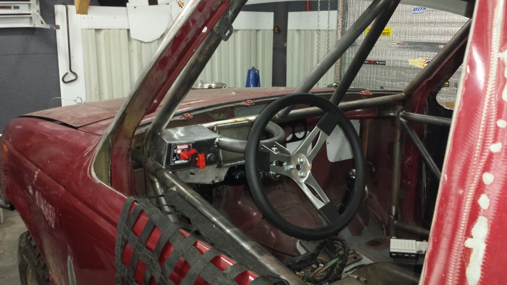

Matt has the steering wheel,shaft and 2 to 1 steering quickener in place. He also did a nice job on the master kill,on/off switch and starter button. All within easy reach for the driver and course workers if need be. Seat is all mounted up and has plenty of adjustability.

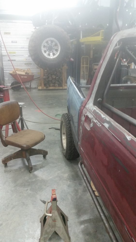

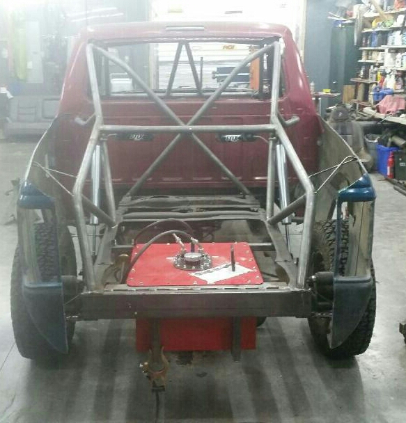

Got a little dove tail action in the rear. And I still might add some wheel spacers for a slightly wider stance and stability.

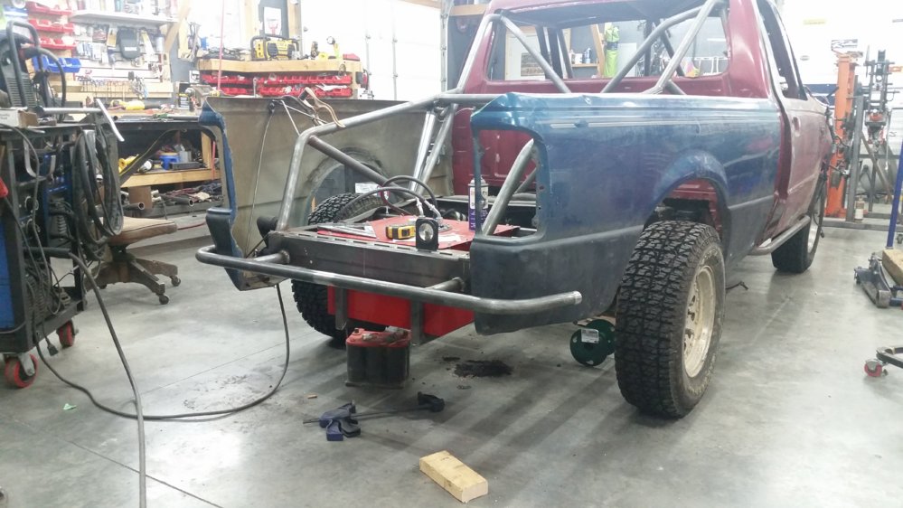

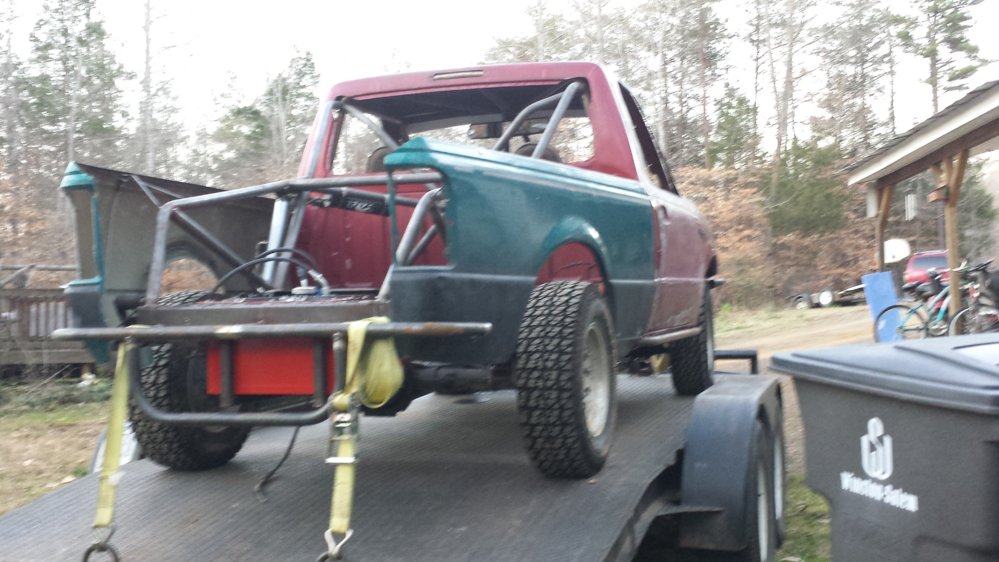

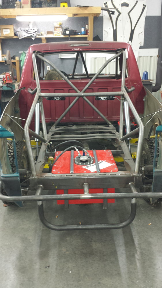

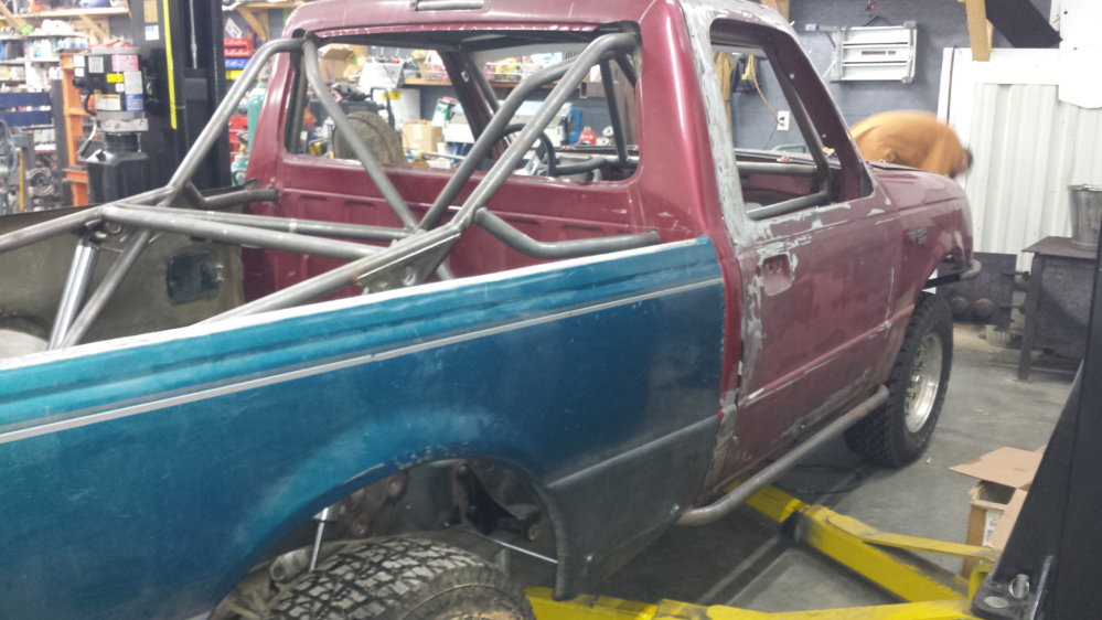

Here's another rear pic. You can see the way the bedsides are mounted. Should be ply able enough to deflect a little..and if they do come loose, should tear away nicely and not be stuck dangling off the side.
Also shown in this pic, you can see where the battery will be mounted. Just behind the cab,down low. ( you can see the optima red top hiding there.)Unfortunately, you can't see the sweet battery box that Drew Johnson @WARRIORWELDING built for this truck. (I'll get a better pic of that later) The idea is to mount it to the right to help offset the drivers weight on the left side. It's our attempt at keeping balance. Plan is to mount a passenger seat for ride alongs, but make it easily removable for racing.

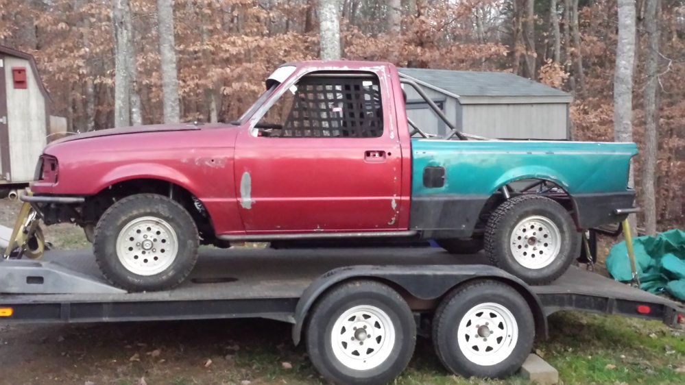

Matt went the extra mile and instead of welding the doors shut, he took a more sensable approach and added 5 nutserts per door. The bed is also mounted with nutserts. Which will definatly make interior servicing alot easier.
Closer pic of bed hangers with nutserts.

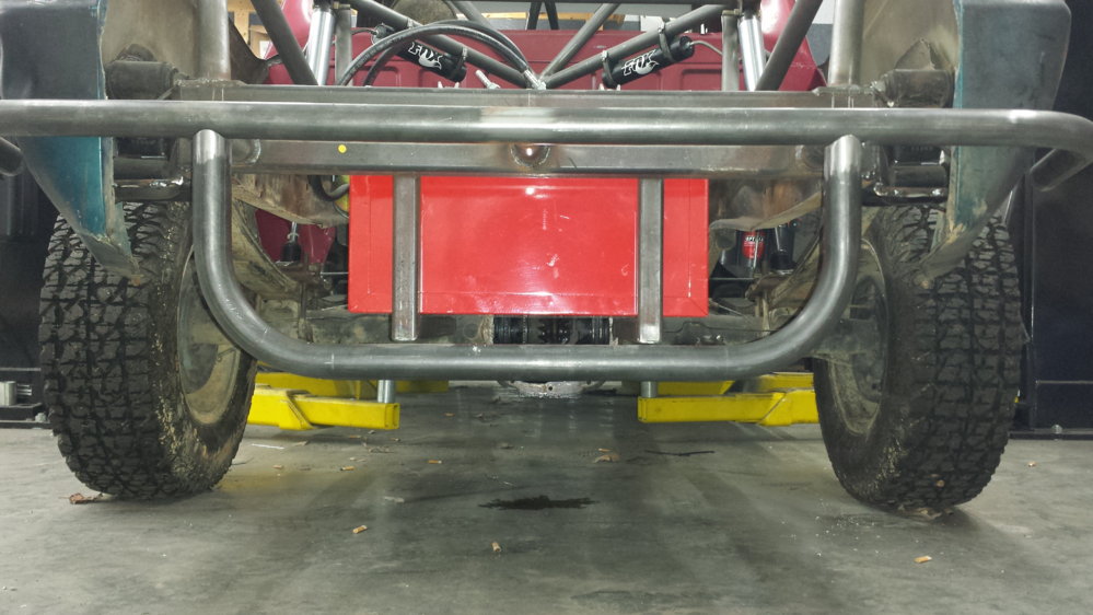

Rear bumper with added protection for the fuel cell. Also helps to hang some weight out back down low. Maybe this will help with traction and level flights!
While I was there, Matt and I were pondering the weight of this truck. Matt says he believes it will be 2k or so. All I know is that we were able to grab the rear bumper and lift the rear tires off the ground rather easily. It will probably fly like a lawn dart.:D
