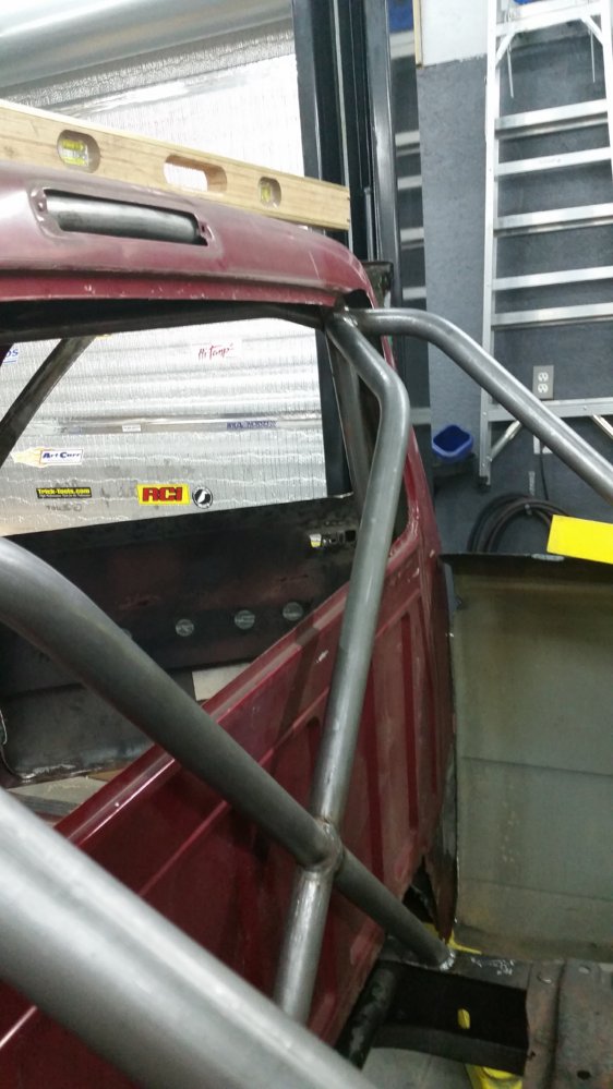

NC Bro-lite build

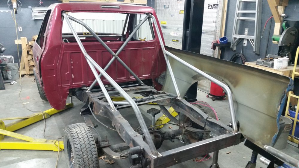

We have a few tubes tacked in and have had to install a couple new spring hangers and mounts. Ordered a few more parts and still have a few more to order. Fuel cell,steering wheel,brake lines and fuel plumbing are next on the parts list. Also...I performed a little bit of sanding in preparation for the Dodge Viper orange paint that @Infamous1 has donated.
I'll try to get some more pics next time I go work on it.

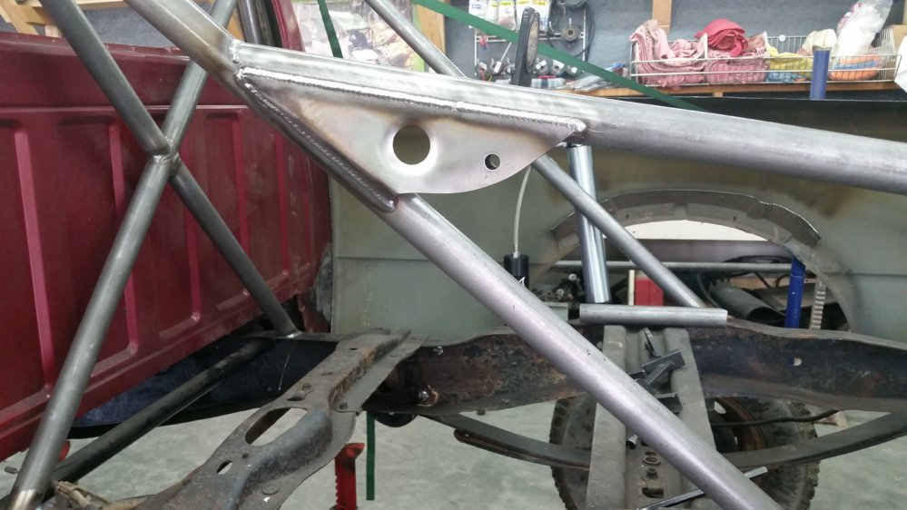

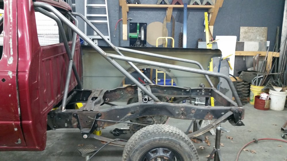

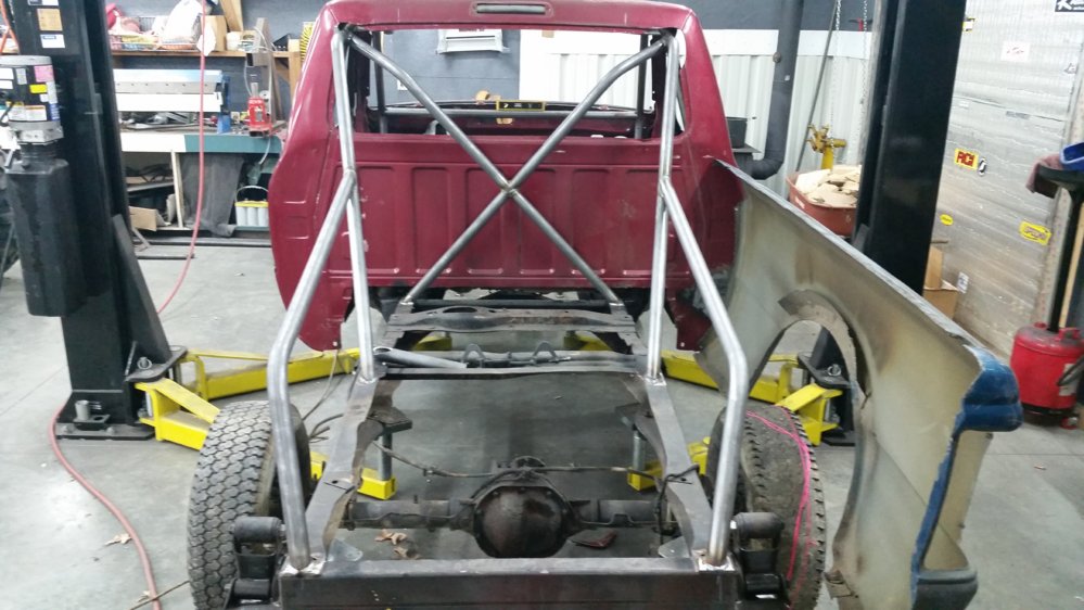

With the holidays behind us...we are ready to build the Bro Lite truck. Expect some forward progress and pictures soon. We do have the main part of the cage in the truck and are ready to start adding the rear tubing, door bars, bumpers, nerfs and and a lot more.
