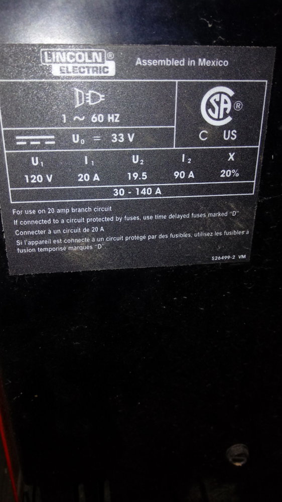

I was going to wire in a really GOOD dedicated circuit for my welder to get the most out of it...(more like get more out of it than I ever have according to what I've been reading).
I have plenty of 10/2 and 10/3 wire laying around, several 20amp outlets, a 20amp spare breaker and it's for my Lincoln 140. I've read that by putting it on it's own dedicated circuit with 220 wire (10/2) and using 20amp outlet AND some say a 30 amp breaker (others say stick with 20amp breaker).
I have the 10/2 wire, I have the 20 amp outlets (i think they have 25amp outlets too?) and just need to know what size breaker I can safely use...20 or 30amp?
I'm fixing to switch my welder very soon to Gas MIG setup and been reading with .35 wire and gas with the above mentioned wiring, it can really put out the full 140amps to really get the most out of it. Up to this point, on a dedicated regular 110 circuit with 20amp breaker and whatever factory housing 110wire was used, I have never been able to weld on the highest heat setting for more than like 12seconds or so LOL (I know sucks) but have managed with next one down or for while now been using .30 wire. I do remember thought for those 10seconds it did burn pretty hot until it tripped breakers.

Well the nameplate says for use on 20 amp circuit, so I would stay with a 20 amp breaker. The gauge of wire is both dependant on the amperage needed and how far the run is. Plenty of graphs online to show how far a gauge of wire can safely carry x amount of amps.

I'm not an electrician but I wouldn't put a 20amp receptacle on a 30amp breaker.
The breaker protects the circuit. If the outlet or wiring is rated for less than the breaker the breaker can't protect the circuit (at least thats how I understand electrical systems work)

210.21.b exception 2 applies specifically to welders on a 120v 30a circuit in a resident application......
