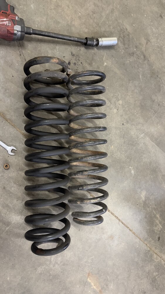

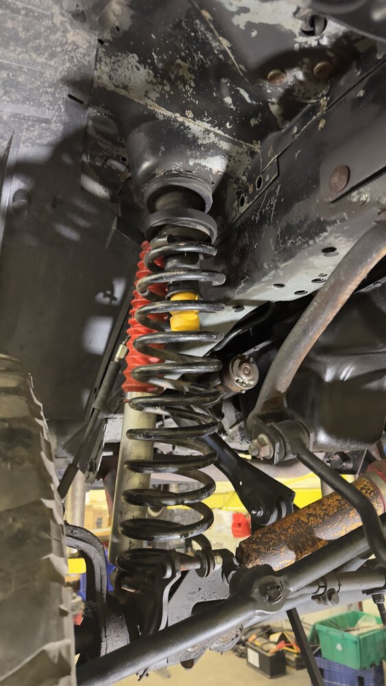

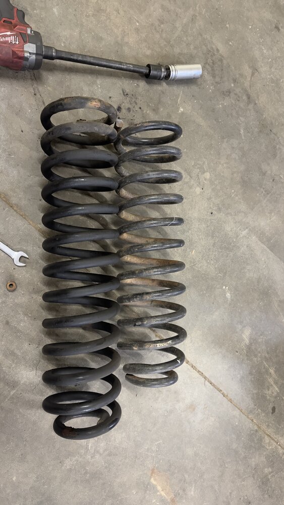

Swapped the front coils for some 2.5” TJ coils that I had laying around and it brought it down about 2” in the rear. Gonna swap in some 2.5” XJ rear leaves leftover from the previous XJ, but still working on getting the bolts to unrust from the shackles. They are moving about a quarter turn, but not out yet. The coils that came out were very tall and stiff, so hopefully the new ones ride better.
Also put in some new bump stops while the coils were out.

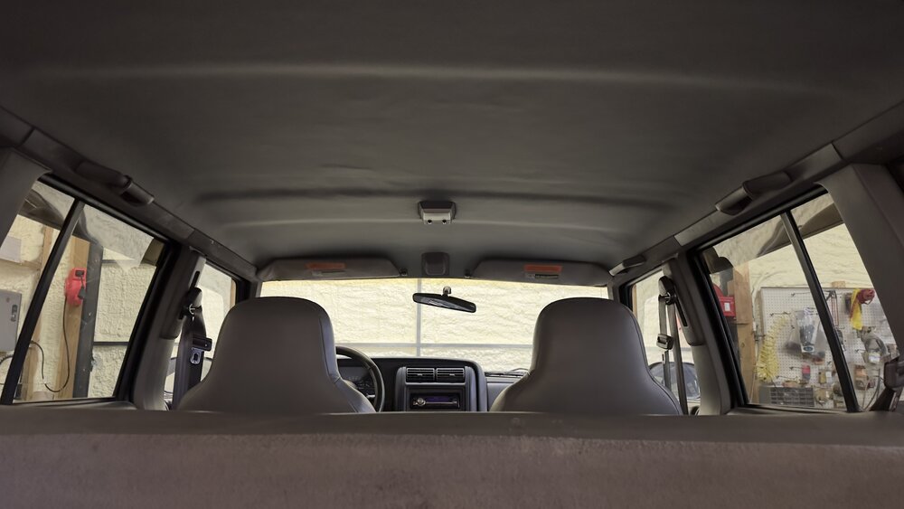

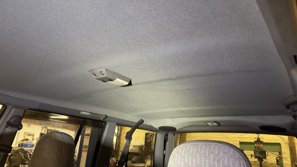

Also had the headliner redone. Had 6 pieces of off brand dynamat leftover from Xtrajeep so I stuck them on the roof before installing the headliner.View attachment 429416View attachment 429415

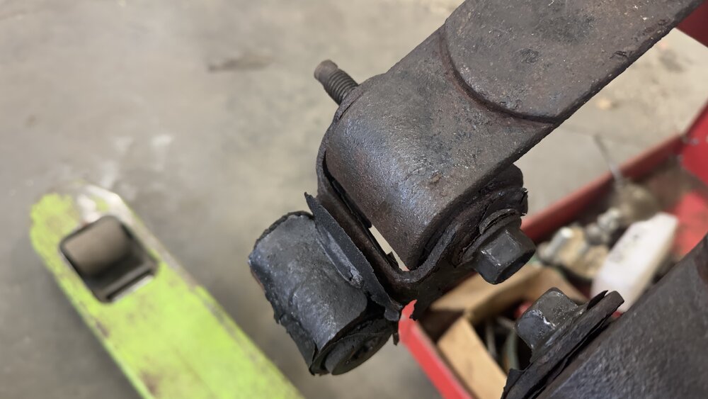

If I can get some rear shackles, it’s got a solid chance. And they are supposed to be here tomorrow. I got the 4.5?” Leafs off today, but the bolts were NOT separating from the bushings, so I just ordered some new shackles.

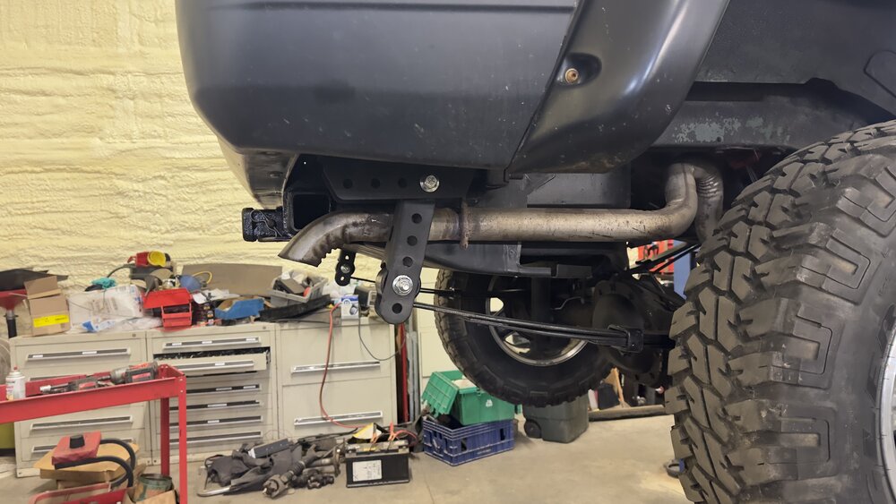

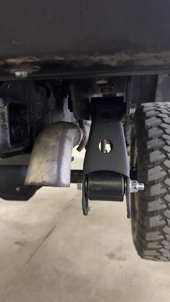

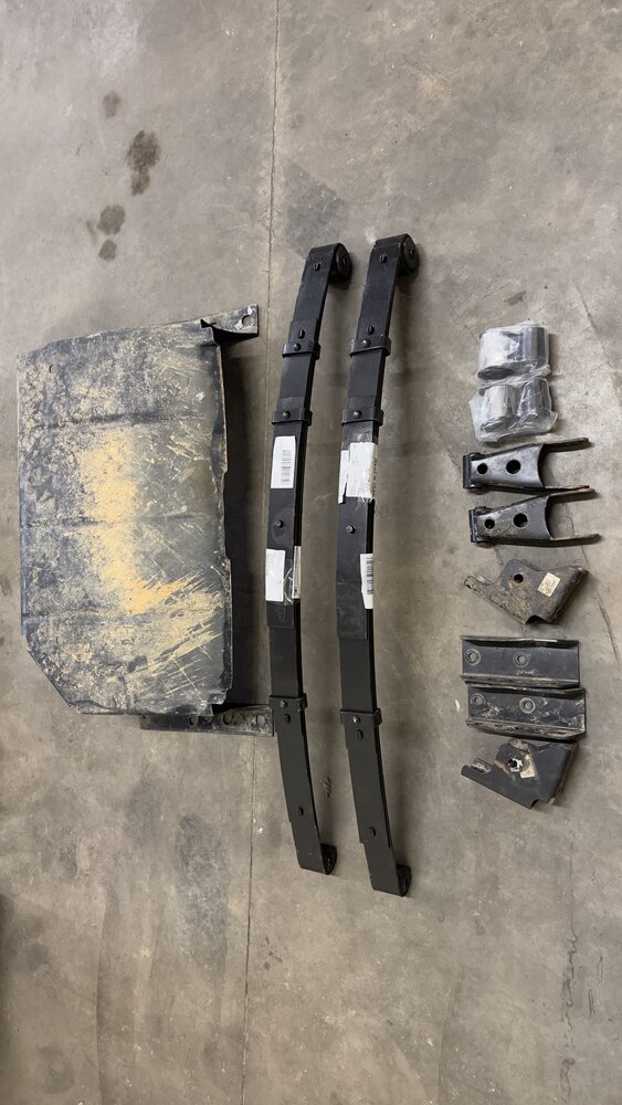

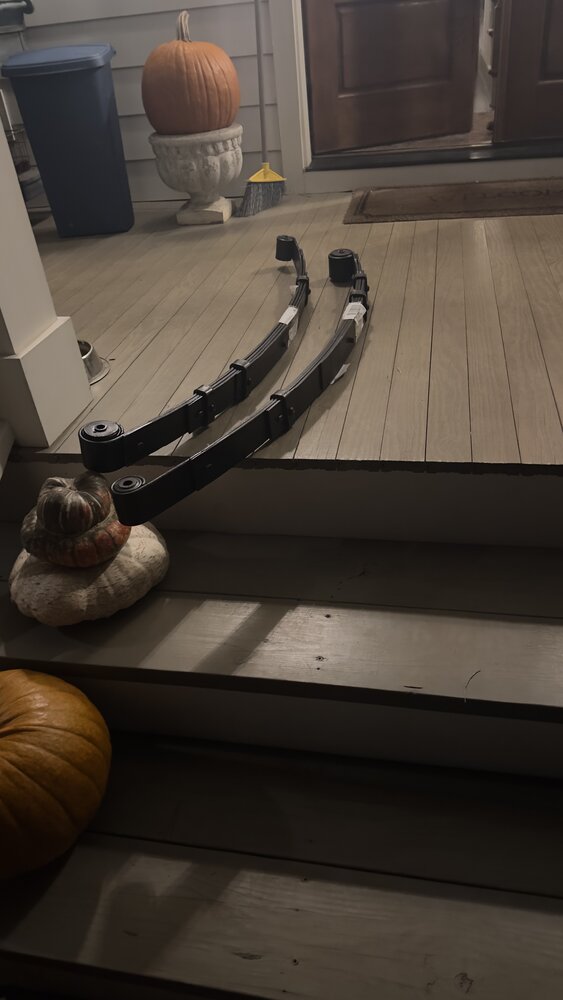

Lots of little things done in the past few days. Swapped the 4.5” coils for 2.5s, swapped the 4.5” leafs for 2.5s. Got a shackle relocation kit from @1stgenxxx and installed it with the 2.5” springs. Uninstalled it because it was too tall. Installed the 2.5” springs with new stock shackles, and the shackle angle was terrible. Tried the lift shackles but they were too tall. Uninstalled all that, bought new stock springs, reinstalled the shackle relocation, installed stock springs and new stock shackles. Clearance issues with the exhaust and it was too low. Finally, shackle relocation, stock springs, and 2” lift shackles ended up being the magic combo.
Definitely stealth packaging on these springs
:laughing:

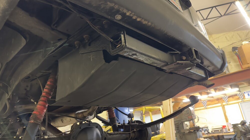

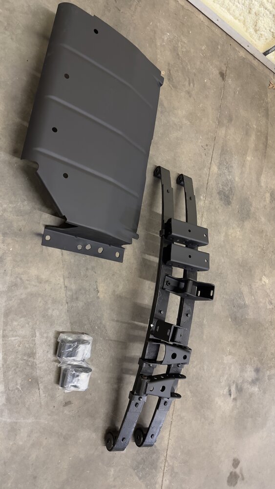

I also picked up a fuel tank skid from @Jeff B
Got it all cleaned and painted last night.
He had even trimmed it already for a receiver hitch 👍

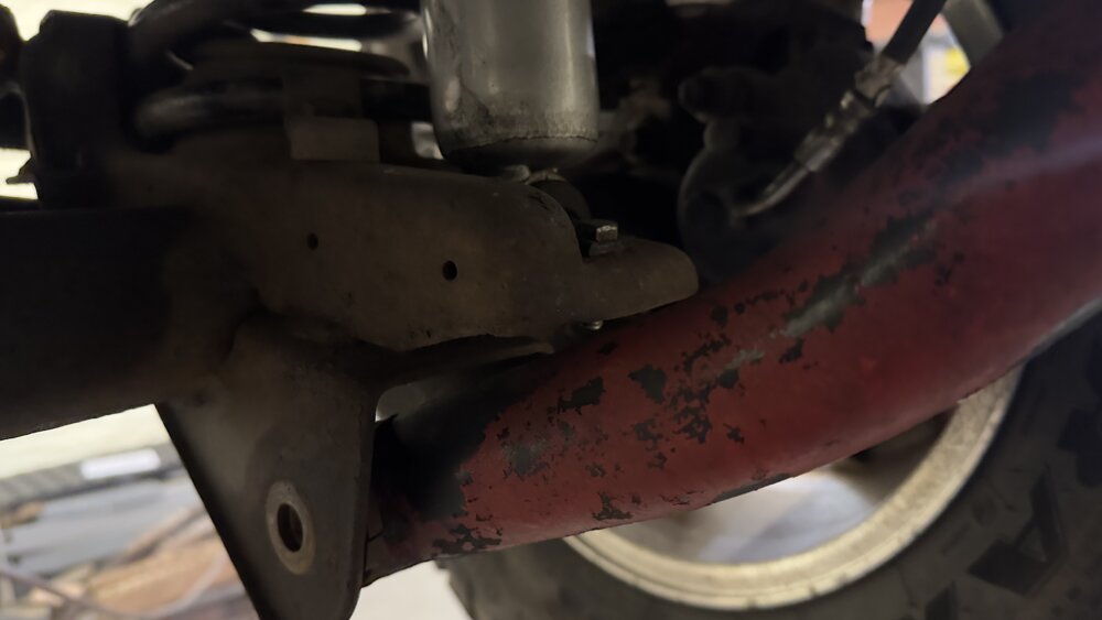

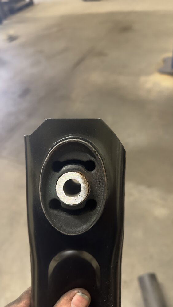

Removing the old bolts and installing everything went better than expected. The only thing left to do was install the WJ lower control arms I had bought. Everyone said the bolt right in. Jeep is already on the lift, should only take 15 minutes, right?

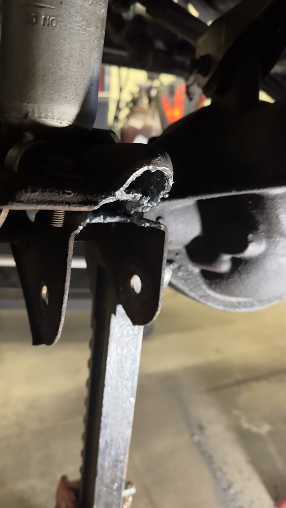

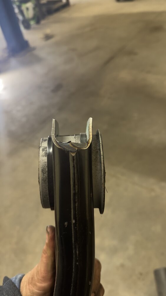

Of course nobody mentioned that one end of a WJ LCA is 2-7/8” wide and the other is 3-1/8”. But the stock XJ stuff is 2-5/8” on both ends. Not a big deal, but grinding 1/2” of width off a brand new part is frustrating. Anyway got that sorted only to realize that one end doesn’t fit in the frame side bracket because of sheer bulk. Then when I started checking clearance for the arms, I realized the shock mount would severely limit travel. (Aftermarket LCAs that were on the jeep)
Ended up cutting a ton of metal off to make clearance.
Cool finally I can move forward!
Oh wait, the body of the arm now hits the axle tube so I gotta grind that down.
And then of course they fought me getting everything lined up too. 3hrs later I finally have em done but man it’s definitely not a bolt on swap.

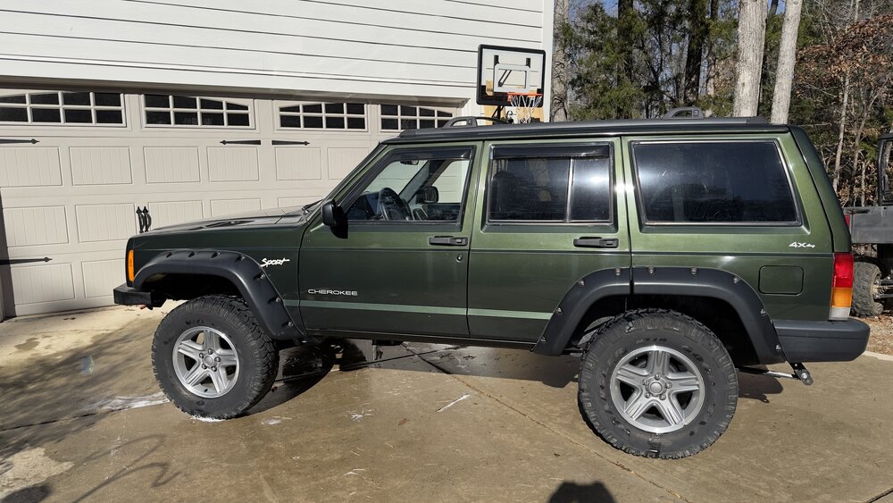

A bath and glamour shot before heading to Uwharrie. Hopefully the body is still this straight at the end of the weekend. (It sits level but is FLEXED OUT at the transition in my driveway.
That rear shackle angle is great. Gonna ride like it's on a cloud of boobers.

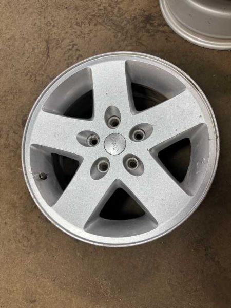

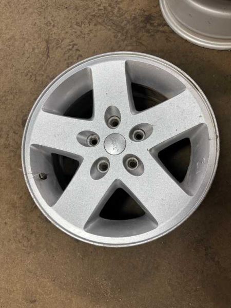

I also like the fact they are electric lockers and a little wider. 5x5 bolt pattern is a nuisance though if I want to keep the wheels.

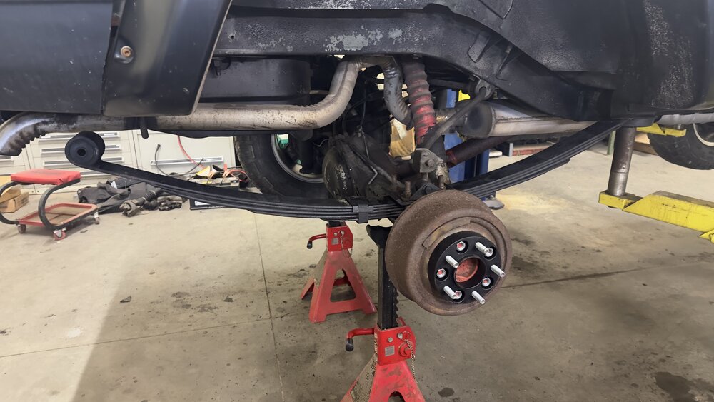

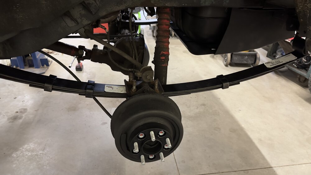

Any concerns about life expectancy of those rear leafs being that they are already inverted?
I have no idea. I'm a coil spring guy. Is that bad? To be fair, that side is flexed up about 2" and has about 300lbs of tire/tools/gear in the back when that pic was taken.
