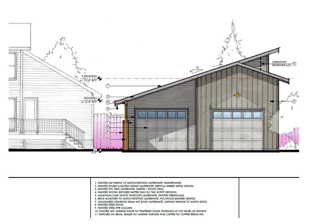

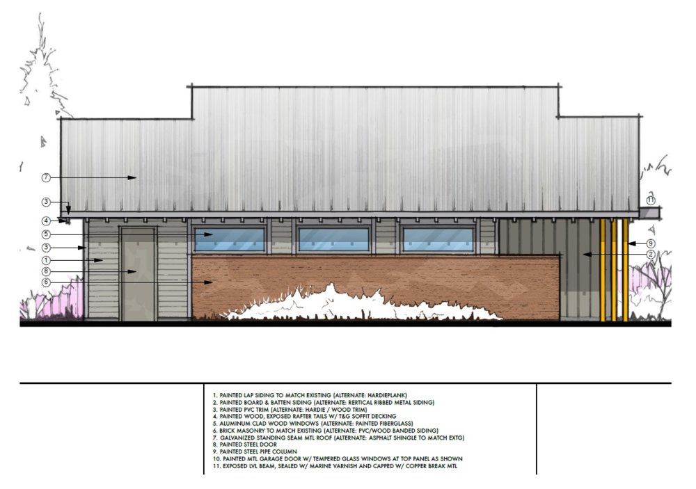

What's the point of the lvl running the length of the building? Detail 11?
You have a lot of expensive nitpicky details that are driving your price up so high.
Lvl is there to break the length of the roof up into a length where conventional lumber can be Used. Since it’s a single slope roof.

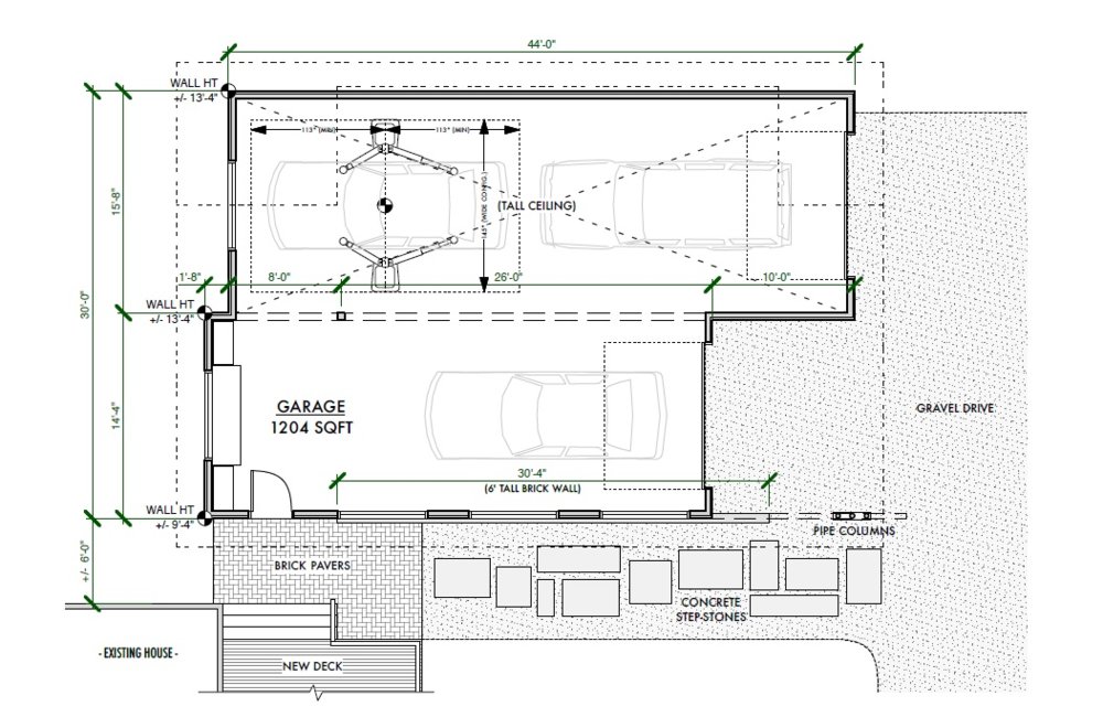

I’d also say that the off set on the back side of the garage is a waist of money. Every corner of a building will drive cost up
In the drawing looking at the doors side that mentons the lvl I missed that the left side bay is recessed. I thought they had the lvl running the length of that short wall on the house side. Oops
I bet you could add 300sqft and it would barely up your price. All your details are driving the cost, not sq footage. I found that out when building my house. I cut the size of a few rooms and it changed my cost by pennies.
After seeing the pics and drawing. I redact my statement about the contractor being too expensive and replace it with a new statement that he hasn’t estimated enough $.
Please elaborate. This is what I'm trying to learn. What specifically jumps out at you? We're currently at well over $100k without metal roof, or interior finishing, or the pavers/walkway/deck that are included in the pics. Any of the details are up for discussion, which is why we're still at the quote stage and don't have drawings. 30% GC fees are not helping.
I'm fully willing to simplify some things, but I don't want to get rid of the big elements that make it look different than a generic boring box or a metal building, which is the reason I'm not building a boring box or metal building.
Downsizing to 900 had some effect, but not huge. Mostly the incremental costs of lest concrete, less roof, etc., which makes sense. I was definitely not expecting it to scale linearly with square footage.

Too many exterior finishes. Detailing between them isn’t quick for most contractors. Too many exterior corners. Roof structure, while reasonably simple, isn’t a simple gable roof with prefabbed trusses, which adds time and costs. *exposed LVL with marine grade finish, wrapped in copper... this just adds $$$ even though it’s probably simple and relatively simple. Exposed rafter tails and cool, but not quick, adding time. Brick... adding this into the mix again complicated things; foundation for the bricked areas is different and again, transitioning from one wall finish to the other further complicates things. Painted steel columns... that just adds $$$ even though it seems easy to do.
the clerestory windows and structure around add probably at least $15k without any benefit other than looks.
Volume discounts for finishes is shot out the window because it looks like you have, at most, 2 squares each of 5 different finishes.
standing seam metal roof is double what an AG metal panel would be. (I think we touched on this earlier).
there just seems to be a lot of detail and finishes that just easily double the price.
