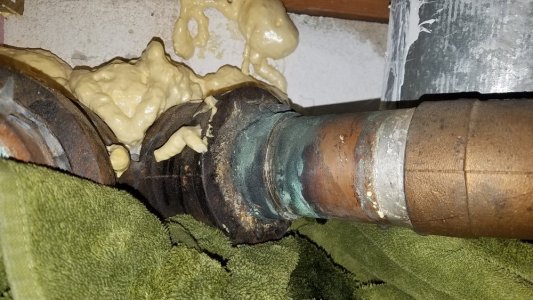

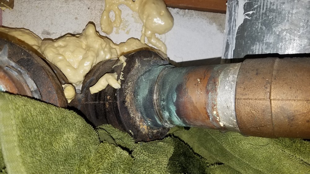

This drain line is leaking right around where it meets the exit like. Copper into what I'm assuming is cast. Our water is acidic and has slowly eaten mist of the copper away.
What is the best way to repair this?
Right now it's a slow drip, and only for the kitchen, so I need a quick patch (epoxy putty?)
But then the right way.... whatever that is...

Drain, you said...so not under pressure.
Had a cast-iron wye at my mom's house rusted thru after 40 years. When they built the house, the plumber had actually cut and shortened it, and brazed/welded back together. Epoxy putty patch over it 25 years ago and still holding.
Looks like brass to copper to cast
I know you're smart and all..but call the man
It's just copper into cast. May have a brass braze...? Its original from '67.
What would "the man" do? What is the proper way to fix it? Cut it off flush at the cast, and braze on a new fitting?

The leaky part of the copper is right in front of where it goes into the cast. Hairline crack in the bottom.
