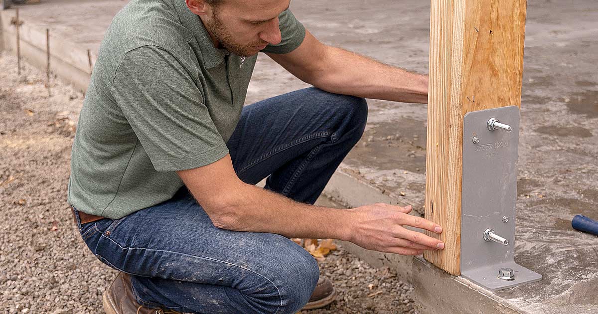

Then are the wetset kits not good? I would think that the pier with a wetset bracket should function the same as the the post in concrete.
I do not like the idea of putting wood in the ground at my house. Be it in concrete or gravel. Too many termites and too high of a water table. I have been planning to do a monolith slab with footers under the posts and utilizing wetset kits.
I considered that method when I was building my shop, and I see no problem with it. You are transitioning the load from a solid body (the post), to a bolted and embedded connection, and maybe its not quite as strong, but worst case it will flex a little more so the sheeting/wall tin will just carry more load. And a couple 2x6's or 2x8's or cable tensioners at a 45 going post to post seem like enough to be sufficient. I have also done zero calculations to back up the arbitrary situation on a building of unknown size and construction, but I'm certain I would do it that way and still have a building standing in 30 years.

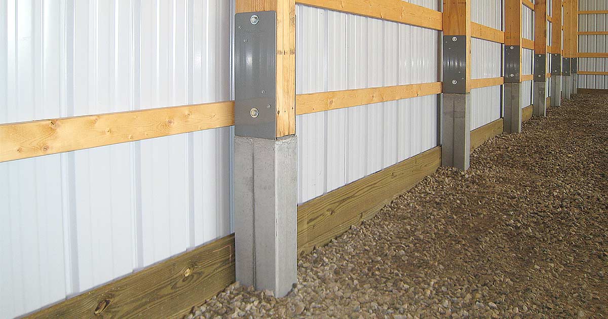

I have been looking into the Perma Column system.

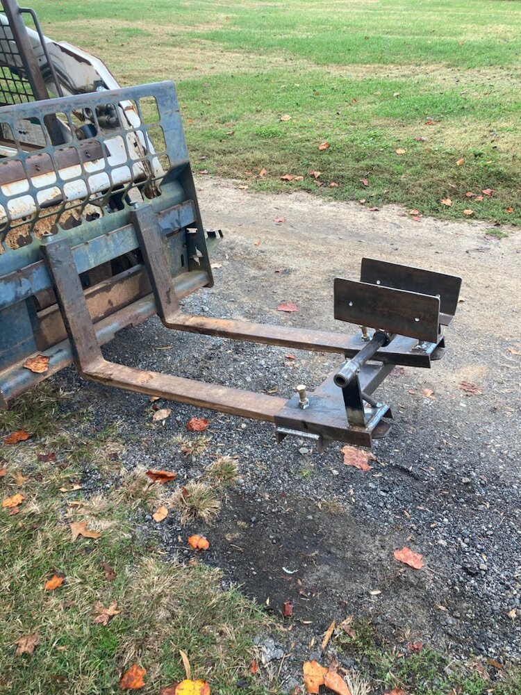

So, while we were letting the angry squirrels scream at Uwharrie on Saturday, my dad got to work welding up post stilt thingies. We threw those bad boys on the posts on Sunday (I'm still sore as hell from it) & now we're ready to rock 'n roll :rockon: Hopefully we'll have concrete Friday afternoon.

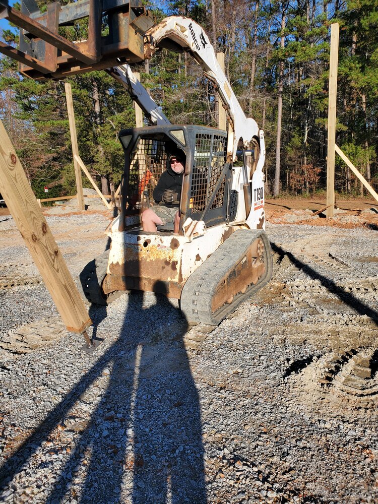

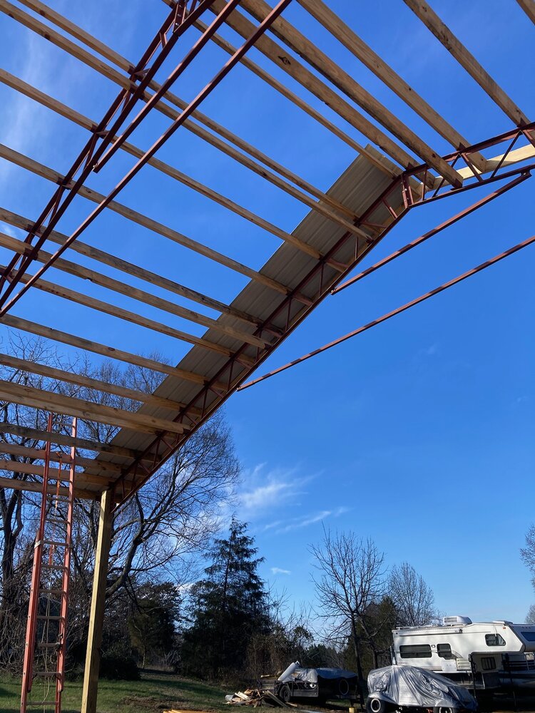

Yes! We actually spent Thanksgiving setting the trusses & purlins in place. All the equipment rentals were booked solid but we lucked out & a friend of my dad's loaned us his bucket truck.
We still need to get the metal roof on there but weather & time hasn't been on our side. My dad sent me a selfie last week while I was at work. He was impatient & wanted to put a "practice sheet" up there. I promptly requested that he get his old ass down since no one was home. 🤦‍♀️🙄
So, that's where we sit currently. Not too shabby for a 3-person team. Depending on how the next 2 days look, we may try to knock out the roof.
