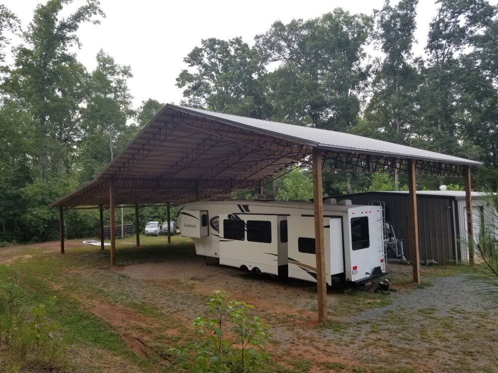

This is my R&R shelter that we put up. Great people to work with. I'll eventually close it in when concrete cost are not as bad or I hit the lottery.

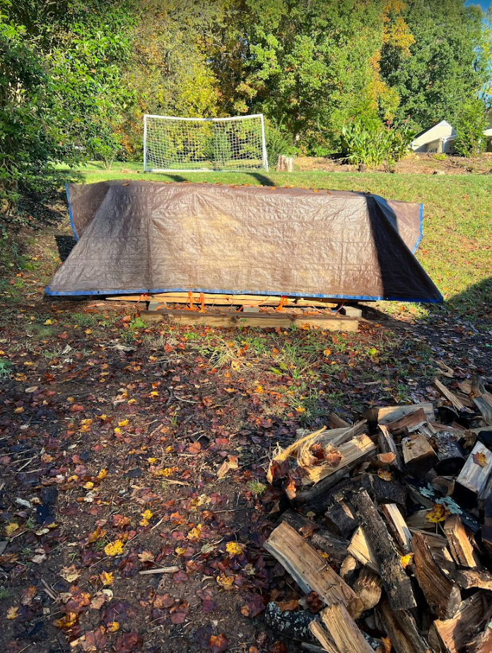

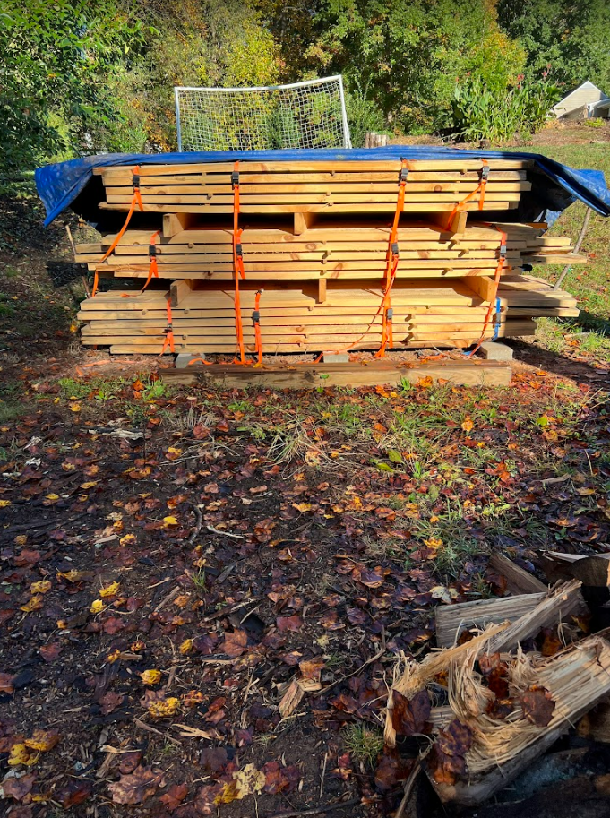

These are white pine and were milled in Nov21 and have been sitting like this since. I generally get out there to tighten the ratchets every few months. There's roughly 120 2x6's there.
To me it looks good. I don't know much though. Air dry will only take it so far. The tarp might trap some moisture. If you can let them sit in the sun on good days then retarp. That is just me though.
I thought the same about the sun, but I've also heard the sun is just as bad (for warpage) if not worse than the rain
I would think that the straps would stop that. Like I said I don't know much. I just started playing with a chainsaw mill this year.
