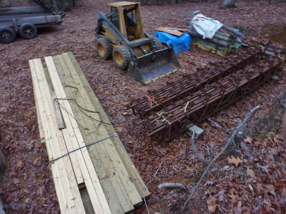

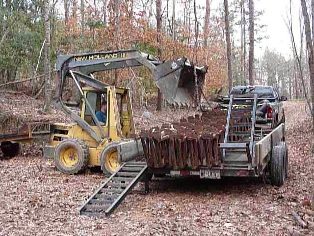

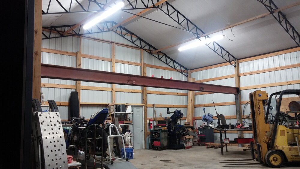

Ain't nothing wrong with some chicken house trusses. I was gonna go 30x40 on mine, until I found a good deal on some 34ft chicken house trusses.
Wish they were 40ft though, because then I could store 6 more feet of junk!

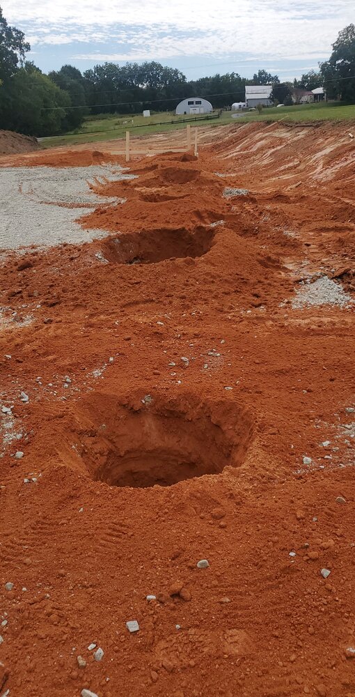

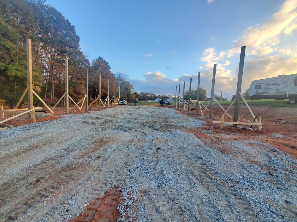

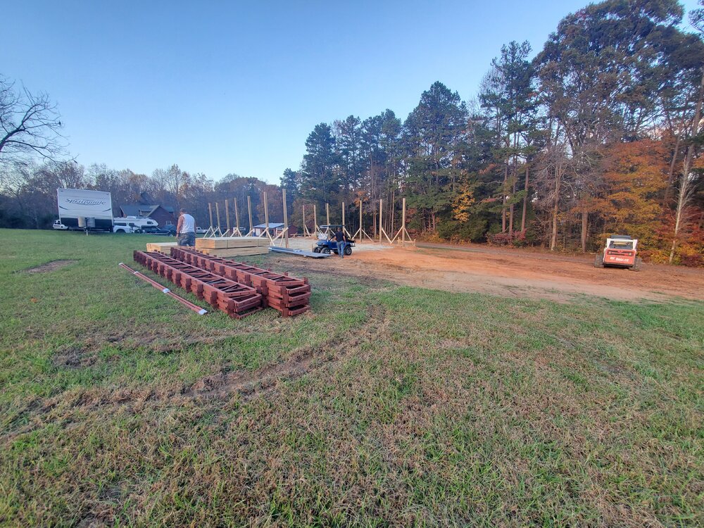

Update: The building supplies were delivered on Friday so @Mulishajoe & my dad got busy at least getting the poles in the ginormous holes. And now we wait.
We don't meet an agricultural exemption so we have to go through inspections. The structure isn't covered in the code book so they rely on engineered prints (hopefully I got the lingo right, this isn't my wheelhouse). The inspector wants more details than what our print offers. So, we can't move forward with cementing the posts until that gets resolved 🙄

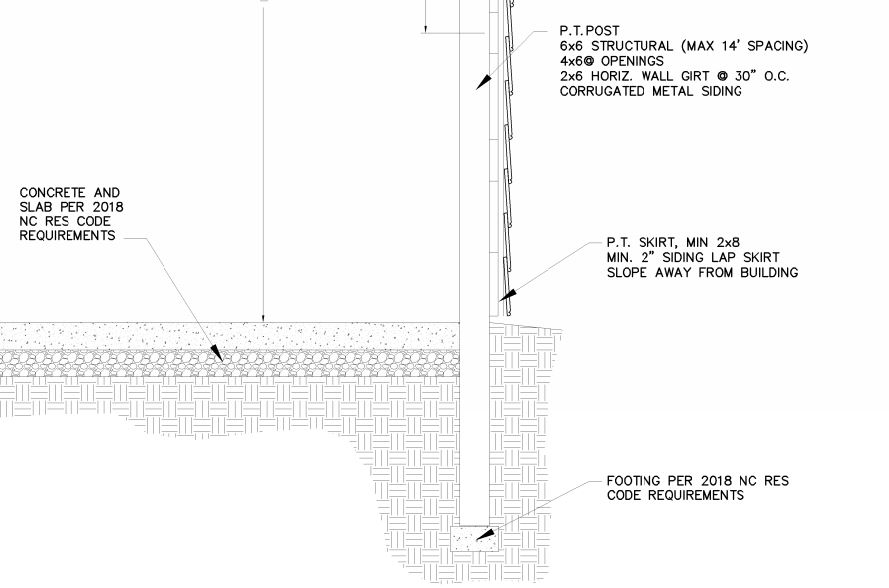

Typically you don't "cement the posts" on a pole barn type build.
Code requires a solid base, but SOME inspectors will not allow a mass produced base so to satisfy some inspectors, a mold is made on site and a base is poured from concrete then lowered into the hole for the post to rest on. From there the post is set and backfilled with 67 stone.
This is a typical detail that has passed inspection in several counties that I know of

I've seen it done several times in several counties now where you have to pour a "footer" in the bottom of your post hole, then when thats inspected place the posts and fill rest of hole with concrete. They do sell wet set and drill in post collars but usually not needed.

So you're saying no concrete around the post at all? Only gravel?
Correct.
But that's only from the inspection dept of Forsyth and Davidson county
The inspector specifically said that concrete around the post was a BIG nono because it cause the wood to rot.
Since there's never a reason to argue with the inspector over something so trivial.. we just roll with it.
The same detail I posted has been used in Forsyth, Davidson, Surry and Rockingham. If another county says "concrete around post" then that's what the detail will show 🤷🏿‍♂️
