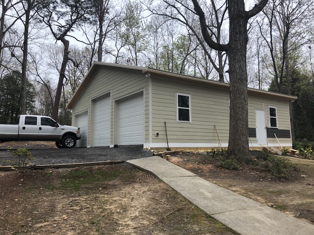

Im building a 36'x36' pole barn with studded walls , I think it was $34k for the building with studded walls and tyvec wrap

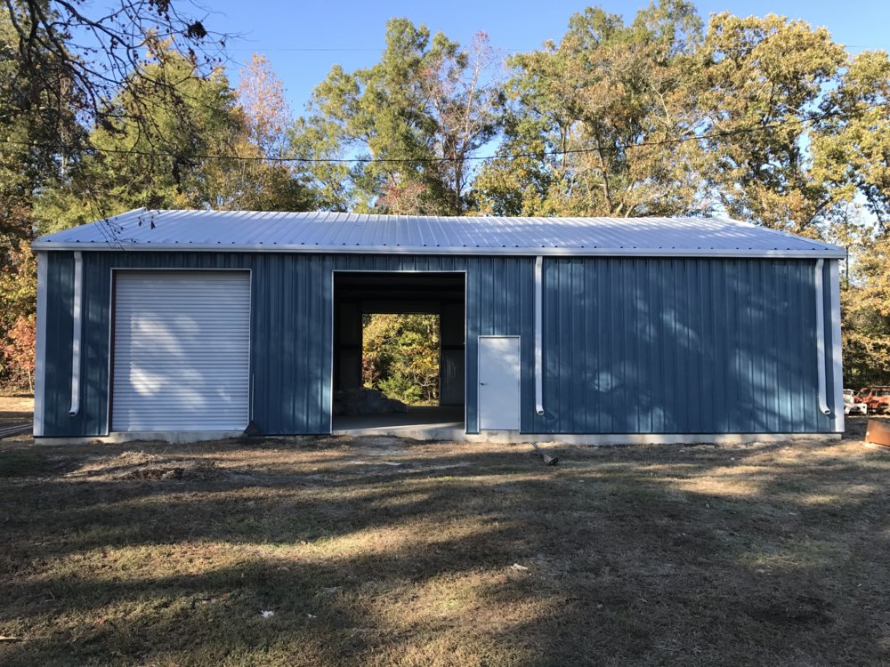

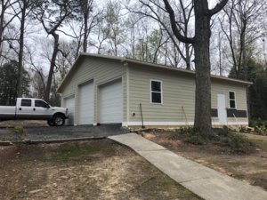

I’m in about $45k. 40’x60’, 14’ walls, 3 12’x10’ roll up doors, 1 personnel door, 6” insulation on walls and ceiling, monolithic concrete slab, (thicker on the edges and down the center for lifts) including having a builder put it up. ARCO designed and built the metal structure, S&L construction put it up.
