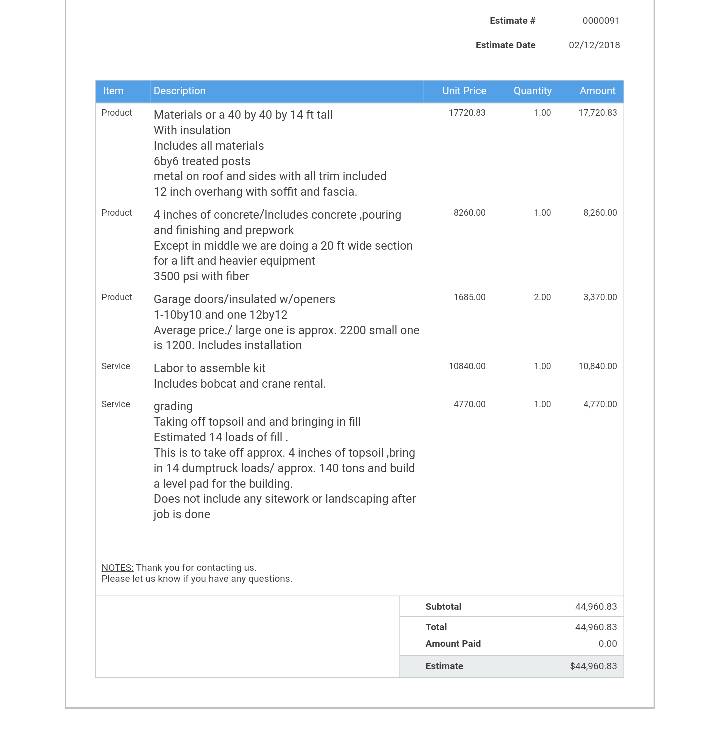

I just got a quote back today for a 40x40x14. Everything seems in line but I just can't get over the grading cost. I have access to a transit and could rent equipment and do it myself for less than half. What do you think?

14 loads of fill... we’re paying 150-175 a load depending on travel distance that’s a chunk of the cost.
Also fiber might be okay, but our engineer we use talked the owner out of it on the two projects we have done, seems to have a higher chance of cracking and settlement issues. All were commercial jobs. But rebar mat is cheap
I don't think I'd let them haul off my top soil. They're just going to turn around a sell it and make even more money off of you. Besides, why do they need to dig that much out? Is it not suitable to build on or can they not just build up a pad on top of it?

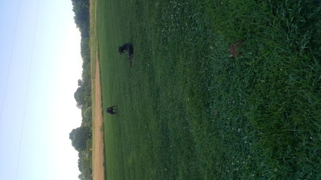

Also....is your dog dropping a deuce in that picture?
Top soil has to be removed for any construction, you have to remove the organic matter or it causes settlement issues

Yea I have a list of some of the questions above to send in. There isn't much slope in the yard to require 14 loads. If I could just get a hoe home from work it would be ready to build in a half a days work.

Top soil that they are taking isn’t worth anything, the soil will have to much plant matter in it and most likely they are hauling it to a dump hole somewhere
@RatLabGuy It's dirt...there's always use for it somewhere if you've got any amount of property. Low spot in the yard? Get some dirt. Wife wants a flower bed? Tell her to get some dirt. You'll need it for something eventually...dump it somewhere out of your way and it's there when you need it. I'm just saying I wouldn't let them haul it off unless that's what he asked them to do. I know I could use all the dirt I could get at my place.

Just signed contract with contractor (not the Malone guy, kept forgetting about me or standing me up to meet and discuss a quote)
30x40x12, 10x40 lean to down the left side (woods side), 16x10 insulated electric roll up door in front, 3ft man door, 10x10 insulated roll up door and 2 windows on right side (yard side) fully insulated and he uses full wood trusses, not the metal strip ones with the zig zag bar $30,500. Ordering material tomorrow out of Columbia so fingers crossed it all goes well for me!
Make sure you get those wood trusses built in such a fashion that you can have attic space.
