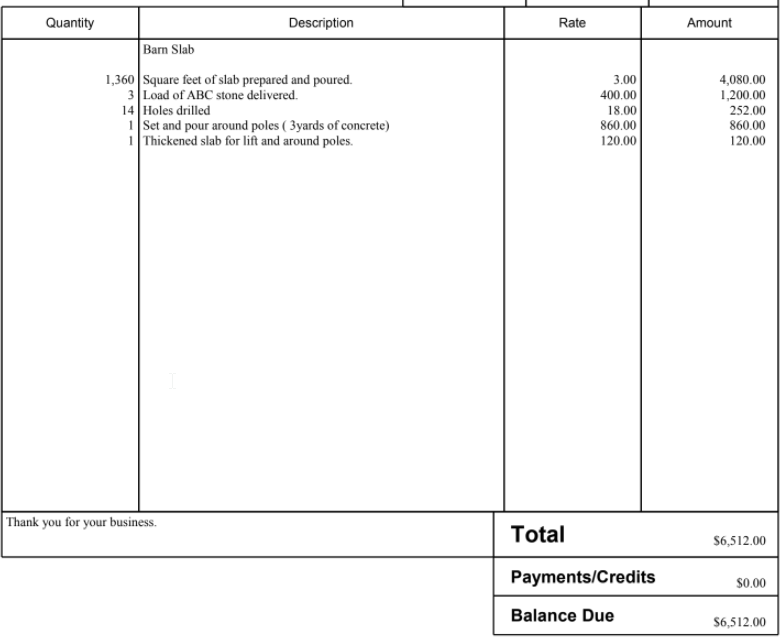

No friend here either, but mine was $6500 for about 1400sqft at 4" thick, but that included boring and setting the posts for me, 2 loads of gravel for the driveway, and several thickened areas. That was at $3/sqft finished, they've since gone up to $3.50/sqft. If you back out the slab concrete and a load of gravel, and adjust for current pricing, thats around $5000-5500.

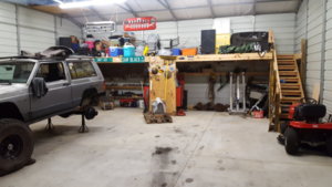

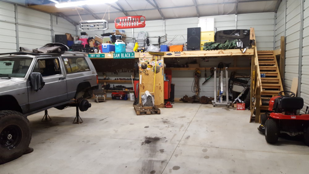

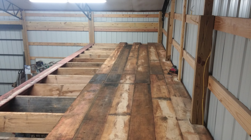

I made a big shelf, 10ft by 34ft. I got the idea from seeing @BRUISER and @GONOVRIT shops
During inspection of the new steps by the fun police.
I highly recommend permanent steps if you do a loft or attic. Pull down, or any kind of narrow, steep steps are just too difficult to carry heavy or large stuff up and down.
And current state:

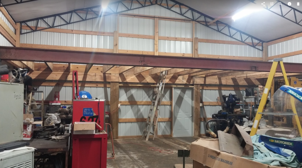

Mine came with a small 8x30 at the back, just wish I had a higher ceiling height.

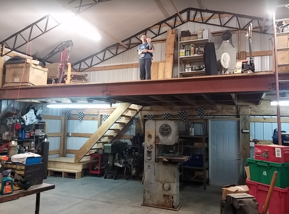

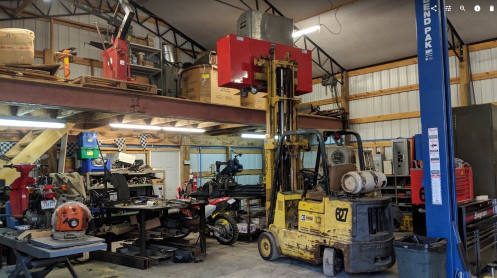

Mine has an over-engineered mezzanine over top of the 12x12 office/pisser. I use it for pallet storage and also steel storage.
