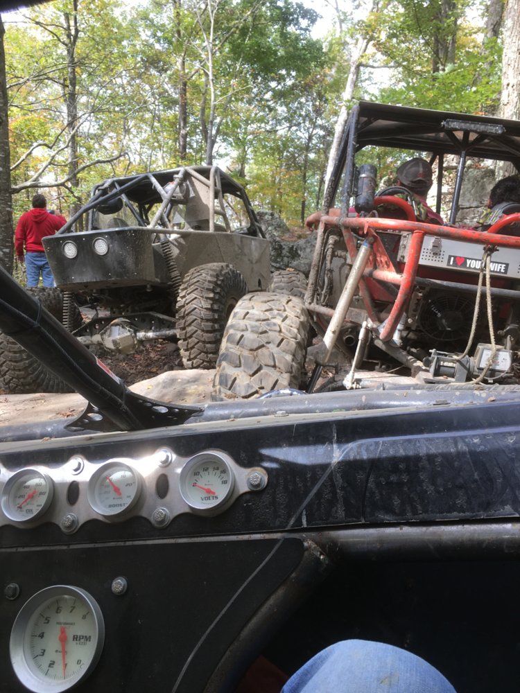

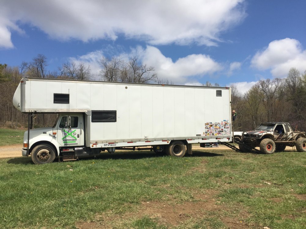

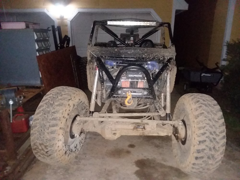

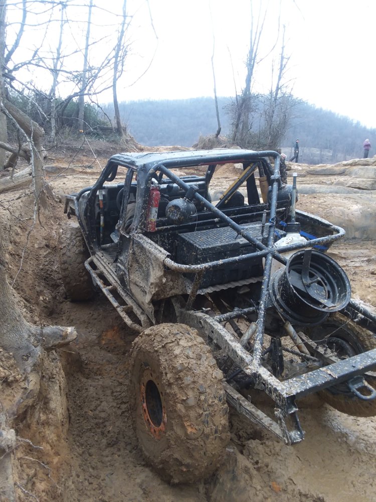

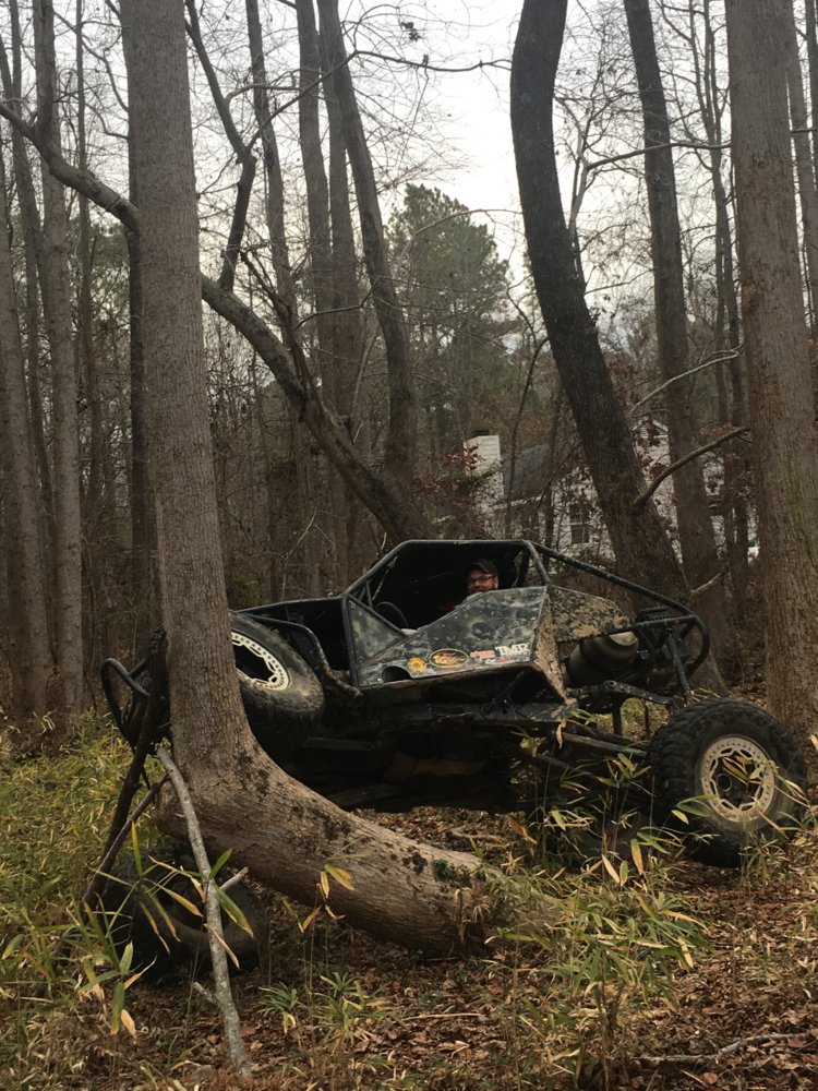

Any details or more pics of the rig with the "I Love Your Wife" sticker?
44f16ac2-af3c-4698-b084-a85ec2f9a96c-jpeg.256944

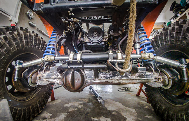

Its a old comp buggy with a 5.3 4l60 and a lovell tcase hp 60s front and rear and i dont think it had a straight tube on it lol but it works amazing

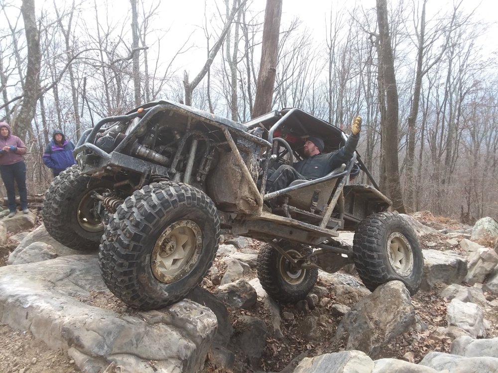

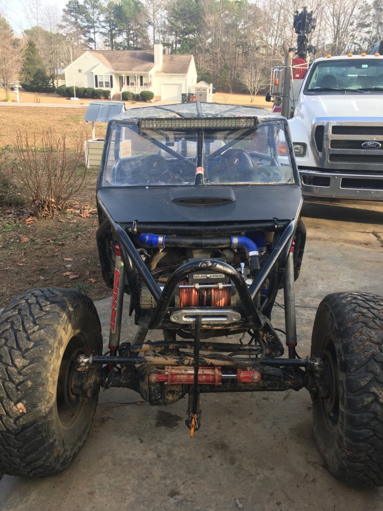

I had a very soft front suspension and every bump in the trail that had some speed would bottom out the front end, also my front end would flex out before my rear suspension would start to flex cause of my sway bar, so I pulled the front race runner 16” 2.0 air shocks( I bought used so I had nonetheless sea of what/amount of oil was in them). Dumped 250ml of oil. I had to run 180psi to get them with 5” of shaft showing at ride height. 5 wt oil is what comes from the factory. I had some 10w so I used that and I put 300ml in them and put 115psi of nitro and about 4” of shaft showing. It settled after I ran it around the yard and in the ditches and flexing it out on my RTI ramp. So we shall see what it rises like at wind rock

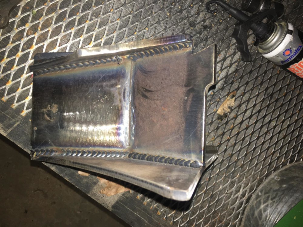

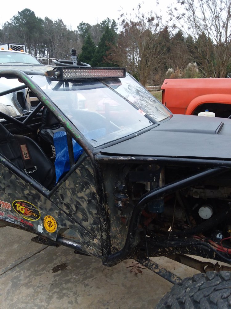

For a couple years I have had this lexan that comes off of rock breaker at the quarries. Heading to windrock next weekend so I thought I'd throw it up therenand see how much warmer we can be with it in.

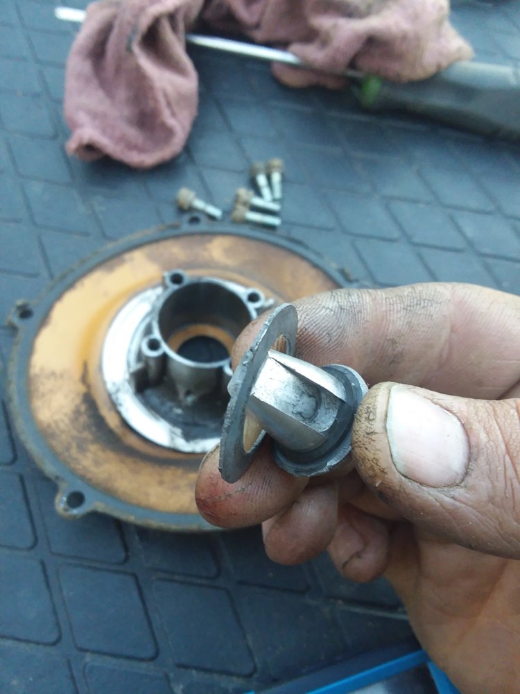

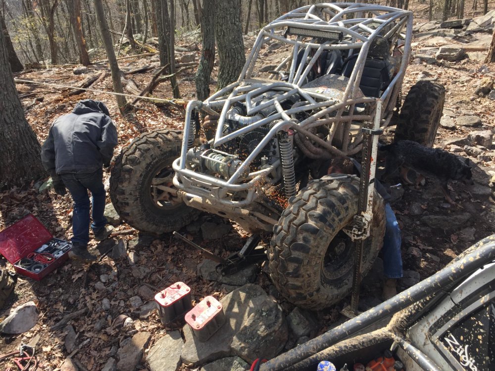

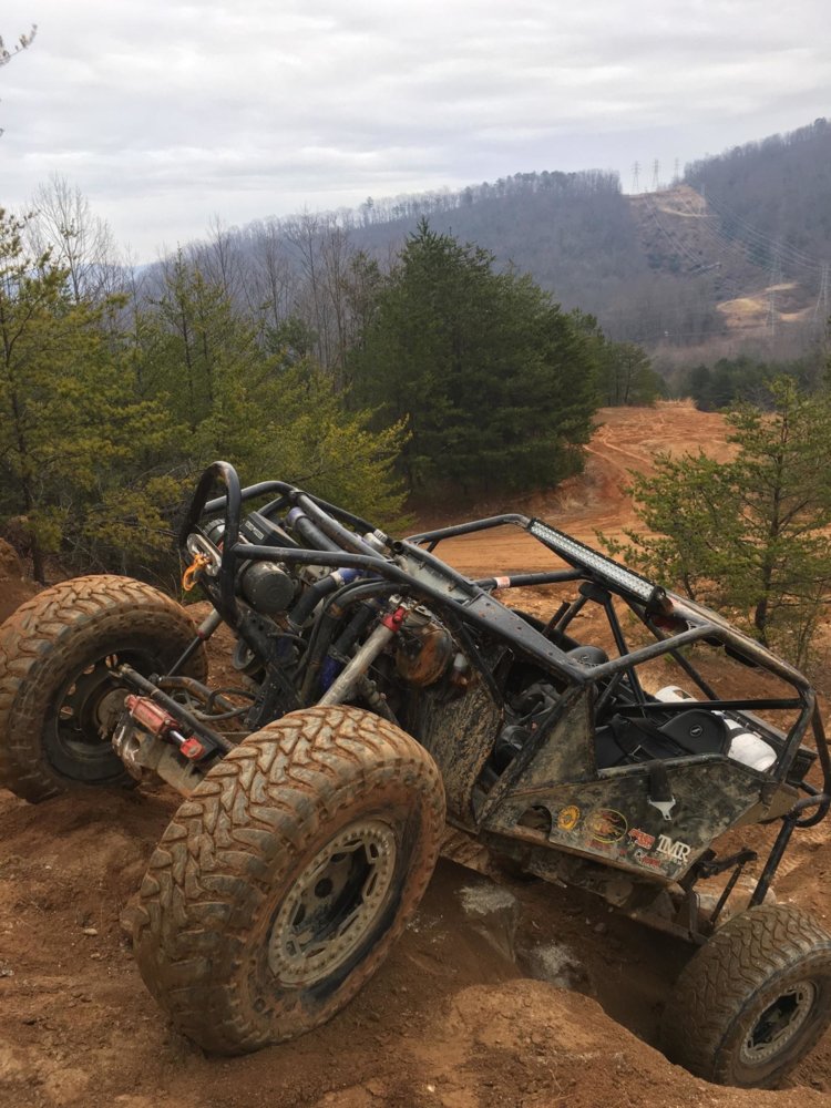

Went to the flats a couple weeks ago. Took my son. He thoroughly enjoyed it for the most part. He was a little scared at Times, but over all a good trip. Buggy did good, for yanked on by a winch more than I would have liked but ir was slick and drizzling most of the time. My propane mixer blew its diaphragm at the end of the day. Engine acted up and the backfired. First time this has ever happened. The center of the diaphragm broke in a circle. Gonna try and get Cary on rhe phone ro see what's the best thing to do.

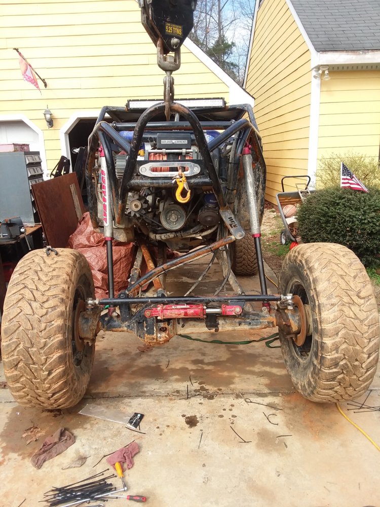

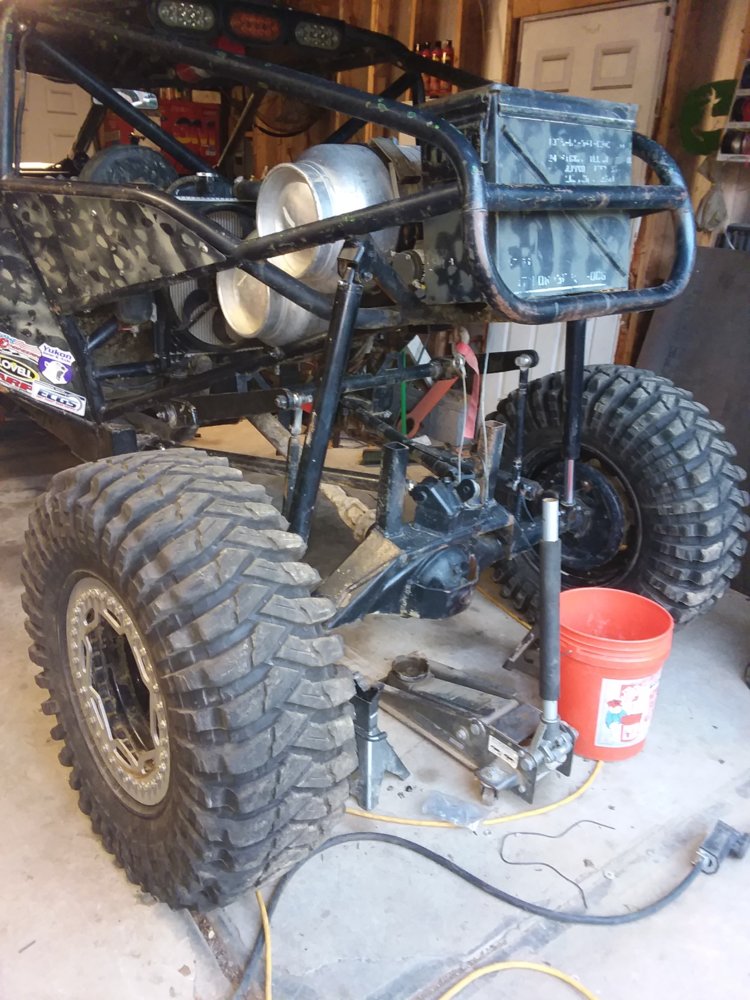

Been working on the buggy.
Working on new driveshaft,
Air bump mounts and pads
Resealing leaking areas.
Installed a wideband gauge
(Still running super rich)

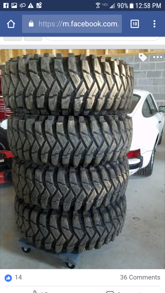

Picking up a set of new to me sticky treps
Hood mounting
Not alot of pics but gonna hit Gore VA this weekend to pick up treps and ride

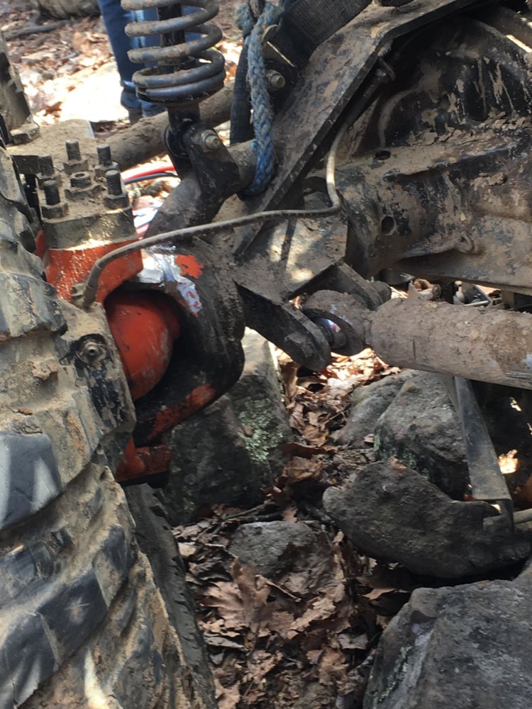

Bought a set of lightly used longs for spares a while back and pulled them out when I found a crack at the spline of the birfield of my existing birfield...one of those was cracked too...but looks like I have 2 birfs that are good so I'll keep the others as spares
