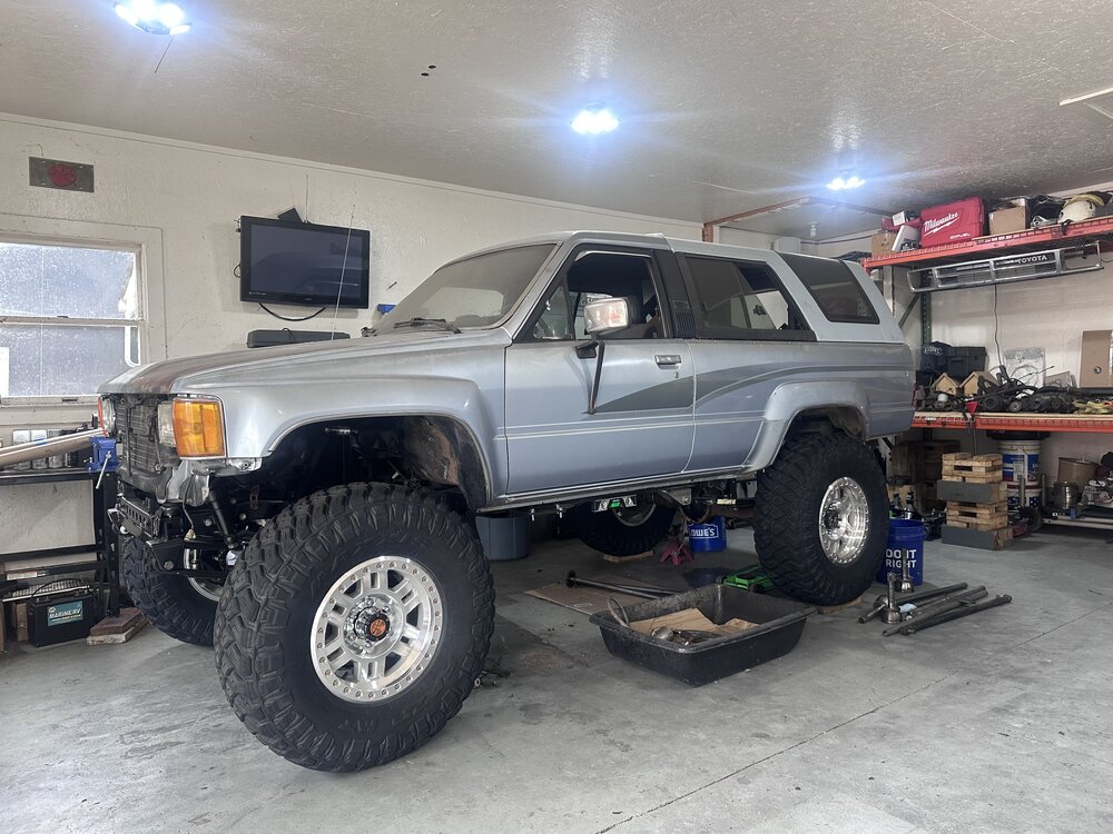

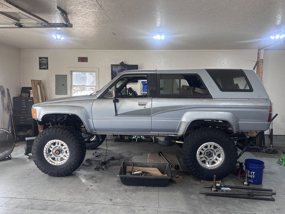

I've been very unmotivated to update this build thread with actual build updates. I have been pretty motivated in the shop lately, though. Not much readily apparent progress since the last pic. But, a lot has gone into getting it to where it is. Still a long way to go, but progress is progress.

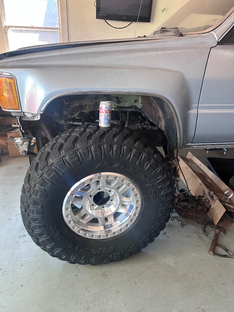

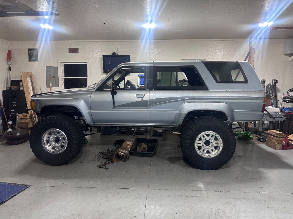

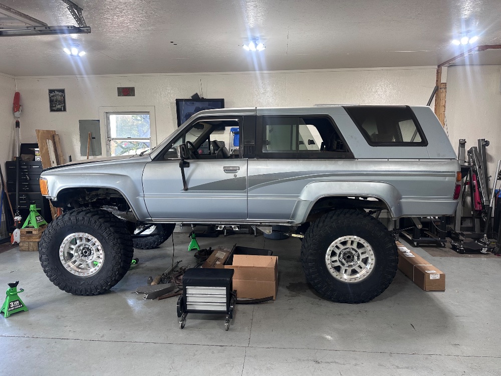

The front axle and suspension are 99% buttoned up. Still need to make brake lines and bump stops, and bolt up the shocks. But the front is ready enough for me to work my way towards wrapping up the rear.
I have a new dual case crossmember on the way, somewhere between Nevada and NC at the moment. The one I snagged with the dual cases "fits" my 4Runner, but not quite right. I *believe* it is actually for a 1st gen pickup. Instead of doing a bunch of figuring and fabbing, I decided to just pay that man his money and order the correct crossmember for this truck. Once the new crossmember is in, my drivetrain should be situated in the correct-er spot. That will then allow me to re-set my rear pinion angle, tack the perches on, mock up and tack in the shock mounts, and then pull the rear axle for welding out the axle and frame mounts. Then I'll get the rear axle cleaned, painted, permanently installed, and fully assembled, along with a kinda trick custom rear brake setup (more to come on this soon-ish).
That should about wrap up the suspension/axle portion of this build. Then I can move onto other things. I spent a little time working on the front bumper while I've been waiting on the crossmember. It's ready to be cleaned up, painted and permanently installed. Below is the remaining to-do list (big ticket items) floating around in my head:
