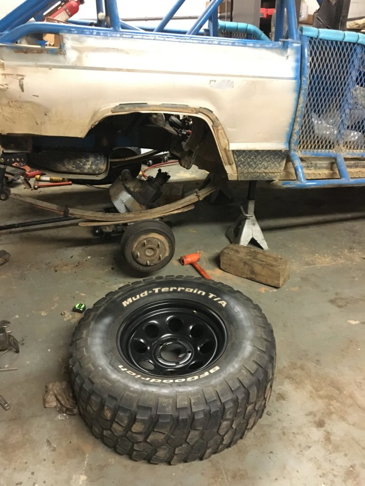

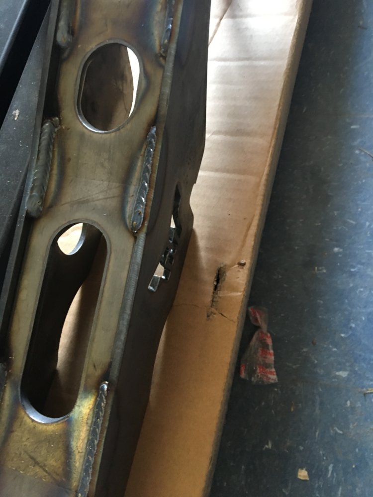

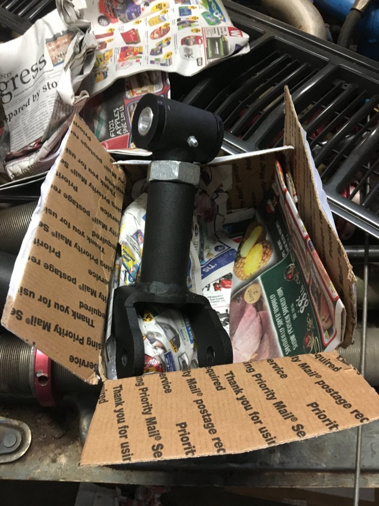

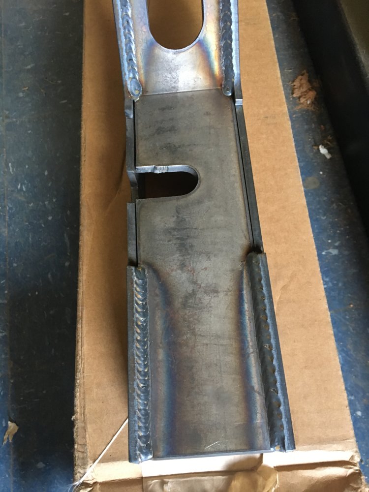

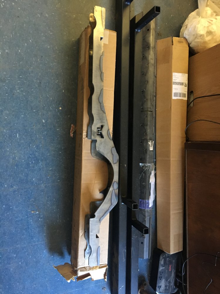

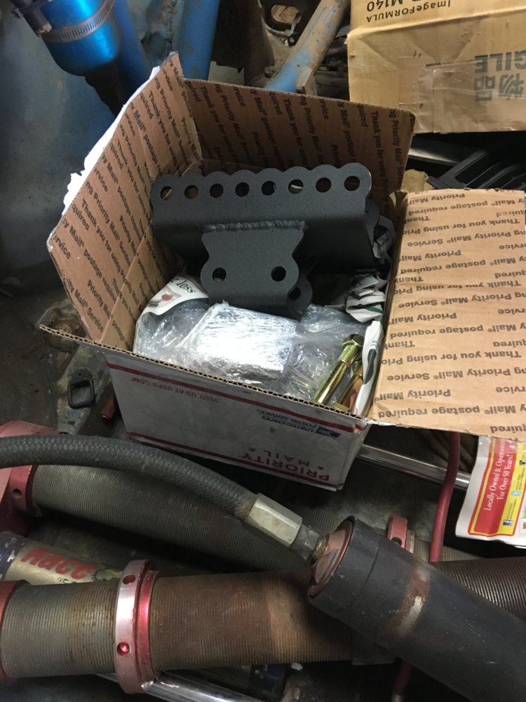

So this thing is finally going to get some attention real soon. Just ordered a shackle relocation box and adjustable shackle from Andy @ironman4x4fab.com hope to start work on setting up the rear 9" this weekend or next. Still looking for cheap parts or donations.....

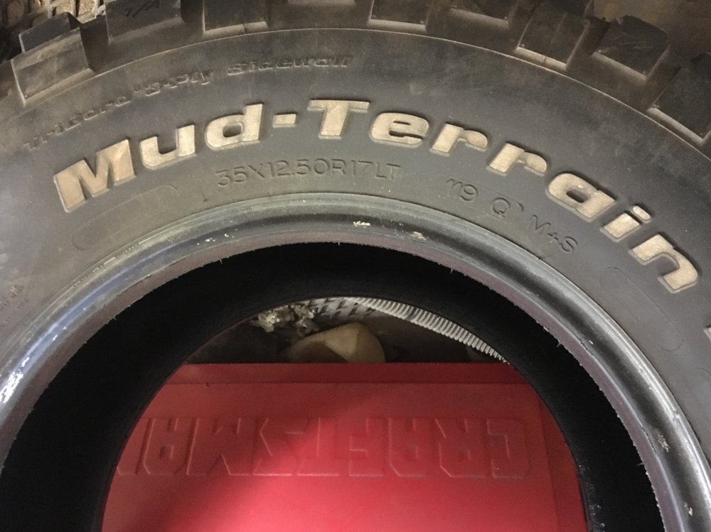

So finally got the last of the parts to put the rear end in... the tire will be for mock up and rollers until I can catch the 35” LTB on the blemish list.

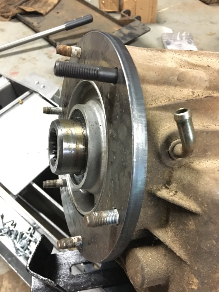

I've got a 241C transfer case. Do you know it that'll work for your front yoke?
I do not but I can count the splines today i you an check those. You sell the yoke and nut or whole case and how much?
Looks like 30 splines to me. I don't have a caliper to measure it. My plan was to go back to the pull a part and get one but it's been hard to find the time. Hell I got shiney new Ironman4x4fab parts and havn't been able to get them installed......

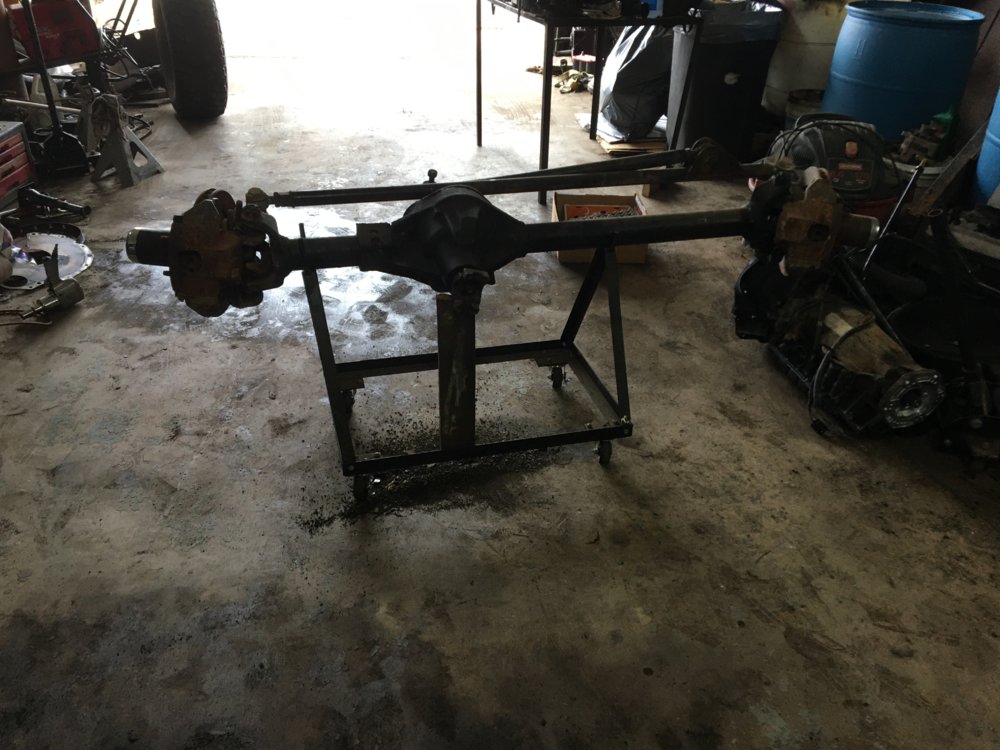

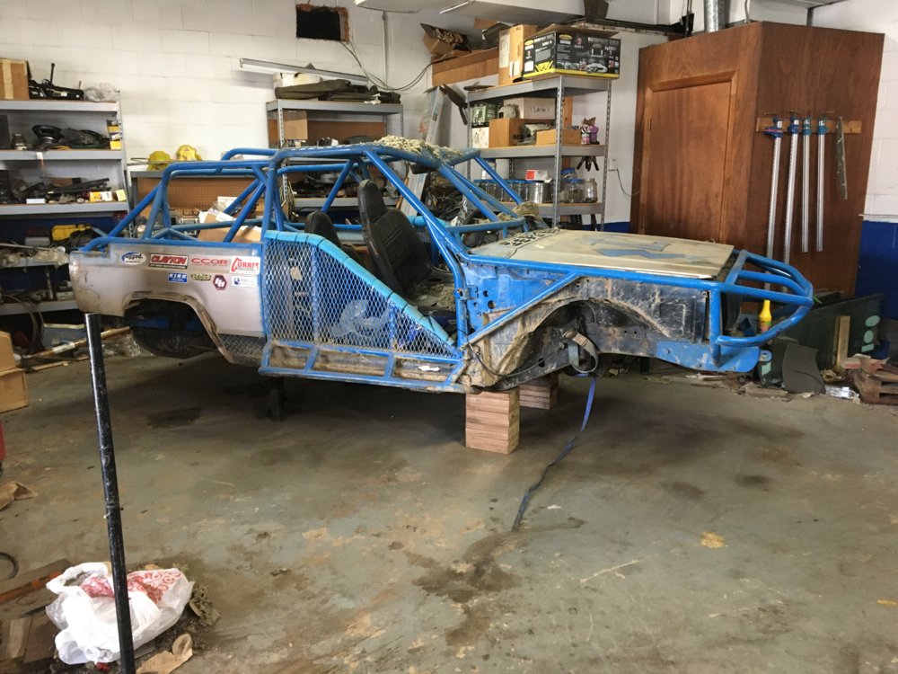

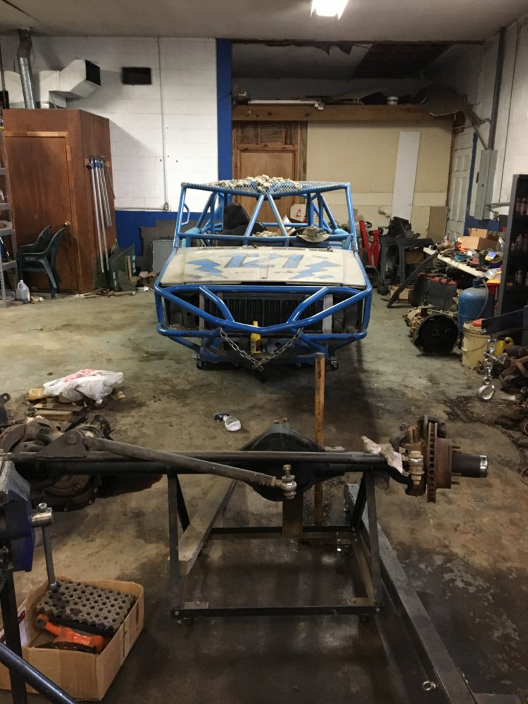

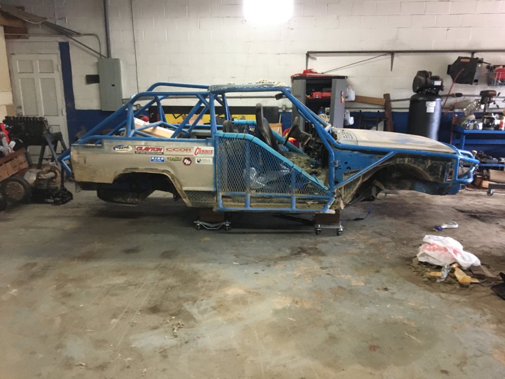

So today it began.

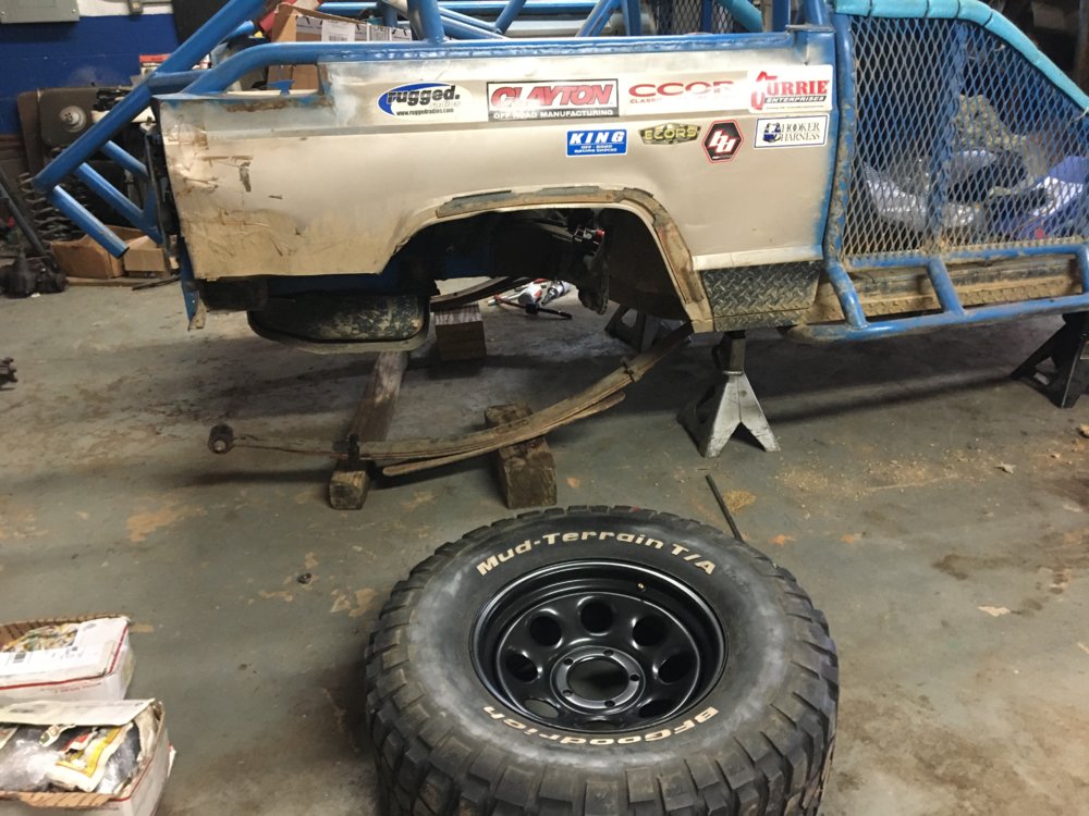

Moved the axles out from under the jeep.
Cleaned up under it and set it on Harbor Freight car dollies.
My sone and rolled her into the build position.
Installing MJ leaf springs.
More to come.

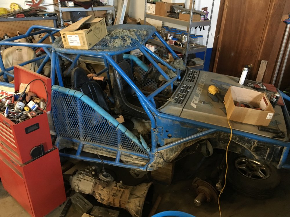

More progress today..

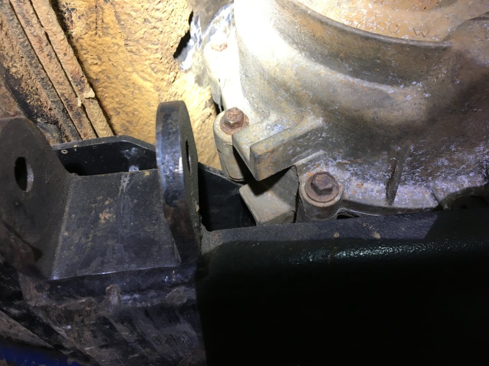

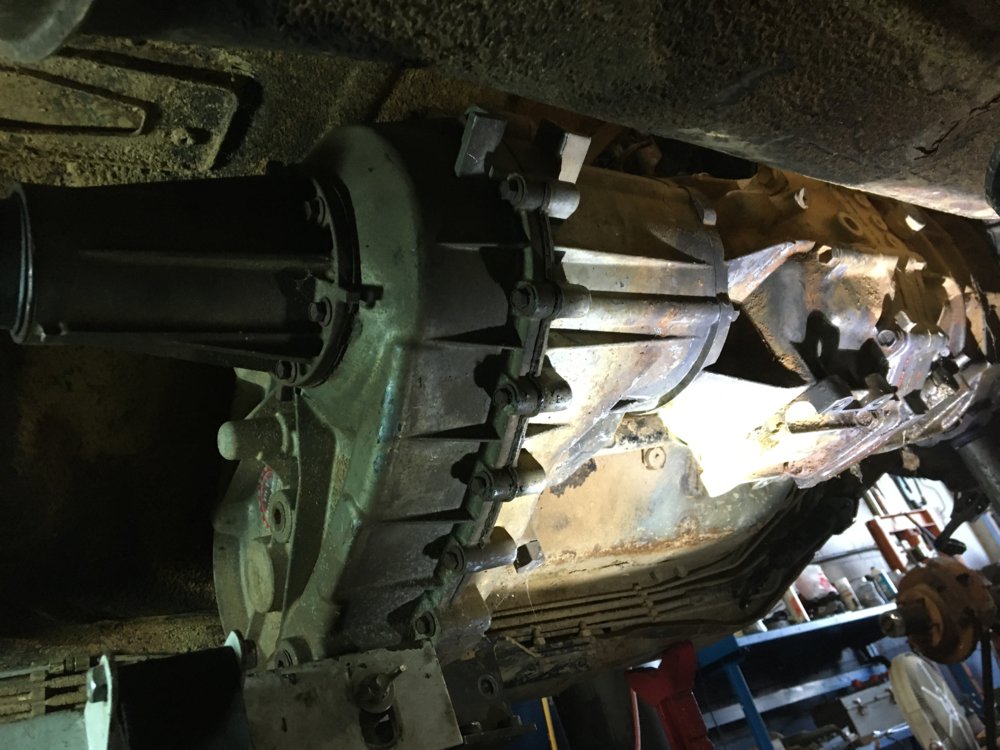

Installed the ax-15 and the 241D. This Jeep came to me with a RE long arm cross-member. The 241 clears everywhere but that one bolt. Plan is to clearance the case to match the angle of the RE long arm mount. Eventually I'll go see Ironman Andy and see i we an it his 4 link in there but right now goal is to et this thing mobile.
Why not just clock it up a few degrees so any future case will clear without mods?
Just a thought.
. Factory ax15. Factory 241. Is there a clocking ring or other option over re-drilling the ax15?
Any of the D300 clocking rings will work. Same BP. Just make sure you have enough engagement in the splines
Or just redrill the extension housing
Never seen them or dealt with them. This case is tight but clears everywhere but that one bolt boss. I'll look into it.
It’s mega easy to re drill. Once you have a template it only takes like 20 minutes. I hate drilling aluminum though!

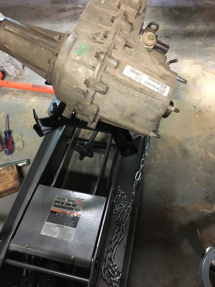

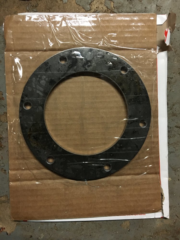

Spent some Christmas monies on a better transmission jack and after doing some invoicing removed the transfer case.
Thanks @4wheelsupply for cutting me a spacer.
Went to my local Ace and found these studs. 3/8 16 the same length as what goes in the t case. Using a screwdriver as a depth gauge I'm pretty sure they will work perfect. If not I'm thinking a washer will keep the nut back enough. Bad idea or should I look for a stud with the 3/8 24 threads cut lower?
