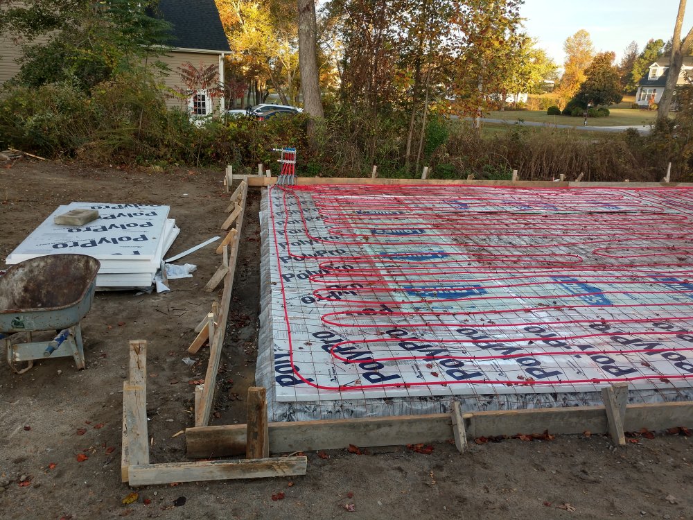

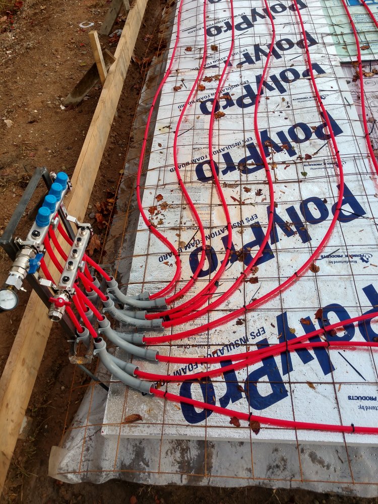

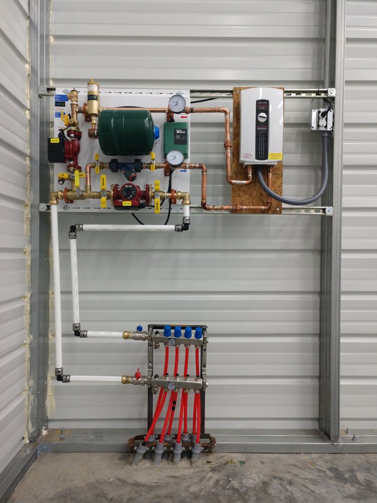

good question. I installed it earlier this year when i built the garage. haven't needed to fire it up yet.
Electric instant hot water? How expensive is it to install? Did you install yourself or did you have it installed?

did it myself. The shop is 28x40 have about 6" of insulation in the walls and r13 on the ceiling. so far haven't needed the heat. have about $550 in the pex and manifold and about $2k to finish up with the panel and 10k heater.
used this for a guide ended up using the "heat sink" slab design
The Slab on Grade Installation | | DIY Radiant Floor Heating | Radiant Floor Company
https://www.menards.com/main/plumbi...4726-c-8521.htm?tid=511941231281877254&ipos=2
https://www.menards.com/main/plumbi...ectric-microboiler/sh3-10/p-1444433731612.htm
