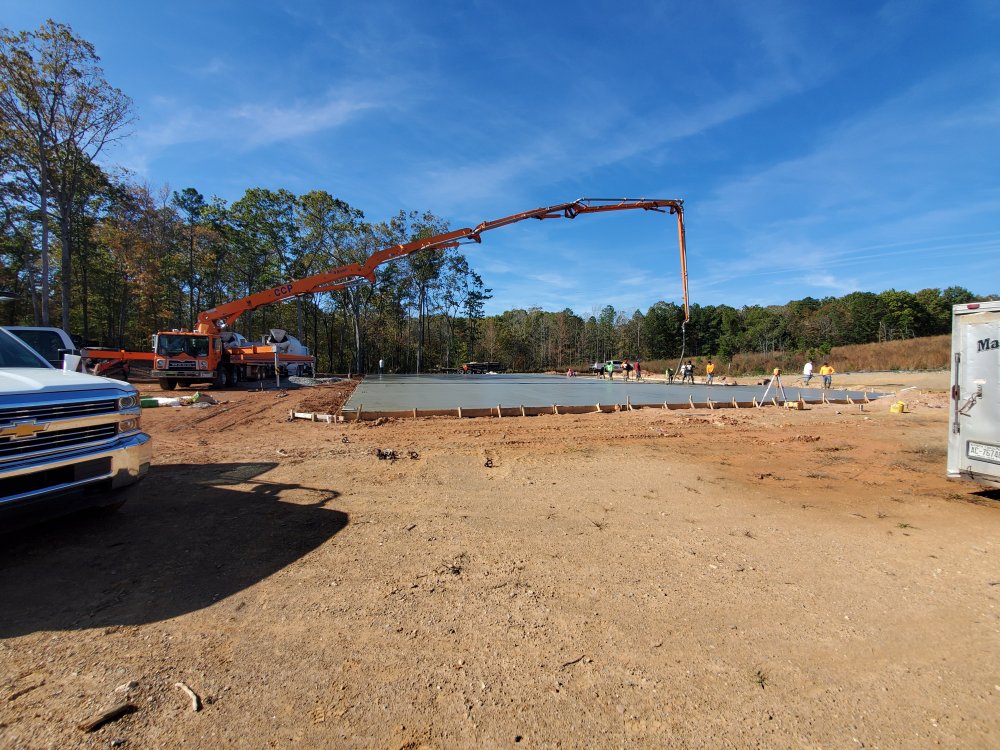

You will have to have a concrete pump truck so be prepared for that extra cost too when pouring.

I hadn't thought about having to pump the concrete.
How much more expensive is that?

I would budget $200/hr for a pump truck. It might not be quite that much, but $200/hr will ease the pain if it comes in at $160ish
Dude is talking about an 8000sqft shop with heated floors. A days worth of pump truck rental aint gonna matter.
