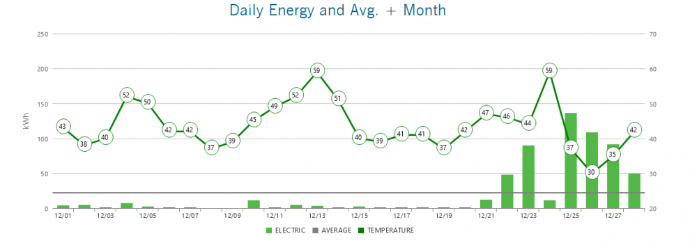

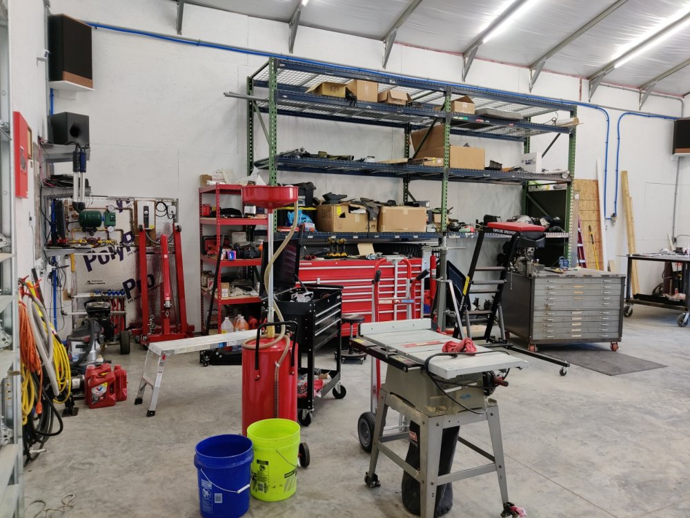

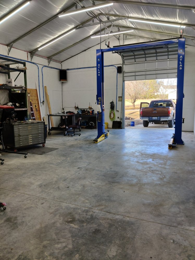

I fired up the radiant heat for the 1st time last Tuesday about 6pm. here is the energy used so far.
the shop is 28'x40' with 14' side walls. insulated on the walls and ceiling.
the tank-less electric heater is 10kw.
the thermostat on the wall it was set to 60 initially but, turned it down to 57. i don't have a probe in the floor.
after about 15 minutes in the shop i'm down to a short sleeve shirt and comfortable.
my feet love the warm floor.
