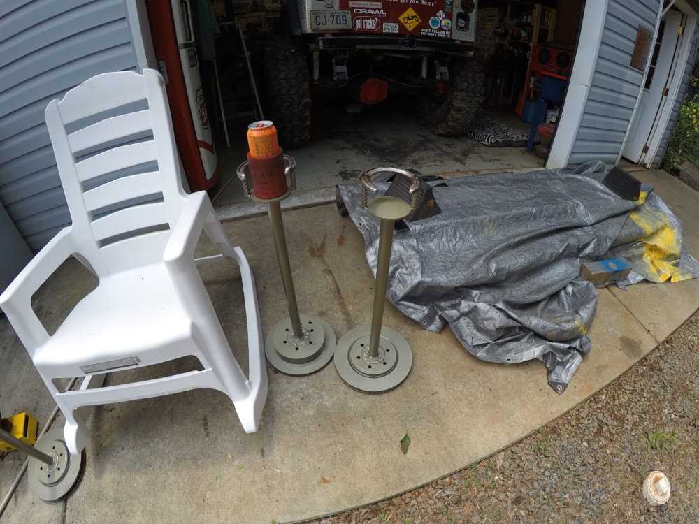

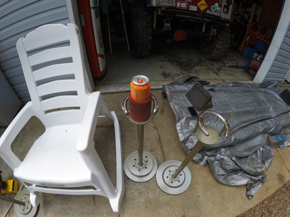

The pooper chair is missing a bucket. Must have been that chick from the other thread that stopped by. Pay $5 so you can get in the garage. :lol:

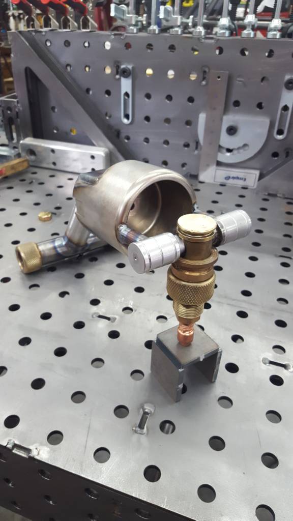

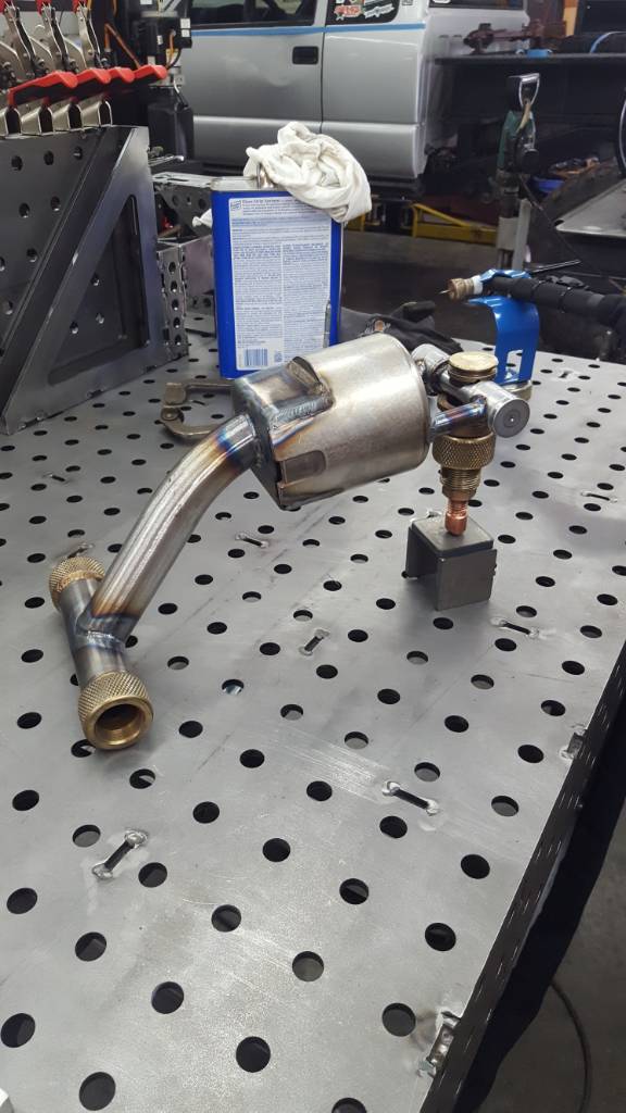

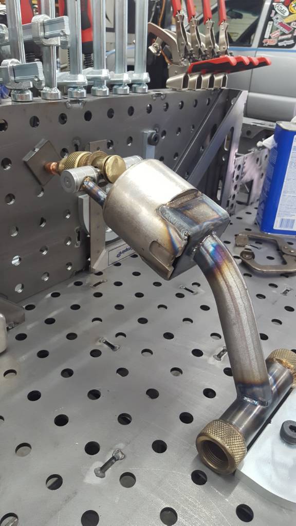

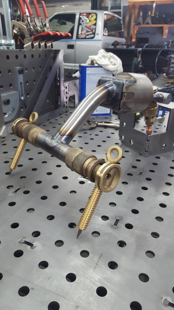

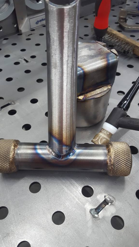

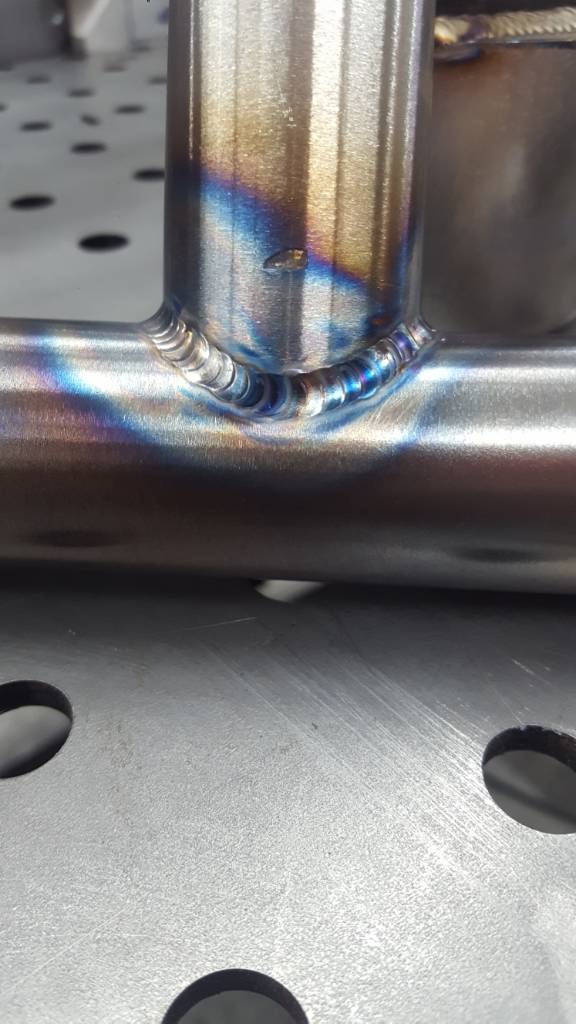

Cobbled together a "third-hand" for my welding table.
Used some odd scrap metals I routinely collect from the electric company - mostly lineman pieces; brass, copper, some type of hydraulic crimping tool parts, and of course some 1.5" DOM tubing.
Brass feet, copper work tip; (to prevent arc blasts on a work piece. Rotating head, for extra adjustment from perpendicular to vertical. And leg extensions if it needs to get up and over the work piece better.

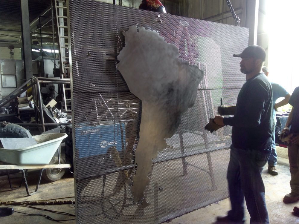

Sneak peek at one section of a World map we're building as an outdoor learning display for the public library. As if they didn't own enough of our art projects. :lol:
All .250" 3xx stainless segmented and installed in place. Overall dimensions of the map will be something like 20'x 60'. If I'm not too busy cutting everything on waterjet, I'll be out on site erecting this Goliath of an art piece. Will be following up on this as it progresses.
Started with South America.
Let me know when y'all get to installing all this stuff. I work across the street from the library.
Joe and Jason have been out there already. Will do!
That's awesome! You must have a blast at work.
My hand works great. Just don’t set them down.
Well, you never know when you'll have a "hold my beer and watch this" moment. They can happen anywhere. It's easy to tell you're hanging out with the right people when there's nobody left to hold the beer. :lol:
That’s when you chug it. After the “hey y’all watch this” moment, grab another cold one from the cooler while waiting on the ambulance.
Some of us are getting too old for that kind of fun.....

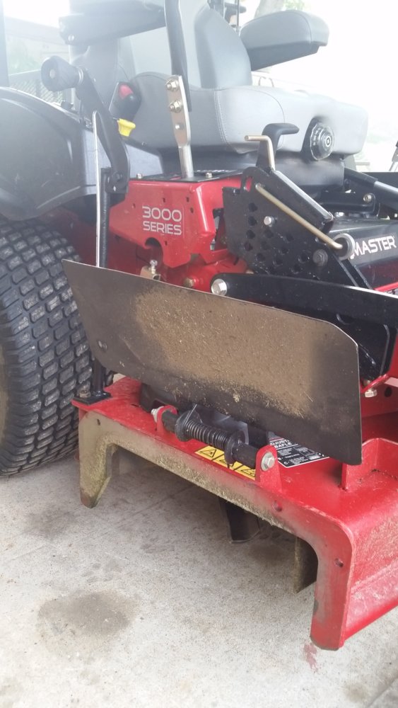

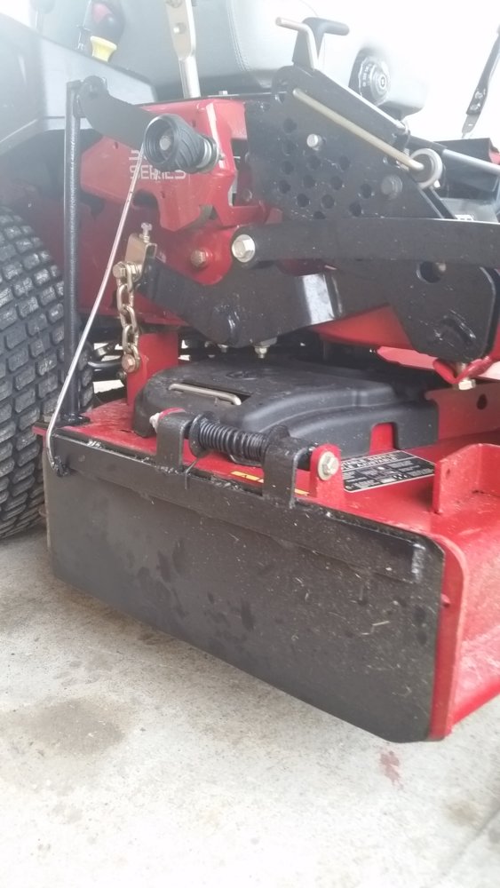

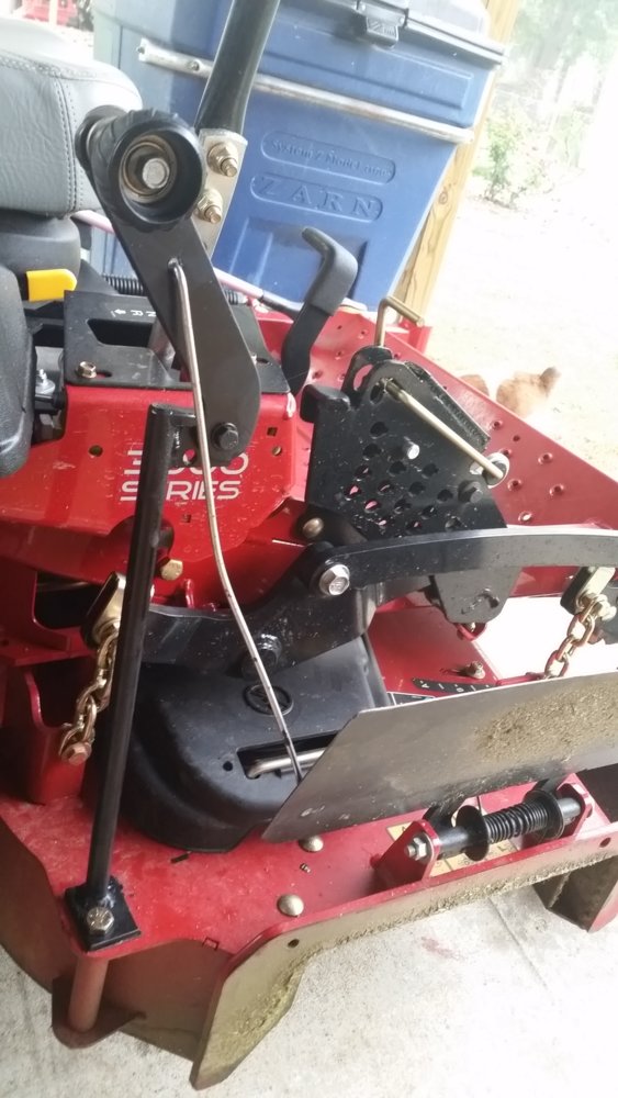

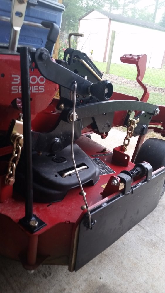

Well, after some fabbing I built a nice grass flap over a few nights for my zero turn. It is basically a discharge blocker for mulching that can be opened and closed from the seat.
They sell for over 300 depending on the brand, I am proud of my home made model.
The handle simply overcenters against the spring on the flap (the spring pulls the flap into the closed position) which is self locking at that point.
Works like a charm, uses all factory holes so I did not drill into my mower and I could take it back stock in a few minutes.
I fabbed every piece from scrap I had and the knob was an old steering wheel ball I had.

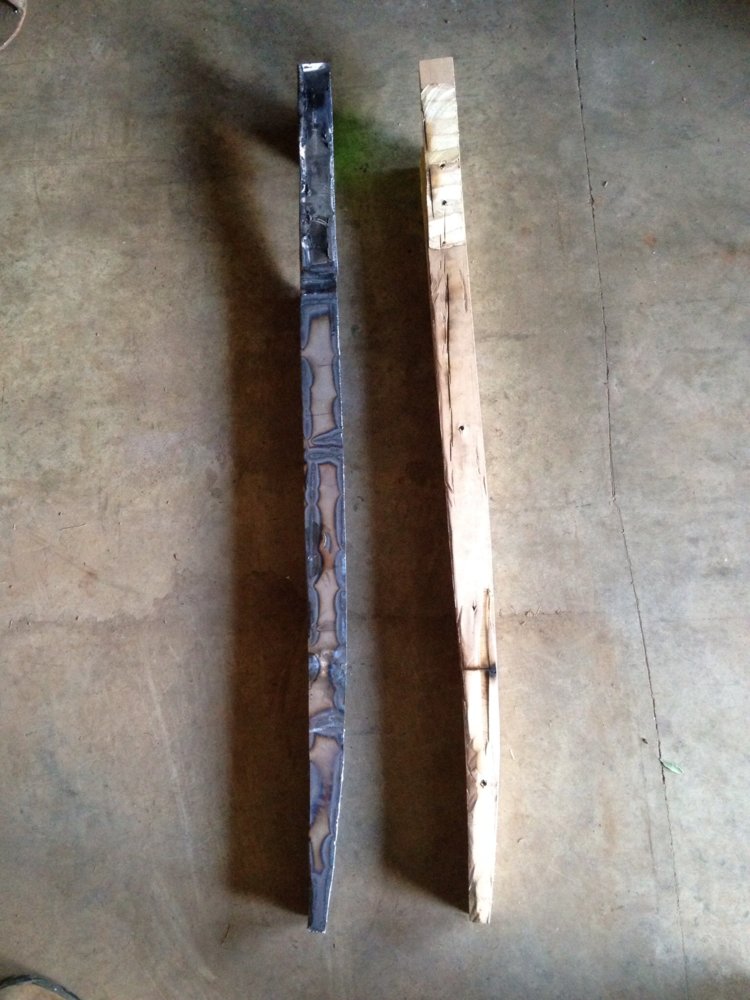

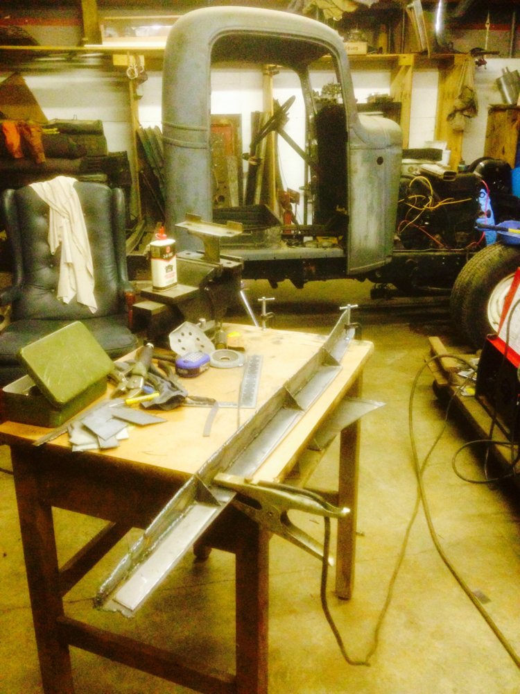

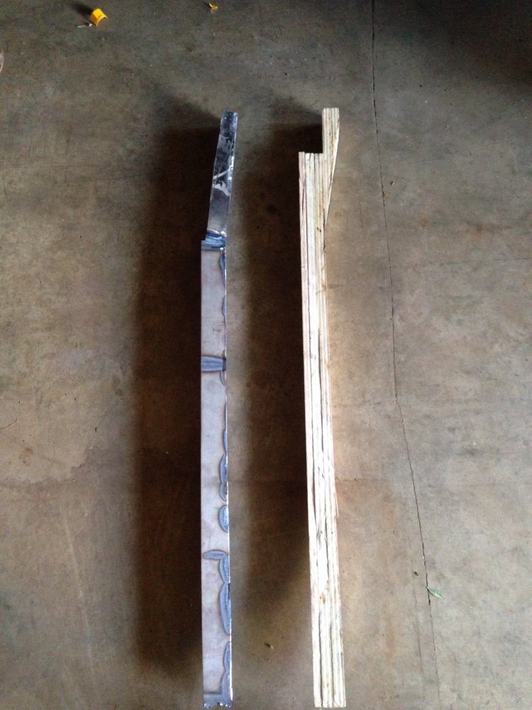

My feeble fabrication attempt at some replacement door post for my '36. I made some plywood templates that fit pretty good as a guide for my metal. This would be the appropriate time to call something cobbled :D. But I think they might hold the doors on.....maybe
