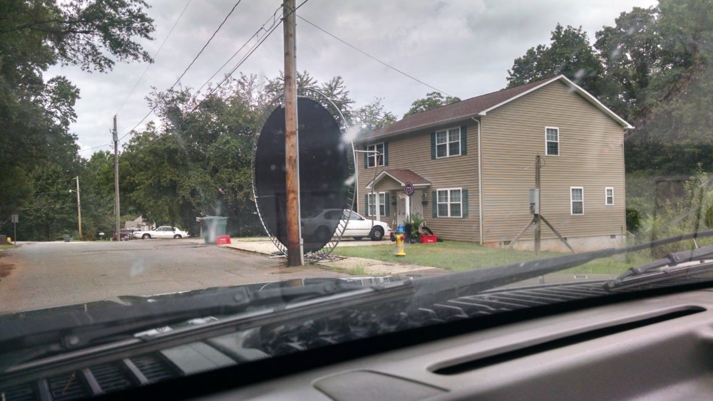

I don't know. No wind storm. I just don't know.
