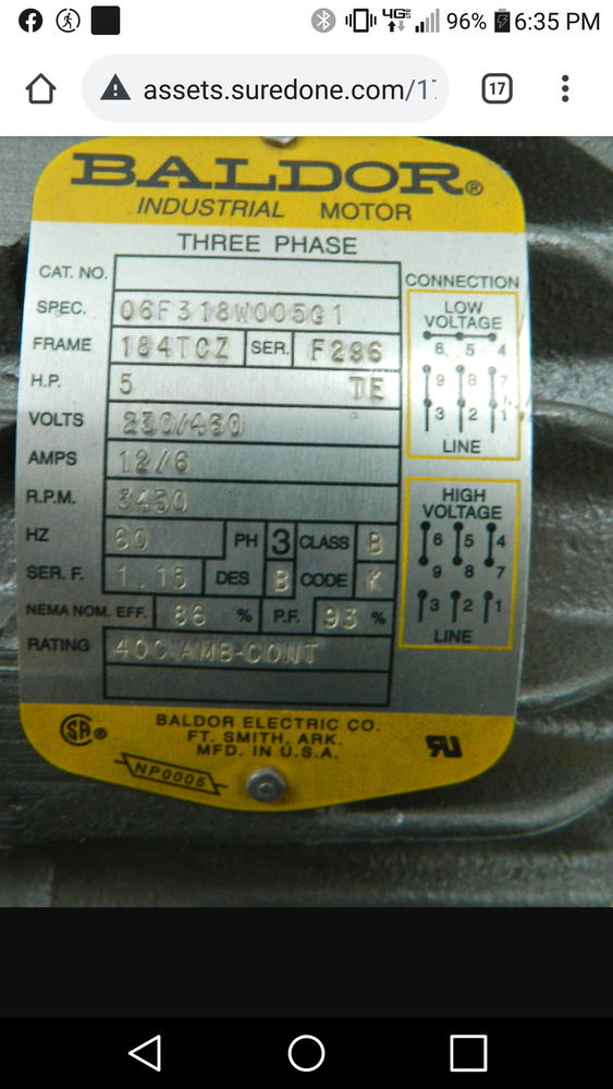

So I assumed our "electrical" guy new a little sumthin until magic smoke was exposed.
Guess I was wrong. ( conclusion of random thought )
He wants me to take the blame for calling out the high side pairs and then just saying 1,2,3 is left. He was acting unsure so I just read the plate to him. More he didn't have a clue.
He tied 1,2,3 together. And the diagram was right in front of him.
Man can run conduit and pull wire like a boss.....I guess he hasn't done much of the finish side. Uuuuuggghhaaa.
Pic for reference.
That's pretty bad. 480v 3ph is the most simple wiring setup ever. I'd much rather wire up those than 220v 1ph any day of the week.
At least with his mistake, the motor should be fine. Just $30 worth of new fuses and rewiring the motor and you're back in business.

Naw I he had it a bit more screwed up. Hitting go was an instant smoke show. Ohm checks verified its a welded block of scrap inside. Along with another batch of blown fuses in the buss.

What did he hook the incoming lines up to?

He tied 123 inside together and one line incoming to each of the other three pairs. Completely fubar.
I have never heard of someone wiring a motor that incorrectly. That's downright impressive.
