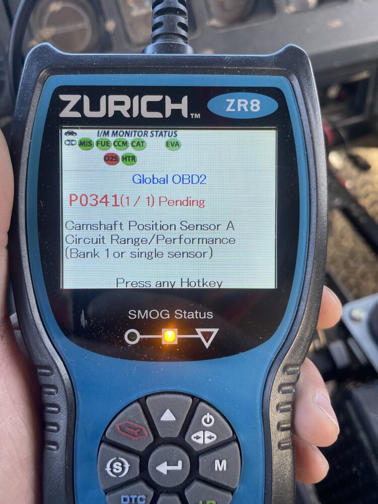

Once we got back home, I threw the scanner on the jeep just to view some live data items and was surprised to see this code. When I had the motor out, I replaced the oil pump, front cover seal, and front output seal. Of course I didn't replace the timing chain like a dummy so I might be on the path to doing that :dumbass:

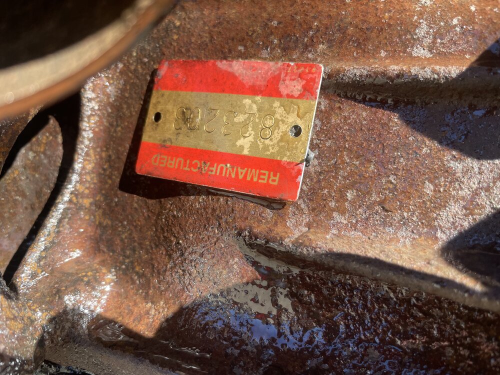

Sunday I got a little time to start cleaning up the new-to-me motor for the little YJ. All openings were taped off, it got sprayed down with purple power, and then pressure washed. While cleaning the block, I was greeted with this reman tag. I was told this motor came out of a 97 TJ with roughly 120K miles on it. This tag now tells me it has less than the 120k reported miles. I still plan to open it up and inspect/regasket everything but I feel more at ease about what I'll find now.

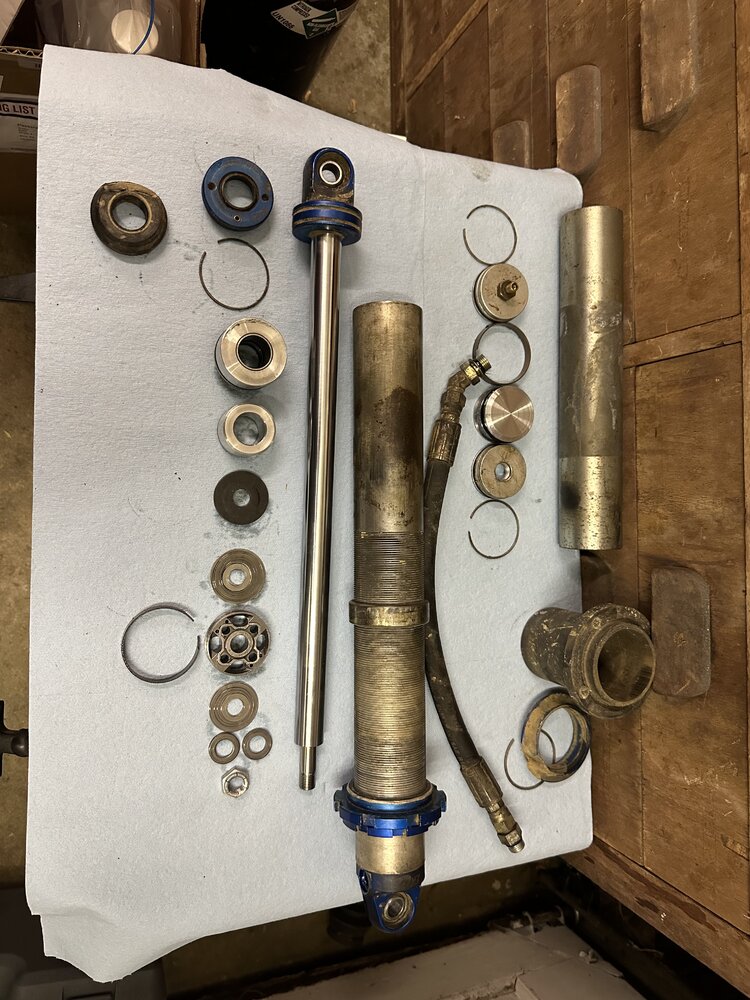

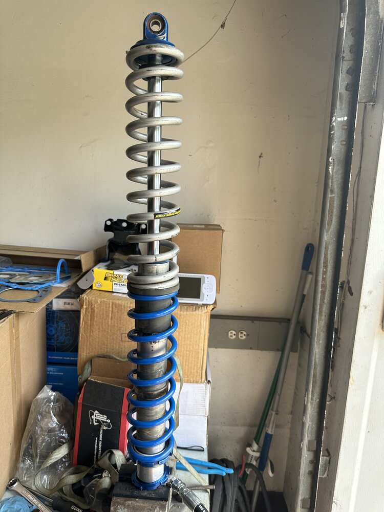

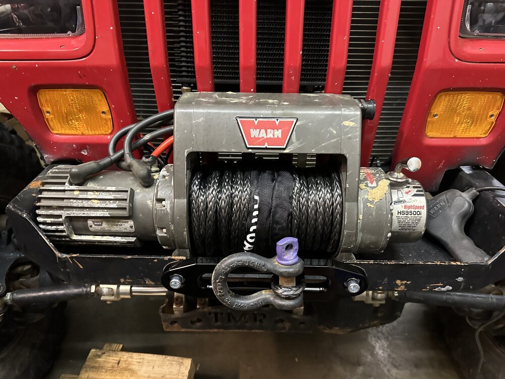

Fast forward to this weekend and I’m getting things ready for a trip to the ranch next weekend. Pulled the front coilovers to finally rebuild them. Also swapping the lower spring for one slightly stiffer and we’ll see how that goes. Rebuilt the warn 9500hs and ordered new line for it. Battery terminals have been replaced (ultimate cause of winch issues at windrock). Had the vss go out and put the trans in limp mode. Wiring checked and all was good. Ordered a new sensor and it should be here Monday. Also ordered some hydraulic bumps for the front but highly doubt I’ll get around to getting them installed before this ride.

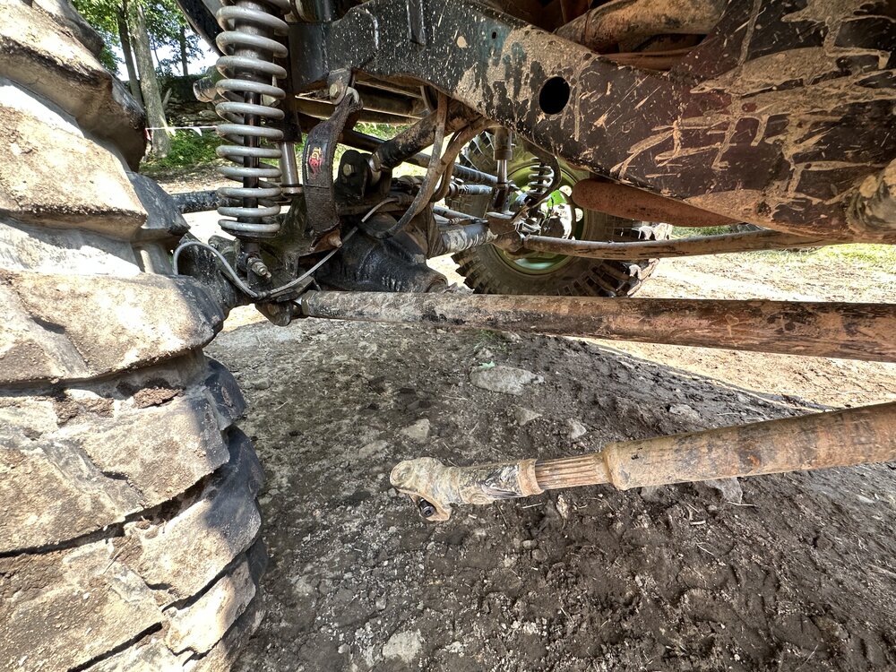

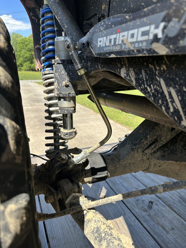

A couple weeks late but the ranch trip went great. My new favorite trail is Jimmy Hoffa. Jeep did well and, until I loaded it on the trailer to head home, I thought it made it through the weekend without any damage. When strapping it down I found a bent sway bar link and mounting tab. I’m 99% certain it happened on cripple creek because it was the only time, that I’m aware of, the passenger rear was very stuffed into the bump. A new link was ordered and I’ll straighten and strengthen the tab.

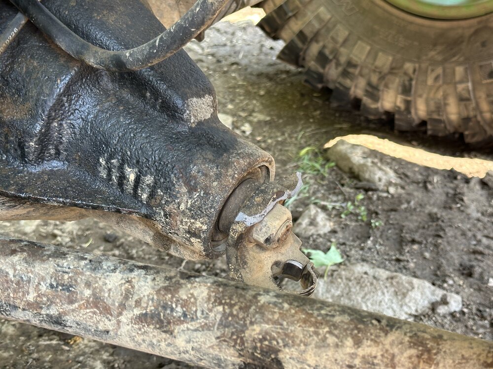

Joe qualified 7th of 18 on Friday which was great. We wheeled Friday afternoon and all day Saturday and then Joe competed Sunday morning. Unfortunately, the competition was short lived as his upper link decided to identify as a taco thus killing his front pinion yoke. The day ended there but it was still an absolute blast.

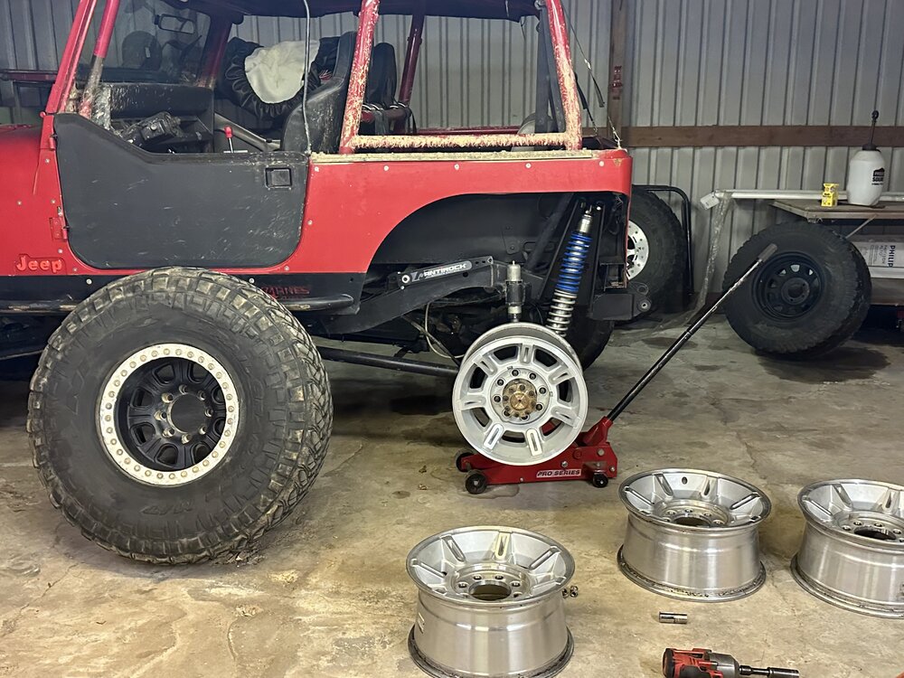

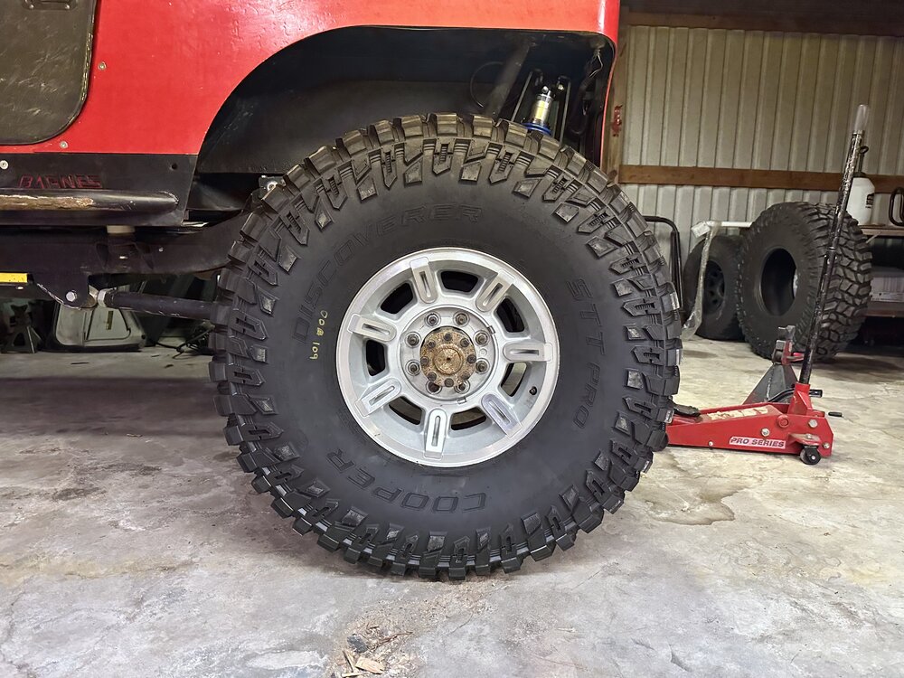

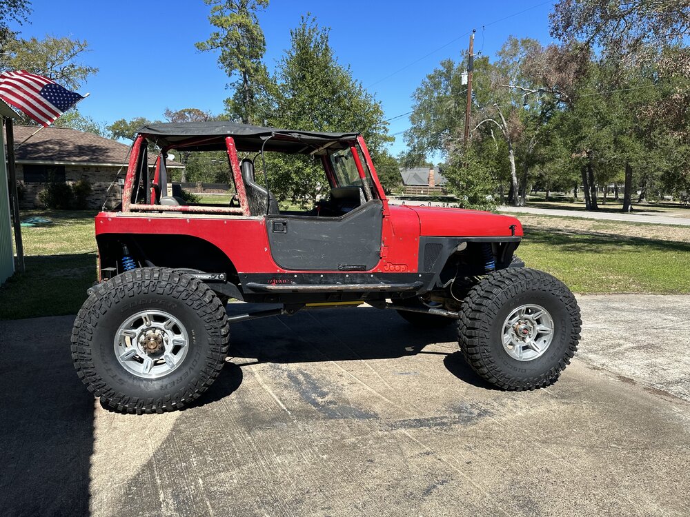

Well a lot has changed in the past 4 months. The rig is still doing well and I’ve fixed the sway bar links. Also bought a set of H2 wheels, some STT Pros, and swapped the rear spool for an ARB for some street use.

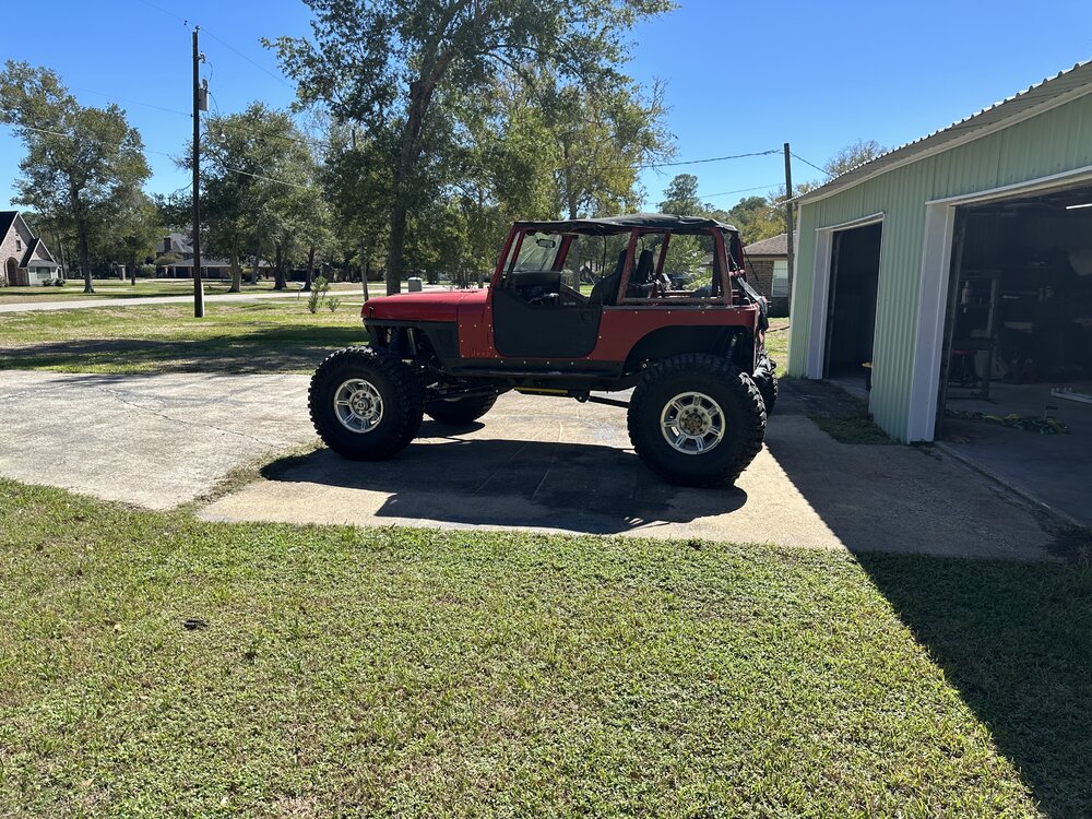

The biggest change, however, is that I now have a new home, a garage, and a shop. The catch is that I’m no longer in NC. My wife and I made the move to Houston, Tx. Why the move? My wife’s family are all in the Houston area. She and I had been talking about wanting to move down here for years and, after some medical issues that hit me back in December (had a stroke), we decided it was now or never. Moving away from the physical NC off-road community and the Misfitz has been tough but we’re incredibly happy down here. My son has absolutely fallen in love with Jeep rides (hence the street setup changes) and can’t get enough time hanging in the shop with me. I’m still making regular trips back to NC for work and will continue to do so for the foreseeable future.
