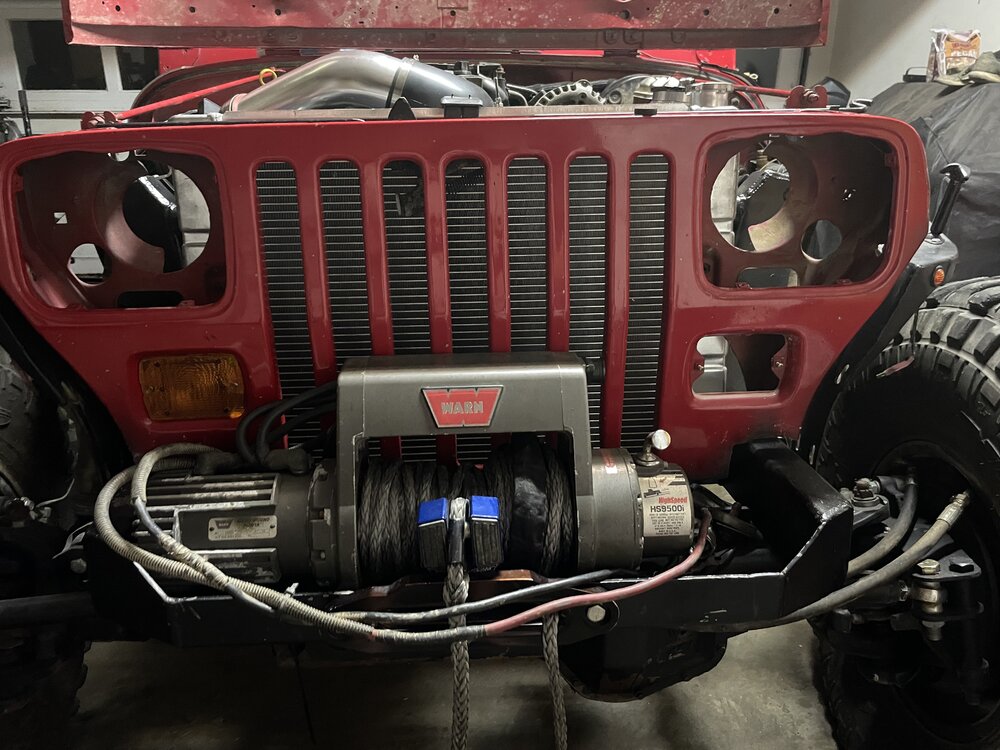

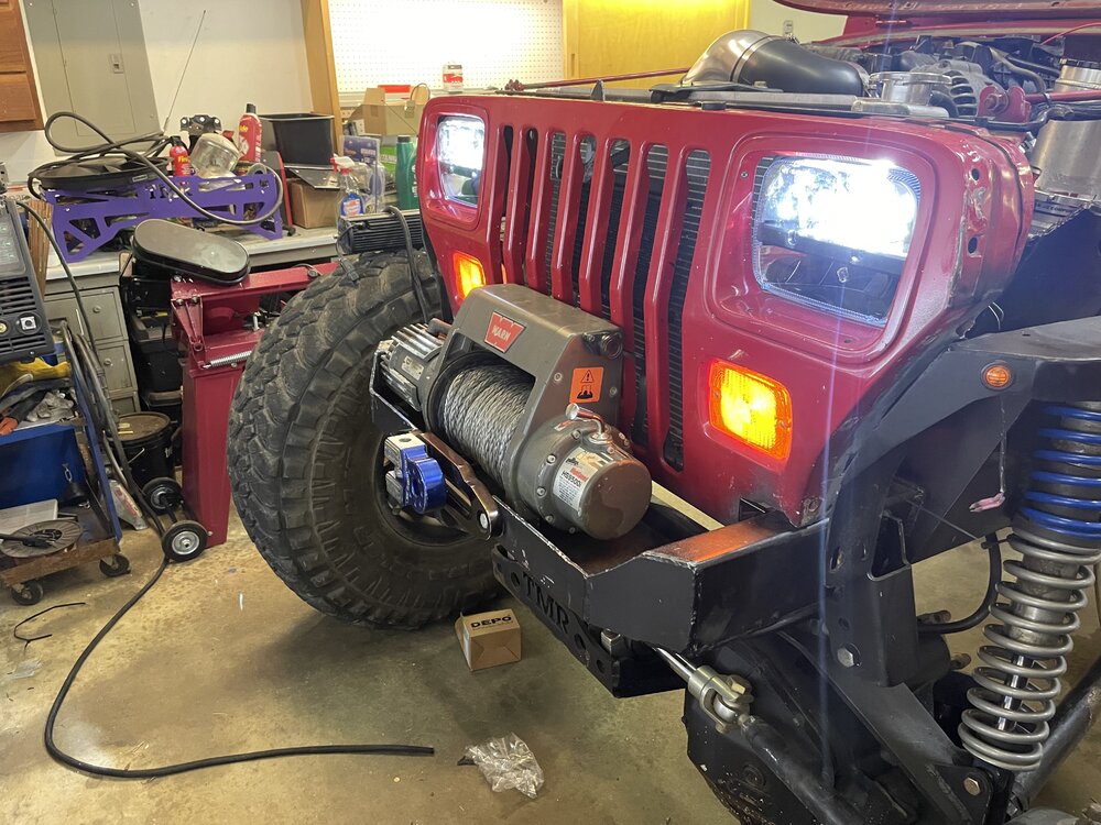

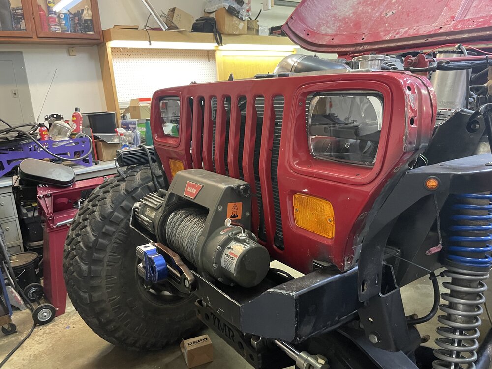

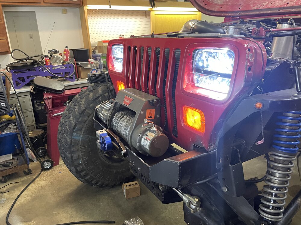

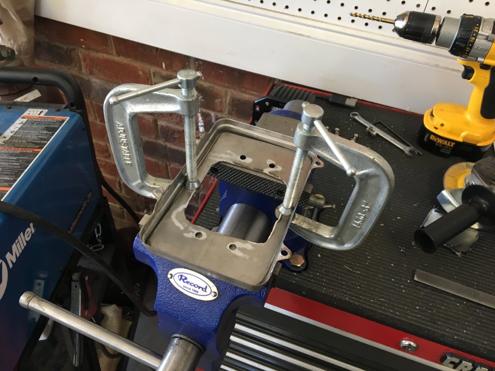

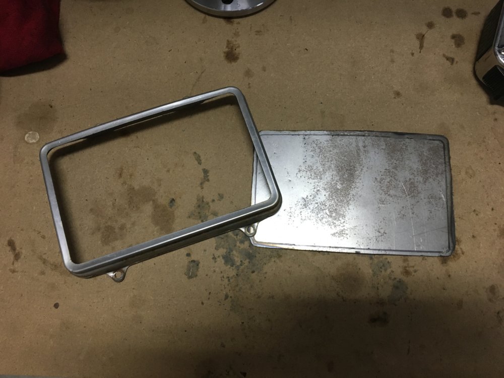

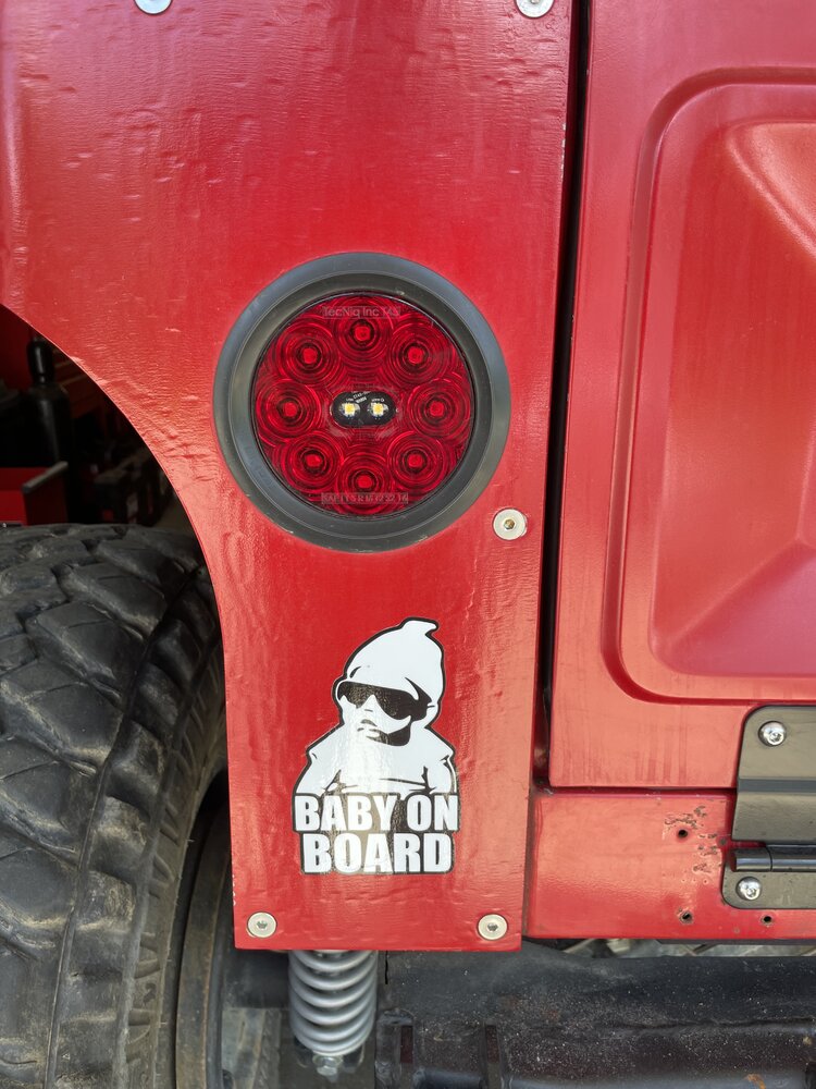

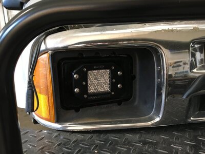

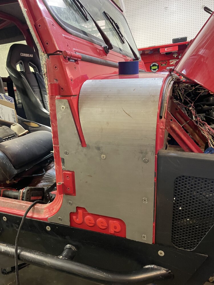

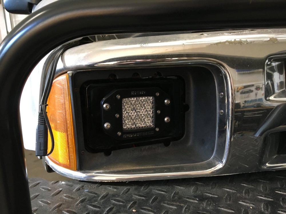

It very well could since the lenses are from 94 and are already cracking. New ones are on order just in case. To gain the maximum clearance with the radiator, I’m actually going to be machining down the cooling fins on the back. These LEDs are too bright for what I’m using them for so I’ll use resistors and drop the voltage which will then mean less heat so less cooling needed. After the cooling fins are removed/trimmed, the pods will be much lighter.
All this sounds great in my head and on paper but we’ll find out if/how long they last.
I did something similar with the headlights on my old S10 build. You can always use the orange lens as a template to make something from steel.

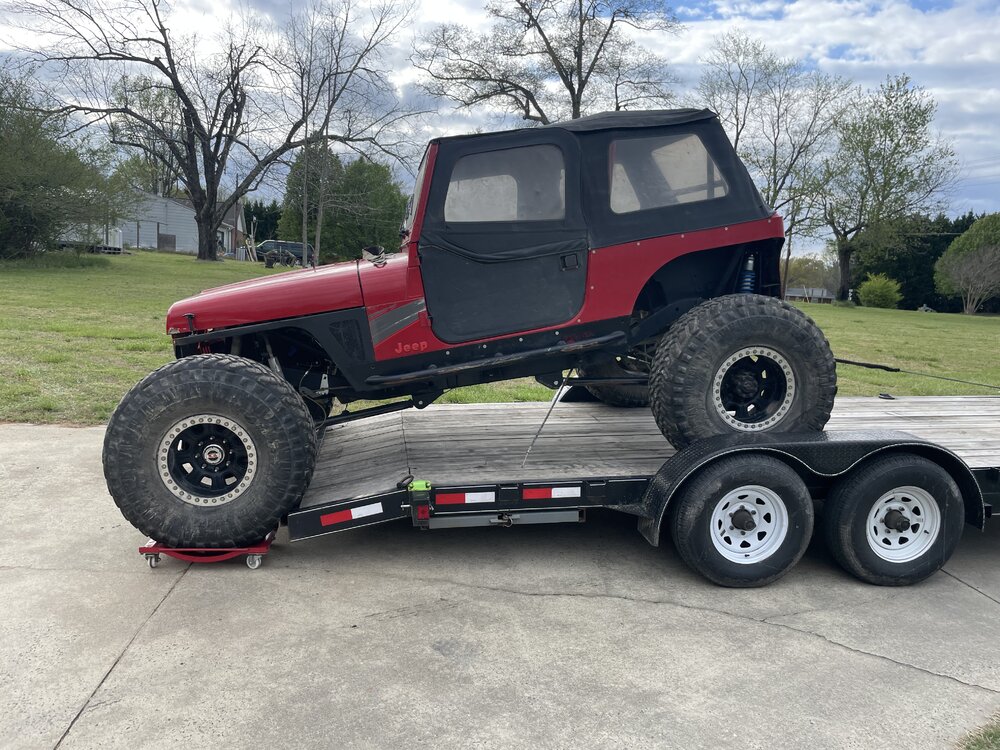

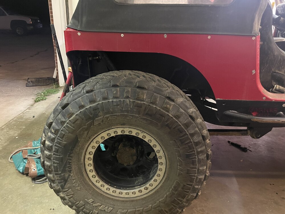

There were plans made so that I would have worked on the Jeep yesterday, tomorrow, and Sunday however, Tuesday afternoon my wife had a doc appointment for our son who was due to be born April 7th. That appointment didn’t go as planned and resulted with us heading to the hospital for observation and ultimately starting the induced labor process. Early this morning my son was born and he and momma are doing great.
What this now means is the build is on hold until I can get the time to load it up and bring it back home. Once it’s back at my house, I can work on it as time permits and not need to worry about commuting 30 min each way to @tobaccoroad4wd shop.

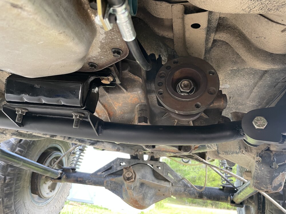

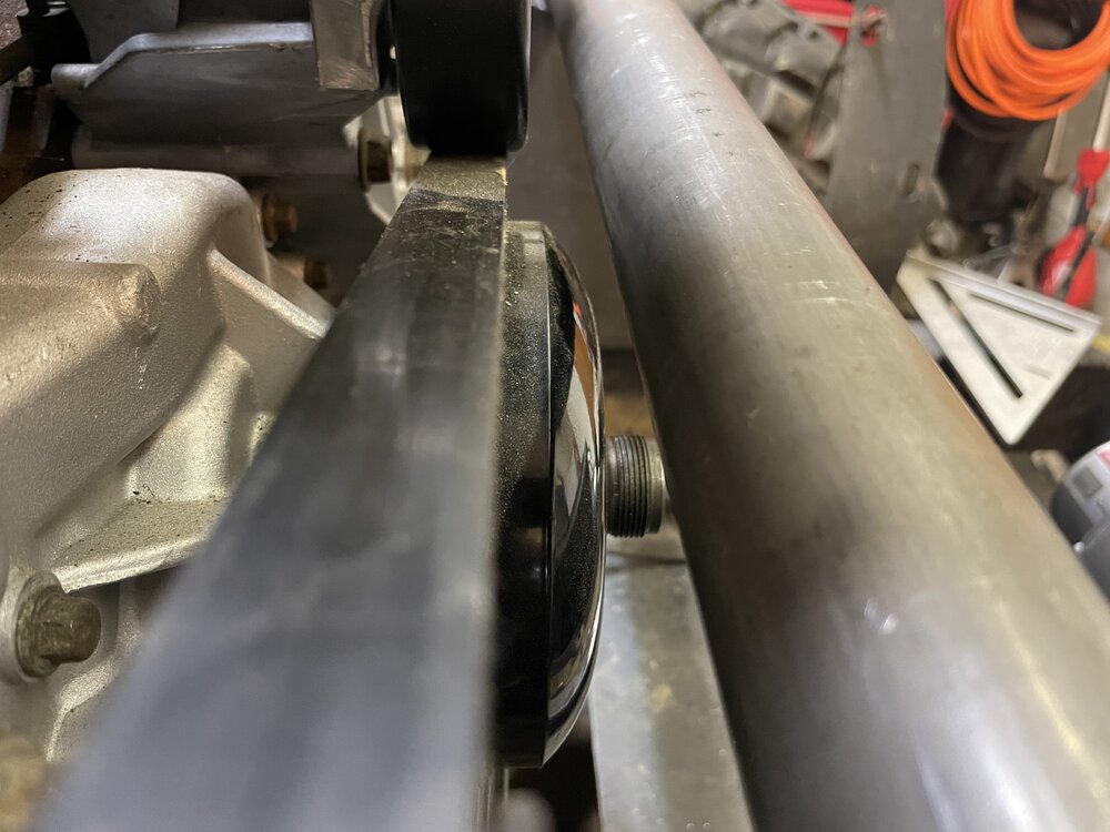

TC is now clocked. I had to modify a clocking ring I purchased because the increments were too extreme for my installation. There now is plenty of clearance between the front output and the crossmember.

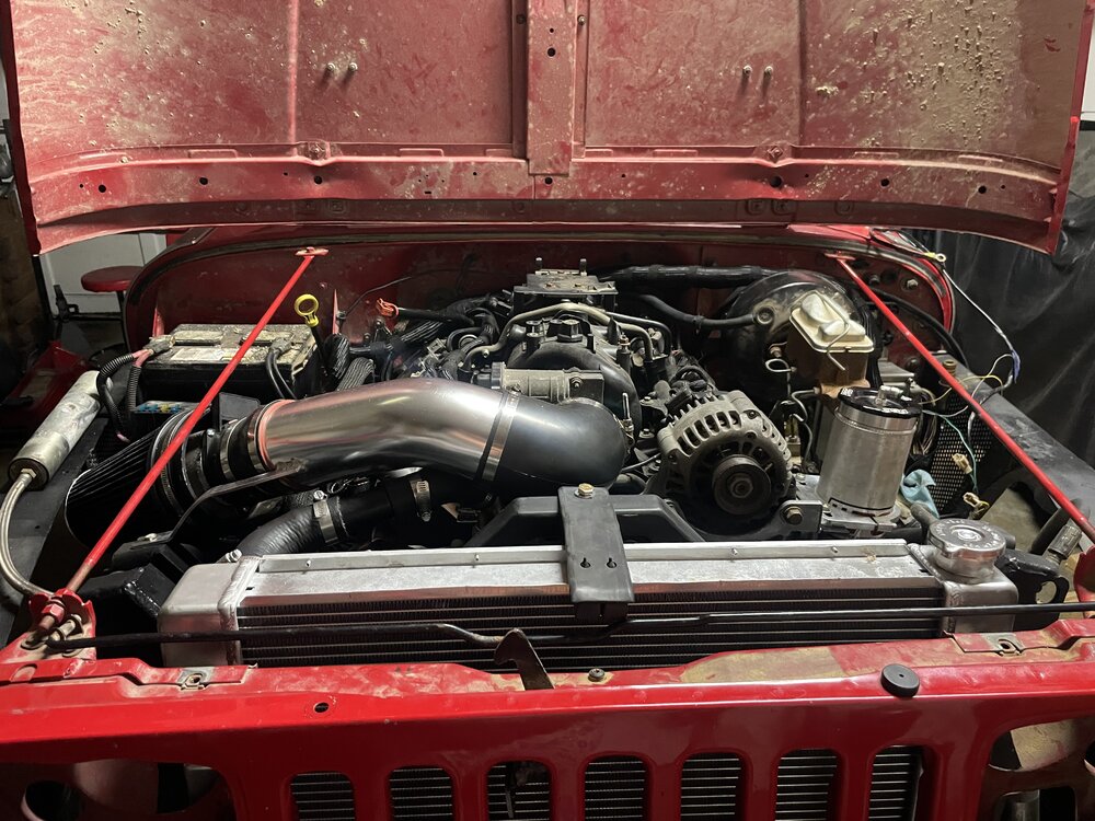

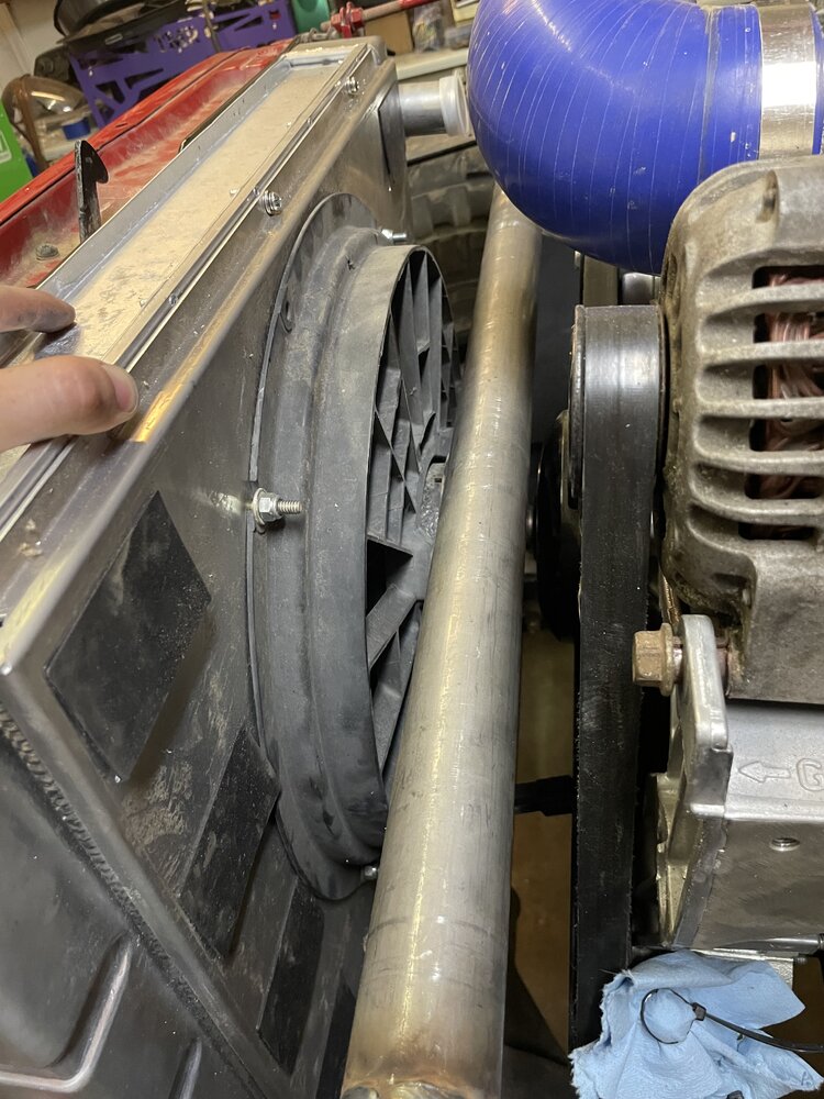

Wiring has been slow but all the trans tunnel wiring is complete. I've mounted the Volvo fan to the shroud and the shroud to the radiator as well as determined where it will be mounted. A new T-stat housing was purchased so I could swivel the output to better fit the lower radiator hose to the radiator and also clear the coilover tower/frame rail. I also purchased a cable shifter for the TC, got the fuel lines made and run, and wiring to the fuel pump complete. Slowly it is coming together.

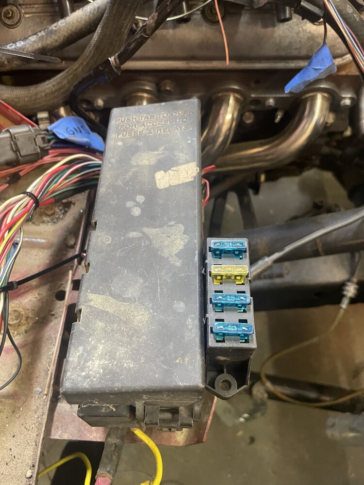

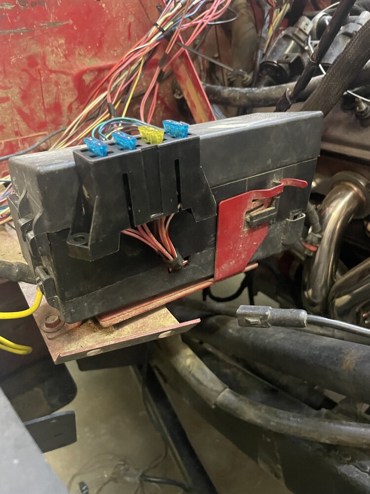

10 min here and 30 min there has gotten me to the point where all engine bay wiring is run and connected. Only a handful of circuits are left before I can call the wiring done. These circuits consist of the gauges, OBD2 port, fan relays, 4 low indicator and converter lockup control. Add a ground here and there and its ready for first start up. Of course, start up won’t happen until I have the motor primed/filled, trans and tcase filled, and exhaust made. It’s so close and I’m getting very excited.

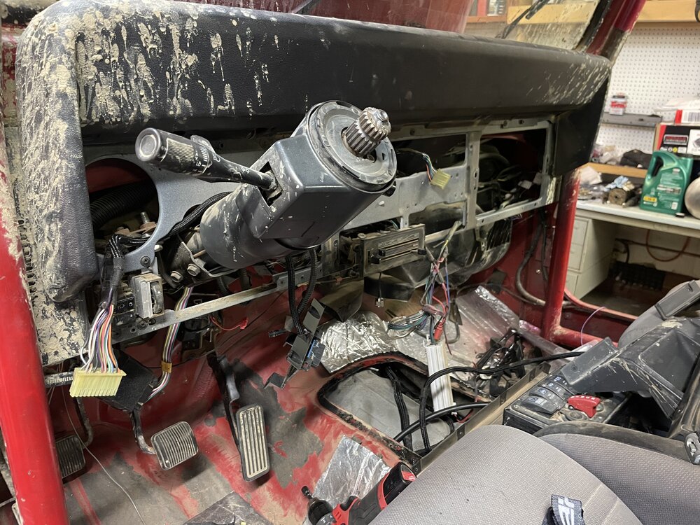

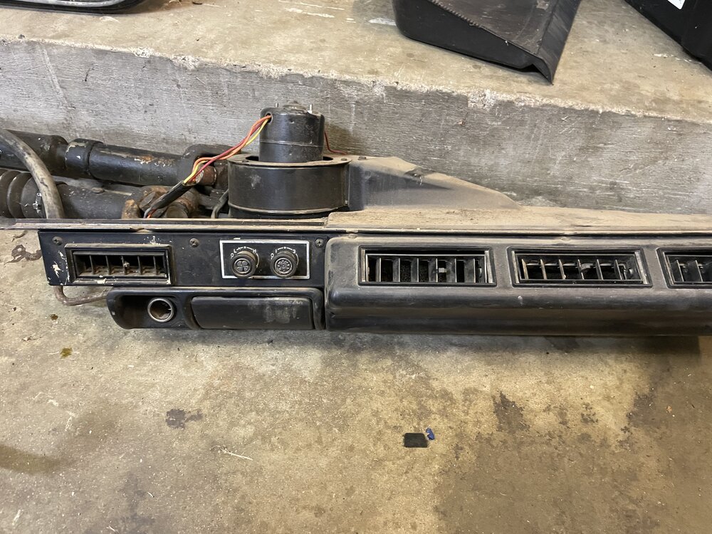

Got another 30 min window to keep chiseling away. OBD2 port and TC lock up knocked out. Moved on to dash wiring items. MIL wired to keep the factory location and dash has been pulled apart to hide wiring and the Dakota digital signal converter for the tach and speedo. I’ve also removed the factory AC with plans of building a center console that will mate with the bottom of the dash.
Tonight more progress was made. Tach is wired and tested to be working. Speedo wiring with the converter was annoying me (unable to understand the instructions :dumbass:) so I moved on to other items.

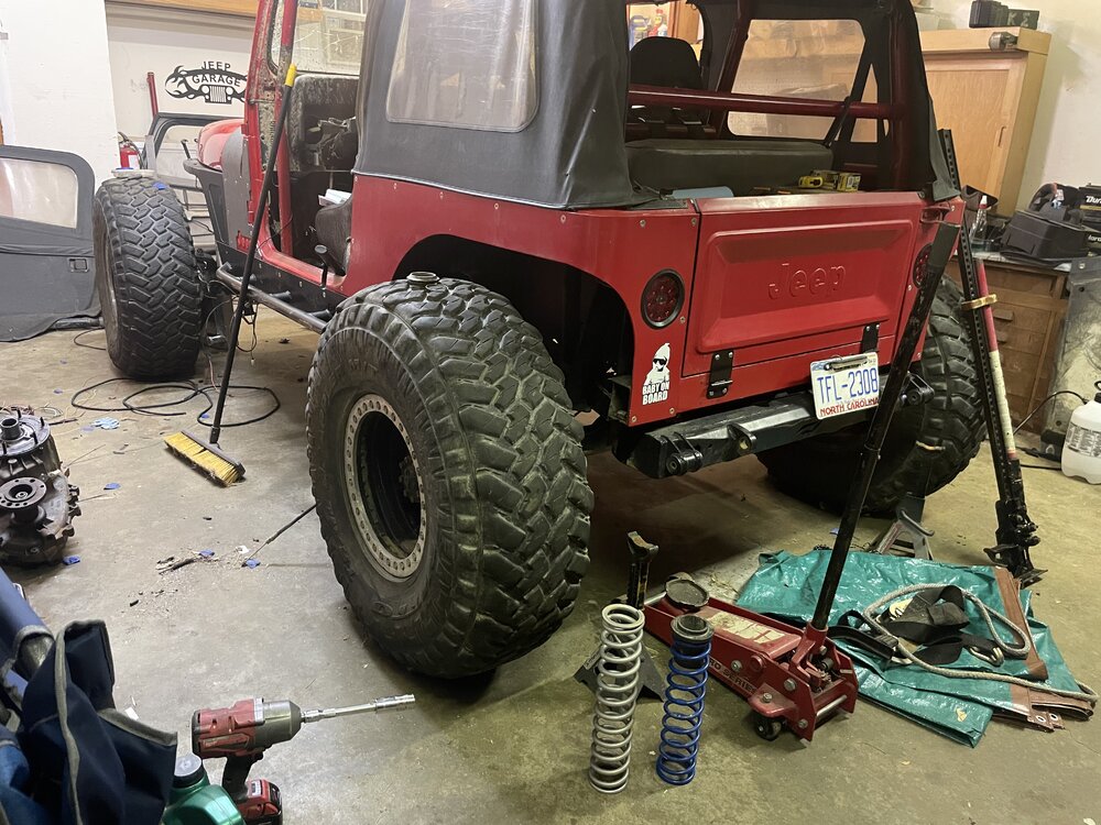

With the fuel cell now up in the tub, there’s more room for up travel. The rear shocks were pulled and bump stops adjusted to the lowest bump. Gained about 1.5” of up travel which I’m happy about. I thought I was going to need to swap the 12” shocks to the rear with this change but apparently, when I built this initially, I had already planned on the 14” in the rear at this bump location because they fit perfectly. I’m happy with how low full bump is and I’ve got more room to bring the front down another 1” or so with some changes to the lower shock mount.

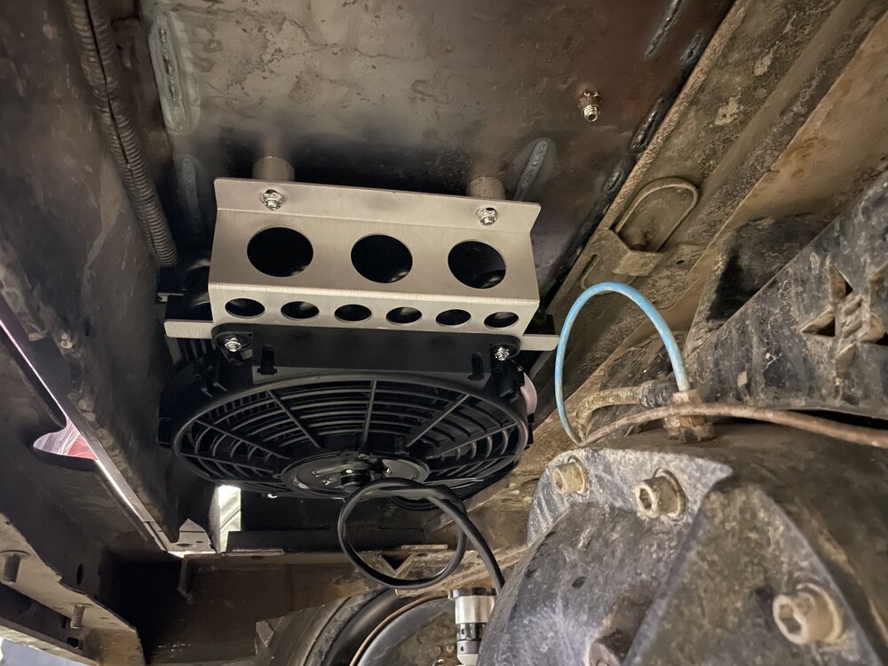

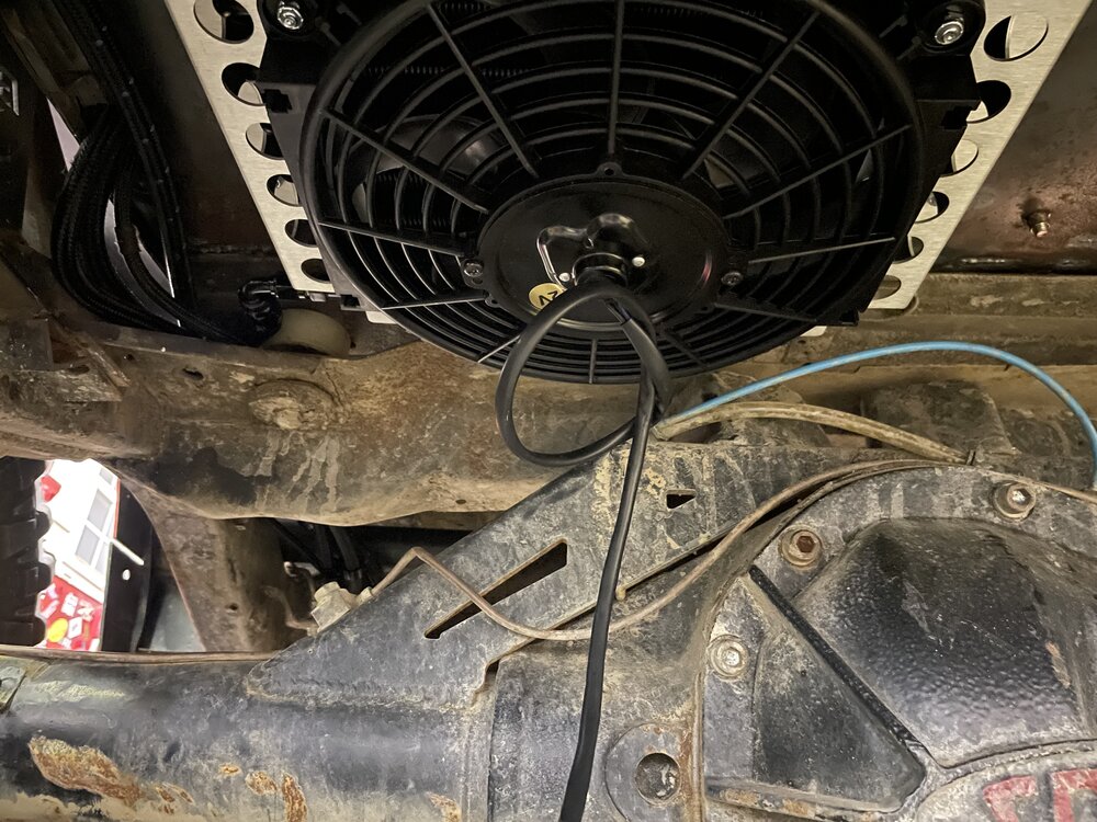

Also tonight, I started brainstorming where to mount the trans cooler. I bought a cooler/fan combo and it’s much larger than I anticipated. At this time, only places I can locate it are the wheel wells and I’m not a big fan of it due to the exposure to mud/dirt. I’ll keep thinking on it but may end up buying a smaller cooler or remove the fan and mount it up front with the radiator.
Still slowly making progress. All wiring is complete minus the 4low switch, fan relays, and then looming everything to keep it tidy. The trans cooler has been mounted under the rear of the tub and lines made/run for it. The lower radiator mount is complete and a shock tower spreader has been made. It's a tight fit with everything but it works. Radiator hoses have been laid out and, pending the upper radiator mount, this whole rig is ready for fluids and first start up. I still have to build the exhaust and make up my mind on muffler/resonator combination that will fit and be mostly quiet. Outside of the swap, I also purchased a rear sway bar and need to get that glued in place.

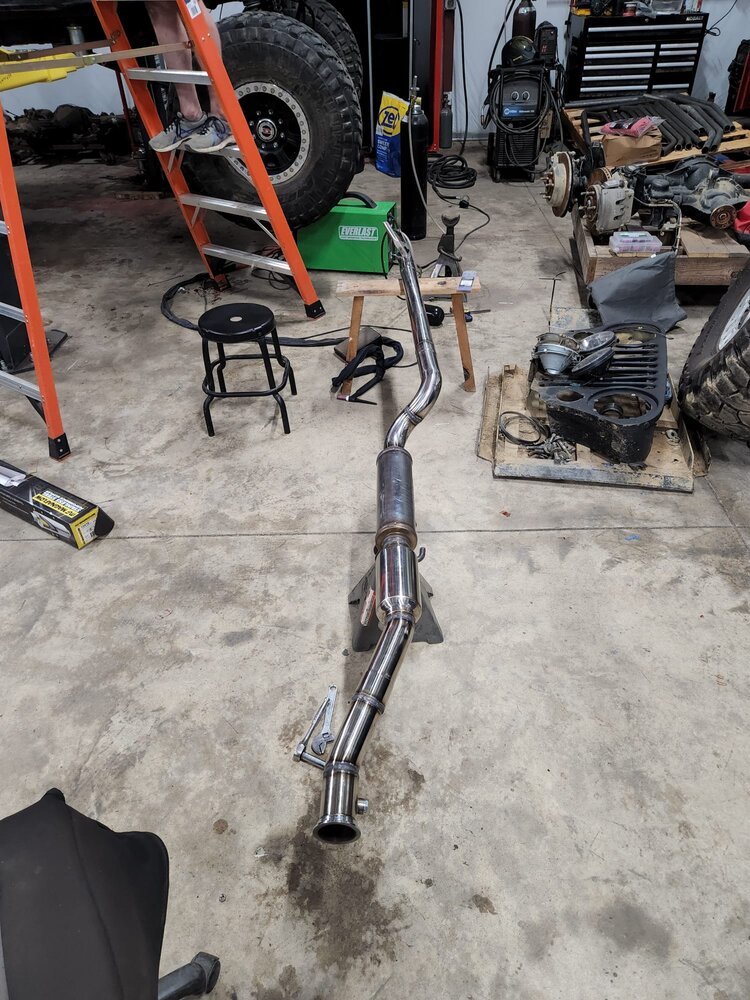

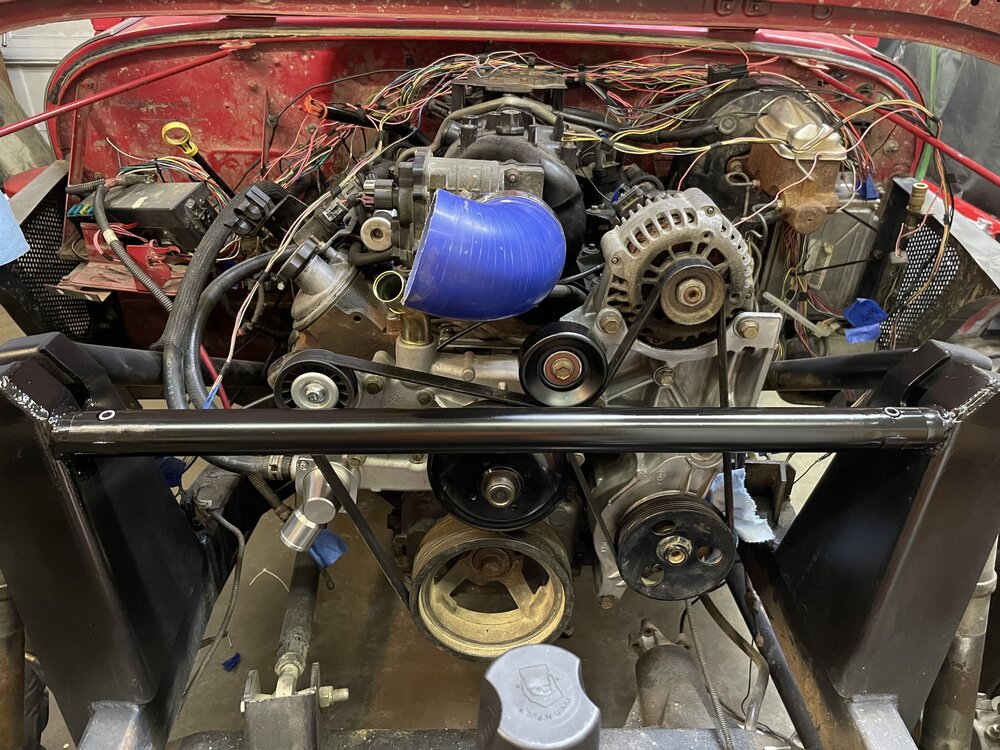

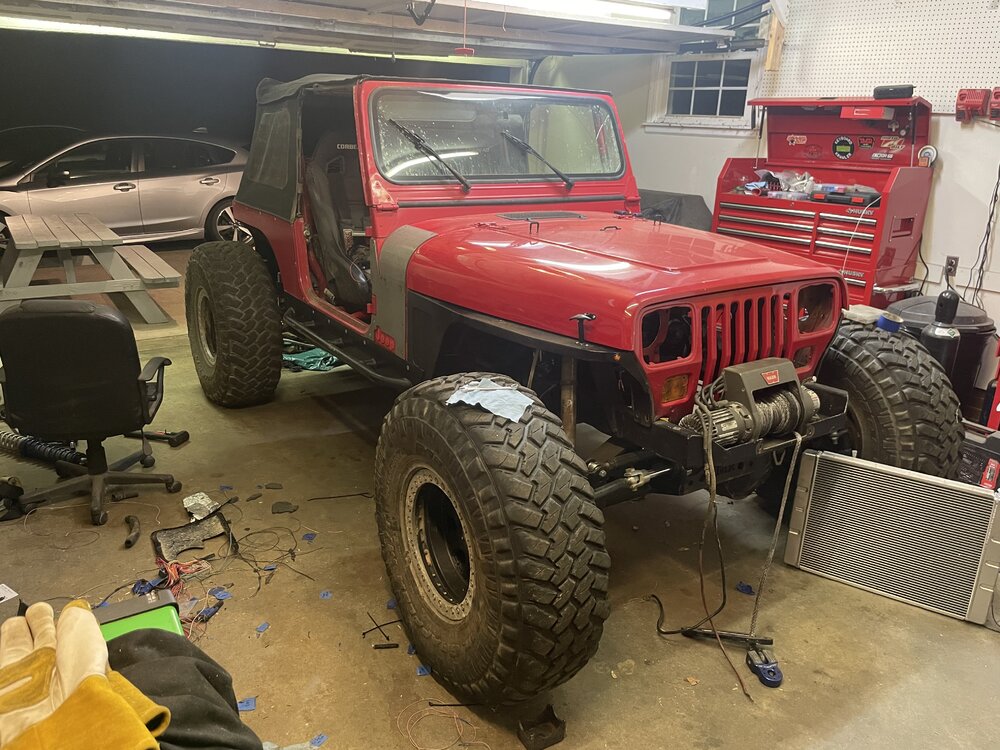

So my wife and son left to visit family out of state for a week and a half. They flew out yesterday so today was scheduled to really tackle open items on the Jeep. @tobaccoroad4wd @Chris_Keziah and @Joe J. came up and put in some major sweat equity into helping me make some leaps and bounds on this project. Today the following items were accomplished

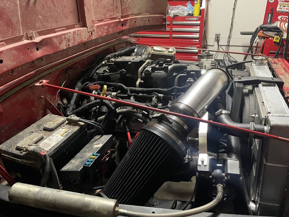

Intake fab’d up and finished

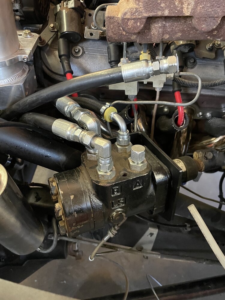

Steering orbital and resi mounted
All wiring under hood (except a couple circuits) loomed

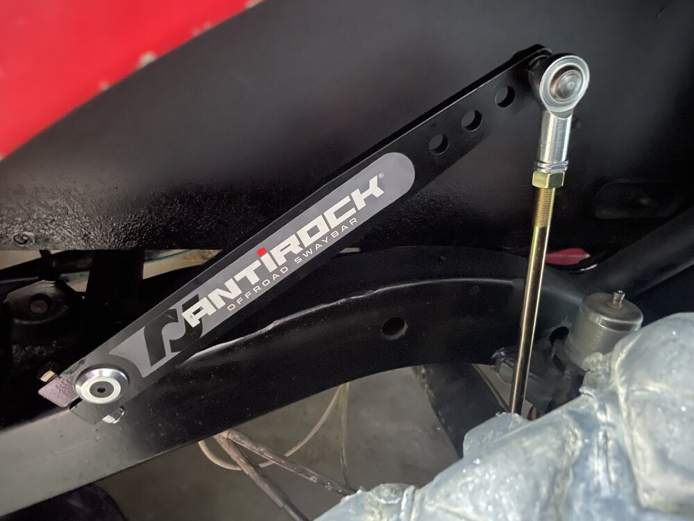

Rear sway bar installed
TC filled with fluid
Trans filled with fluid
Motor primed and filled with oil
Cooling system filled

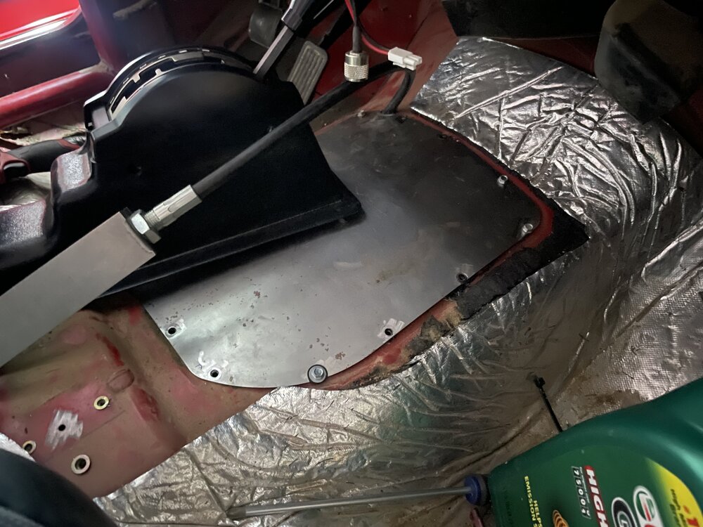

Trans tunnel cover installed
Center console concept sketched out
Motor started for the first time since it was pulled from truck in November
Items left to complete:
Exhaust
Fixed trans leak between trans and TC clocking ring
New fuel filter/regulator needed (cracked a brazed fitting on current one)
Build center console
Install new switch panel (panel being ordered tomorrow)
Power steering lines
Coilover springs installed
Shorten/convert front driveshaft to work with 241 flange
Hook up winch
Radiator fan wiring
Trans cooler fan wiring
While the to-do list is still lengthy, most of these items are quick jobs that I should be able to knock out after work this week. The goal is to have it at GER the weekend of September 16-18 for a shake down run.
I really can’t thanks Chris, Justin, and Joe enough for all of their help and hard work today. We made more progress in less than 12 hours than I have in the past 3 months.

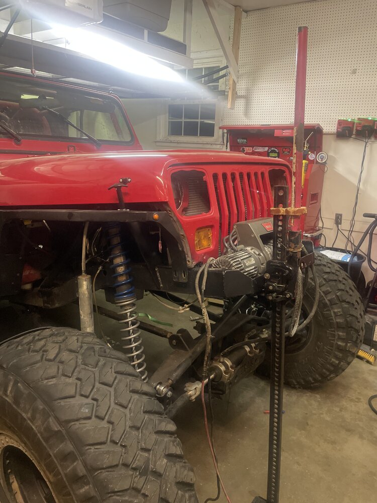

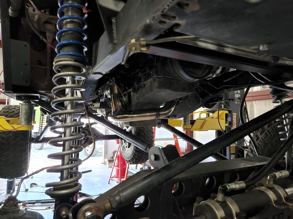

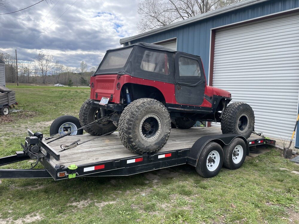

At just under 6 months to the day of pulling a running Jeep apart, it has now made its first drive down the road. But dyno says this is a touch more powerful than the 4.0 :laughing:
Still needs the following:
Radiator fan temp programming
Turn off Evap O2 stuff in the pcm
Correct wiring for OBD2 port - losing connection when engine running but have connection when not running and key in run position
Center console built
Trans cooler power wire
Headlights and headlight harness

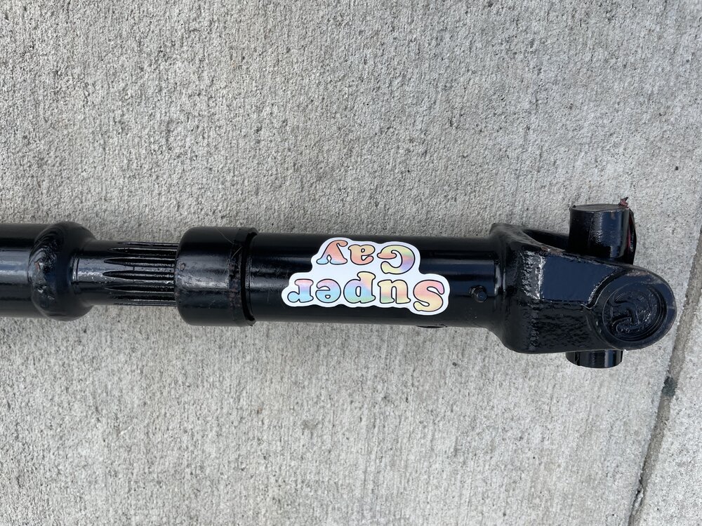

Shorten front driveshaft
Huge shout out to @tobaccoroad4wd for letting me use the lift and @Chris_Keziah for building the entire exhaust

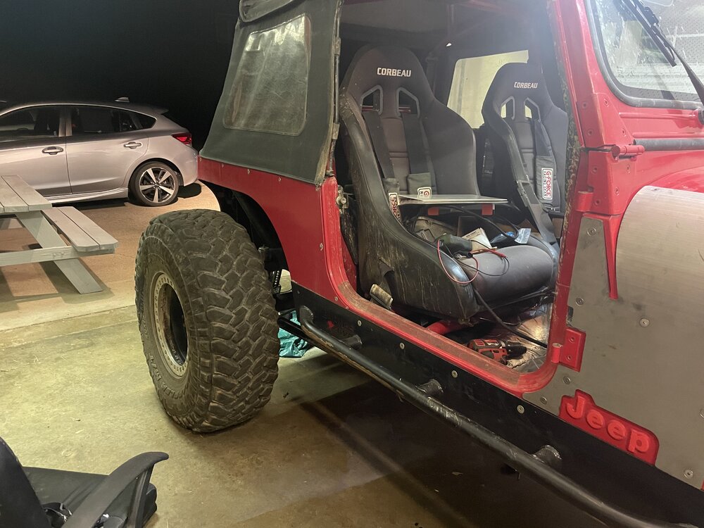

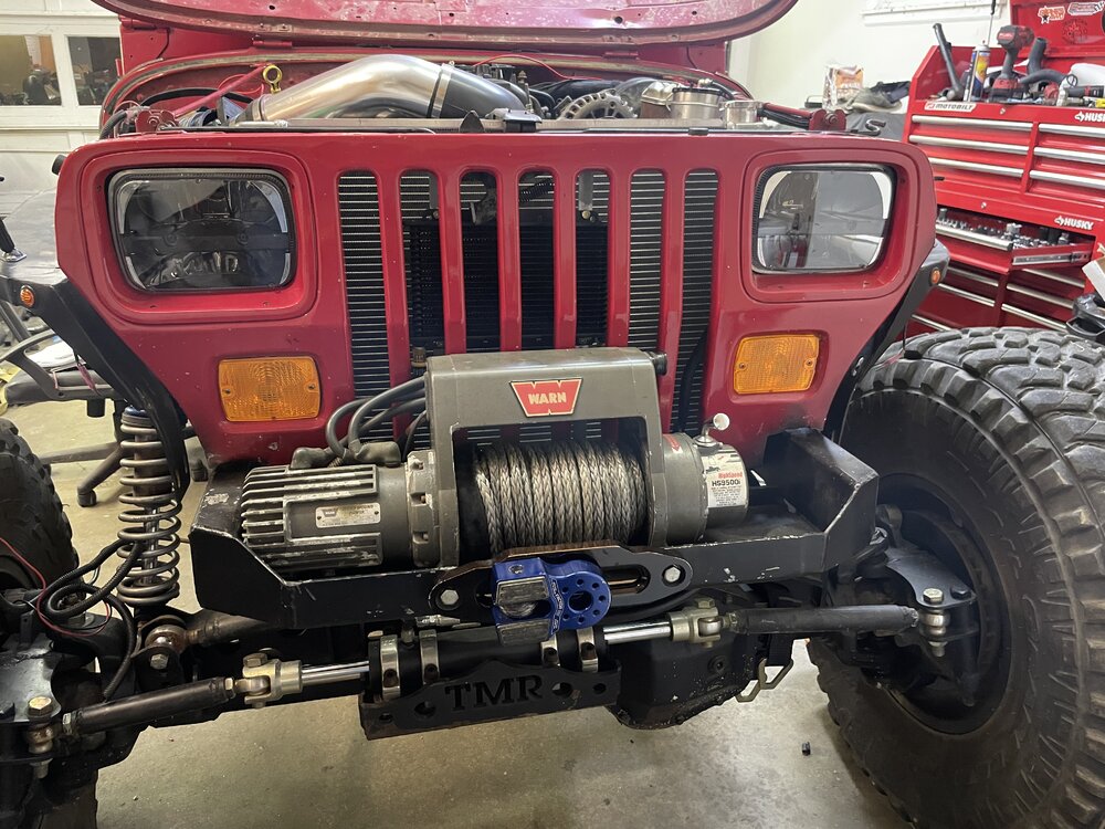

After my son went to bed, I got out in the garage for an hour. Knocked out the headlight, turn signal, rad fan, and horn wiring/looming. Stuck with the stock turn signal bulbs for now but will go to the surface mount leds later. Installed a set of Amazon special led headlights and they seem to work well.

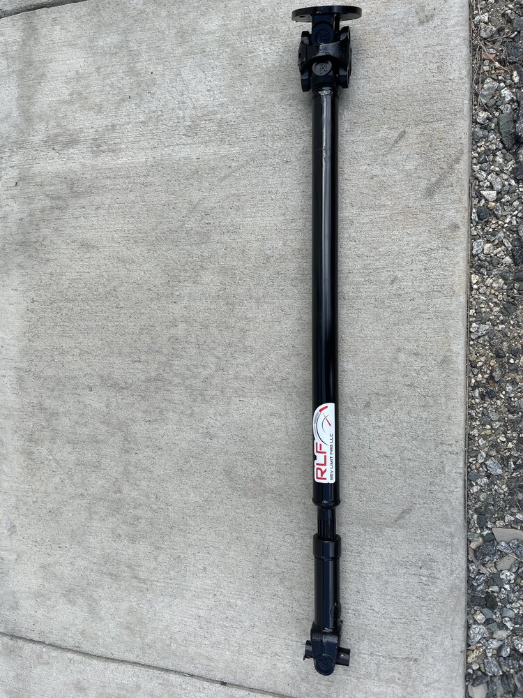

The ranch trip is in 3 weeks so I’ve really got to get this thing buttoned up. Tomorrow I’m planning to take the front driveshaft down to @Chris_Keziah to have him shorten and install the TC side flange. Next weekend I’m hoping to get the center console knocked out and then it’s just some small things to be ready for this trip.
