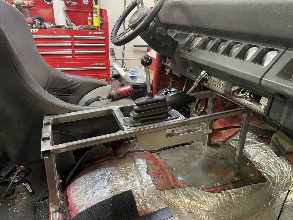

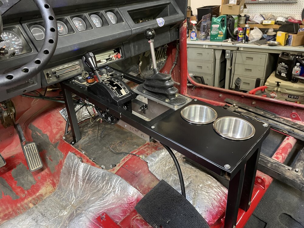

Center console built but needs additional panels and the switch panel will be replaced with a much nicer unit

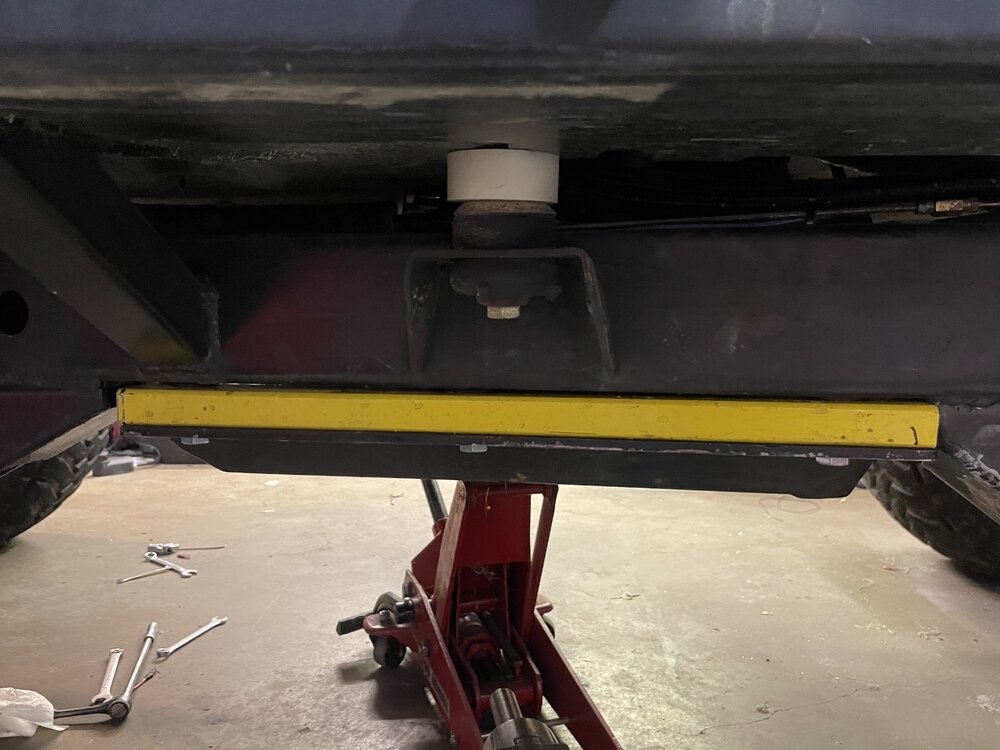

Skid plate is installed with a 1" spacer to allow clearance between the skid and t-case

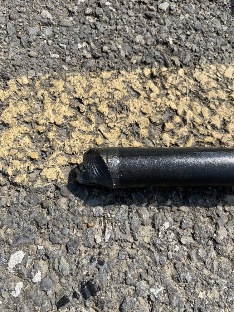

Broken driver rear axle shaft

It needs some tuning and 35 spline rear shafts. Once I get the rear axle and coilover rebuilt, I’ll take the rig to @Chris_Keziah and let him do some driveability tuning.

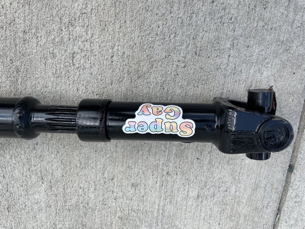

To get the rig back together quickly, so that @Chris_Keziah can start playing with the tuning, I've ordered 35 spline chromos and a spool to put in the rear (thanks @tobaccoroad4wd). I'm also planning to have the front coilovers rebuilt either by myself or someone else (still TBD). The ARB will go up for sale and I'm debating selling everything associated with it (compressor, lines, switches, solenoid (+spare), and ring gear spacer). My goal is to have everything done and back together before mid October so another shake down run can take place before heading back to GER at the end of October. This is going to be a tight deadline because I have a couple weeks I'll be traveling for work so hopefully I can pull it off.

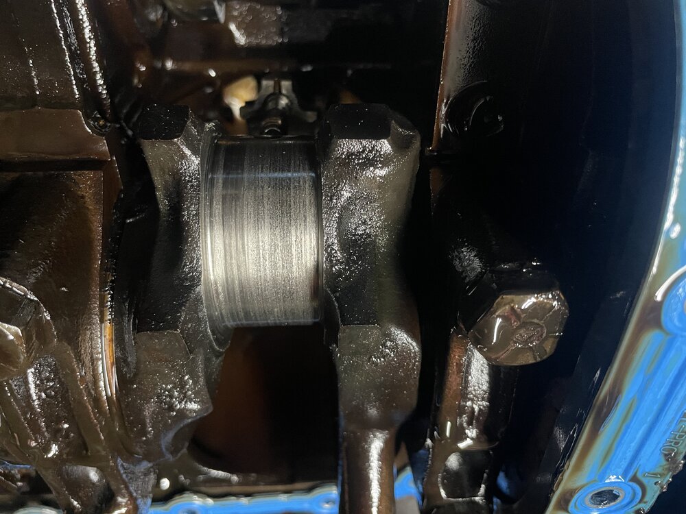

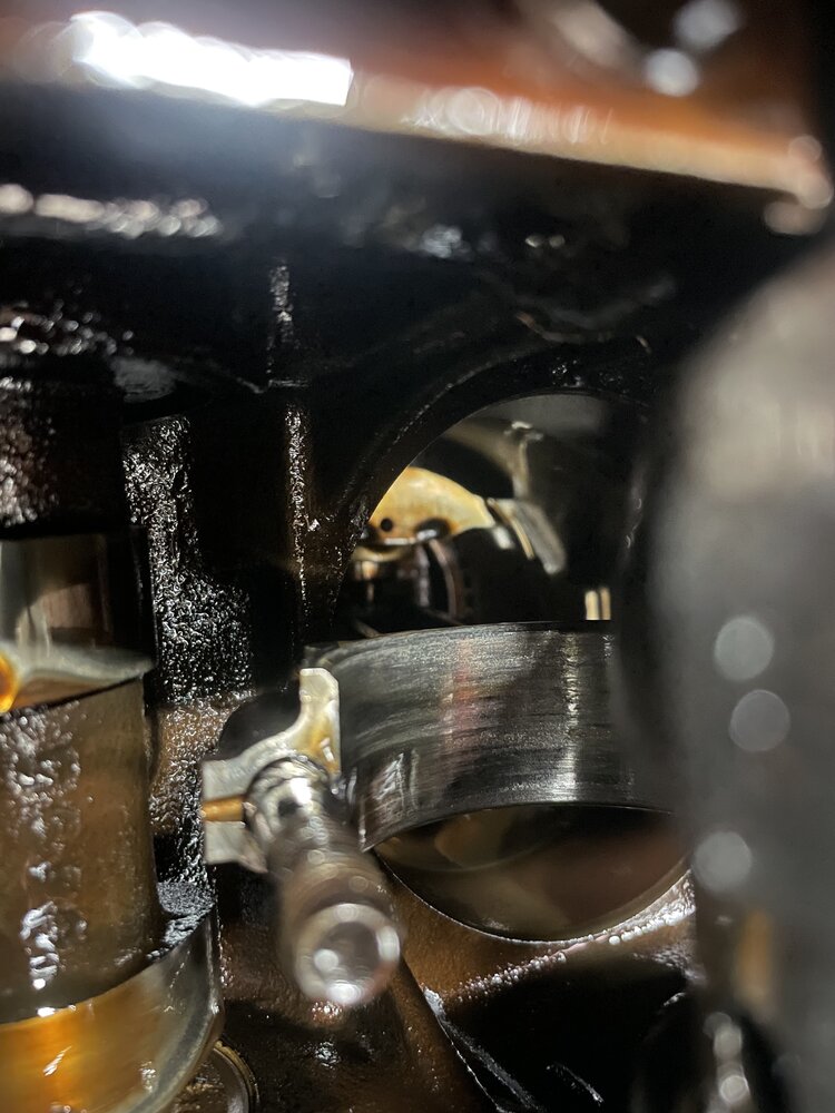

The new project followed me home last Sunday. It's a '95 4 cylinder manual with 139k on it. There's some pretty bad bottom end noise that I've pointed to a rod bearing at cylinder #1. I've found a replacement motor and need to make the trip to VA to pick it up but, in the meantime, I'm going to slap a set of rod bearings in this one and see what happens. This one will stay stock for a little while and just be used for zipping around town. I do have the idea of taking the AC system left over from the LS swap and installing it in this thing.

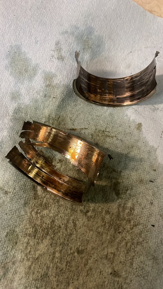

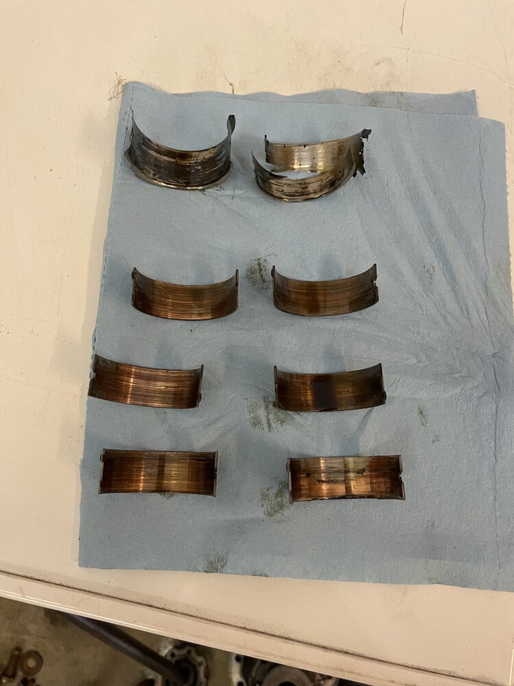

Finished replacing the rod bearings in the 4 banger. To say they were trashed is an understatement. This also means the crank is junk. Because I already had the rod bearings and oil pan gasket, I proceeded with changing them anyway and buttoned it up. First fire up and test drive went well with 40 psi of oil pressure at hot idle. However, there is a massive oil leak from either the rear main or oil pan gasket. Judging by how quickly it was spitting oil, and the fact that the entire underside was covered when I bought this thing, I’m pointing to the rear main. Not going to bother replacing it since it needs a motor anyways.
