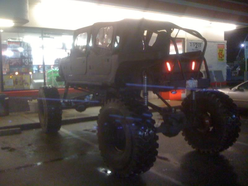

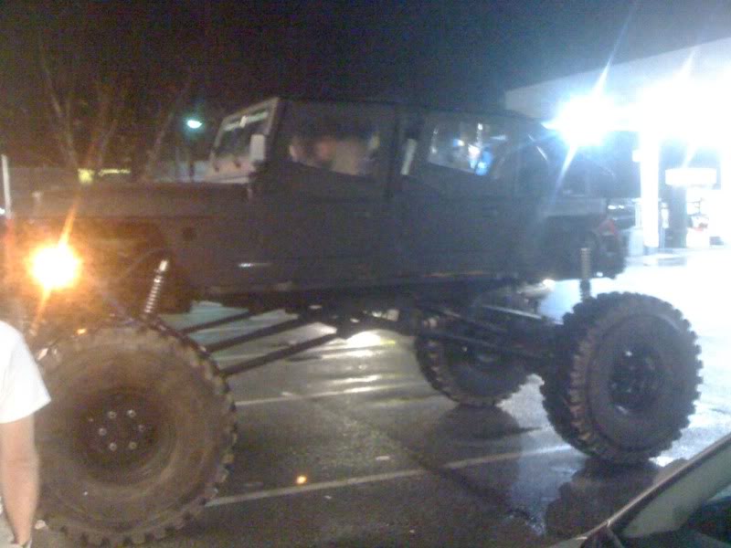

great looking rig just one question why didnt you save some time and money and just do a pinion brake.
For one thing, he isn't locked yet, so only one wheel would stop. Also, he is apparently building the thing to be an all purpose cruiser. This includes driving at speeds on road that would put a quick end to pinion brakes spinning over 6x the speed of wheel brakes.
Wheel brakes are better in every way except for cost, and loss of extra braking power through gearing(which shouldn't matter with those monster brakes he has).
Basically exactly what he said (except for "all purpose cruiser" part). Oh yeah, it stops better than any thing I've ever driven.

I'm curious how you get in?
Rite now. Step on DS rear bottom link, step up on tire, then walk down step/slider. Got set up figured out just don't have time to fab it up yet.
