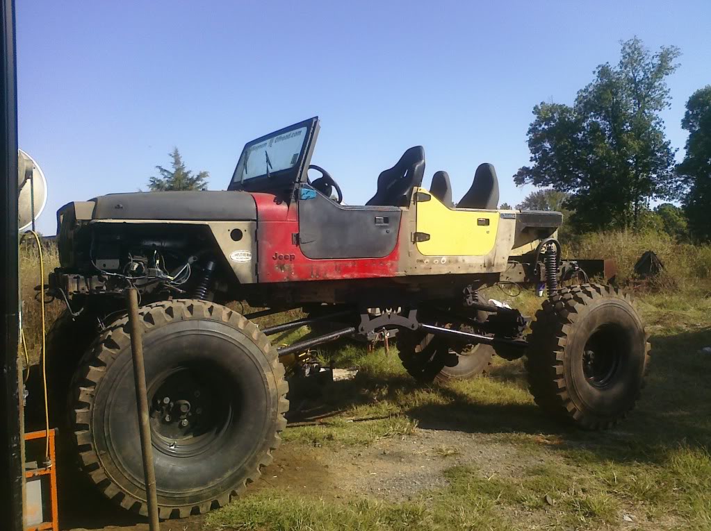

***RELEASE THE KRAKEN***

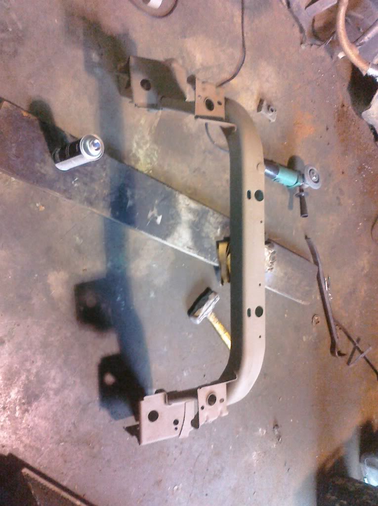

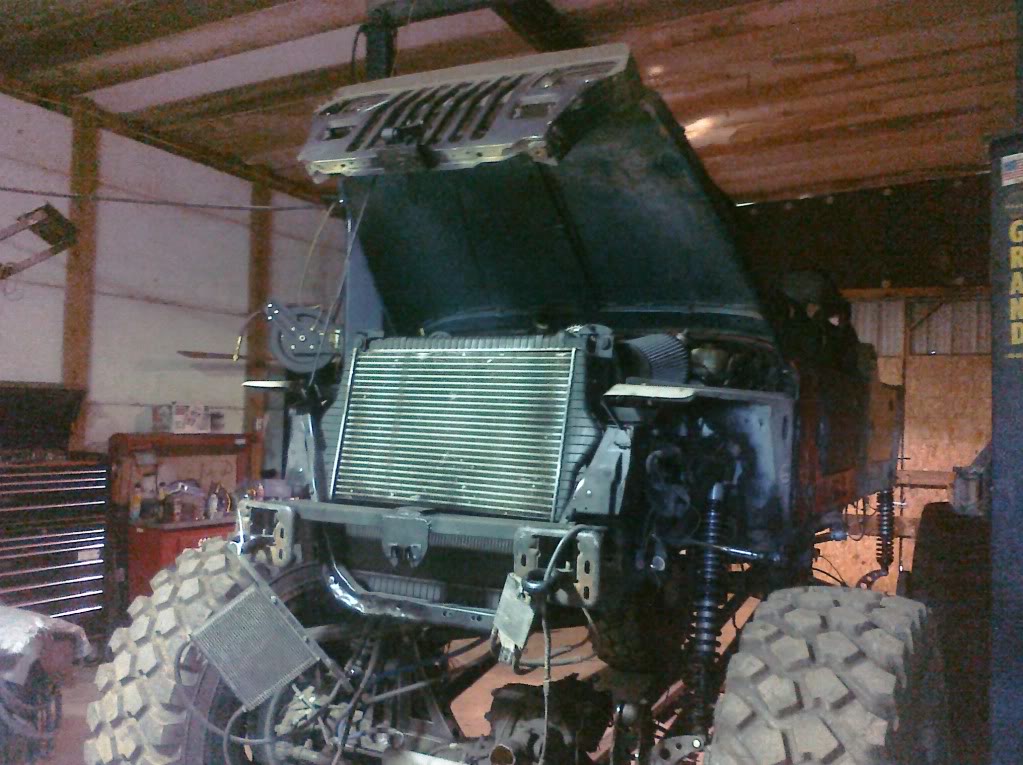

Got old radiator, intercooler & support cradle out. Also got new pulley on PS pump.
Was able to reuse old cradle with some sweat & a BFH. Gonna have to fab some mounts for upper tabs on radiator & intercooler.
Got salvage yard radiator & intercooler in along with support cradle.
more updates to follow...

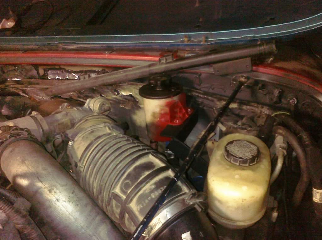

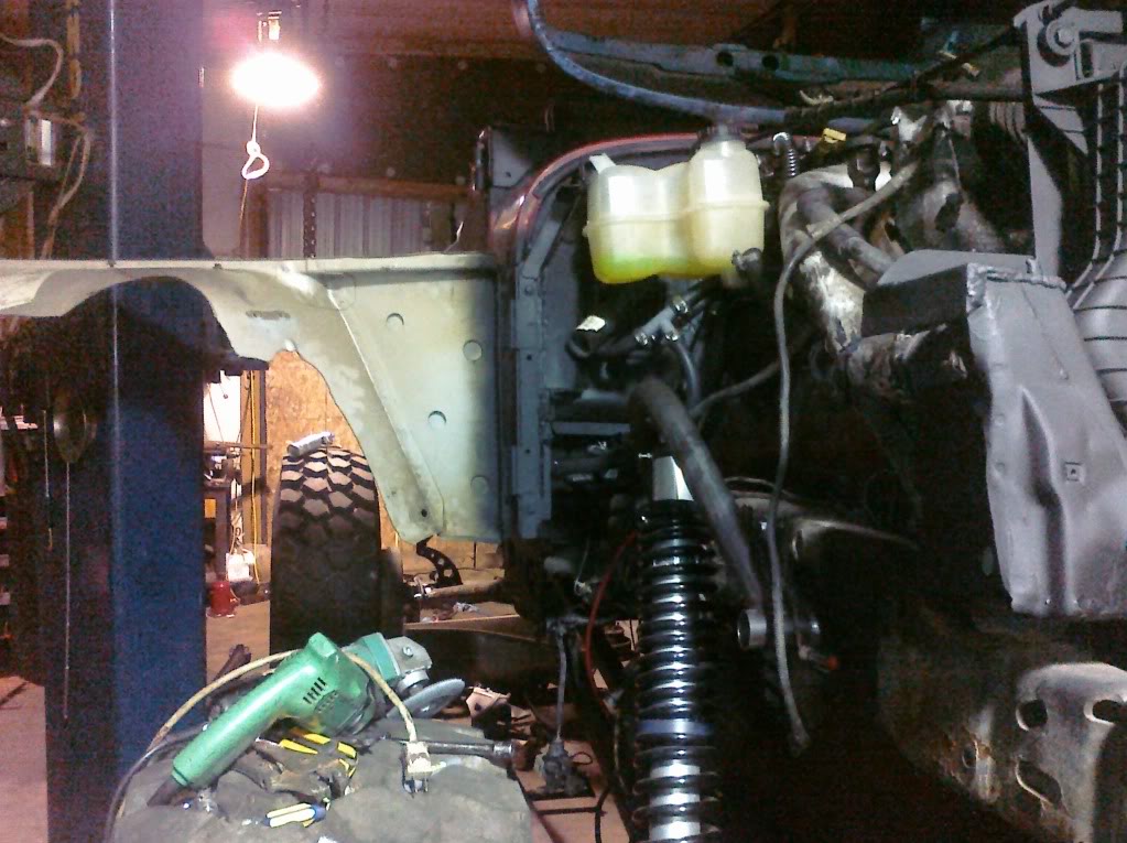

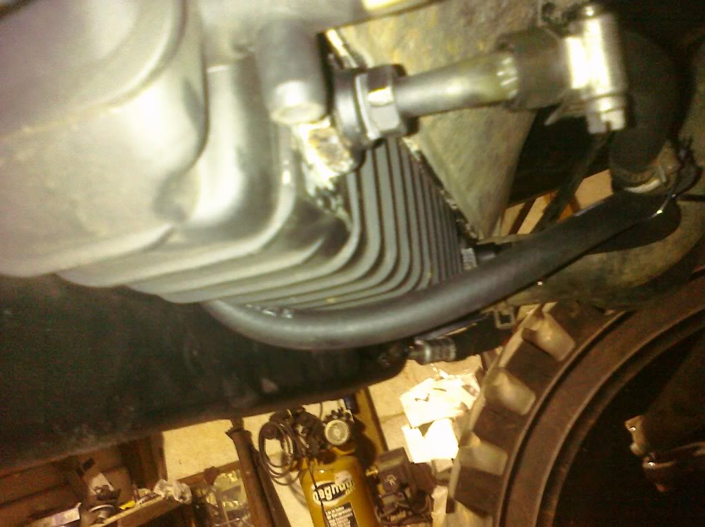

Had to modify my PS res hose so it wouldn't crimp
Got PS res mounted (almost looks like it was meant to be there, pay no attention to red paint)

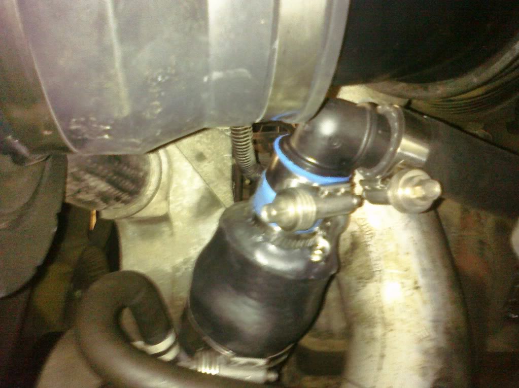

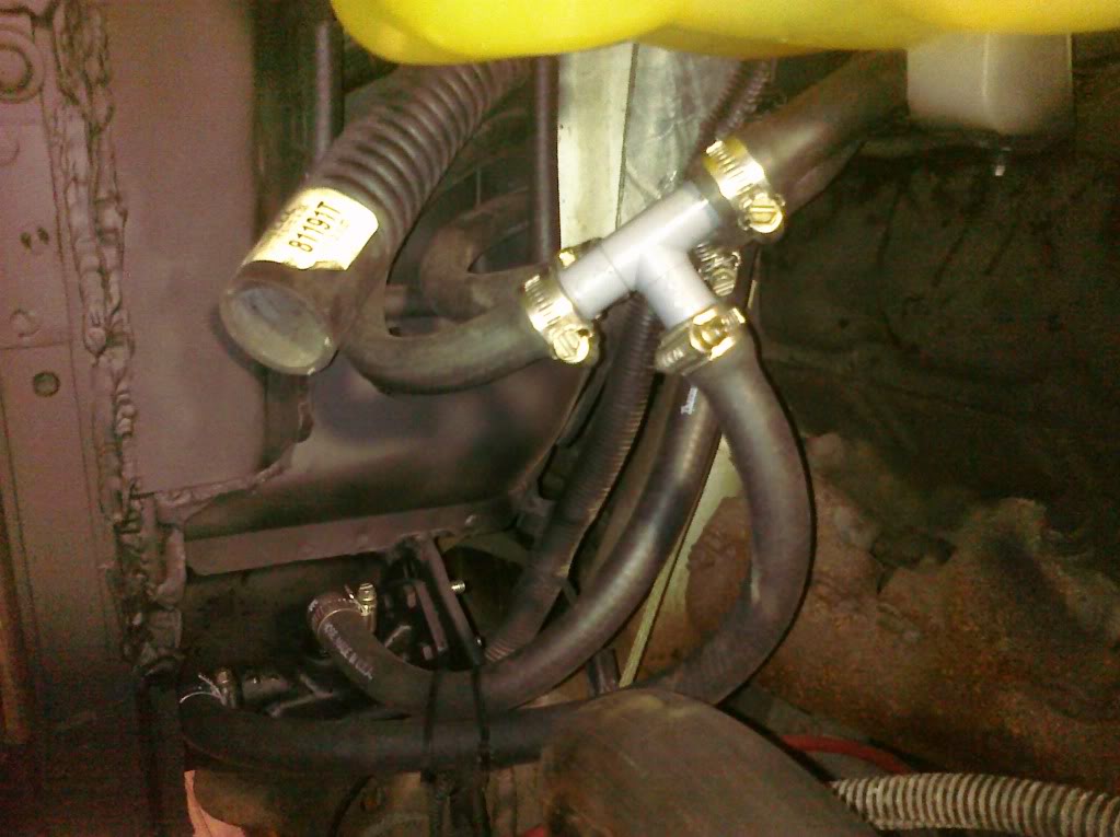

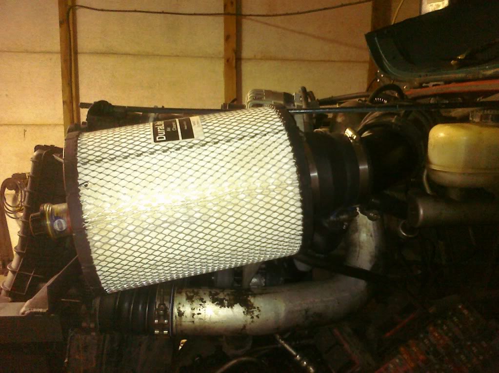

Got filter mod installed (with help from Lowes plumbing supplies)

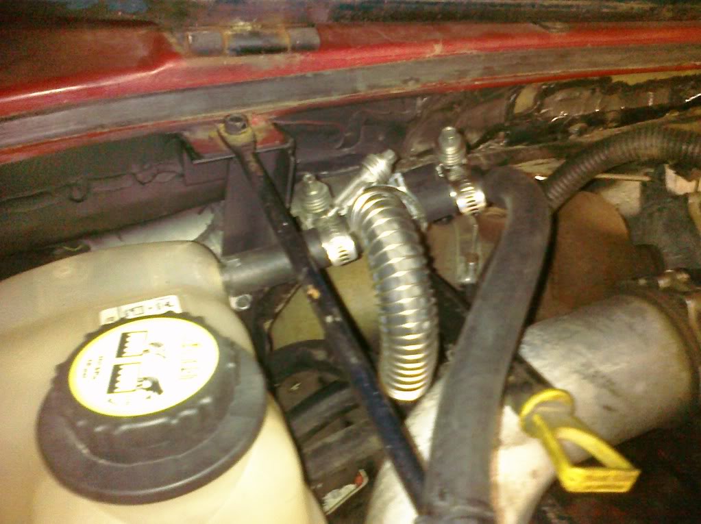

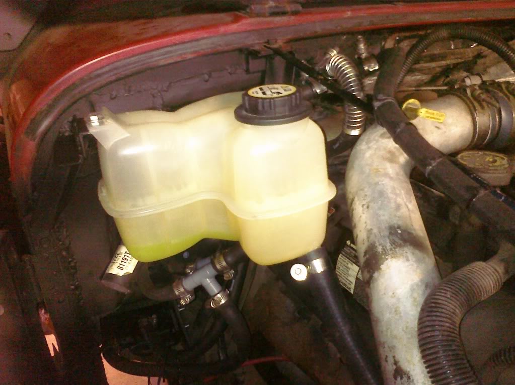

Got coolant reservoir installed & added coolant filter

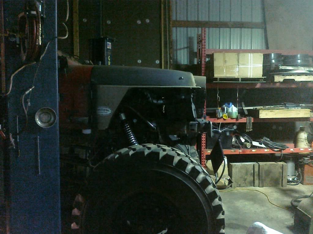

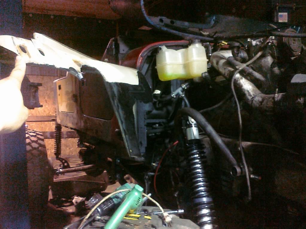

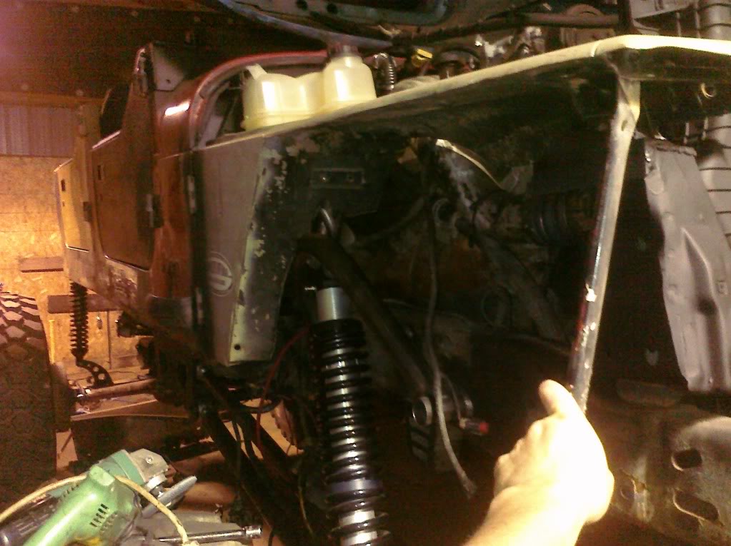

Since fenders are only for looks & to keep debris outta engine bay I decided to hinge them to make it easier for engine work later on

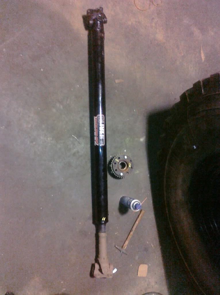

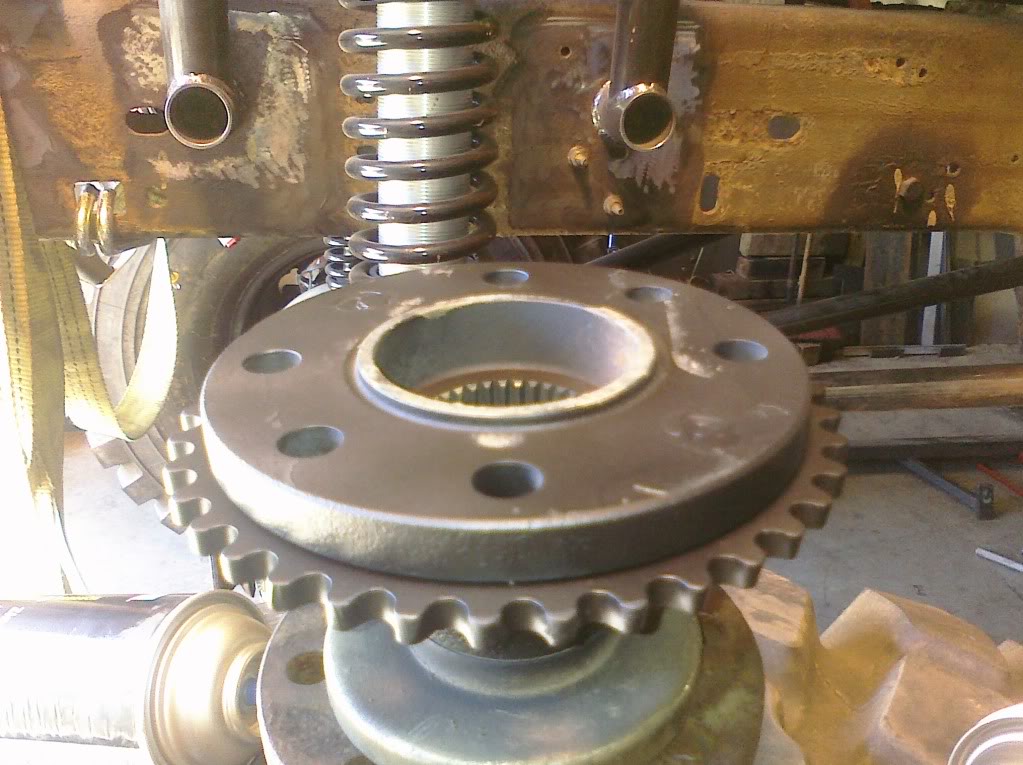

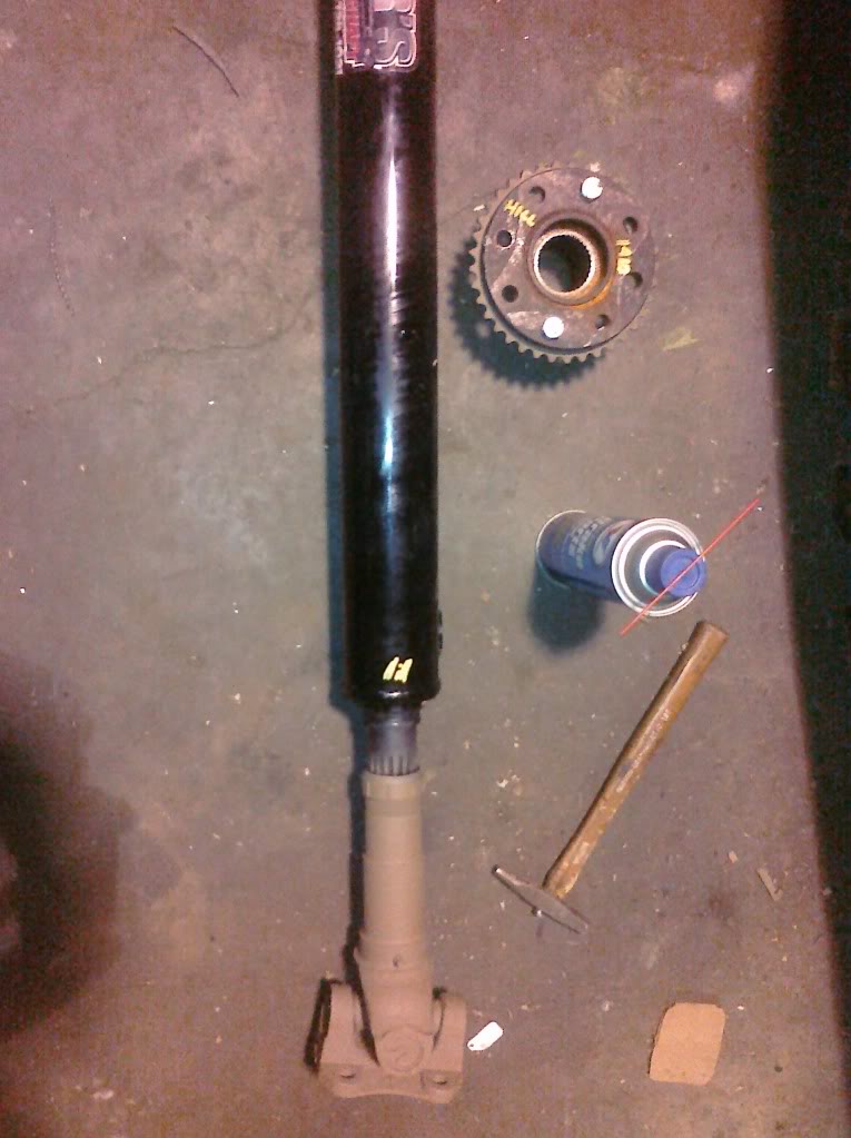

Got driveshaft also from Olivers (looks small in pics, has 1410 joints & standard slip)

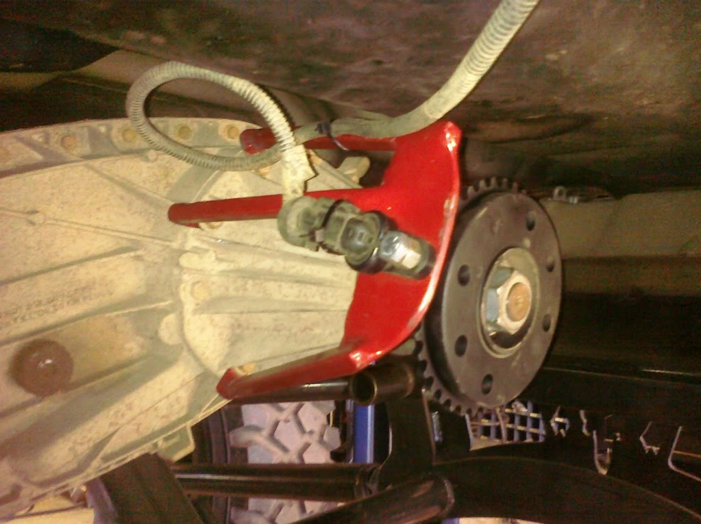

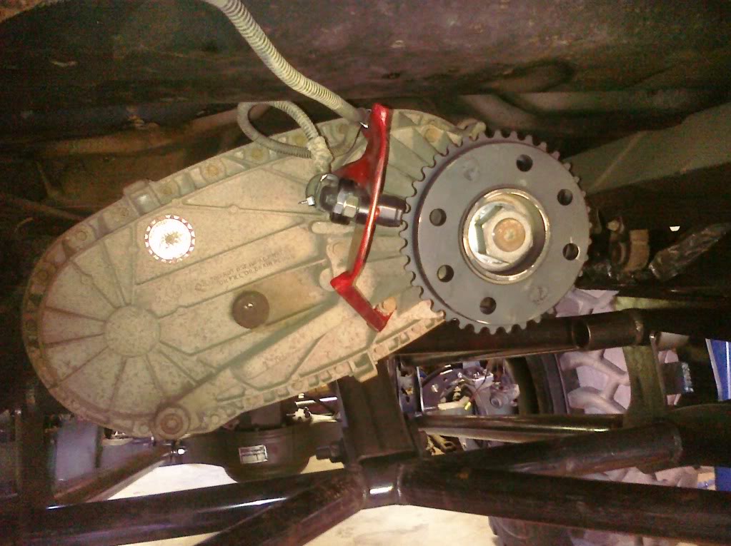

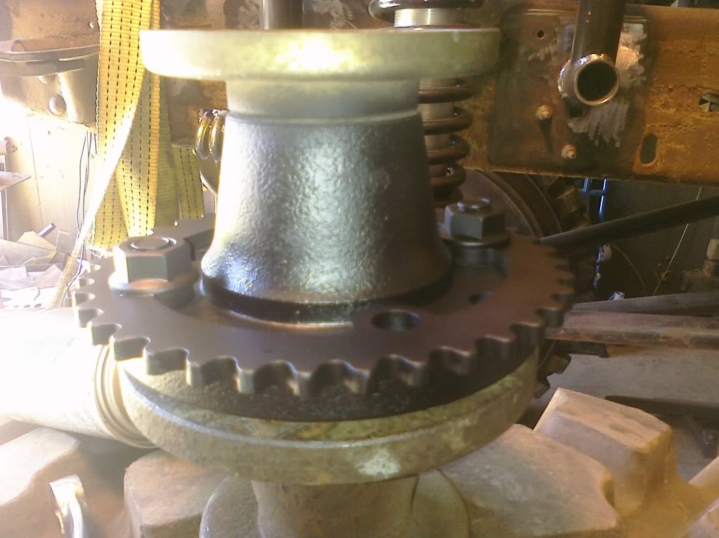

Close up pic & tone ring mounted on flange for speed sensor

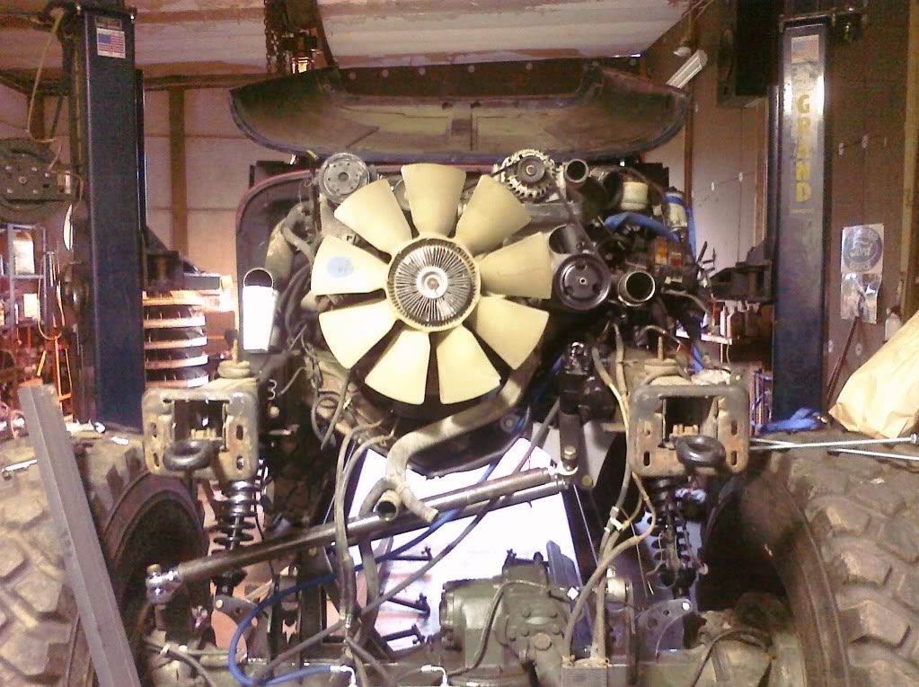

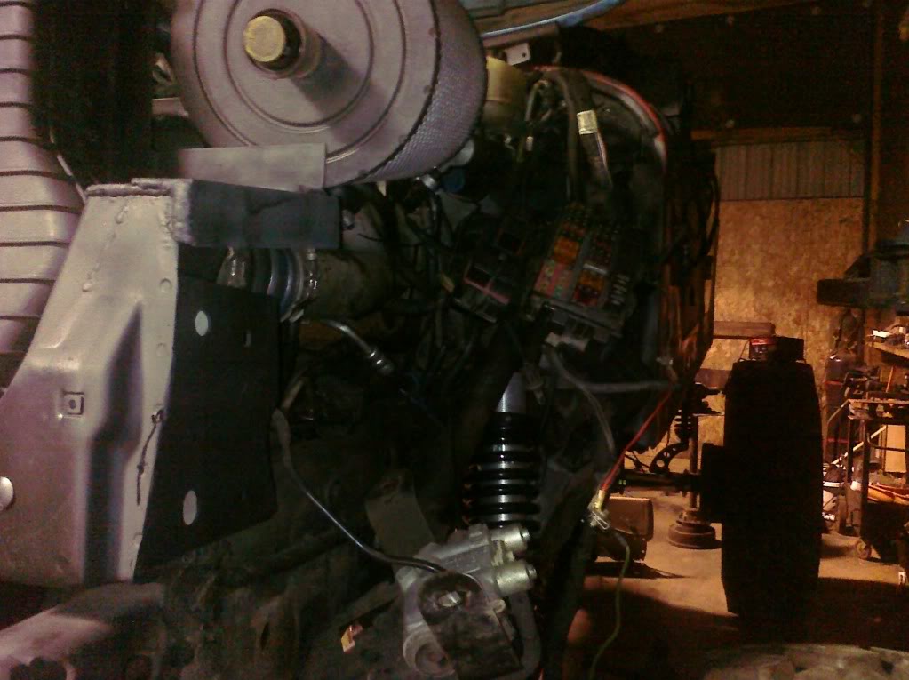

Making progress. Had to change filter mod out for ARE filter & add 3' wire (x16 wires) for IDM relocation to under dash due to not enough room under hood. Redo mount for ABS on driver front & figure out how I wanna mount grille. Changed thermostat & added new upper radiator hose outlet & (new) old style upper hose so air filter would have room. Should have hubs off & milled down by weekend for disc's, hopefully (its hot as balls in shop).

putting those hinges on was ingenious, thats just sweet:beer::beer::beer:
Ah, you likee da "suicide" fenders®. Thanks.

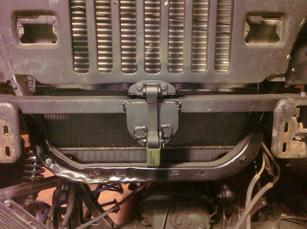

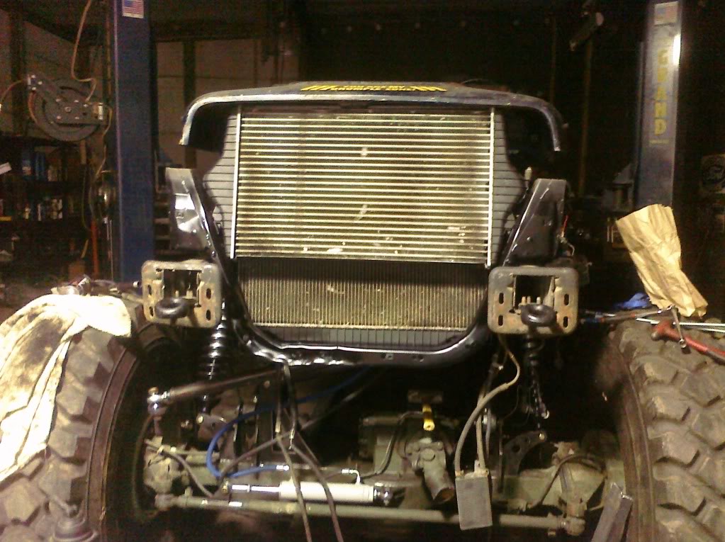

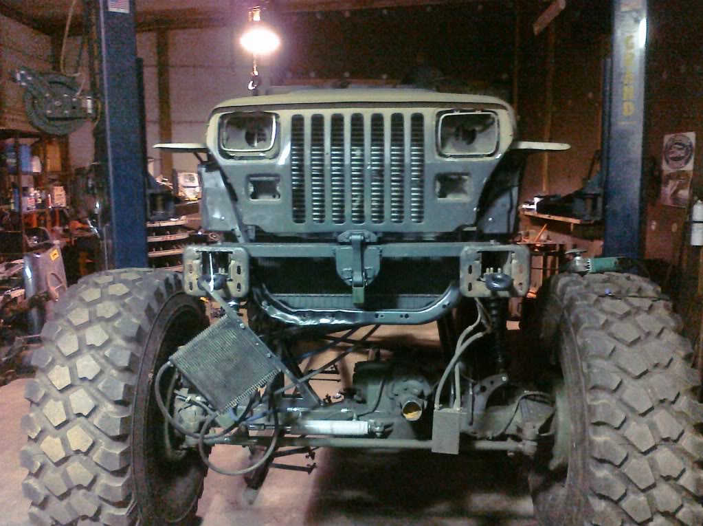

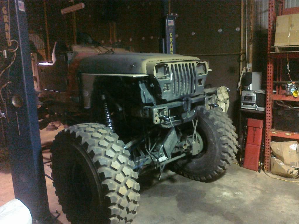

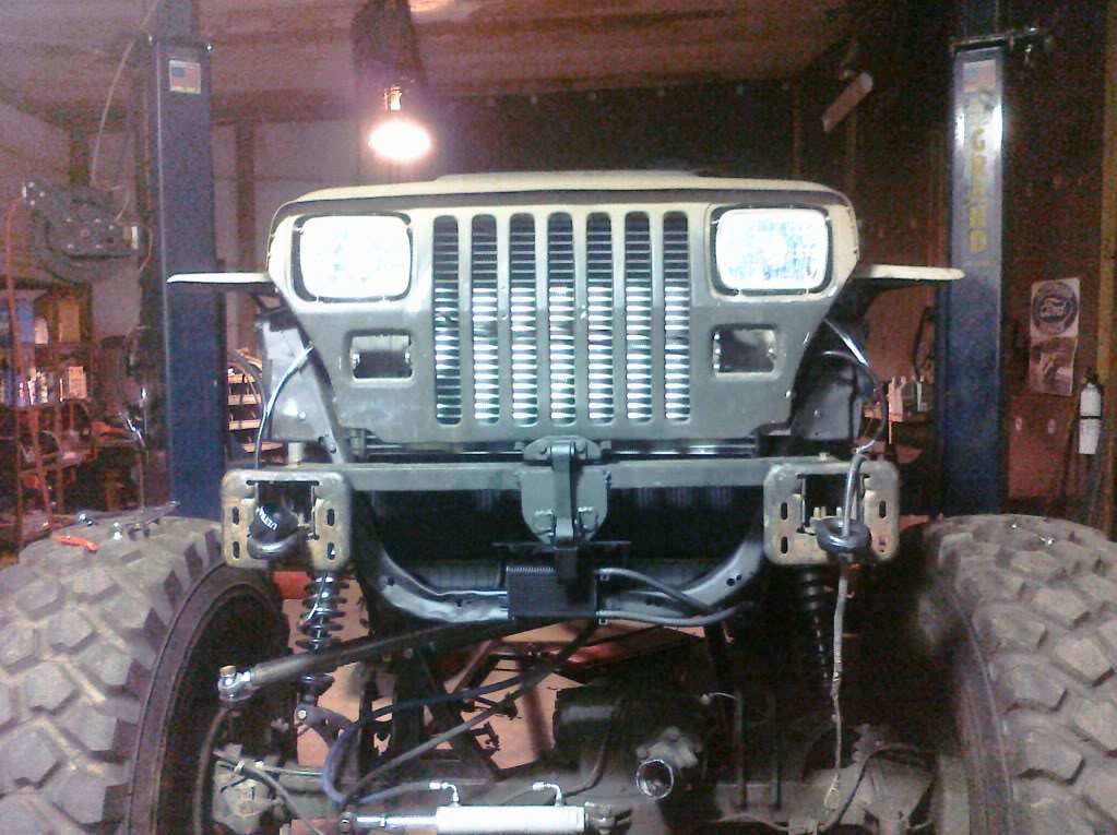

Finally got fenders, all under hood components & grille secure & in place (until body work time). Had to move grille out about 5 inches due to intercooler.
Used a hood latch from a HUMVEE for main hood latch (along with two OEM TJ style hood latches, add later). The hood & grille are one piece now. With hood/grille & fenders all being able to swing away from engine mods will be alot easier down the road.

Pic I forgot to upload of one piece hood

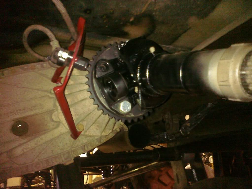

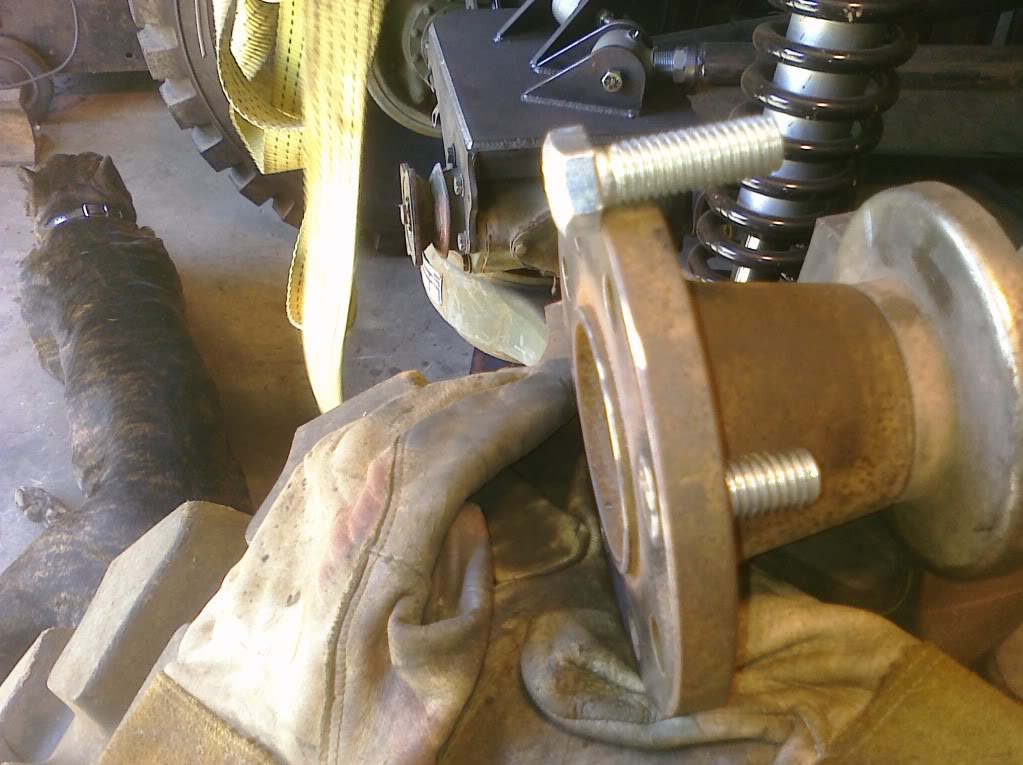

Had to weld the bolts to flange b/c bolt heads would have hit drive shaft yoke making angle less
Tone ring mounted
Got flange mounted back on Xfer case & drive shaft along with VSS sensor mount I fabbed up

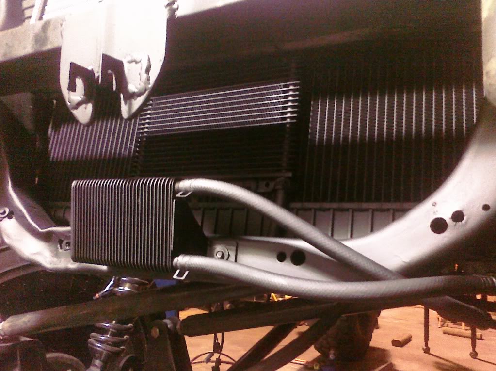

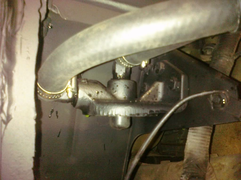

Got extra tranny cooler plumbed up along with the one that was built into the salvage radiator I bought (old radiator didn't have connections). Tranny should stay nice & cool. Got power steering cooler mounted also.
more to follow...

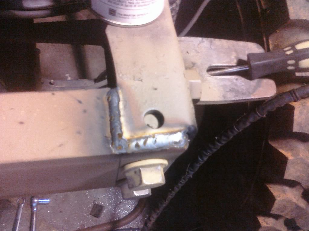

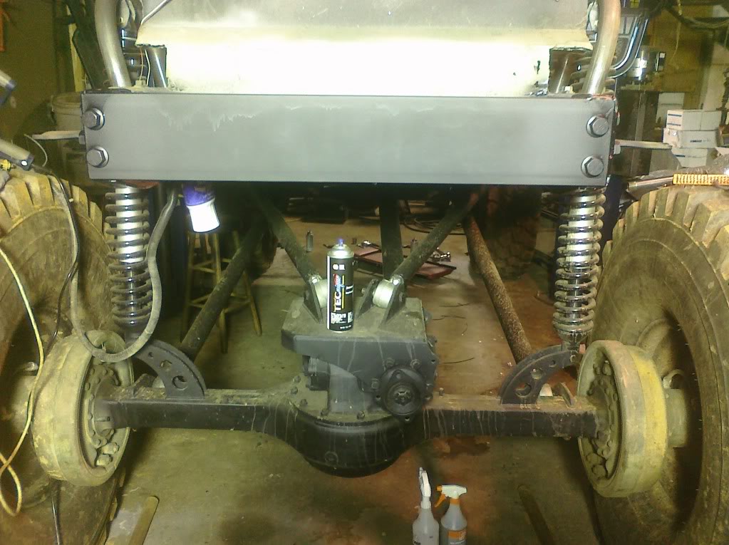

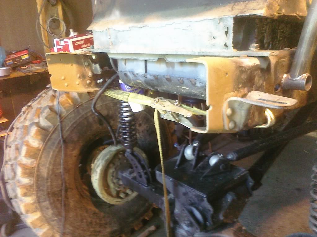

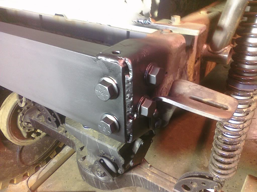

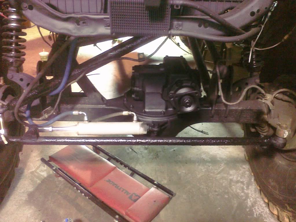

Got rear part of frame strengthened up using 6" C channel & 3/4" Grade *8* bolts:

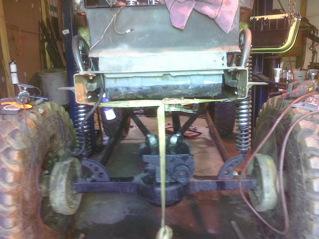

Almost finished with links, mounts, cradle & axles. Frames next, little phosphoric acid & zinc primer then 3M body schutz time.

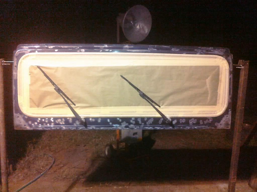

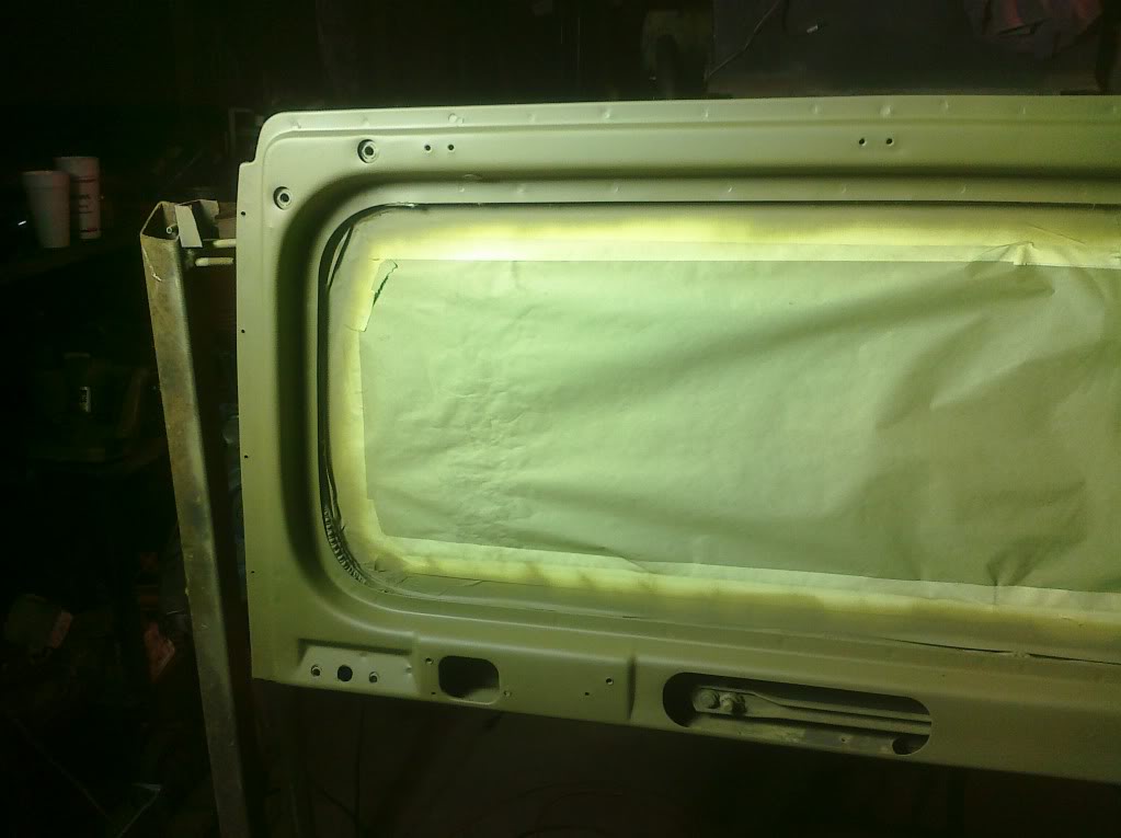

Got windshield prepped, primed & painted (have decided to Herculine the body & paint MIL black over that):

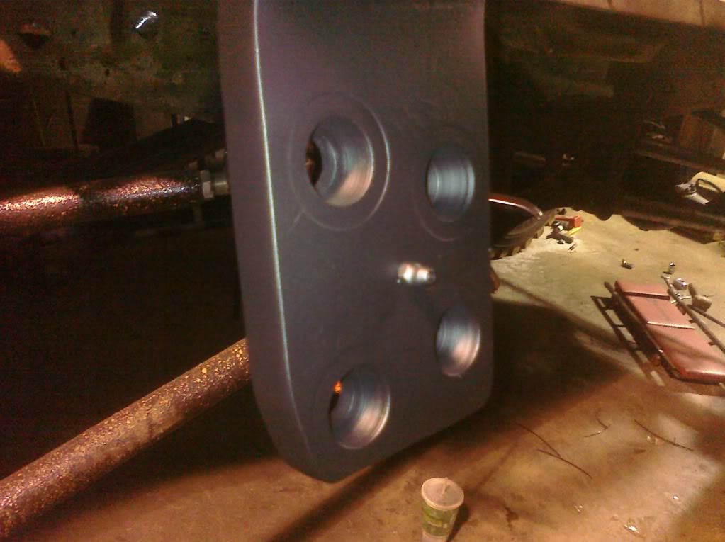

Also had Hi-Steer arm milled for cone washers:

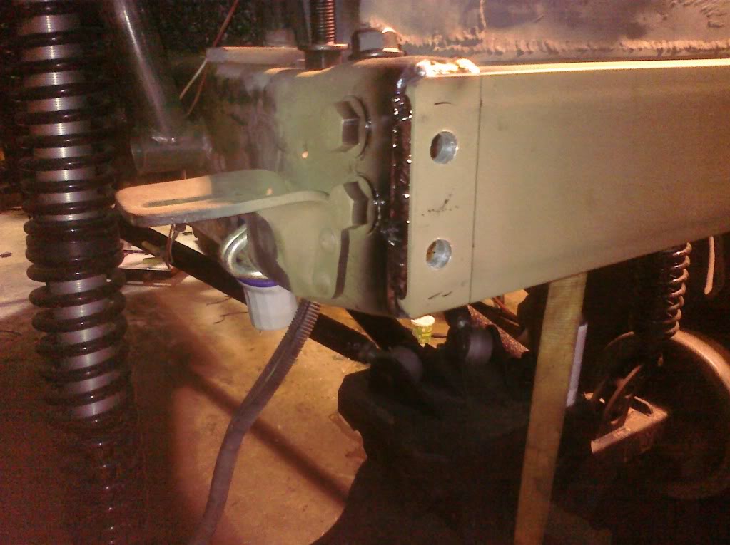

I like the build, but I have a question about the coilover mounts. What is the reasoning behind the shape of the lower mounts? Is it purely cosmetic, needed to clear the link mounts? It just seems like the entire weight of the vehicle is going to be coming straight down, but the offset mount is going to transfer the weight to the welds.
Most people use those on a steering axle, so they can mount the coilovers out over the knuckle. Not sure why he used them here, but it has been done plenty(with lots of questions asked every time i see it).
