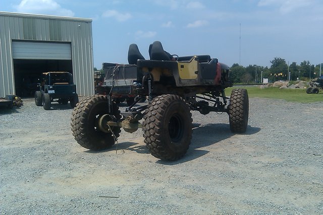

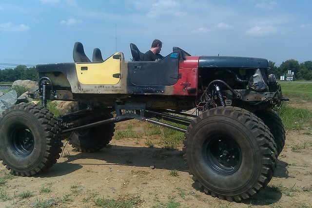

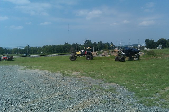

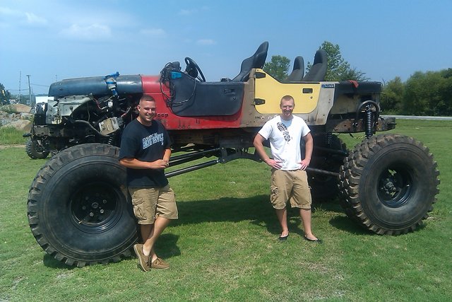

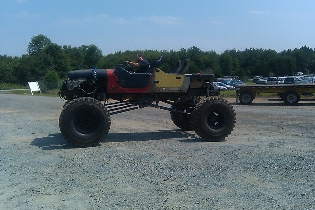

Well after we got the steering bled. We cranked it up and cycled the steering to see if everything worked right only to blow a line apart and have to start all over again. Unfortunately I had used a wrong fitting on one of the lines to the cylinder :shaking: An hour later we were back in business and driving it around the shop. The coil ovvers seem to do pretty I can only imagine how it'll be once they're all dialed in. It's still got open diffs and np front shaft yet so we didn't really get to flex it out yet but that should be soon. For a height comparison the guys in standing next to it are 6'1" and 6'2".
