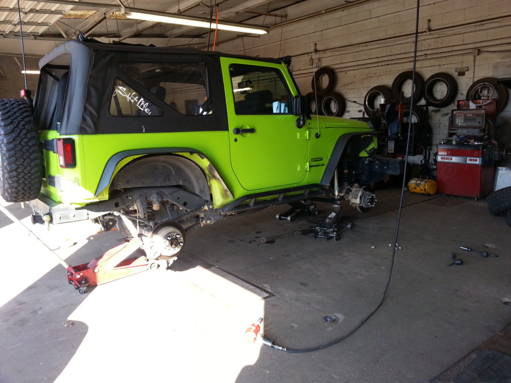

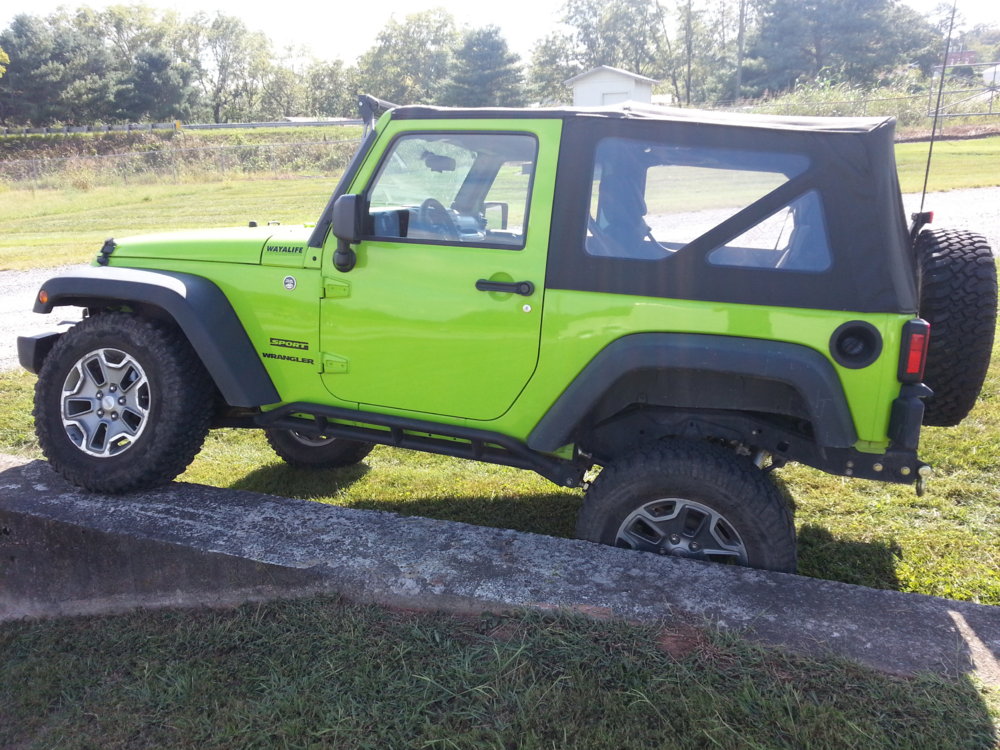

After finally getting all the parts in, I got a buddy of mine to put the lift on for me since I don't have all the garage space needed lol.
Here's some before and after flex pictures.
Before
And after

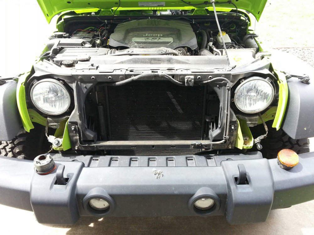

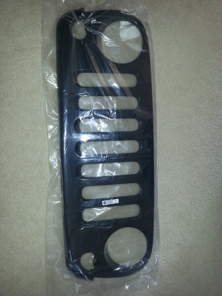

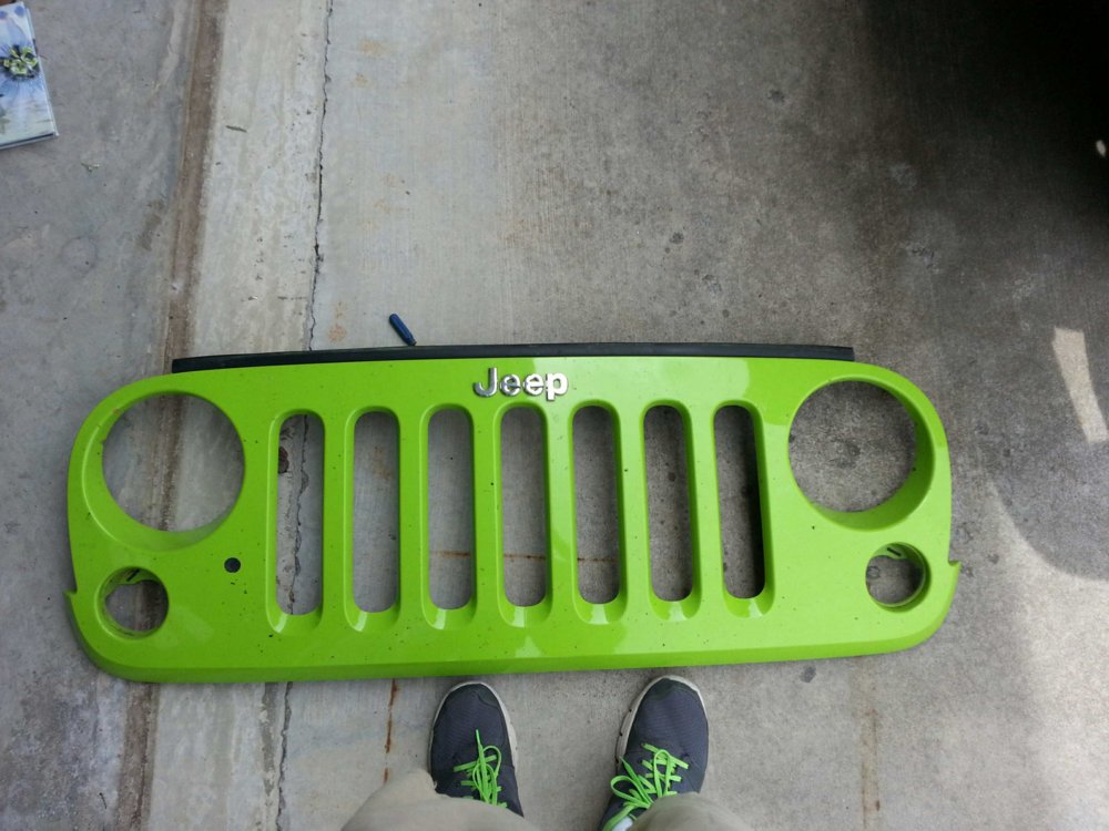

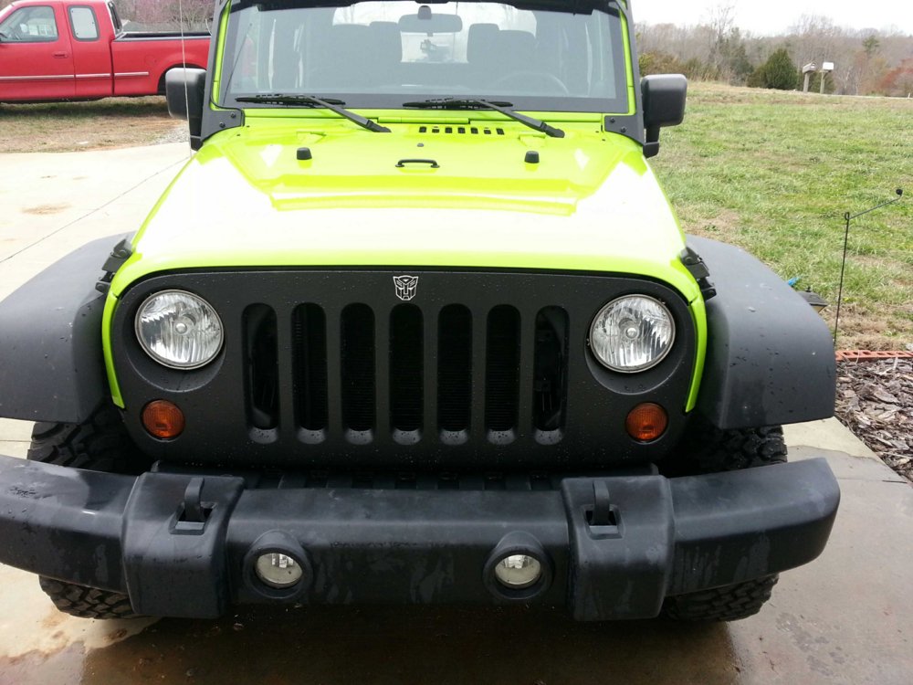

So I had hit a deer and ended up with a small hole in my grille. So I bought a replacement and put my own touch on it.
You can see the hole there on the left.
Here's the new grille still in the wrapper.
It was so easy taking the grille off. There's only like 5 weird screws you have to take off and the grille pops off.
And the new one installed.

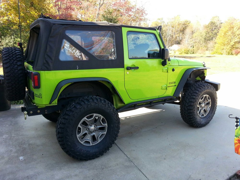

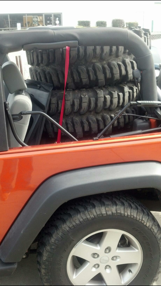

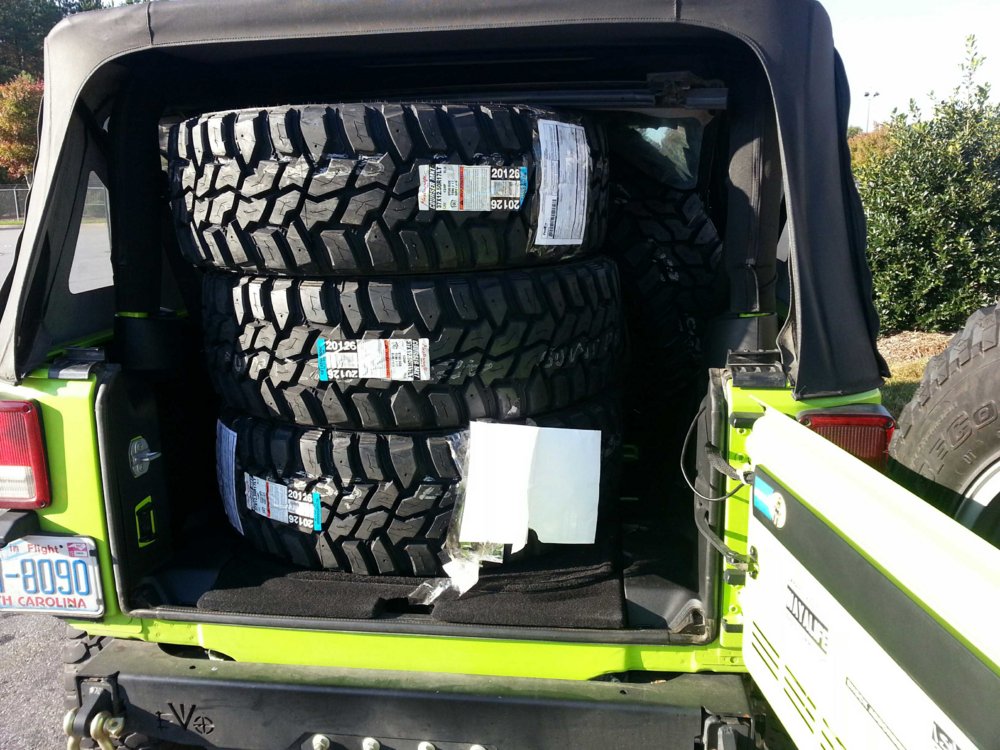

I put 3 38.5x15.50 in the back and one on the hitch carrier

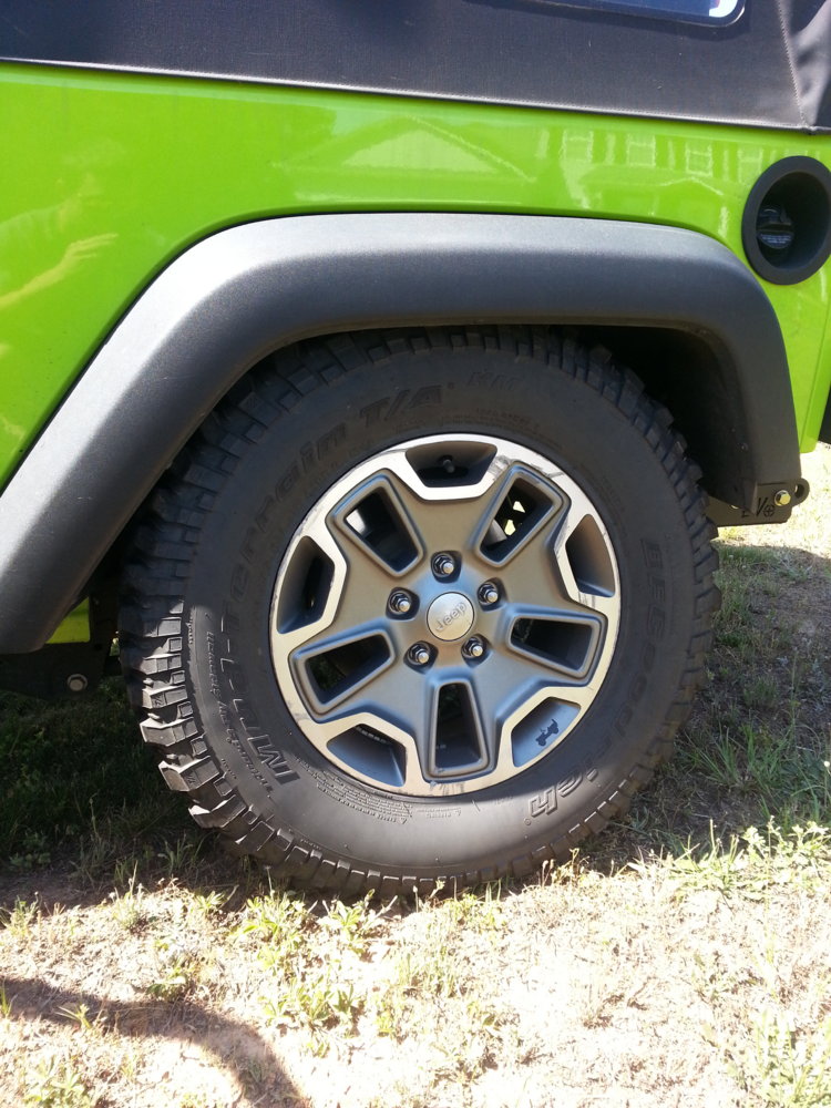

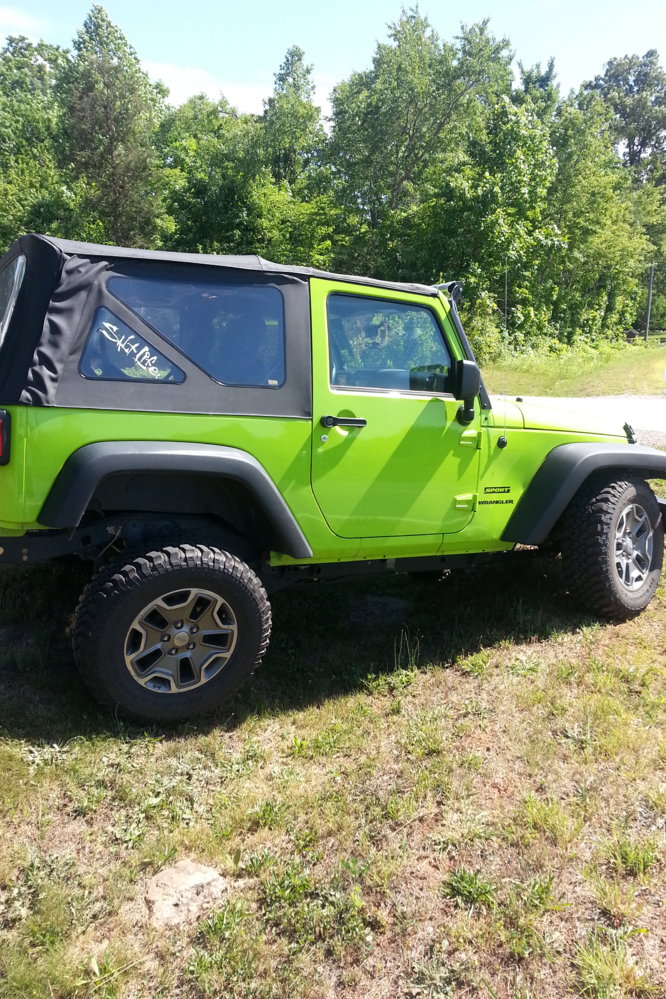

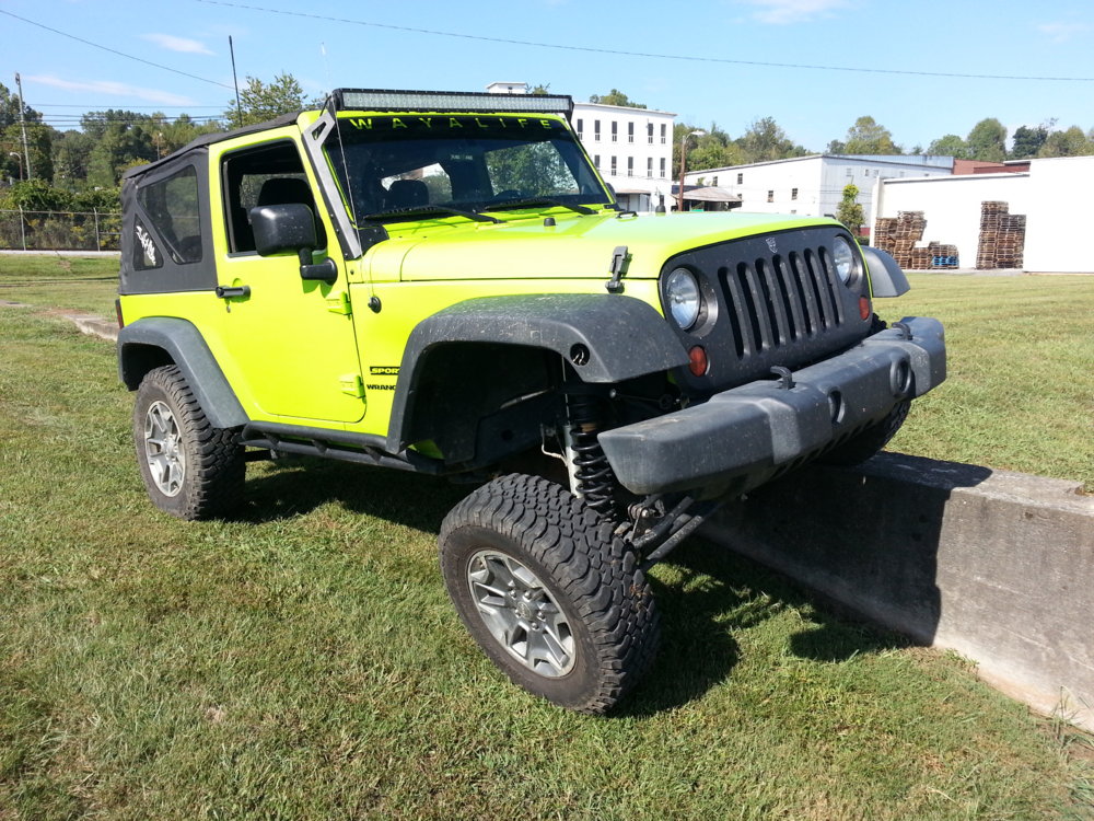

Here's what she looks like with the 37s on her.
As of right now, I don't have a spare. So if anyone has a 37/12.50/17 for sale that I could use for a spare, let me know. It can be a 13.50 too, I'm not picky lol
I'm running 2 and with my 35 inch mtrs yesterday mine rubbed when flexed all the way
I actually don't rub with my 37s, which I'm pretty surprised about lol
JWebbie2, Are you running wheel spacers with the factory Rubicon wheels and 37s? I'm helping my brother do a similar setup with 37s on stock JK wheels, 3" springs and trimmed flares and I was curious as we haven't done the lift or tire install yet.
Yea I'm running 1.5" spacers. The front rubs the lower control arms just a little bit when I'm turned hard with it flexed. You'll have to trim the rear pinch seams or you'll scrub the tires bad. I'll probably end up posting some pics of mine later. I can help you guys out if you need some guidance

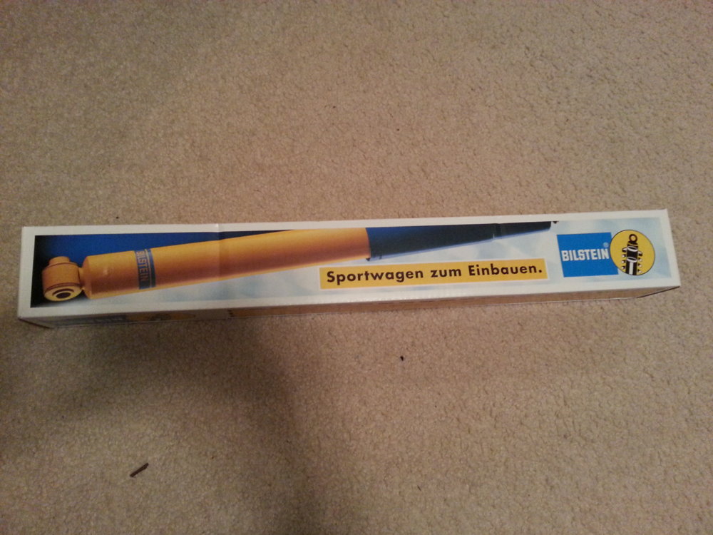

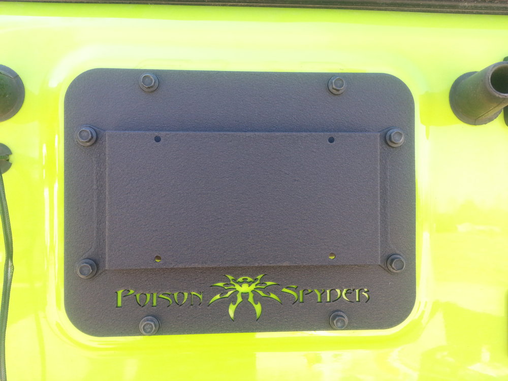

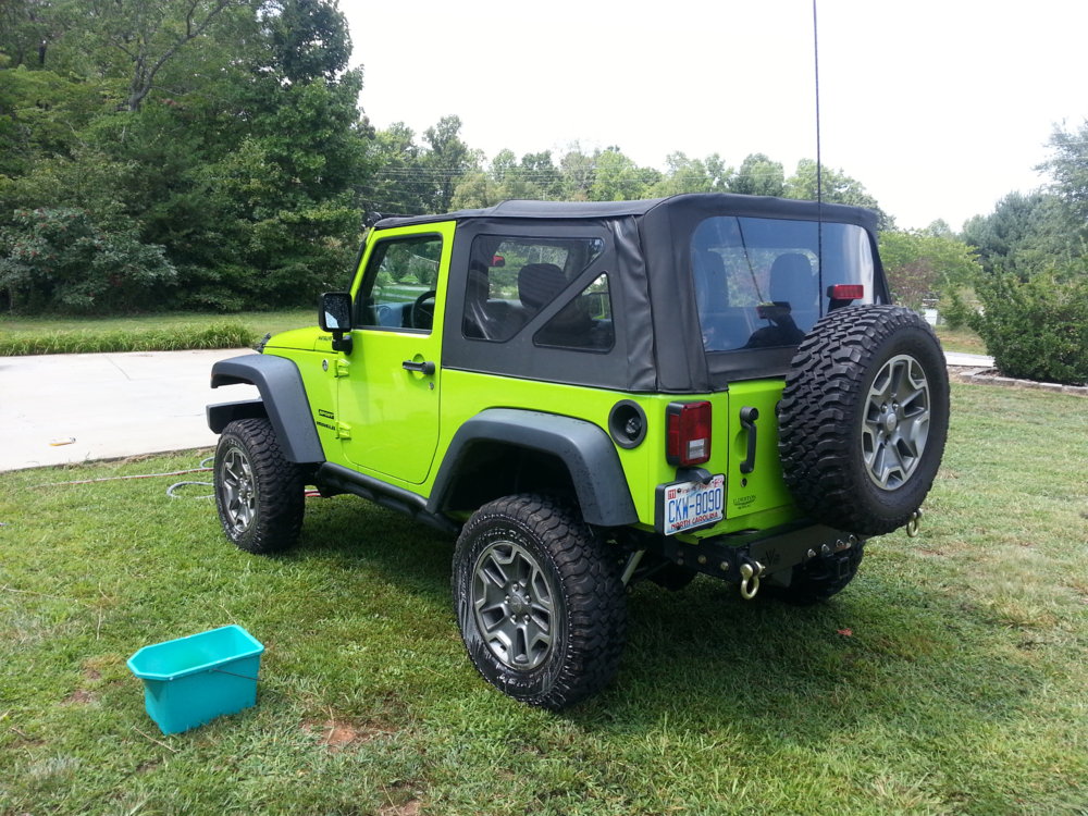

Ordered a few parts the other day. I had a rear shock leaking, so I called up Bilstein and they told me to order a new shock and send in the old one. They will inspect the old and see if it was defaulted from the factory since it hasn't been on my Jeep for too long, and if it was default from the factory, they will refund me the money for the new one. I also ordered the Poison Spyder tramp stamp for the rear since I don't run a spare tire and I'm tired of looking at the stock carrier.
Parts came in!

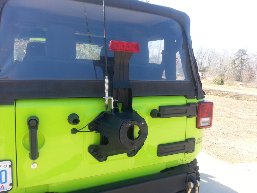

Since the weather was so nice today, I decided to put my new Jeep parts on.
Here's what it looked like before.

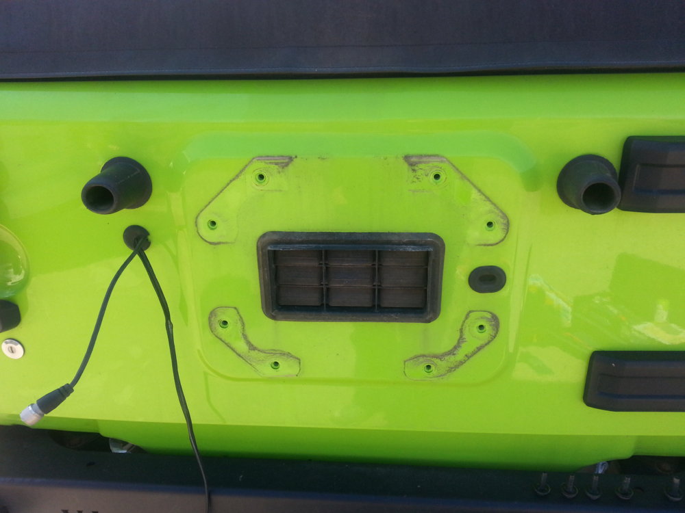

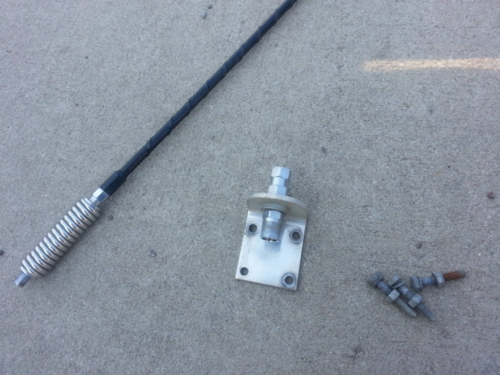

First thing I needed to do was pull off the CB antenna mount and sit it aside. So for now, I have no CB radio lol. I'll try and fix that later.

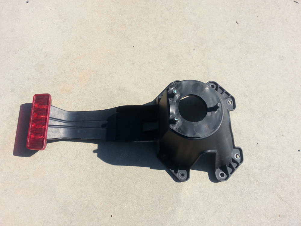

Next I needed to get the bolts off from the back of the third brake light. There's a connector near the top of the brake light that I needed to undo so that when I take the tire carrier off, it doesn't just dangle there behind my Jeep and damage some shit. After that I just unscrewed the 8 bolts that hold the carrier to the tail gate and the carrier came right off. As you can tell, it was a little dirty.
Anyone need a stock JK tire carrier? lol

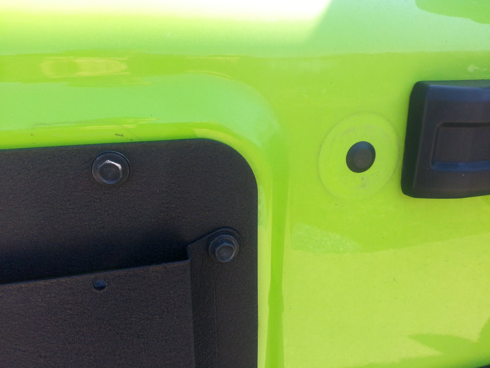

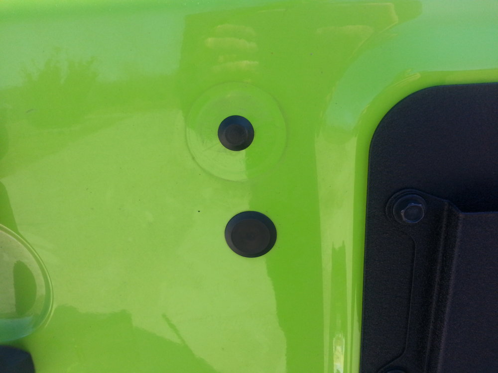

The install for this thing is super easy. You just reuse the stock bolts and boom, its on. Plus it just looks 10x better than the empty stock carrier.
The most bad ass part about the kit is that Poison Spyder also sends these little plastic hole grommets to cover up the holes from the 2 tire isolaters and 3rd brake light wire hole. I didn't even know these came with it. But it definitely makes it look better!!!
