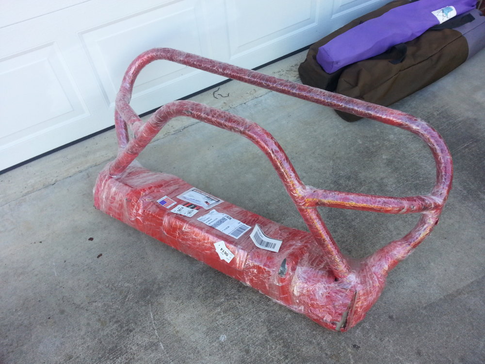

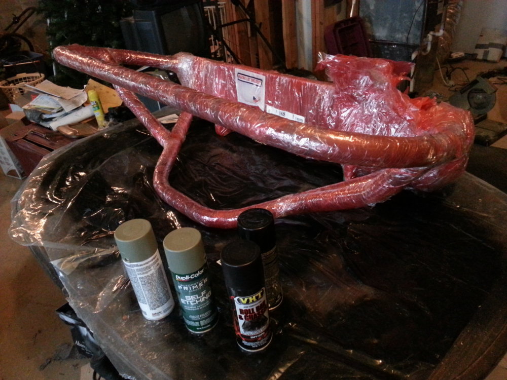

Time to get the new bumper unwrapped, cleaned and ready to paint!

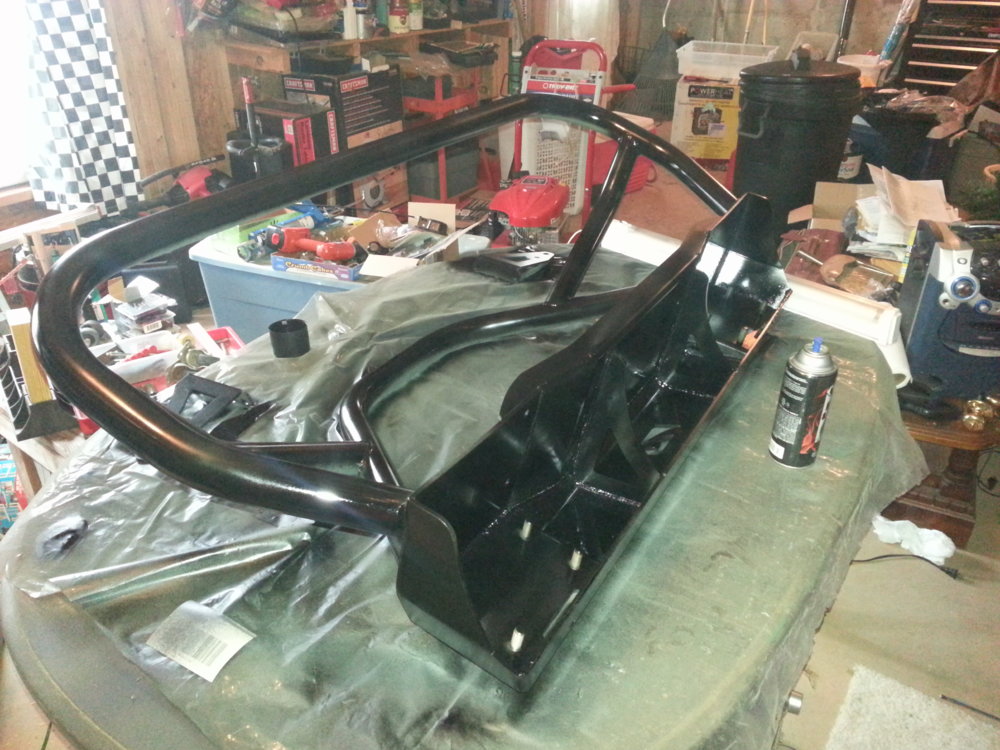

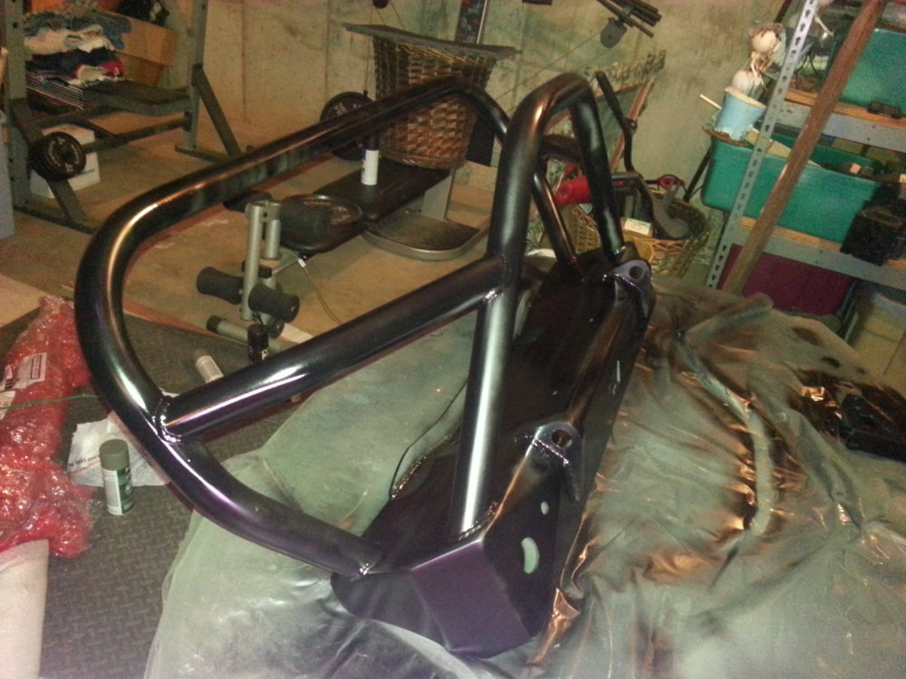

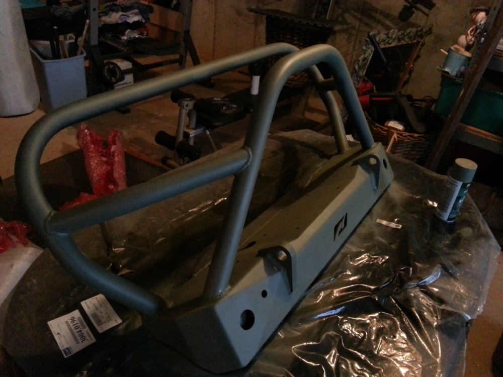

Now its time to let the first coat of self etching primer dry and then it'll be on to coat #2
Almost done! Gonna let it dry over night and then add 1 more coat.
Not going to install it right away, i still have to wait on a new vac pump relocation bracket to come in or I'll have some major issues when i try and mount a winch

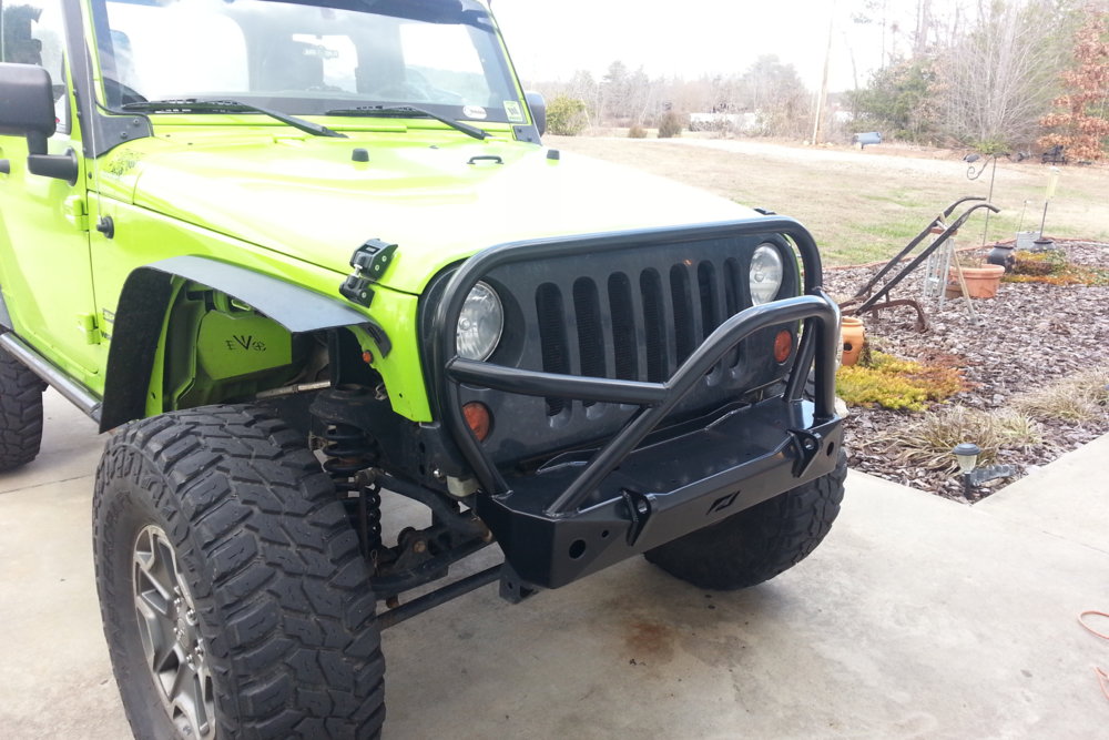

My RockHard4x4 vacuum pump bracket came in today, so that means I can finally get the bumper iinstalled! Plan on doing it Friday since I have the day off and the nasty weather we've had the past week or so is finally gone.

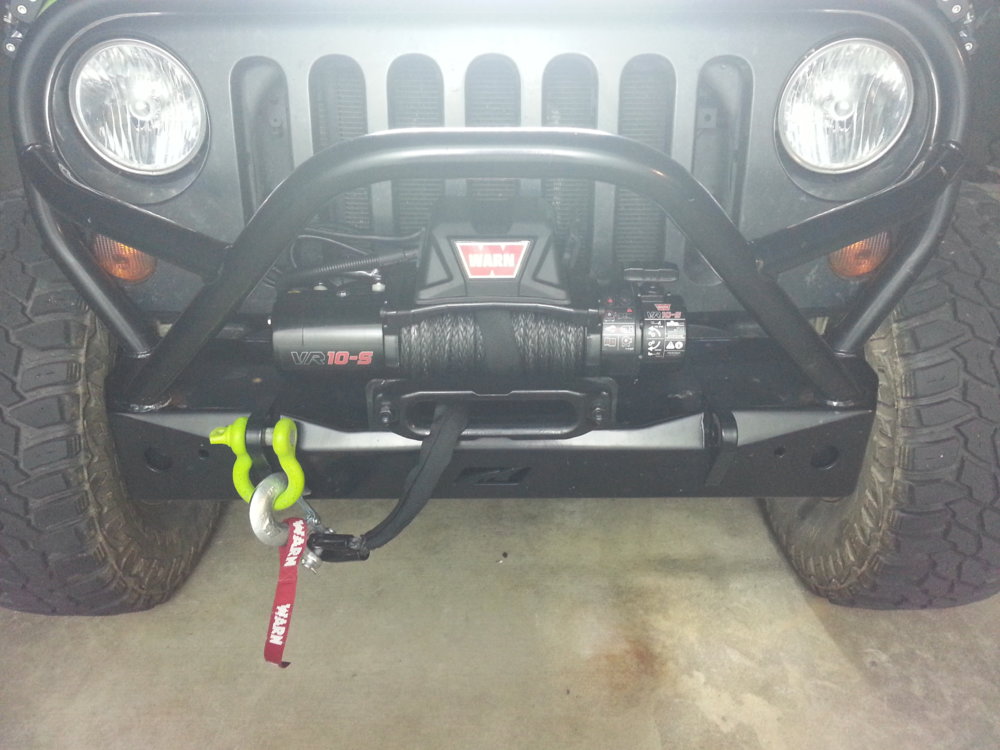

I think in the world's worst at updating my build thread lol. But a few things have changed on the Jeep. First, I got the vacuum pump bracket installed. Second, I got the Motobilt bumper put on and man is it bad ass! The bumper has totally changed the look of my Jeep. And since my bumper can hold a winch I decided why not, especially since I was well overdue for one. So I got a pretty good deal on the new Warn VR 10,000 with synthetic rope. I also ordered a Factor55 ProLink because I'm not a fan of a regular hook ever since I seen one fail a few years back.
And here's a picture of the winch installed before I got the ProLink put on
