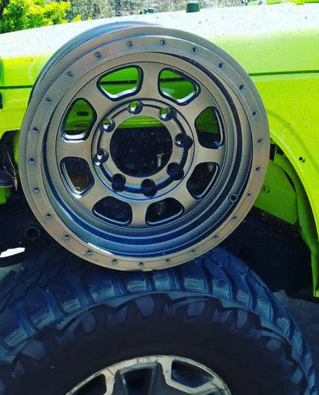

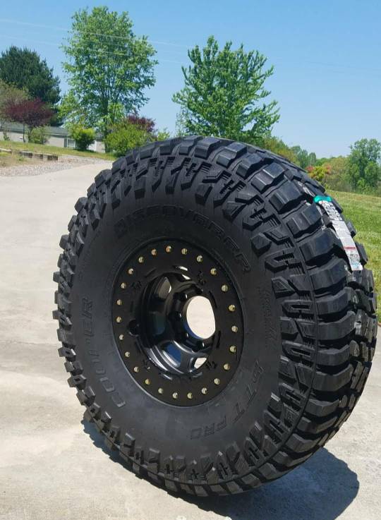

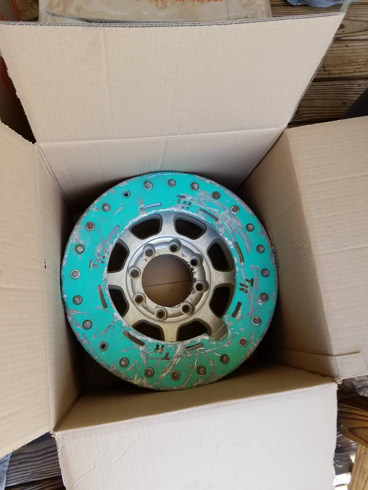

Picked up a set of used TrailReady beadlocks. Now to get them cleaned up and ready for paint.
Sent from my SM-G935U using Tapatalk

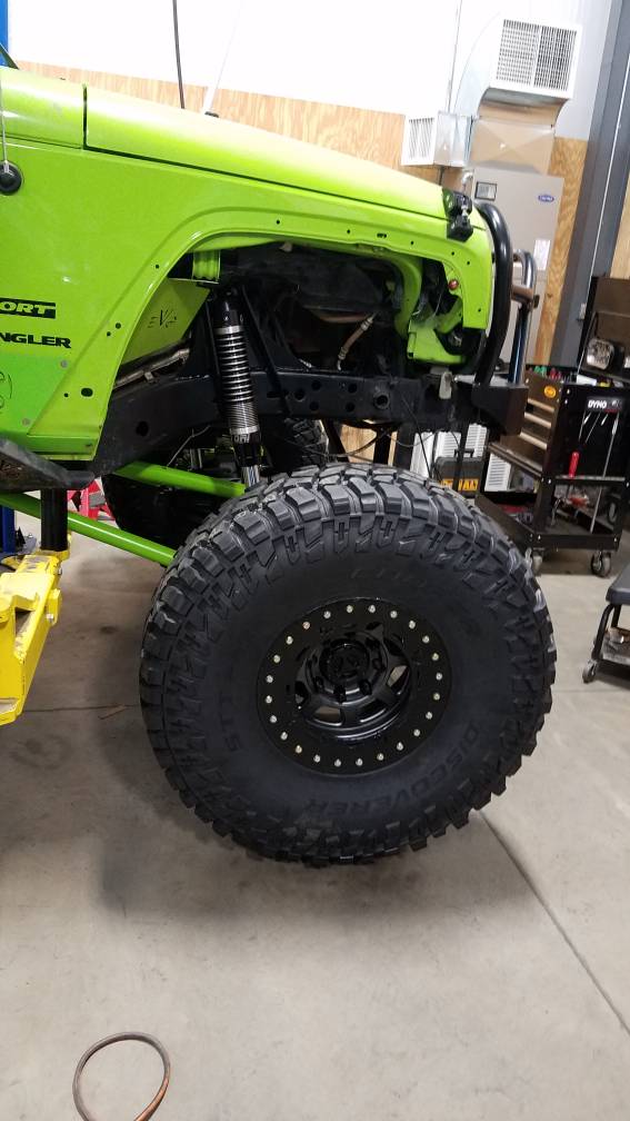

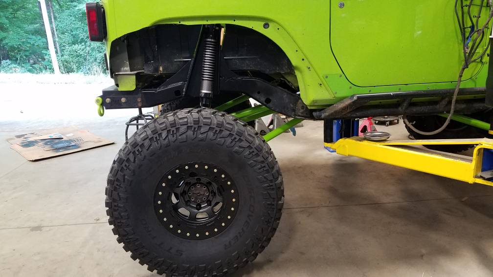

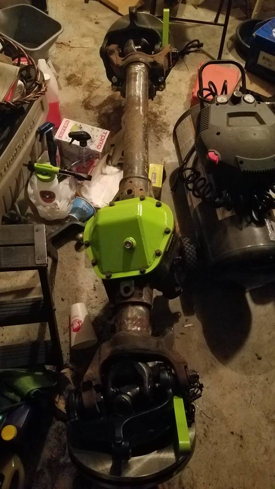

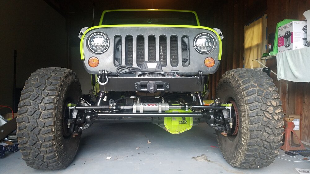

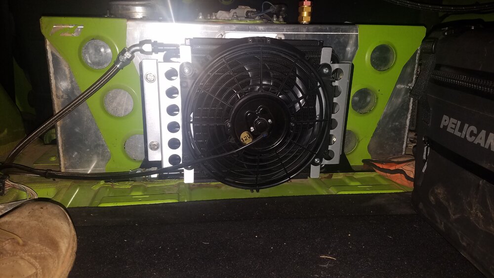

Got my Barnes4wd front 3 link kit and double triangulated 4 link kit for the rear in. Also have a Motobilt fuel cell I need to get installed. Then all I need is to order some 2" tubing and some tires and the Jeep will be ready for the axle swap.

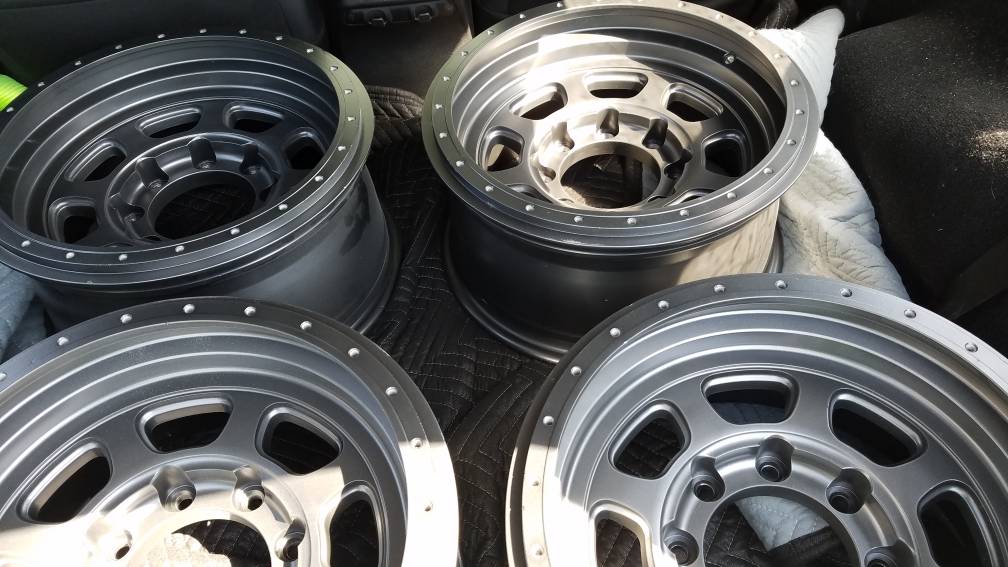

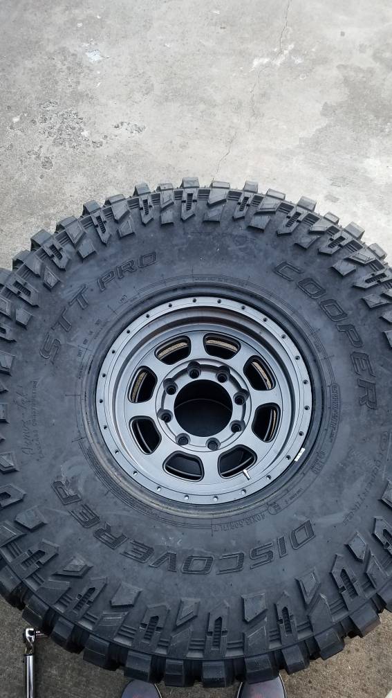

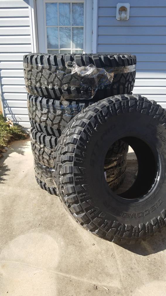

Tires showed up today. Now to get my wheels back from powder coating so I can get them mounted and balanced.

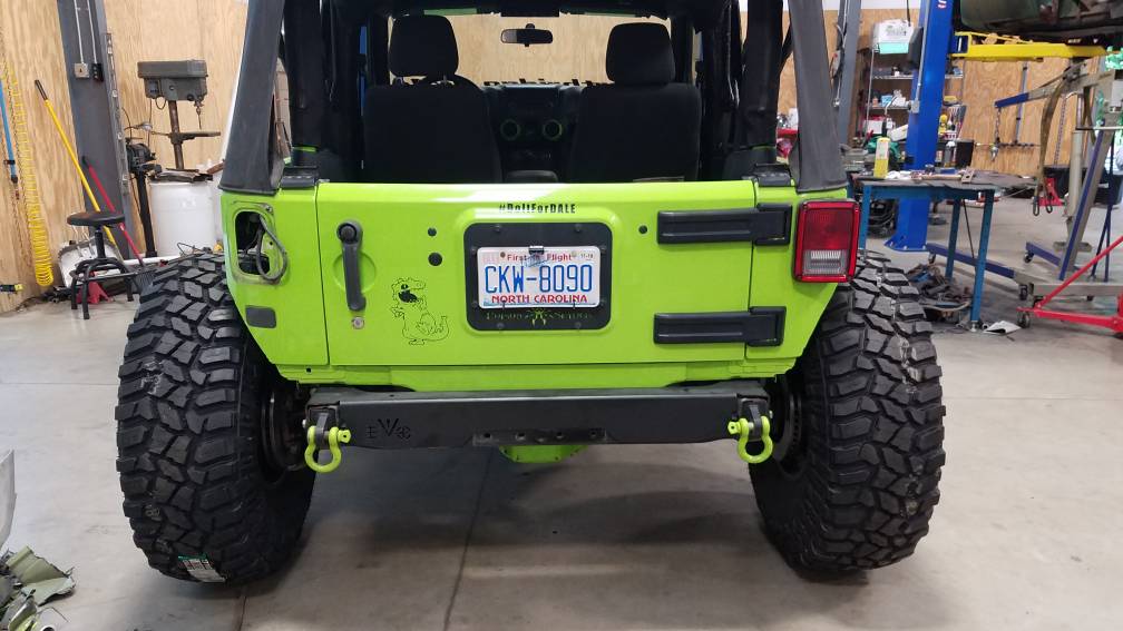

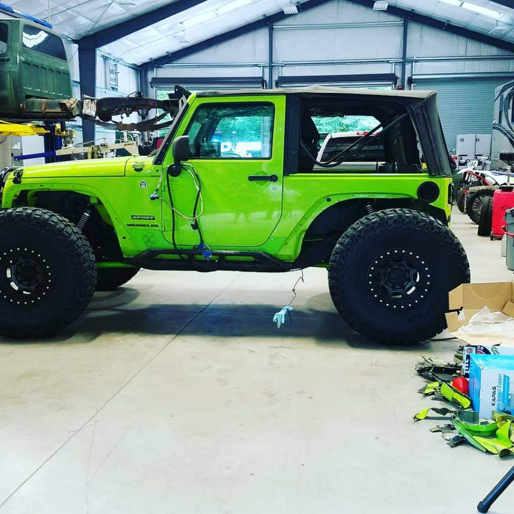

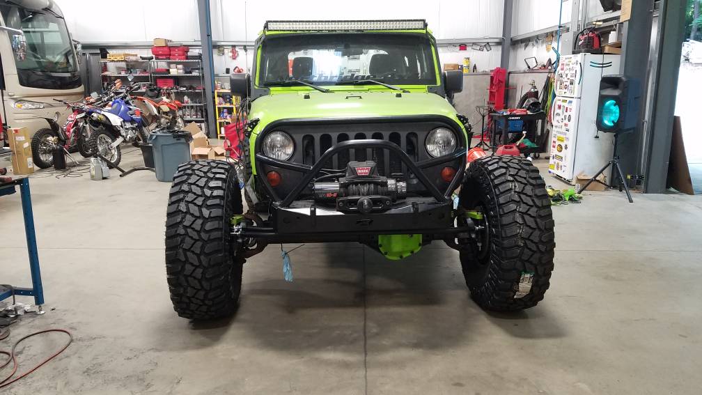

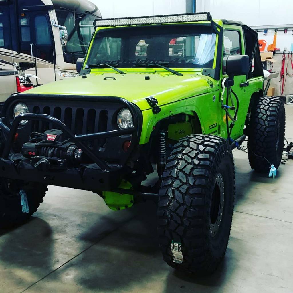

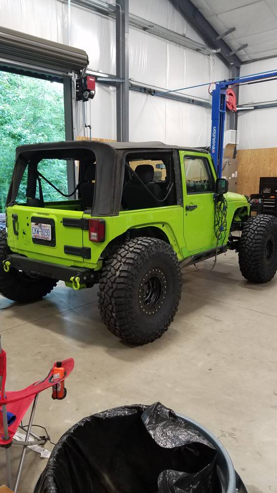

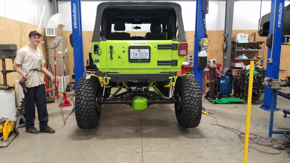

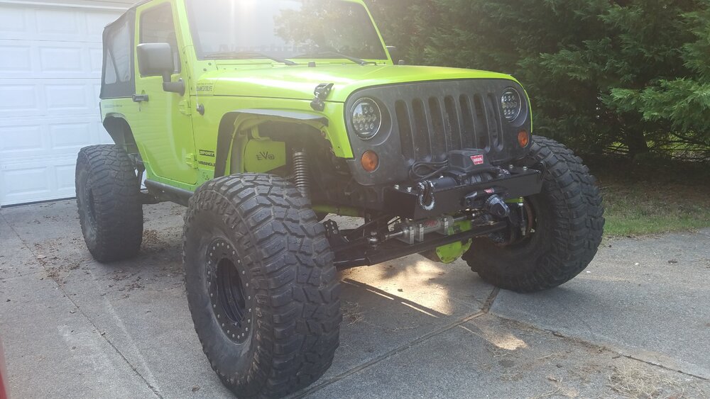

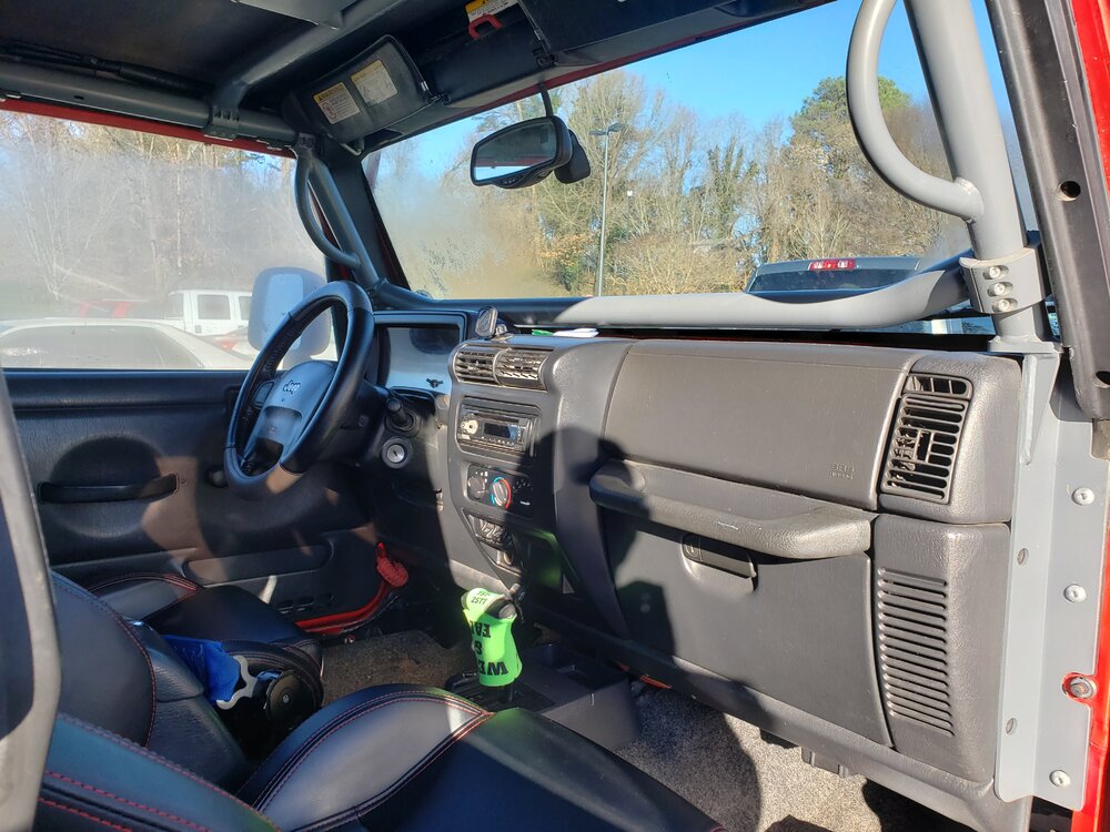

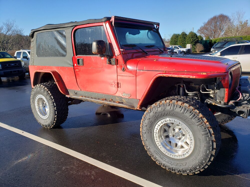

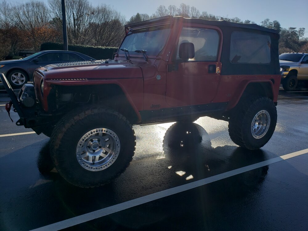

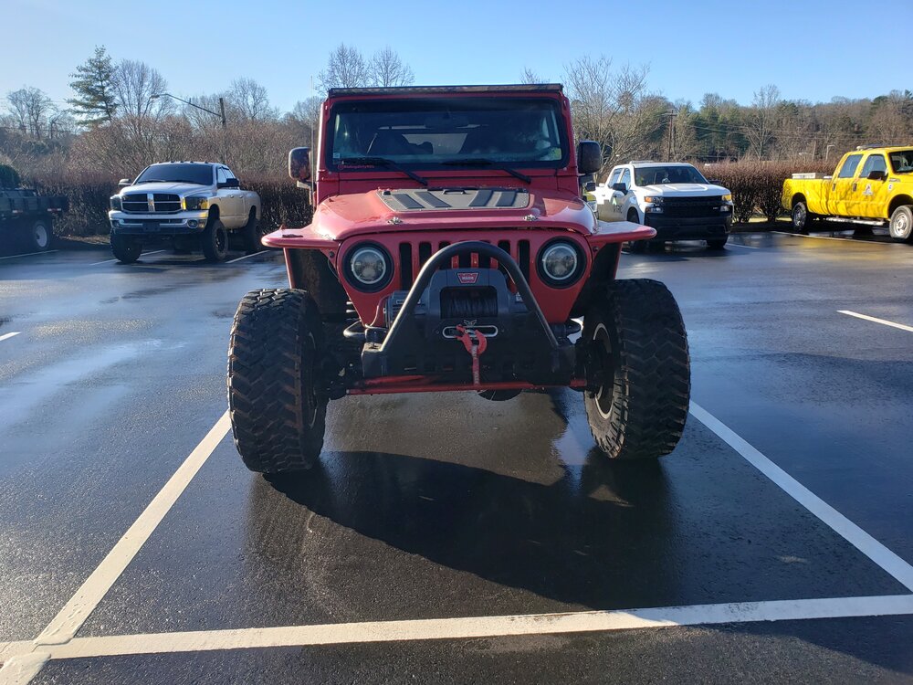

Just an update since its been almost 4 years lol. Jeep is now getting a rear Detroit locker put in in place of the ARB. I swapped in a Rubicon transfer case thats made it way better on the trails. Its also running upper and lower ball joint deletes and also has full hydro now and custom front bumper.
