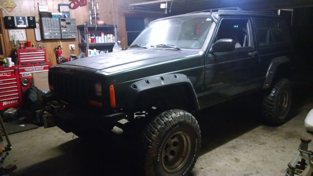

Cleaned and ready for high strength Walmart rattle can black!

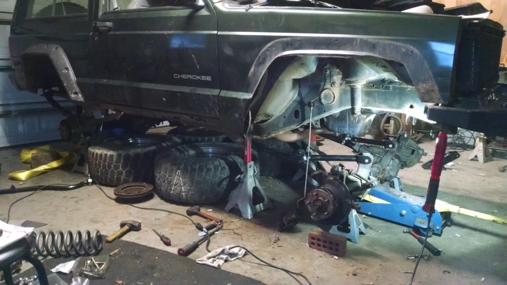

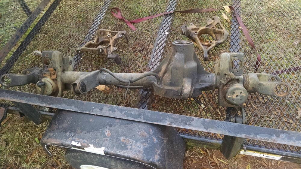

Progress! Got the gears and locker installed and new ball joints. Trying to get it hung now but getting the arms aligned it's a real pain. I've got the top links at the same 15¼" but they don't line up. I've got the chassis stands at the same height and a set of stands under the axle tubes at the same hight so... it should be parallel. The top links should be the same but one needs to be about ¾" longer than the other to mount and not bind. I guess I'll go with what I think is right and adjust it later if it's undrivable.

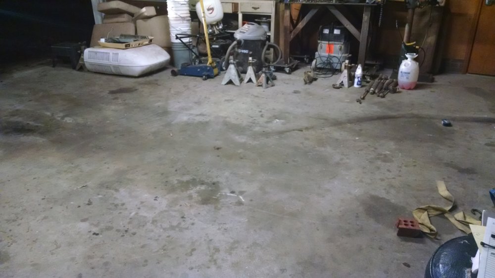

Had one job.
Did someone come & take your XJ?

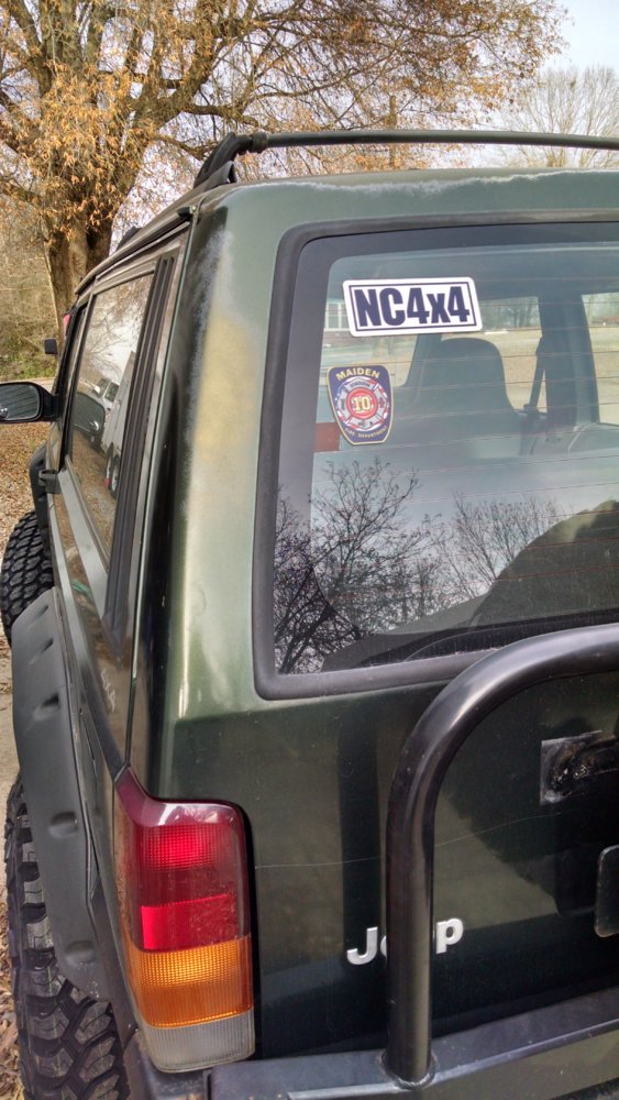

Sure hope the above picture indicates that you got your XJ out the garage and under its own power
Congrats on getting it going

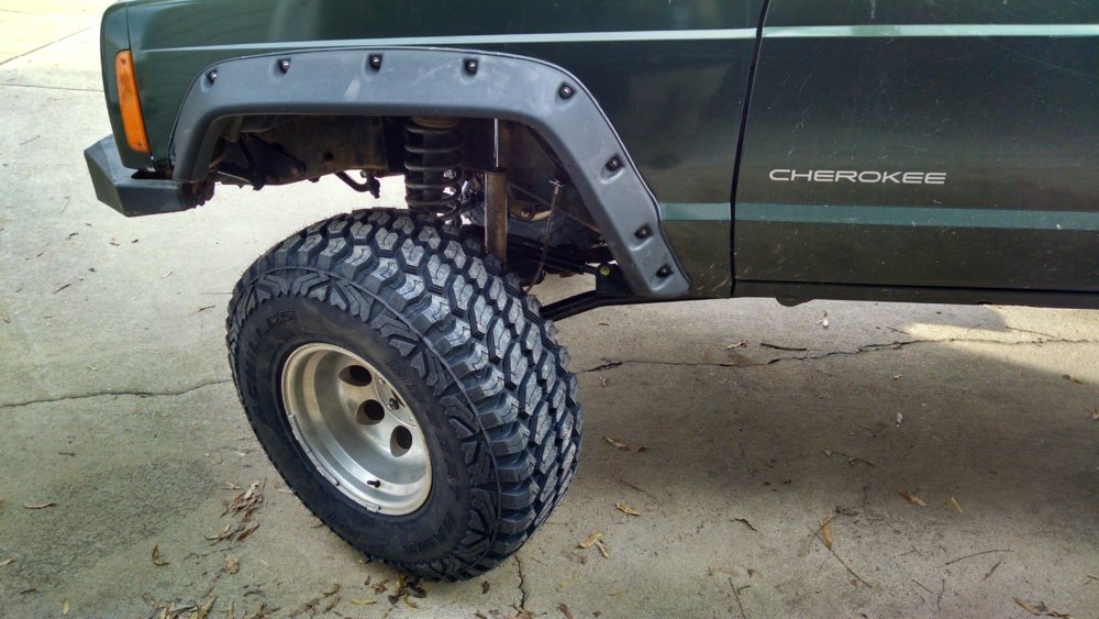

Spent the day putting the XJ back together and went for a short trip down the street. This is the first I've driven it and it runs pretty good. I never went over 35 yet thought. I don't have any front shocks installed because I left the bolts on the old front axle and I still need to get a sway bar and links for the front and fab up a mount for it.
Spent the day putting the XJ back together and went for a short trip down the street. This is the first I've driven it and it runs pretty good. I never went over 35 yet thought. I don't have any front shocks installed because I left the bolts on the old front axle and I still need to get a sway bar and links for the front and fab up a mount for it.View attachment 281339
Shocks and sway bars are for pussies.

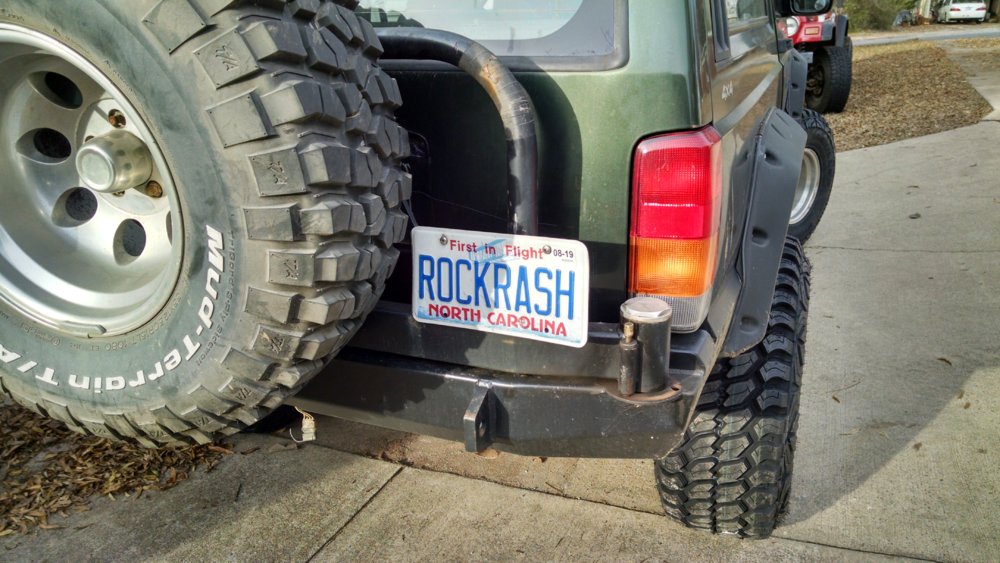

I like the plate.
Need to spend some time on the trails to make the plate and the Jeep align.

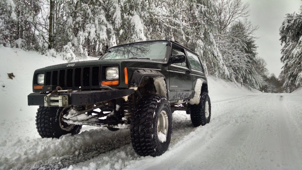

Give me time, just got it street legal this week! Going to test it out Sunday on old hwy 105 Sunday if we get snow. Hopefully no rash though I still need to make sliders and get some extra armor under the tank.
How did it do in the snow?
Flawlessly. The locked front and open rear kept me from sliding all over the road and because the front was locked it pulled whichever direction the tires were pointed. I aired the tires down to 22psi. We passed people on the interstate through the virgin snow like it was nothing. I can't think of a single complaint for a Maiden voyage.
I dig it for sure and glad to see it on the road and getting after it. I had a ‘97 that was the same color and had almost the same “sunburn” yours does. I miss mine bad but looking forward to my new build. Wish I could have played with mine in the snow though.
