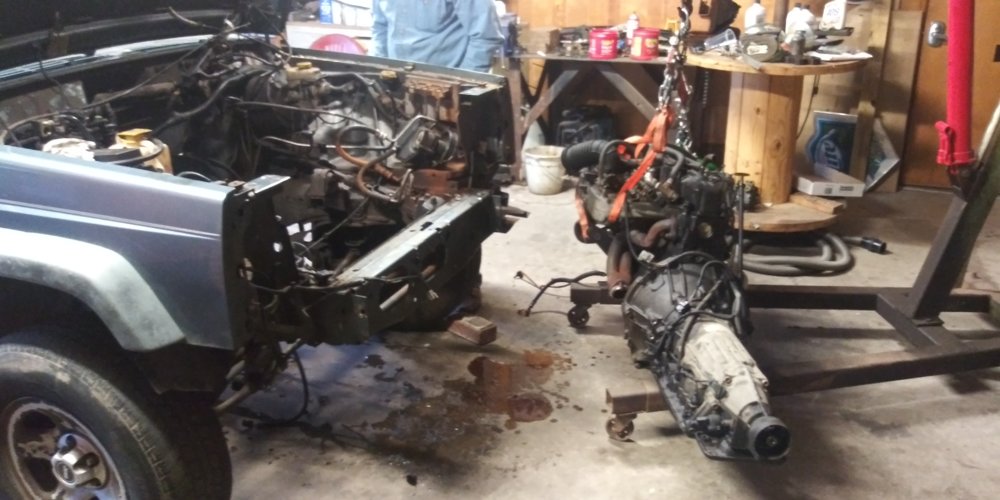

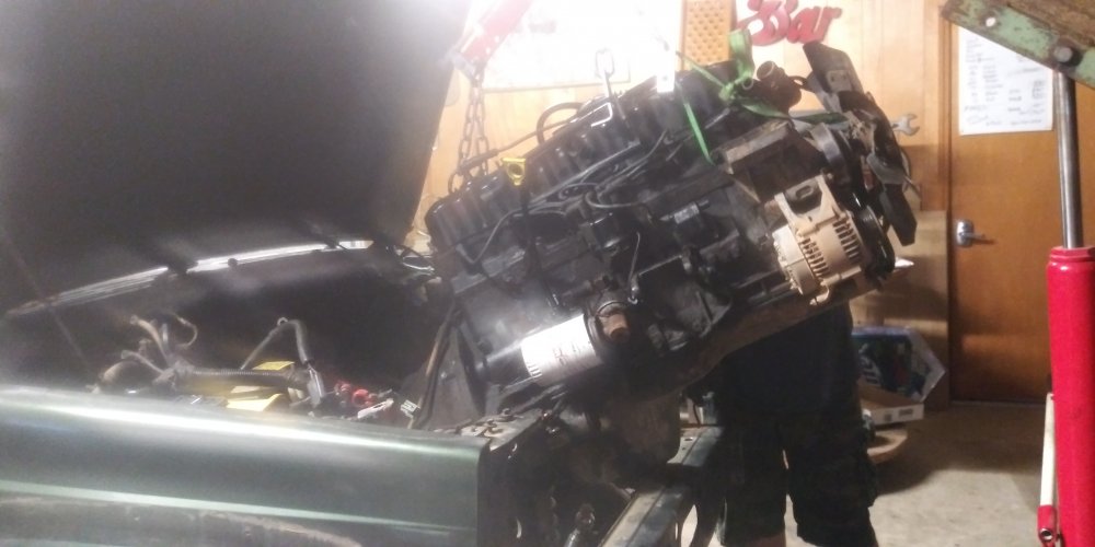

And so it begins. Pulled the motor/trans today. Still a lot of disassembly on the new body before i start taking parts off of the original.

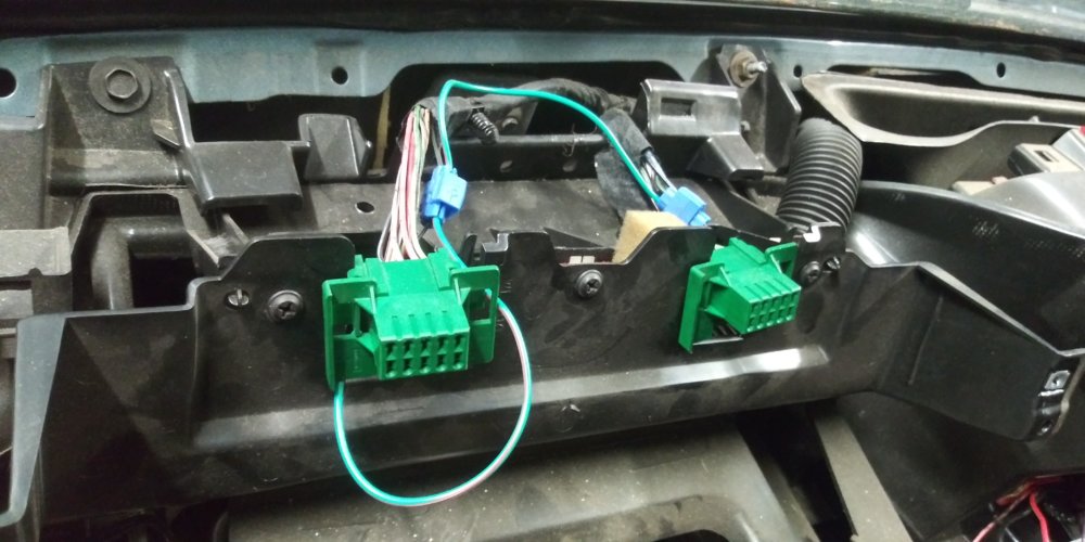

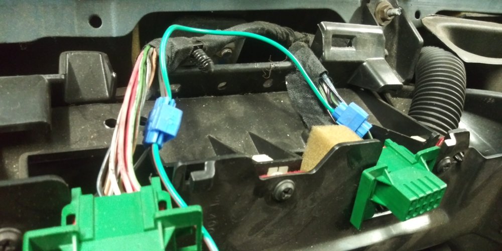

Did a little cleaning in the engine bay and started pulling the interior. Of course someone has been playing with the wiring. @Jody Treadway why/what is this? The wire running down the dash was not hooked to anything. This is on the back side of the instrument cluster.

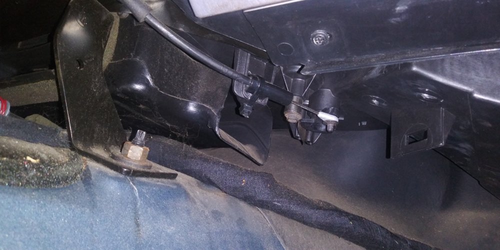

Ok, here's a curve ball. Mfg date is 5/98 but the HVAC box is cable actuated. Could this thing have double bastard 97/98 wiring?

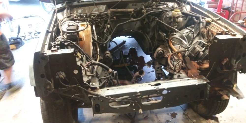

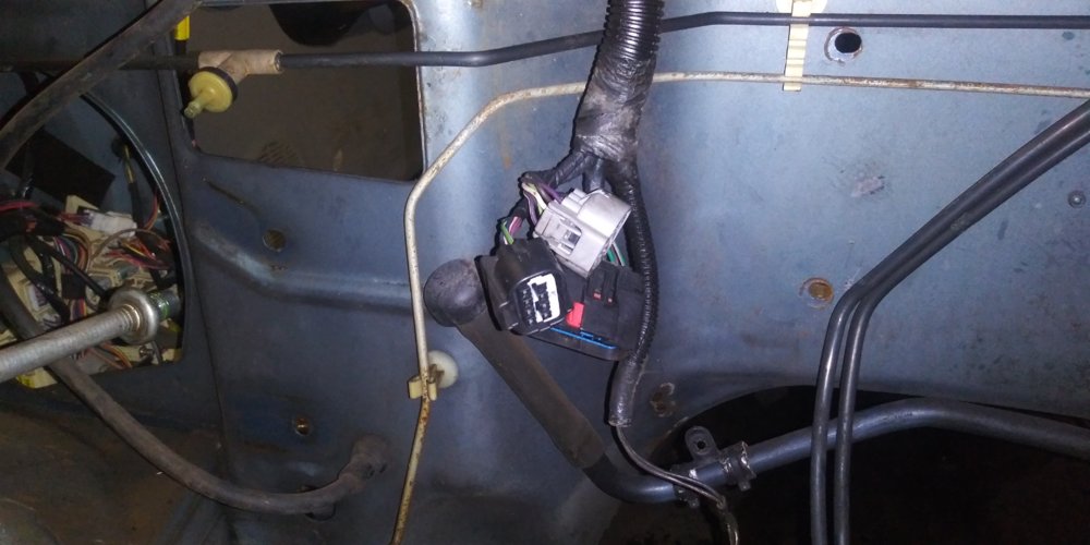

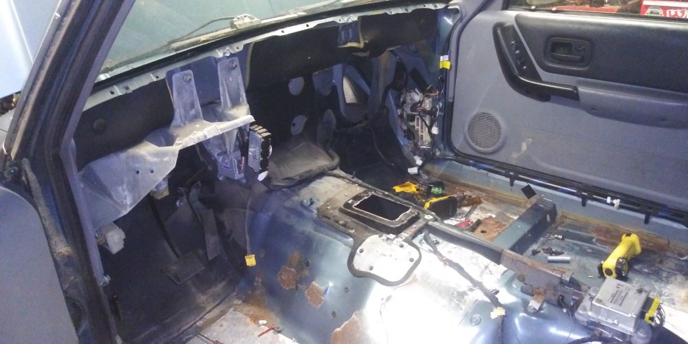

Got most of the interior gutted. I pulled the injector wiring harness, will use the one from the 97 model. Do i need to pull and change the harness that goes through the firewall? It has the plugs for the computer and transmission, goes through the firewall in about 4 different places.

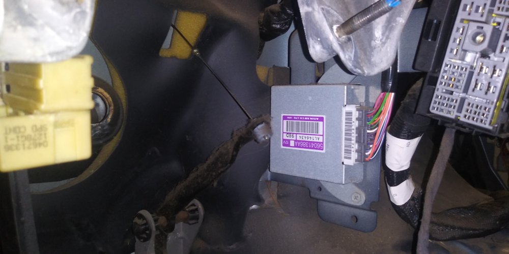

What exactly is this box?

I'd definitely delete the auto computer and stuff I could.
Agreed. At this point I've got this thing so far apart I'm going to swap everything except the body harness. Basically just keeping the sheet metal.

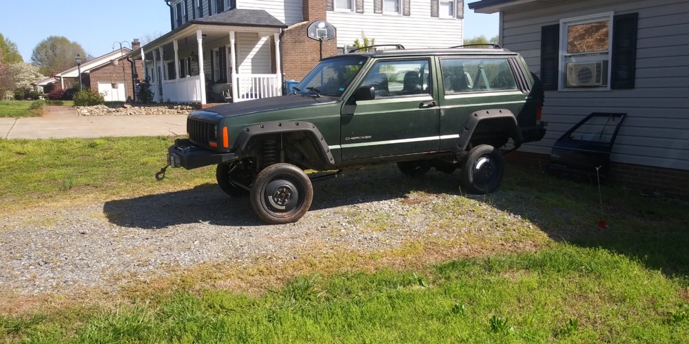

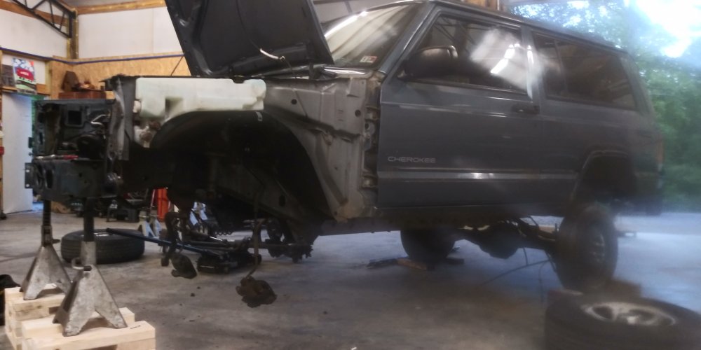

Stage 2 has begun. Got the motor/trans/t-case removed from the original XJ. Will start cutting fenders and adding subframe stiffners to the new body this week.

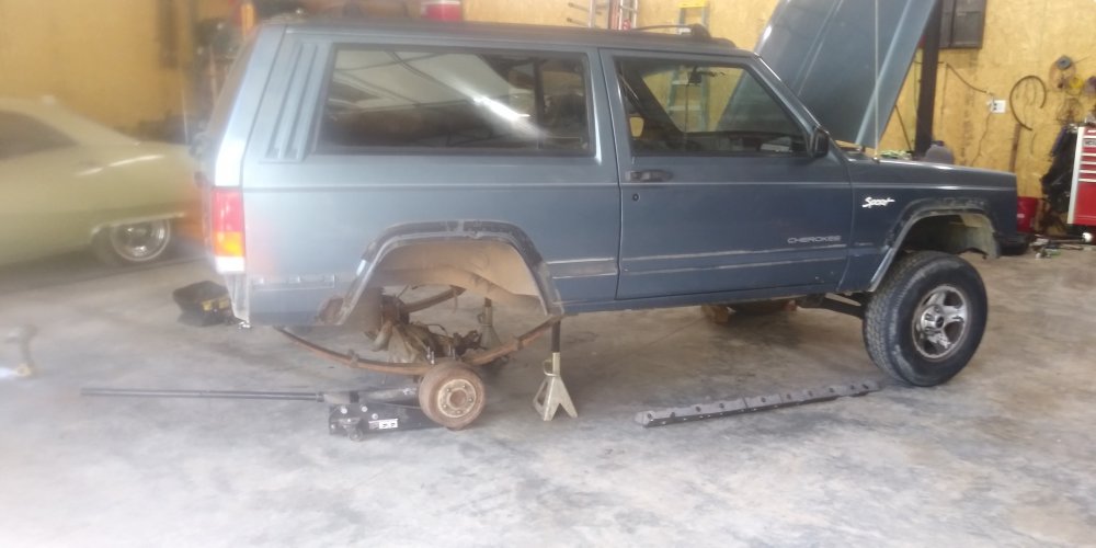

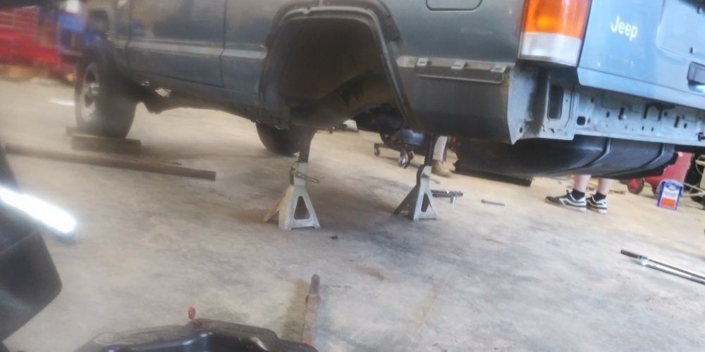

Been working on my days off. Finally started rebuilding instead of taking apart. Pulled the rear end out off new jeep and replaced the bushings from the original jeep and reinstalled. Also got the frame stiffners welded in and will start the front suspension next week.
